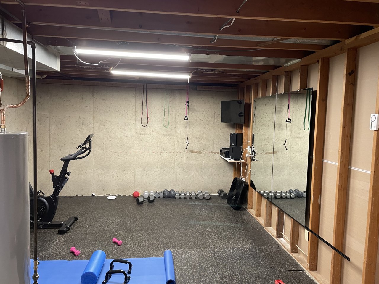

    Took down a big ole shelf and mounted some mirrors and tv so I can watch myself playing with myself.
    Framing and drywall will get down eventually but there are bigger fish to fry currently

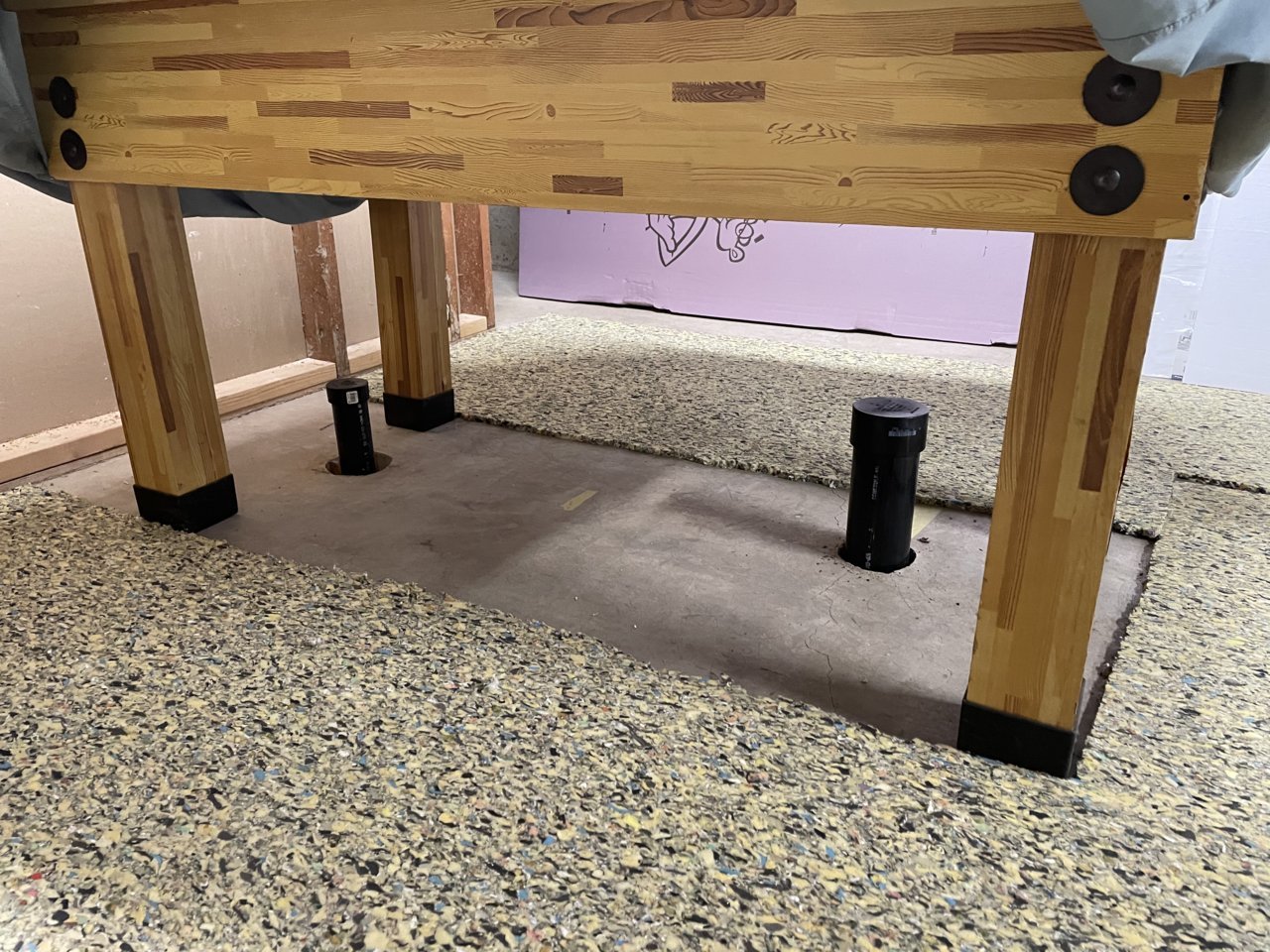

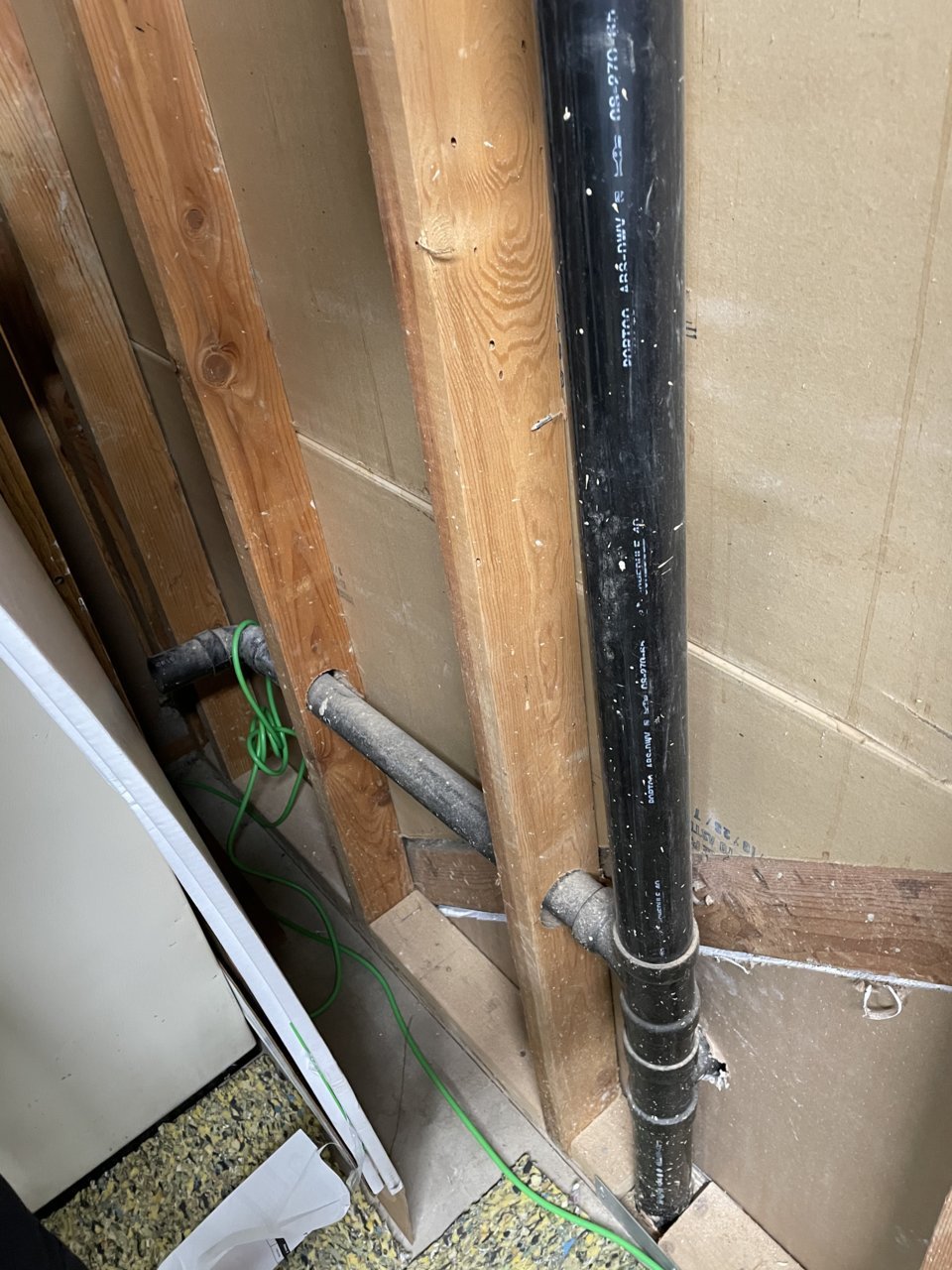

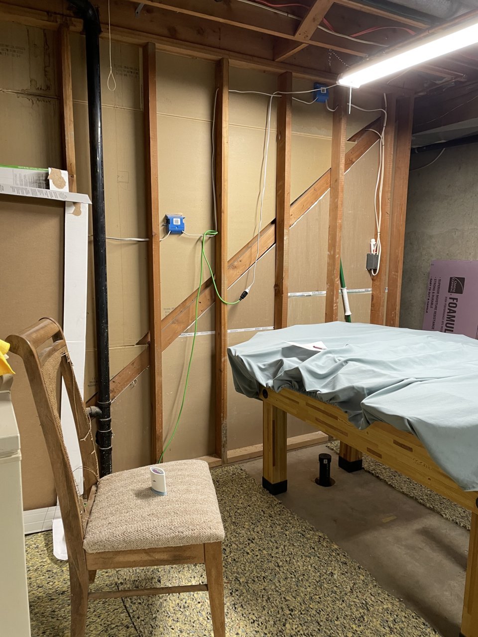

    Any plumbers out there? Our unfinished basement has a shower drain and toilet waste roughed in and I’m assuming they both go back to the wall in the picture. I have no idea if I need a pump or if my sewer line is still below my basement grade? Is there any easy way to tell? I obviously wanna finish this into a bathroom eventually. The pipes were empty when I put the caps on but I’m not sure where to go from here as a homeowner besides straight to a plumber or contractor. Any words of advice?

    Look for a sump somewhere nearby. Unless you’ve got a daylight basement, my bet is sewer is higher than the basement floor level. A sump in the floor is telltale and would be for dropping the sewage ejector pump into.
    I don’t see a vent line unless it’s in the concrete wall, but that is both rare and too far away for code. You sure that smaller pipe is for a shower and not the vent for the toilet?
    It’s hard to really assess without knowing the layout of your house, where other fixtures are upstairs, and where your sewer/septic connection is located.

    There is no sump unless it’s buried in the concrete and plugged in secretly. I was told that our sewage (no septic here) may go through our backyard to the next street over. There is no waste line going to the front of the house so that makes sense to me.
    There is a vent (shower drain style) in the gym on the concrete floor (circled in red) and also a vent line (I’m guessing) off to the side of the stairs wall

    You're home looks like a fairly recent build. Might be a good idea to contact CDA Building & Planning dept & get a copy of your building plan. They have them available for a nominal fee. You can also request copies of all of your required building inspections. If there is a record of a basement plumbing inspection... that will show up.
    https://cdaid.org/planning
    the plan will show all plumbing fixtures. it should also show grade heights for wet utilities like sewers.
    you can also hire someone send a camera down those pipes. The camera is equipped a toner that will give exact location as it travels + depths. it can also scope the pipe all the way to the main if it IS connected.
    around here a typical camera scope with a video is around $300.

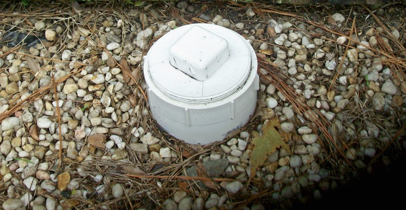

    Do you have a clean out outside for your sewer? Or do you have a septic?
    I have a clean out which looks like this. This is what it’s like in town/in my area of the country. If u have this in your yard just unscrew it and watch for water to flow. Again that’s how mine is set up.

    No, code requires a cleanout where a line exits the building (always assuming your place was built to code). Pulling that cleanout cap and watching/listening for water flowing would be a tell-tale sign that it is connected. But you could also be pouring water into nothing...or filling up a capped off pipe until it backflows on you and you’ve got a mess to clean up.
    My money is on that cleanout you see sticking out of the concrete wall being the main waste exiting the building, and anything under slab is not tied into that (you said in your PM that the pipes were only covered with cardboard until a short time ago when you actually capped them). Looking at the window to the right of it in the last picture (and assuming that window is in one of those sunken pits), that puts it at about the elevation that you would typically run a drain line out.
    As for the drain you have in your gym floor, that may just be an area drain in case of water intrusion, and it may simply run to a french drain. I have three of those in my basement that we routed out to daylight in the opposite direction of the main house plumbing, just in case we had a water problem.
    Does your water heater blow-off line just dump to the floor?

    I have two of those. One from the pipe in the wall by the location of it I’m guessing. And then one on the adjacent wall in the side yard.

    makes me curious where the hell the other ends of those pipes would be though.
    Yes my water heater just dumps to the floor which is why I’m guessing that floor drain is there.

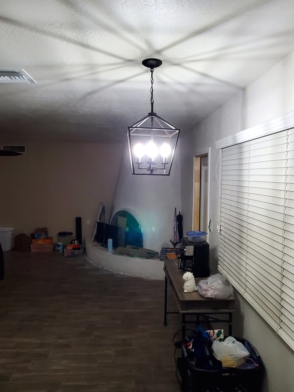

    Picture of new enterance light installed and matching light that will be over the breakfast table after furniture is moved back in. I had to add a box for the entrance light since the old light was apparently just screwed into the drywall. Updated hall bathroom picture with mirrors and towel bars installed.

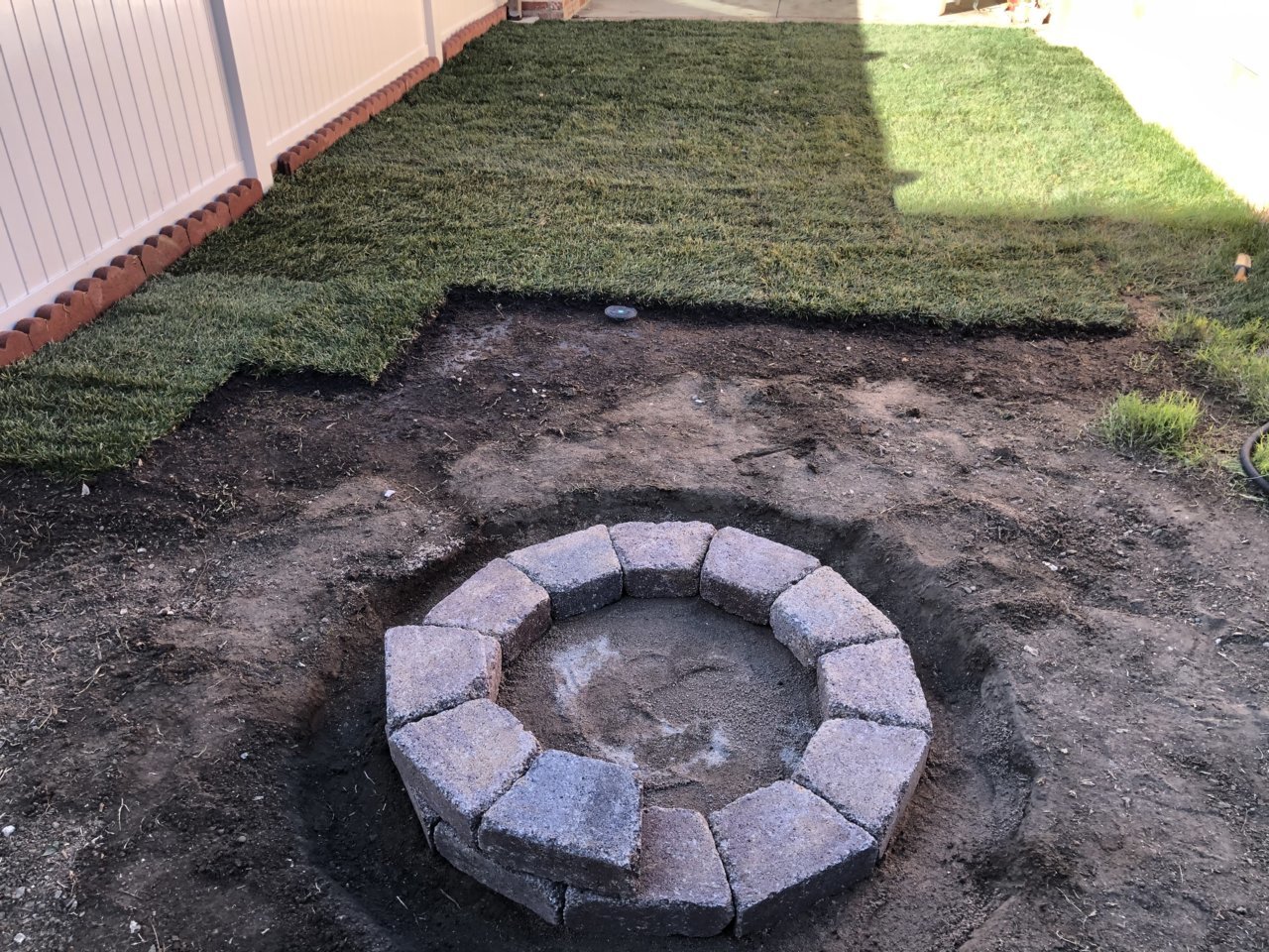

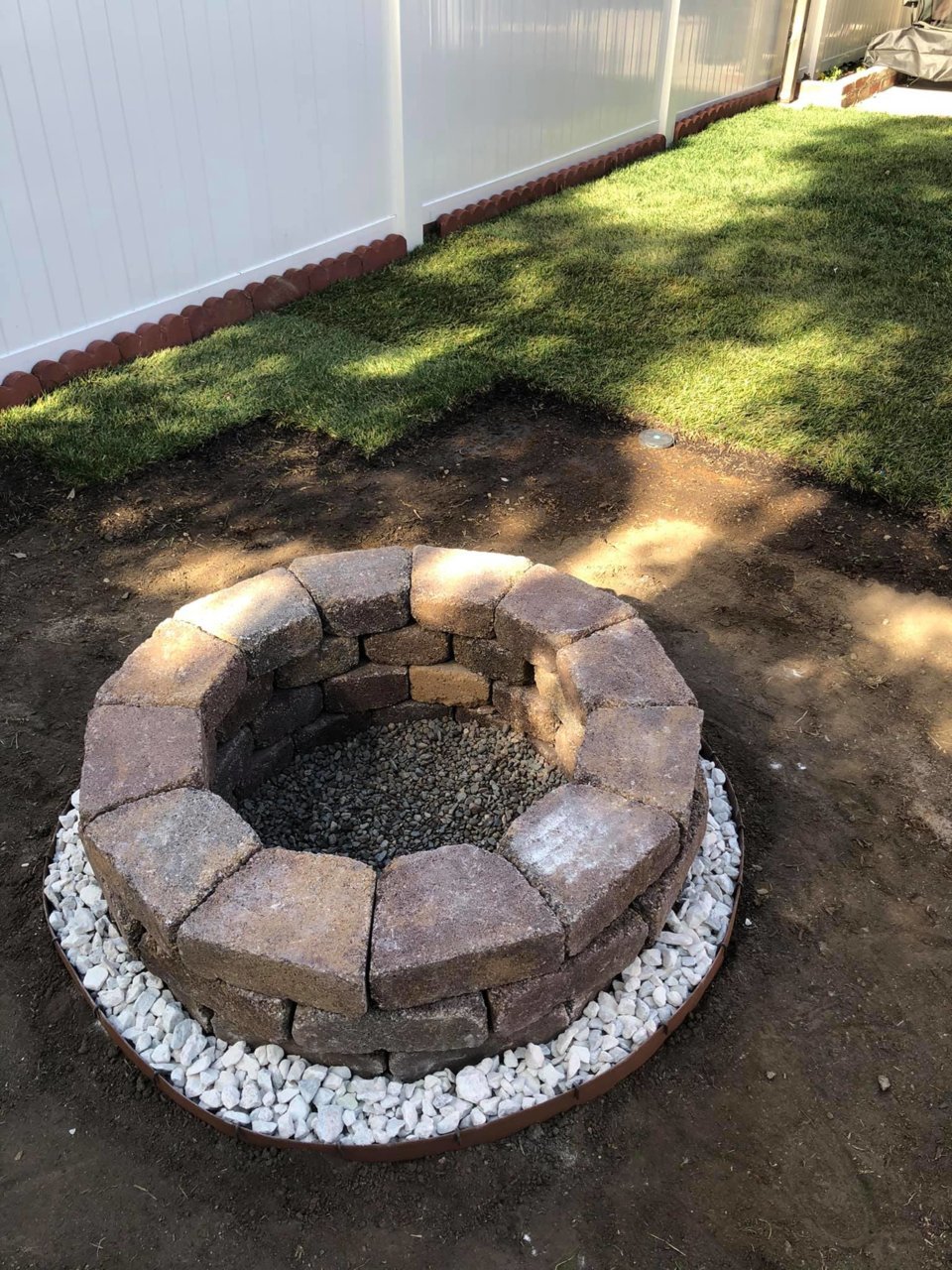

    Finished the pit today. A few more rolls of sod to match it up with the sod I put in last year, then I'll till the yard and seed it.
