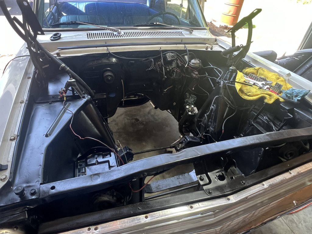

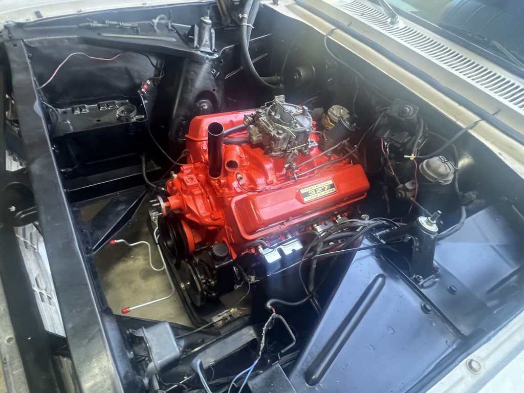

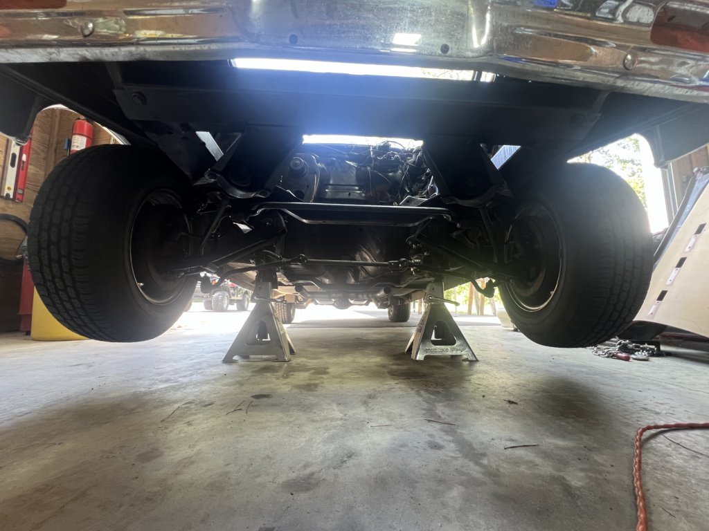

    Friday afternoon and Saturday was spent working on my inherited Nova. I did a rattle can detail of the engine compartment. Mind you, this is not a restoration. This car is a driver and a restoration may lower value, as that can hide problems. This car is solid front to back with just little surface rust here and there. I wanted to dress it up a little for the new drive train we are putting in her. I then sprayed the front under carriage to be more uniform in color. Saturday was quite challenging to get the motor and transmission stabbed in. Passenger side tie rod outer end had to come out along with the passenger side center drag link pinion mount to get the Moroso rear sump oil pan down into the hole and remount them into the channel cutout of the oil pan. Look up Chevy II oil pan and you can understand what I am talking about. The motor and transmission are in place and all bolted in. We need to get the exhaust manifolds cleaned and ceramic coated, fuel line bent into shape, radiator installed with the metal finger guard mount fabricated and some other odds and ends done before firing the motor back up again. Thanks for looking !
