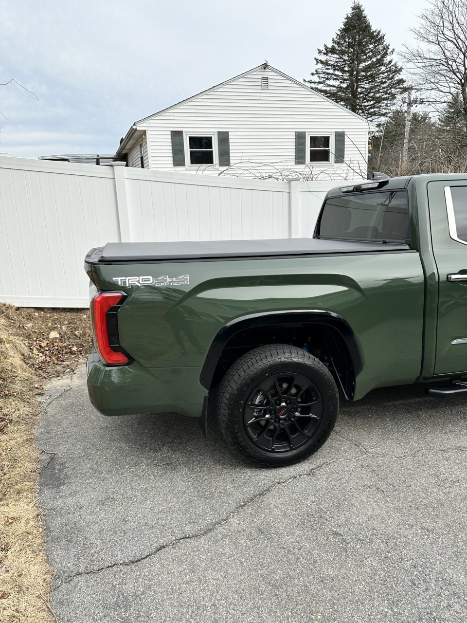

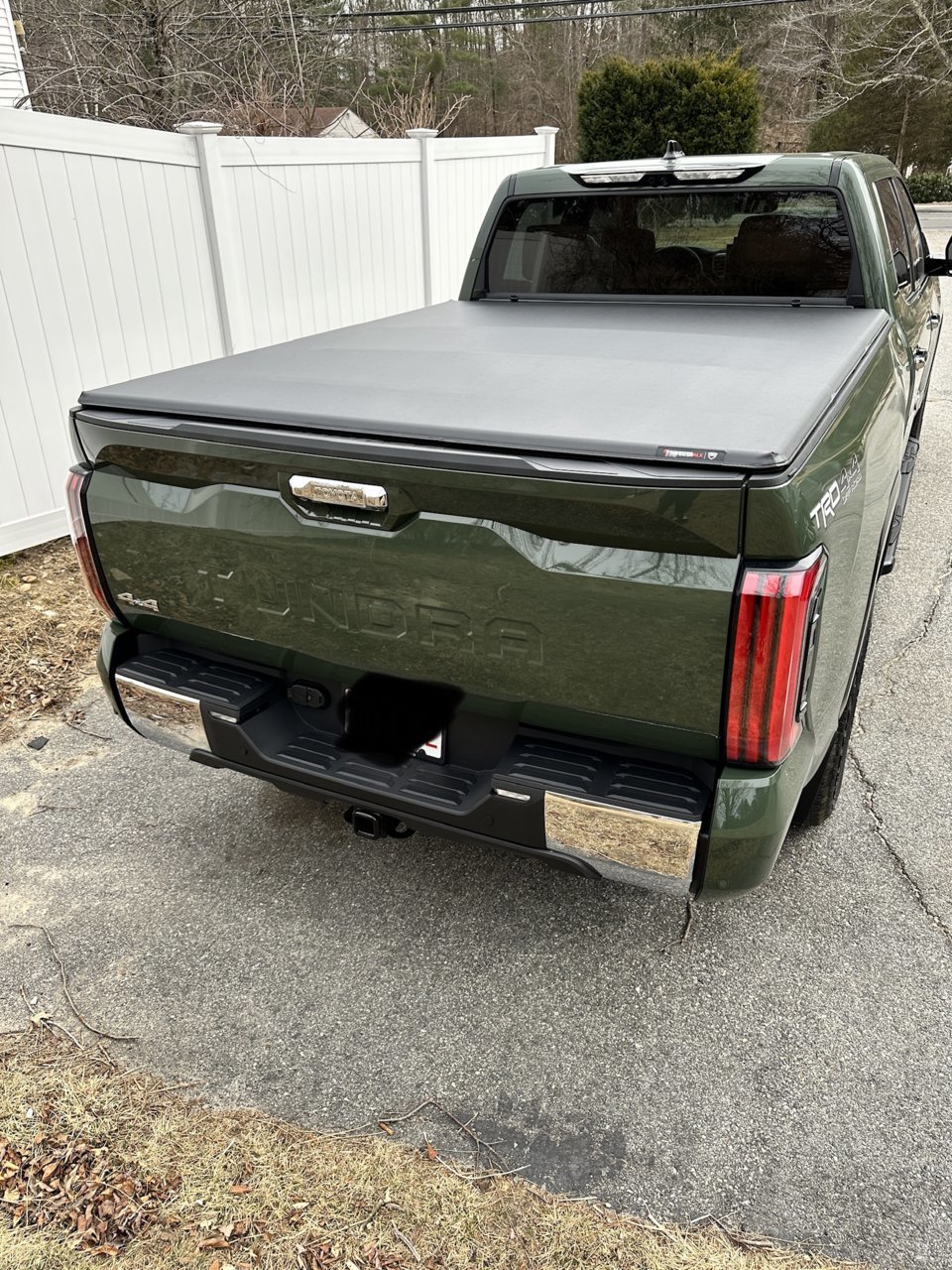

    Installed Extang ALX tonneau cover. Shameless plug : if anyone is looking for one for 5’5” bed. I have the same one for 22-23 tundra I need to get ride of. DM me if interested. Only a few weeks on the last truck.

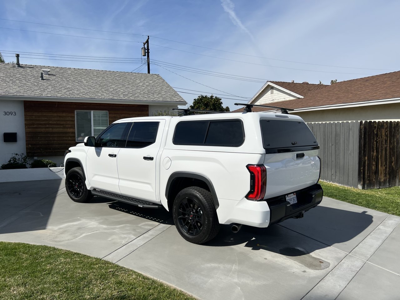

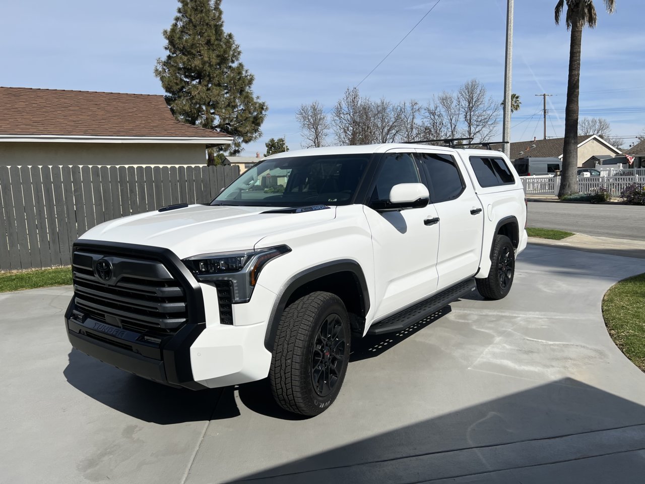

    First post - 2023 Tundra Limited Hybrid 4x4
    - De-Badged it
    - Chrome delete with vinyl wrap
    - Leer 100XR Cap with racks
    - GoRhino RB20s
    - Swapped the stock rims for TRD rims (got a steal on them from someone who bought a new Tundra and immediately took it to the shop to lift it)
    Planning for a small lift, 2” or so. It has the Air bag/Level system, so I’m trying to figure out the best move while retaining ride quality (if anyone has advice).

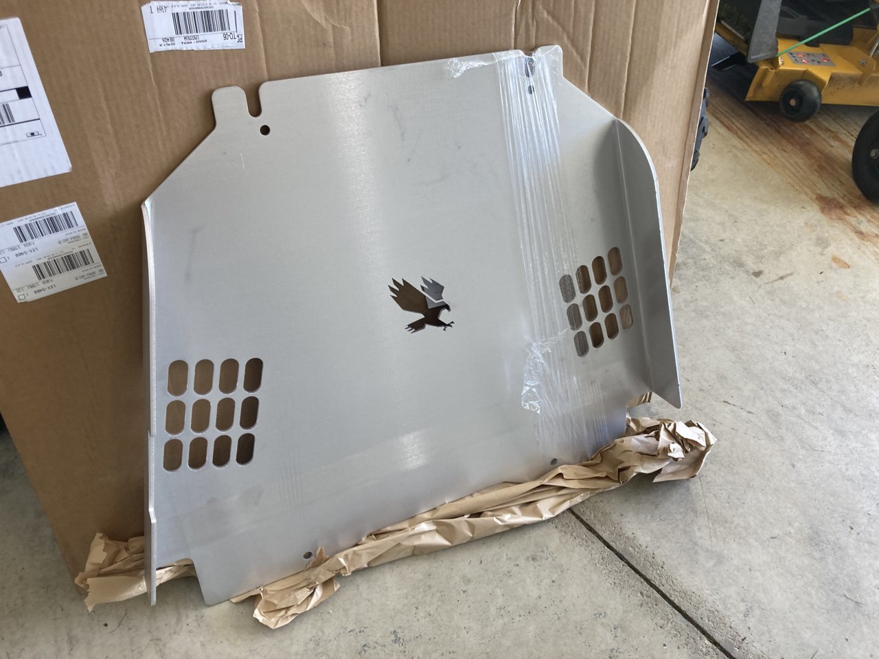

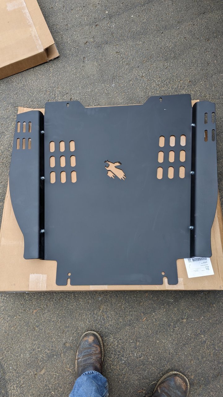

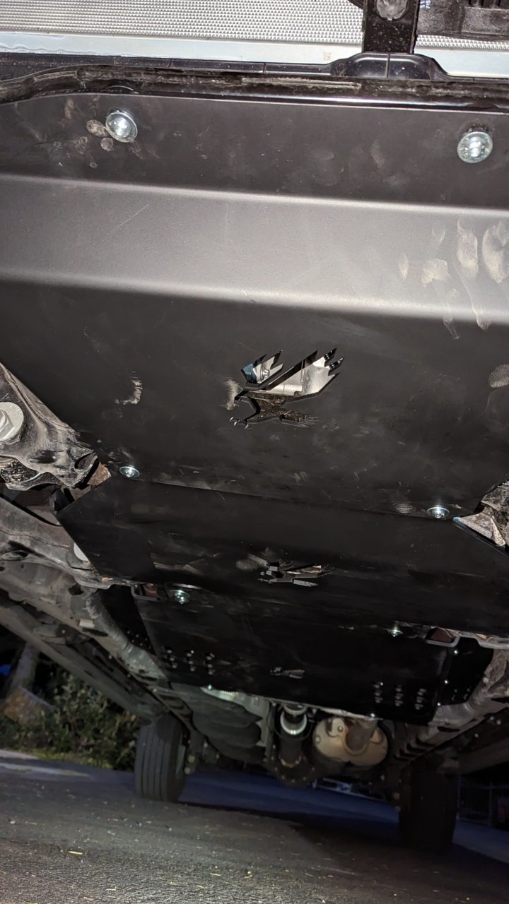

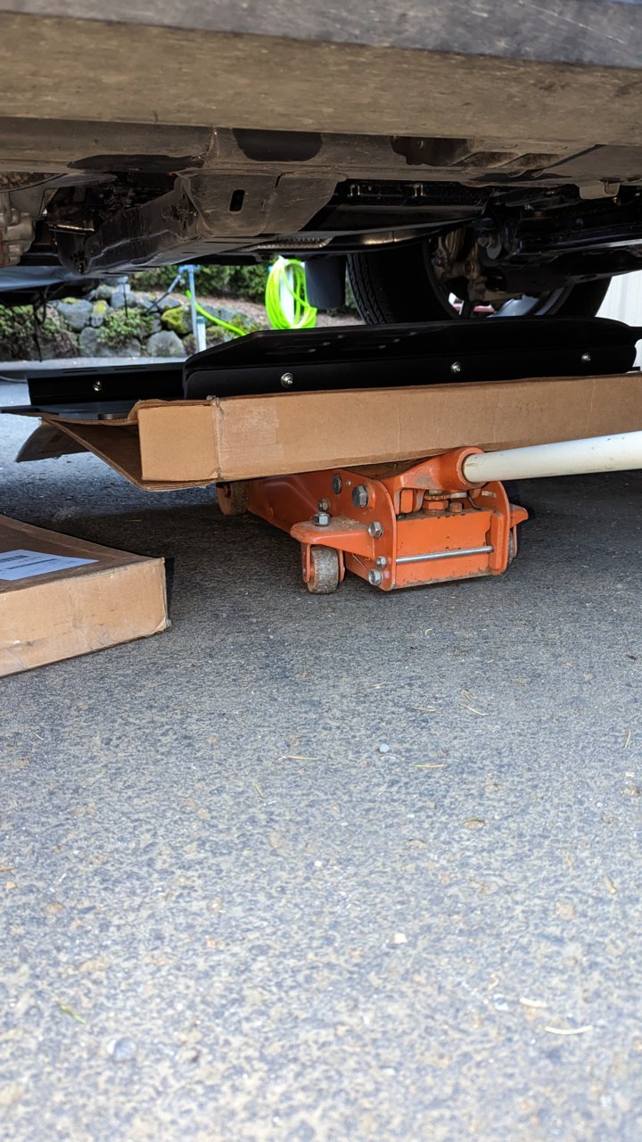

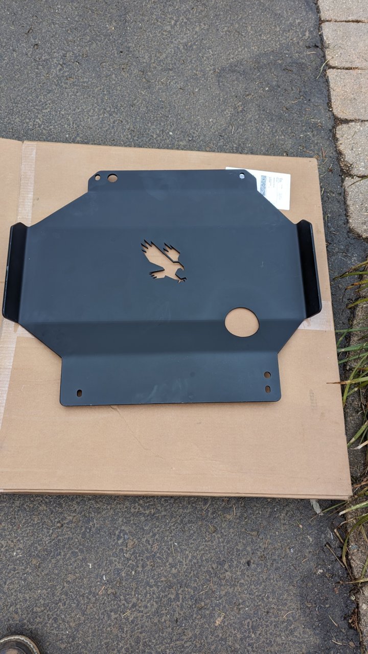

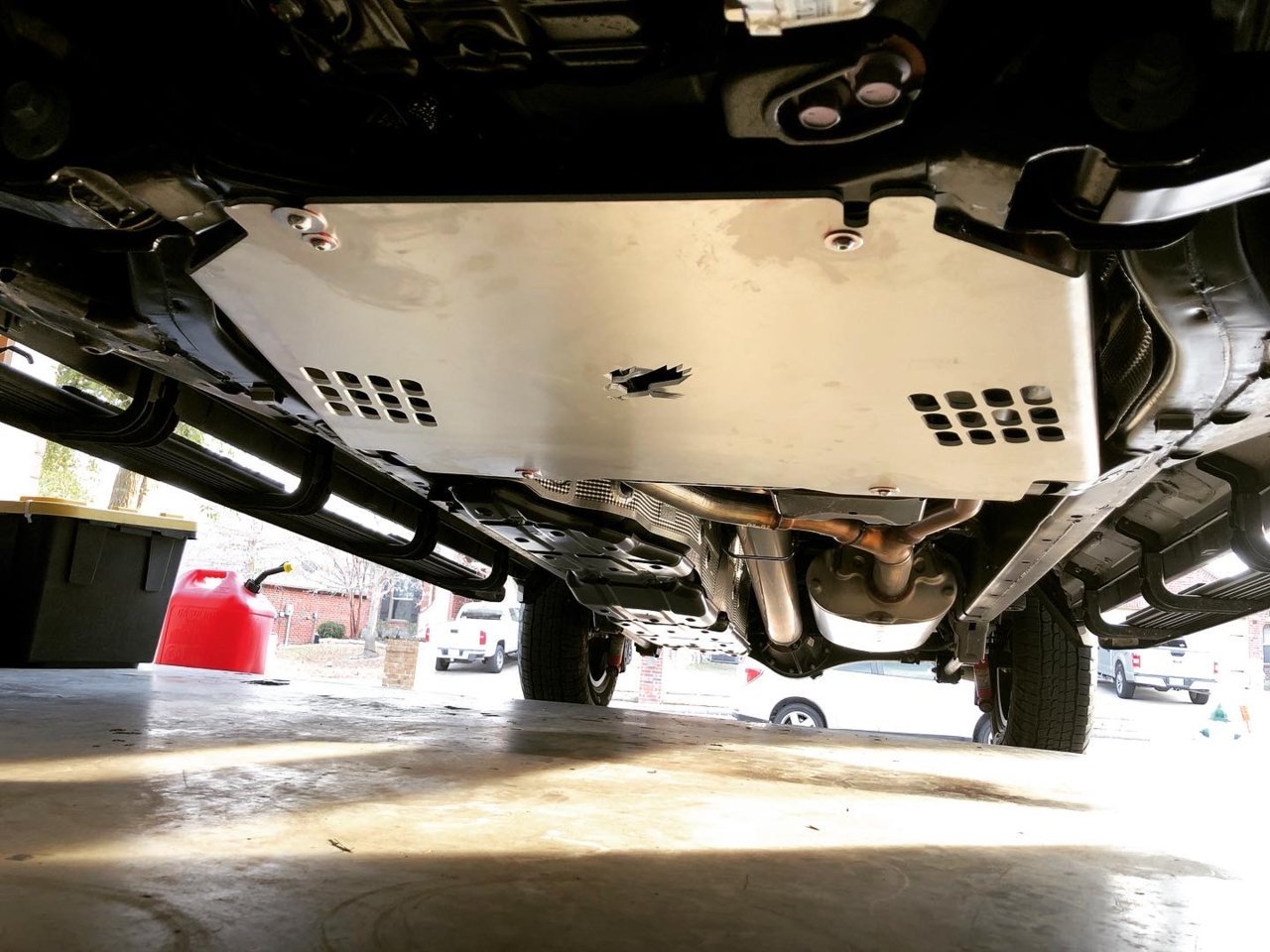

    Installed Talons Garage Engine Skid Plates and Cat Shield, today. I painted them black before installing. I highly recommend grinding all the sharp edges smooth before installing. Especially the drain plug access.A721B41A-2772-46FF-80F2-2F8F7ECE8313.jpg D22F4187-DF77-459A-B60D-DE1C939EB73C.jpg 474D360D-E873-49BD-82CC-0568FAC7786E.jpg 7BB40B60-68D8-4A6E-BDD1-C07B75FBD529.jpg

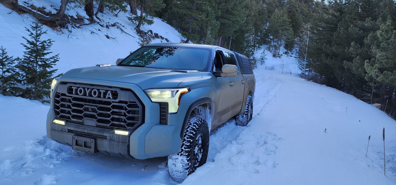

    So I accidentally overheated my transmission today... Ran the first 2 mins of this trail in 4hi... Oops. Obviously user error and should have been in 4L. I was too distracted messing with the mts modes. Think I should do adrain fill? It cooled. Right back to normal after a few mins

    maybe my ignorance is showing, but that seems crazy to me that the trans would overheat in 4hi on some snowy trails. Sorry that happened! Hopefully it was a fluke thing!

    Honestly I was surprised too. I'm used to my first gen Sequoia and I probably would have left it in 4hi. It could definitely use extra cooling or maybe mine is abnormal or low or something. The manual does warn it can overheat with excessive wheel spin though.

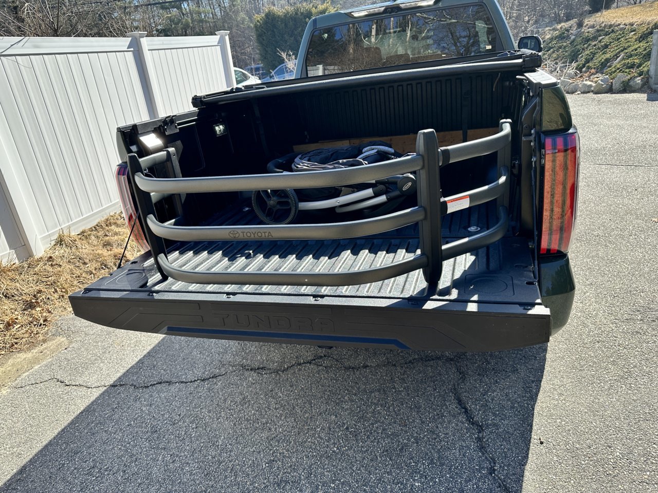

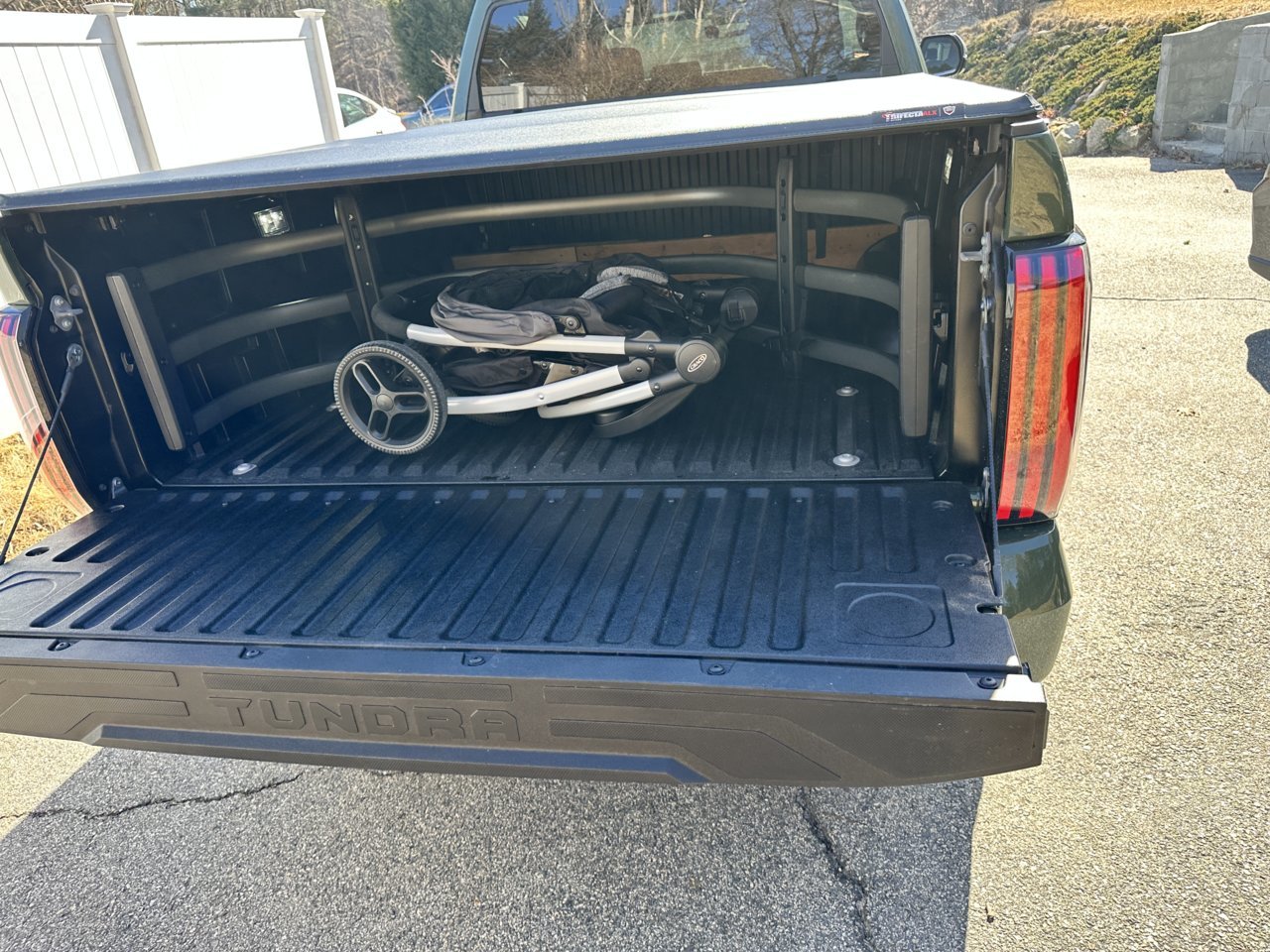

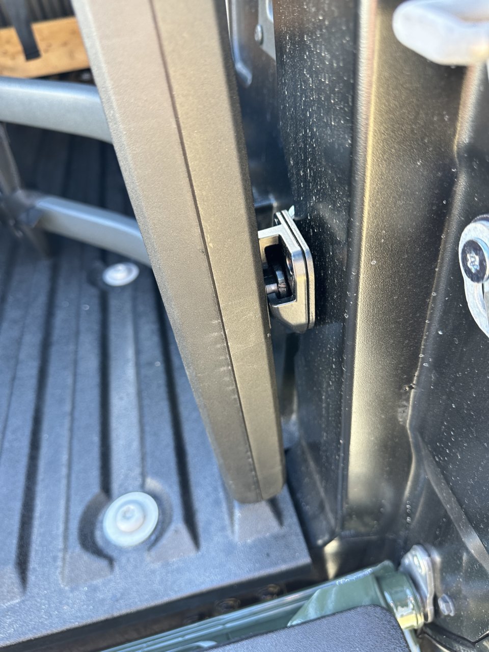

    Installed the oem bed extender. Took 5 minutes and makes a huge difference. I bought it mainly for the stroller and grocery runs etc.

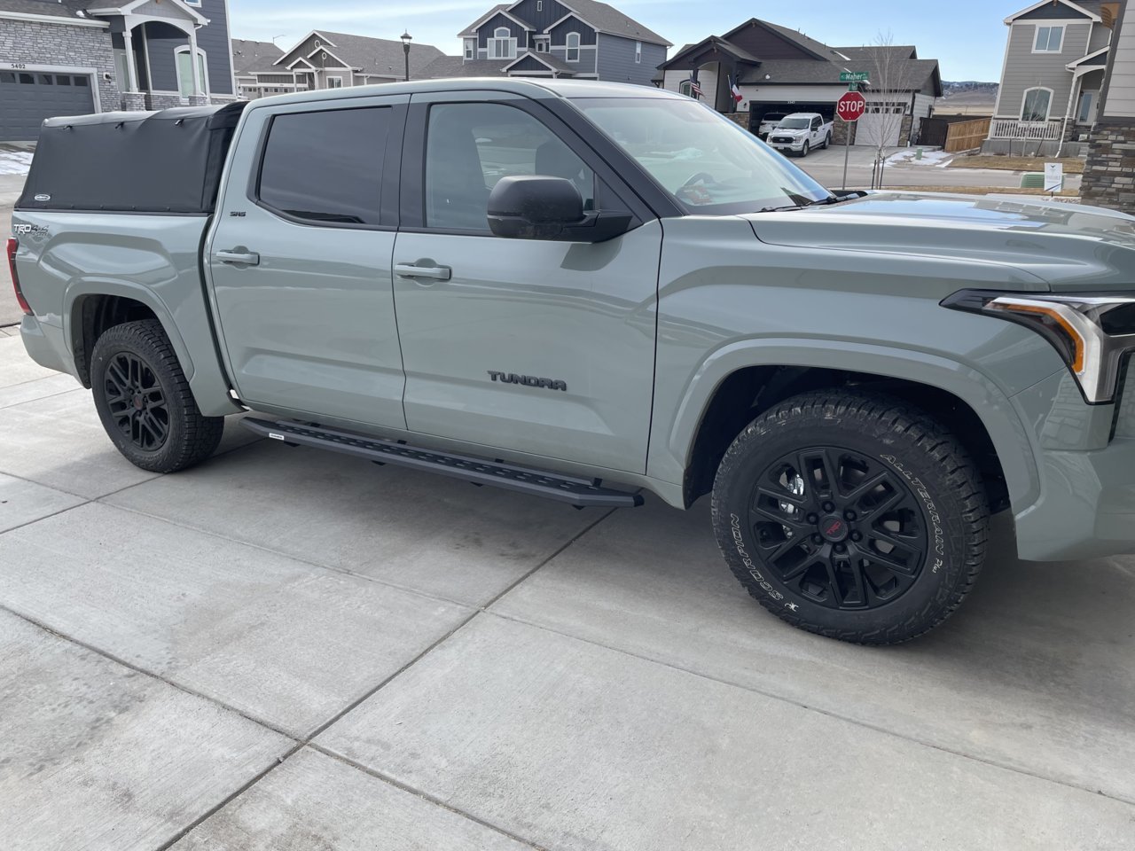

    RB20 slims and Softopper

    Talon’s Garage Cat Shield was the first thing I got and installed, lol

    Was it difficult installing the engine skid plates? The instructions on their website aren’t great (visually)

    TRD Air Filters, Front door windows tinted to match the rears. Wheel locks, Talons Garage cat shield, Tyger Automotive soft tonneau cover, WeatherTech floor mats with Tuff Skinz Custom Emblem kit, Toyota OEM Emblem Black Out kit. AVS vent covers on all four doors, Red Tundra letters on front bumper & TRD highlighted in Red on front grille. Tailgate Tundra Letters in Black.
    I bought my Talons Garage plate before my Tundra arrived.

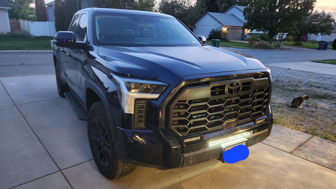

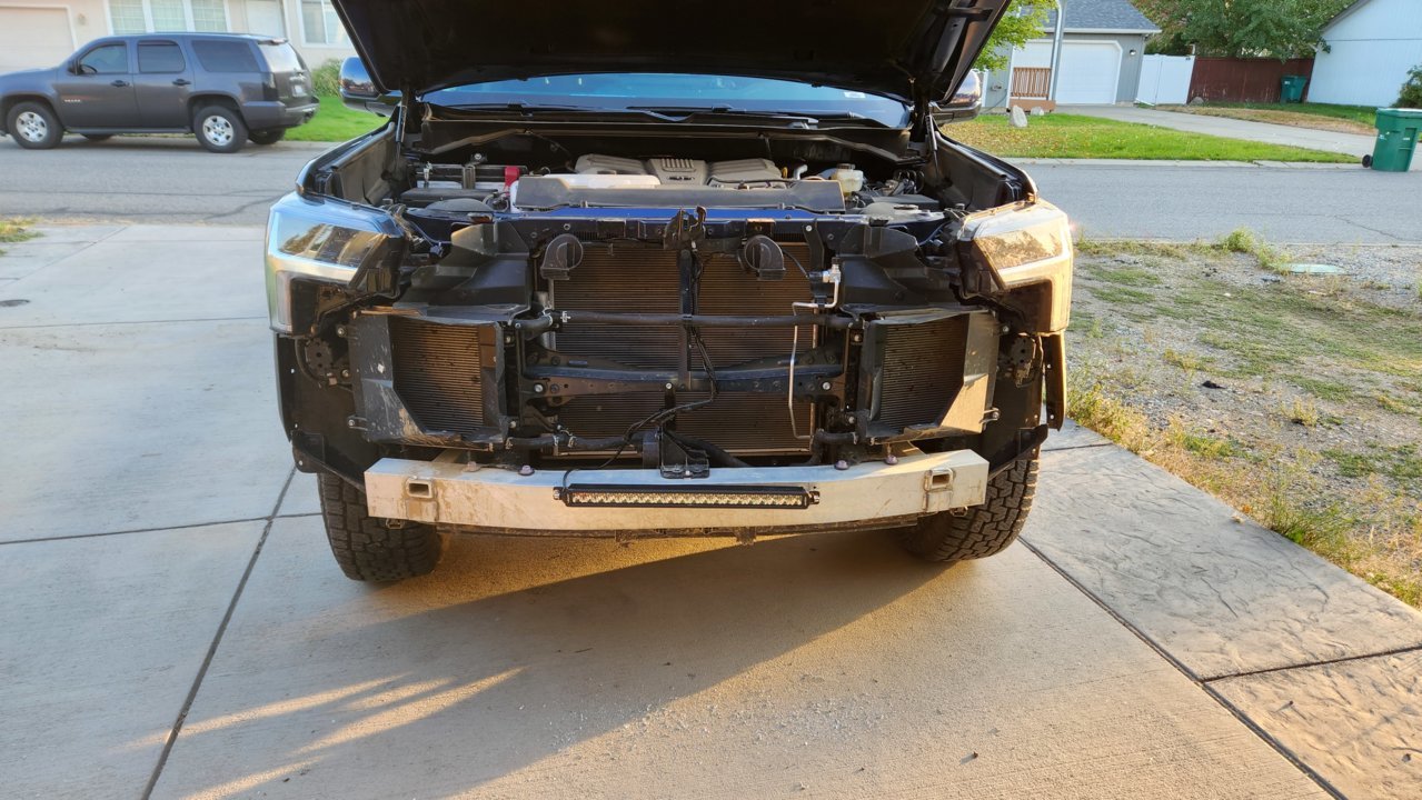

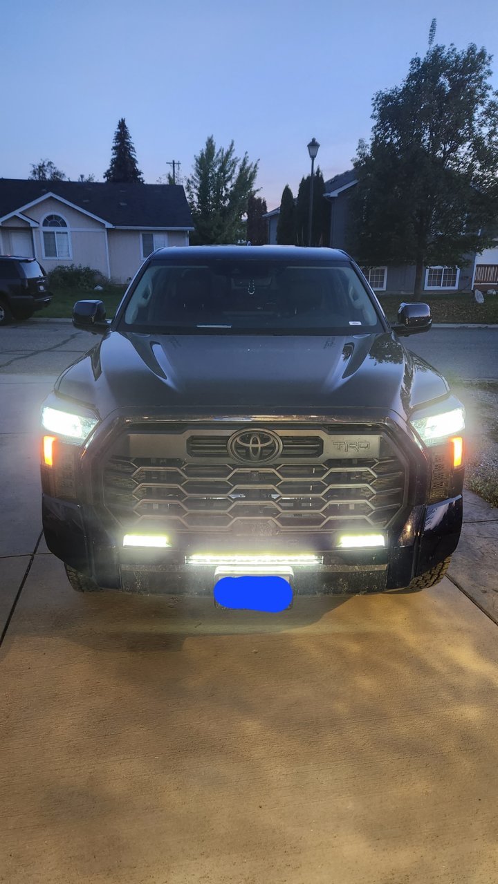

    I used a 22" Lasfit light bar I got for $100 on mine. Bolted right to the crash bar. Outputs TONS of light and is super subtle looking hidden behind the bumper

    There are no instructions for the engine plates, only the cat shield. That said, it wasn’t too hard to figure out. The engine plates come with four 1/4” spacers. After installing the front plate I figured out the spacers go in the very front. Then with a little logic, I figured out that the three plates go on like shingles on a roof. The second one tucks under the first and the cat shield tucks under the second. The cat shield instructions tell you where all the shield screws go. The middle shield uses 3 of the same holes, which leaves 4 bolt holes to figure out. So to answer you question it was not difficult too install the engine skid plate. I did email Talons and let them know they had the wrong instructions linked the 3rd Gen.
