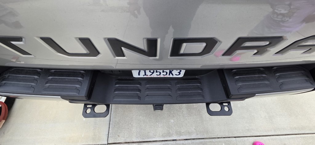

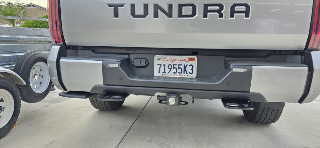

    Installed Amazon rear recovery points

    ^^Nice!^^ Finish: paint or powdercoat? Seem decent?

    Powder. They are STOUT for sure. Wouldn't worry about using them at all. 4 bolt install, welded where it should be and gussetted accordingly.

    Are they a knock off ny top?

    They look like a set I have from Amazon. Mounts the same as the nytop. Gusseted differently. Not quite a knockoff, but pretty similar.

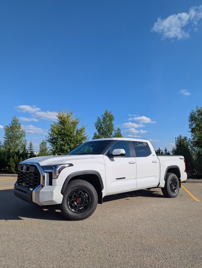

    2025 SR5 trd offroad with Brand new BBS wheels from a brand new 2025 TRD pro

    Nice. My 2023 is getting the exact same thing this Tuesday.

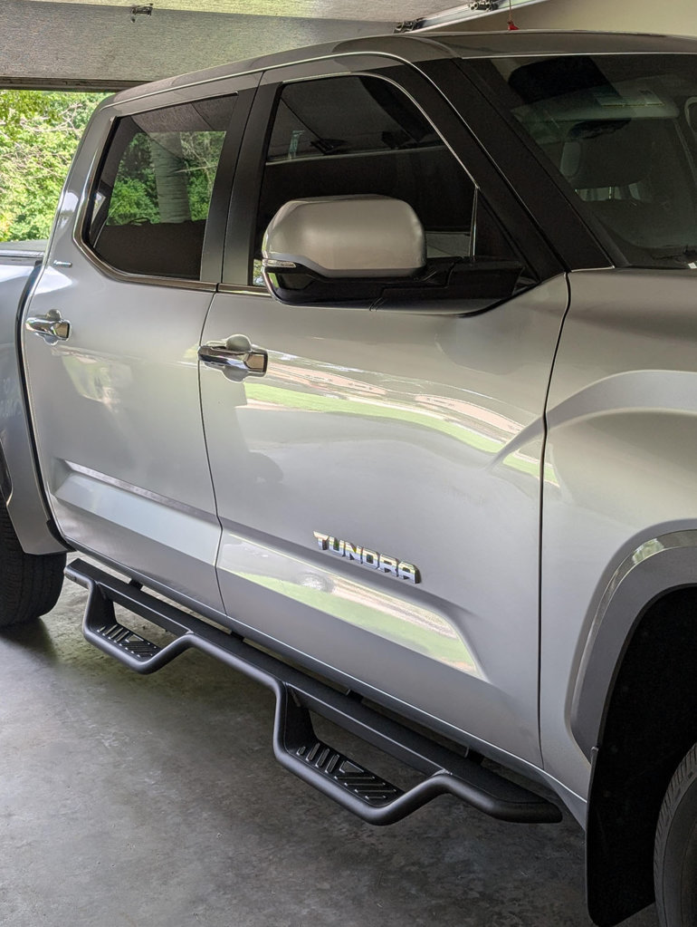

    Westin Outlaw drop steps. Parts weren't labeled correctly, and instructions were wrong. Made it minor monkey to install them.
    Footing surface is 10.5 inches off the ground, 4 inches lower than the standard high boy units I had on there before. They stick out a couple inches more, which makes them actually useful as a step.

    Those look nicer than my oem steps! Hope Kong did it take for them to ship to you?

    Amazon. 2 days.

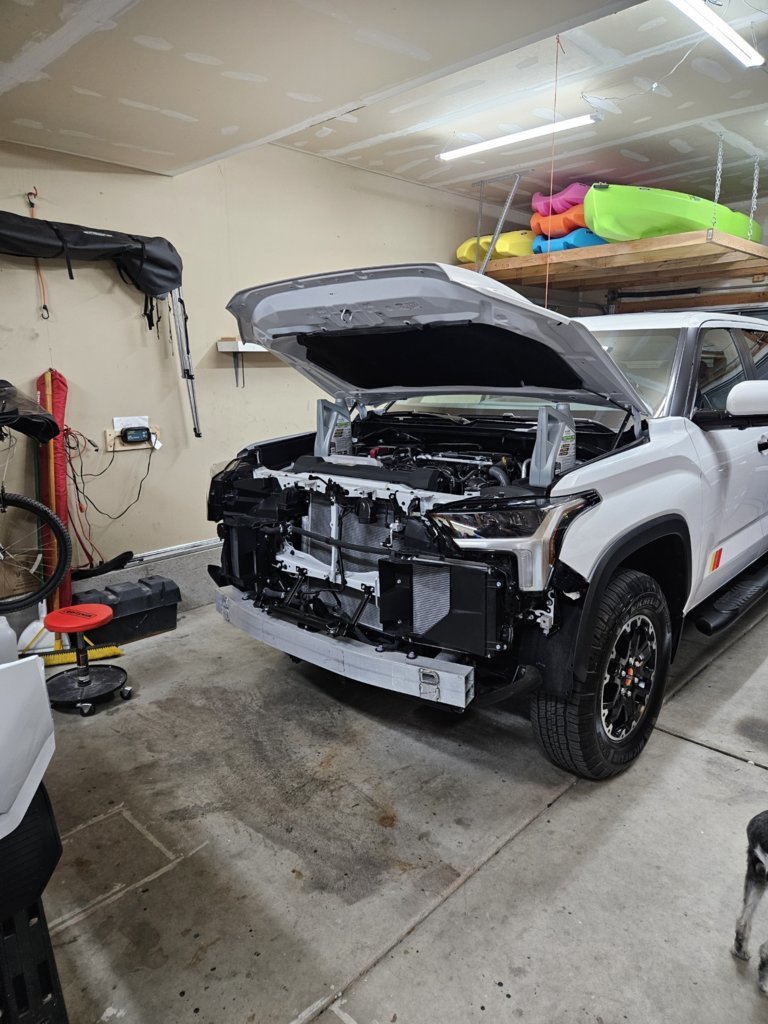

    Looks great, how long did it take to remove factory bumper and install new bumper - also did you run into any issues?

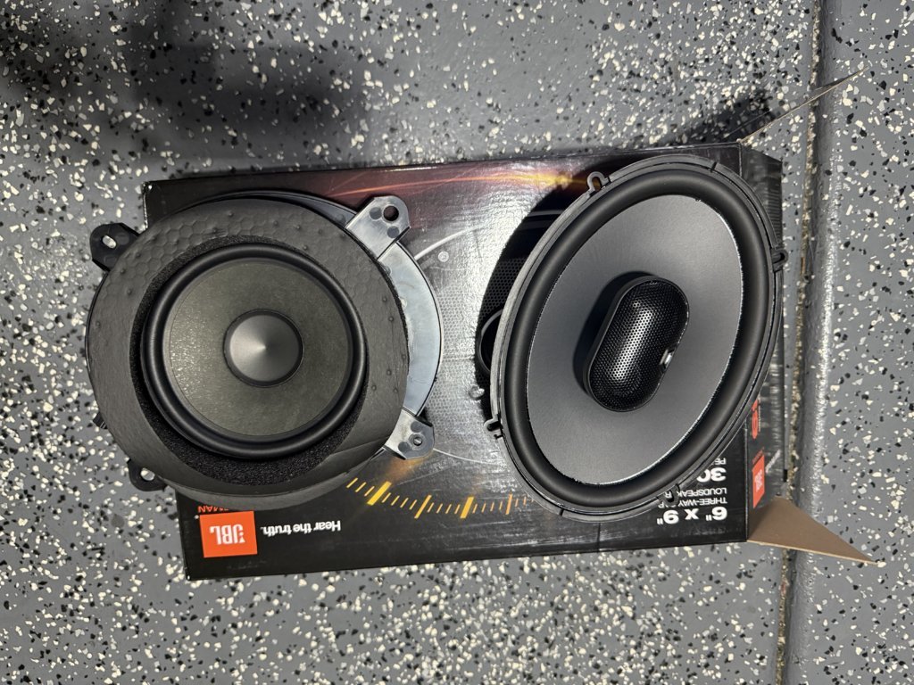

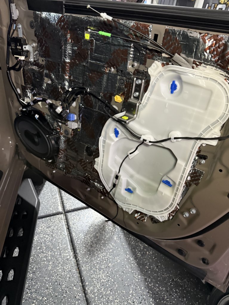

    Installed JBL 6x9s in the front door. Much better than the Hertz 6.5s I had in there. They handle the Beat Sonic amplification (~60% gain) better than the 6.5s. 6.5s were punchy but couldn't handle some lower frequencies (obviously due to the type/size of speaker). 6x9s are better suited for my preference.

    do the 6x9's fit without an adapter?

    depends on the mounting depth. These JBL GTO939s are pretty tall and look like they just cleared the window rolled all the way down. The one inch on the adapter definitely made it work.
