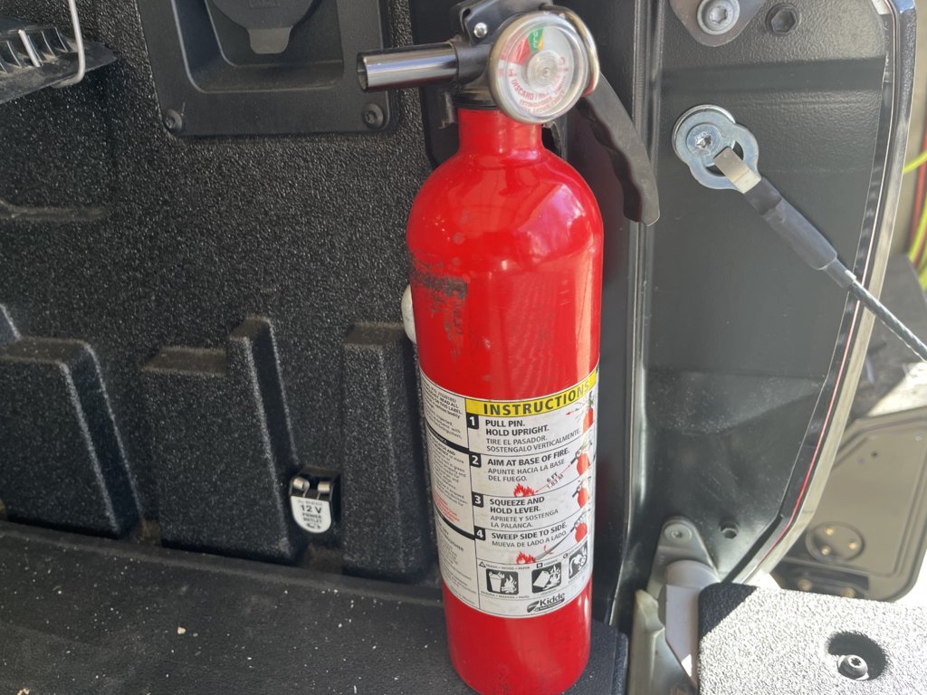

    There are those here who have done this more snazzily than I did, but this is the first mod I did to my Platinum. Ran a 12 gauge wire from the pass side fuse panel, snuck a NAPA 12 V outlet in a bed slot for protection. On my truck one could just lay on the floor under the truck and see right up under there to wire it up. (Fire extinguisher for scale!?!) (Actually the only pic of the outlet I had)IMG_6991.jpg

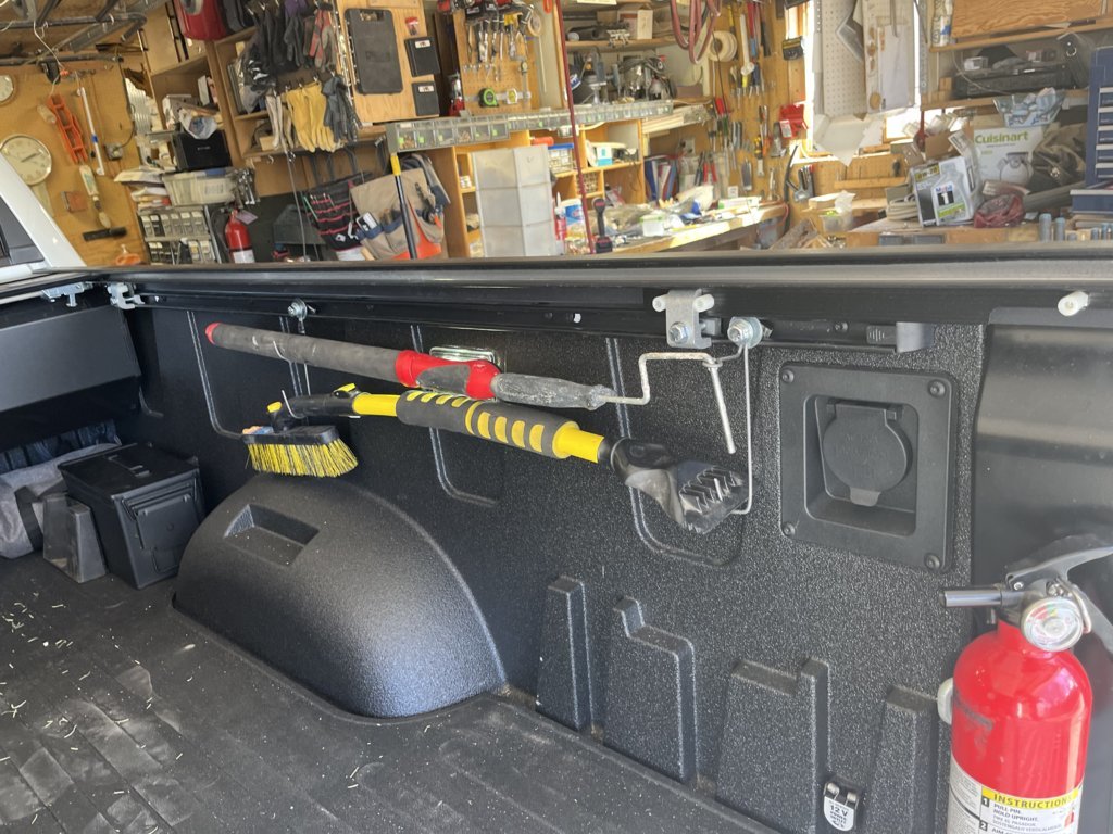

    I upgraded my bed storage system from the amateurish wire method I started with. Amazon tool holders and aluminum brackets machined from Home Depot stock.
    Before:
    After:
    (The paint tool is for pulling stuff from the front to the back without climbing in. Repurposed when I retired from commercial bus driving. Used it there to pull bags out of the luggage bays.

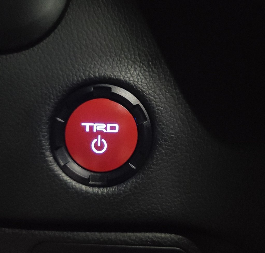

    Finally got around to installing my AJT oversized cupholders and an orange start button ring since I have some other orange bits inside my truck. No broken clips, didn’t have to disconnect any wiring. Life is good.

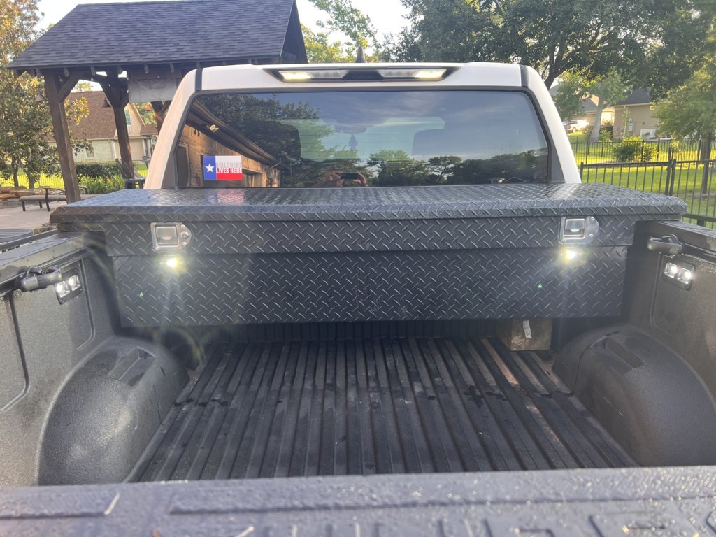

    I added some tool box lights today. Inside the tool box lid added LEDGlow 2pc white led lamps off of Amazon. I wired it from the Toyota accy bed light harness that was bundled under the bed. The kit offers a accy switch & magnetic door opening switch option, but I hard wired the lights to come on when the bed lights come on from door or tailgate opening. The mounting base has 3M tape and cut at a 45 degree angle so they give some bed lighting, but do a great job of illuminating the inside of the tool box.

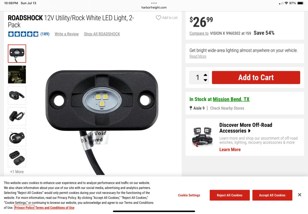

    Also added 2 bed lights just under the tool box latch. They’re from Harbor Freight and $29/pr. Really liked that they’re armored up a bit and the housing made of aluminum, & mounting on a rubber mount. Comes with a flat mount & curved for rollbars, I used the flat on the outside, and inside sandwiched the curved behind the locknuts as a spacer to prevent gear from snagging on bolts. I put all these lights on the same circuit. When you open a door the cab cargo light comes on, along with factory bed lights, new rear facing bed lights & tool box lid light. Makes the bed very usable at night.
    I thought it worked out pretty well!IMG_0600.jpg IMG_0601.jpg IMG_0603.jpg IMG_0605.jpg IMG_0608.jpg IMG_0612.png IMG_0611.png

    I’ve got mine in the box from AJT waiting for a good time to install. Looks good!

    Agreed.
    But reversed color order (red over yellow) is the way, even if it's technically wrong. :D
    Especially with the red "TRD".
    (See avatar pic)

    I went back and forth and decided to go with the technically correct order. I do like the look when reversed as well. I think it will look better once I do the Tufskinz raised matte black and red outline Tundra in the valance.

    Few daylight pics

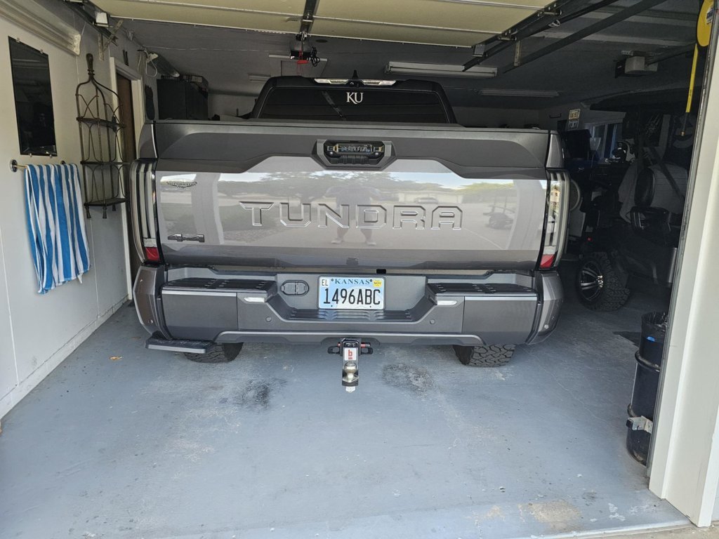

    Finally got my Form Lighting taillamps in. Went with smoked, and then blacked out the red "C" reflector on each side just to add a little touch and reduce the amount of red. Love the additional reverse light that these add, as well as the complete plug-and-play sequential animation.

    Looks good on the dark grey. Glad I went smoked as well. Took a while for me to adjust to it but happy with the purchase
