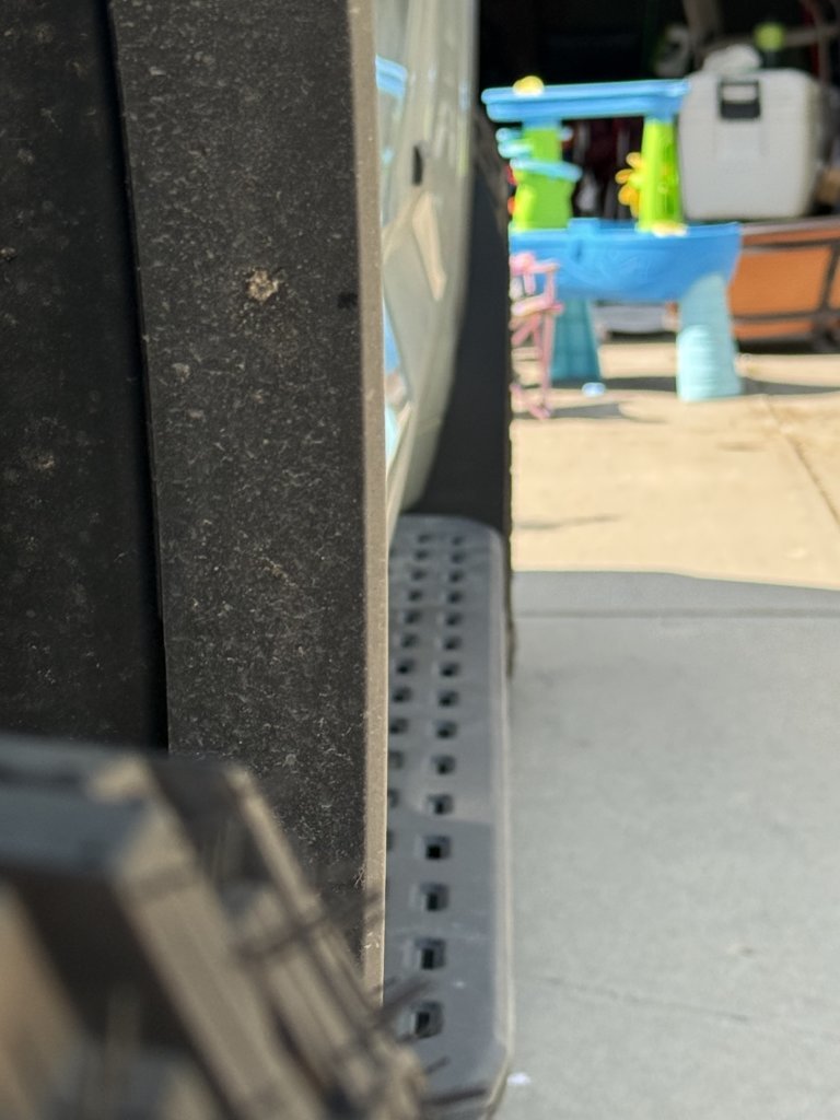

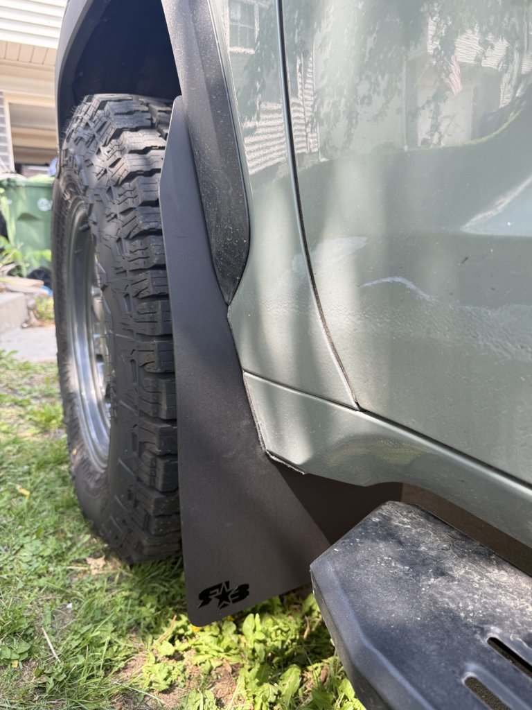

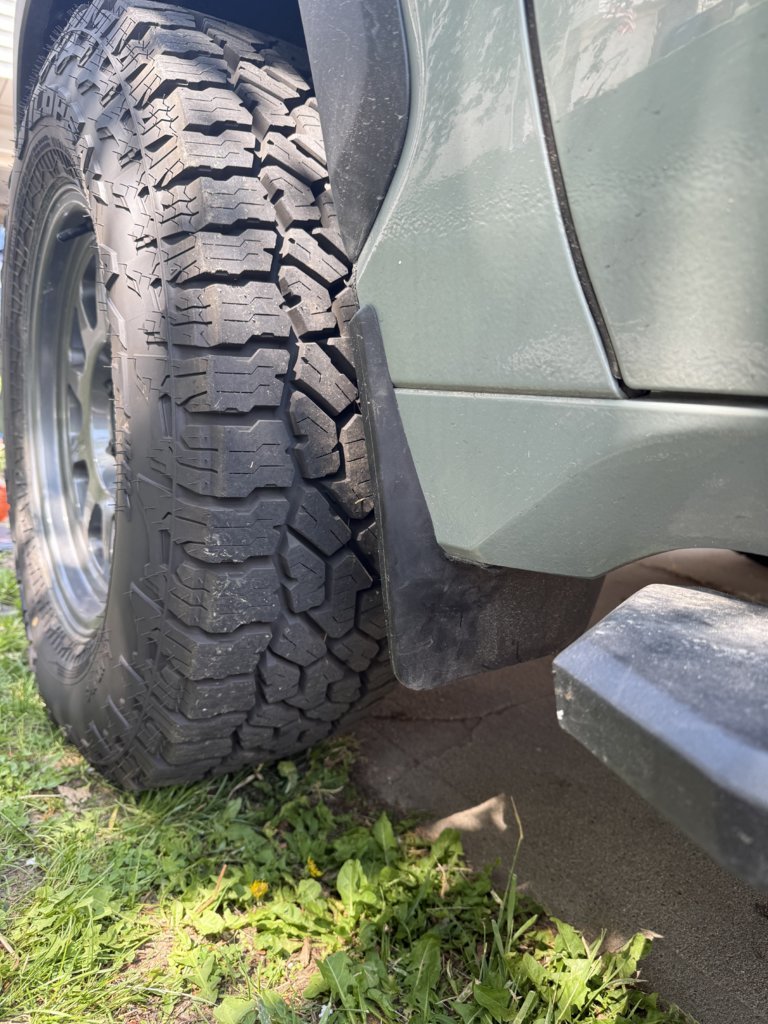

    I put some on 2 weeks ago, love them!

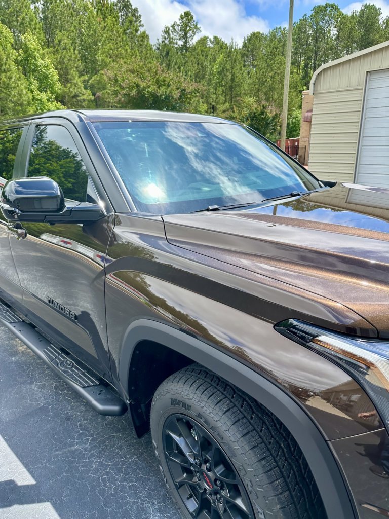

    Full ceramic tint. 15 on the windows and rear and 70 on the windshield. Suntek evolve. 3rd truck I’ve had this shop and same tint used. Been flawless everytime! Broke triple digits on the old girl, finally over 100 miles on the odo! Lol.

    Love the color!

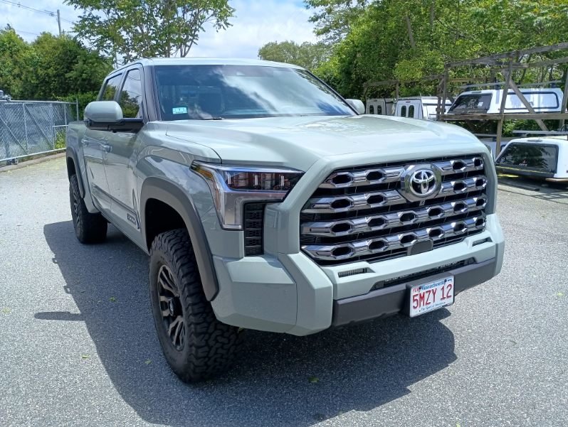

  7. May 29, 2025 at 5:35 AM
    Reubenski
    Reubenski New Member
    Jan 14, 2019
    #24474
    150
    2025 Limited CM, TRD Off-road package, 3" lift

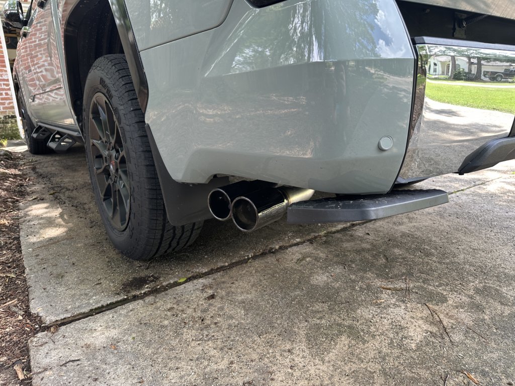

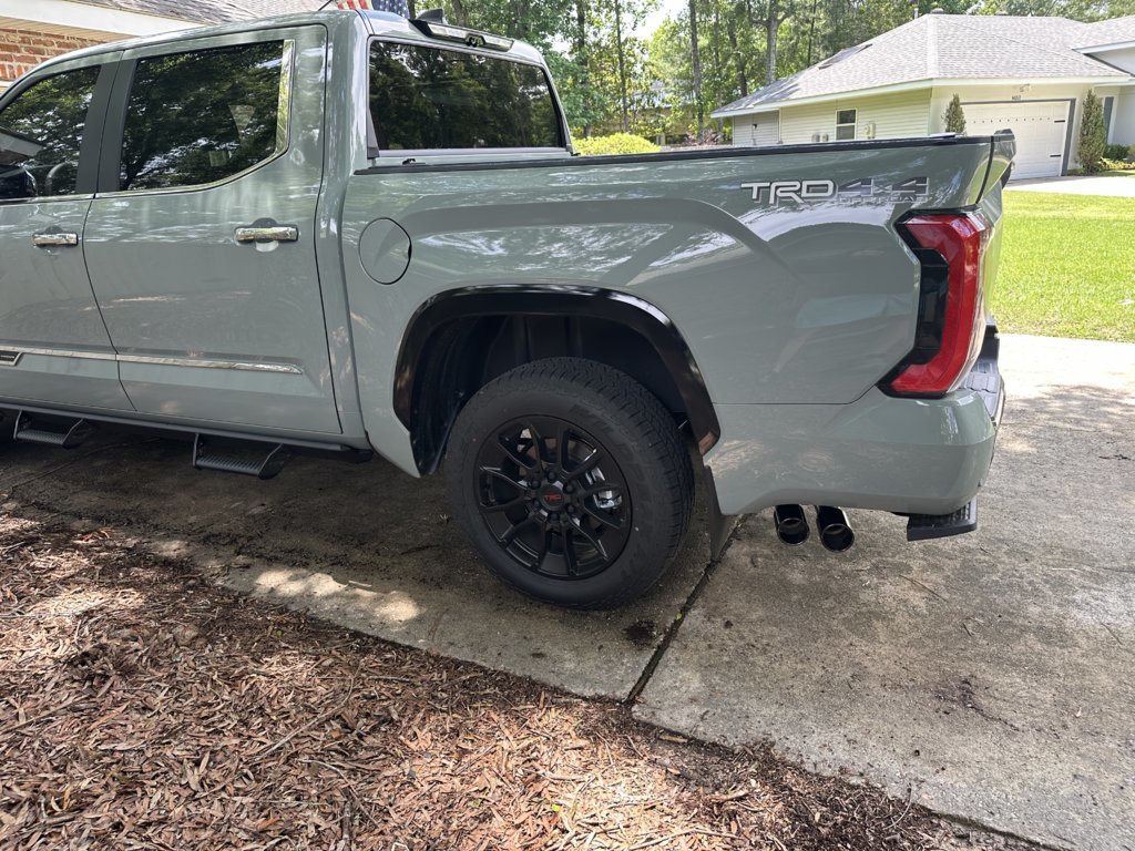

    Swapped on the TRD-Pro Tailpipe (PT226-34220-02) that I got during the recent Toyota parts sale. IMG_4379.jpg IMG_4380.jpg

    What size did you go with?
    Ive had mine sitting in the box since I got them a few weeks ago. Keep forgetting about them

    Regular, fit and look great for my setup.

    Was this just a straight swap or did you need to do anything additional for fitment?

    Straight swap, the tail pipe comes with a new gasket and nuts.
    Super easy swap, pop off the two rubber exhaust hangers, unbolt the clamp at the junction. Drop the spare tire and jack up the truck by the hitch to increase the gap between frame and axle to get the exhaust out and in. New exhaust bolts right in and uses same hangers.

    Powerswitch mount?

    Use the screws they supplied? Didn't realize they used screws and couldnt find my 90degree screwdriver, so it waits a few days

    Any sound difference at highway speeds compared to the original?

    Haven’t been on the highway yet; not expecting much difference and honestly don’t know that I’d be able to identify a mild change at those speeds

    Nope. Mild change outside, nearly imperceptible inside.

    I did....if you have a ratch, socket and short screw tip it works better. After I put them on, I've sprayed them a couple times with black spray paint so it looks much better.

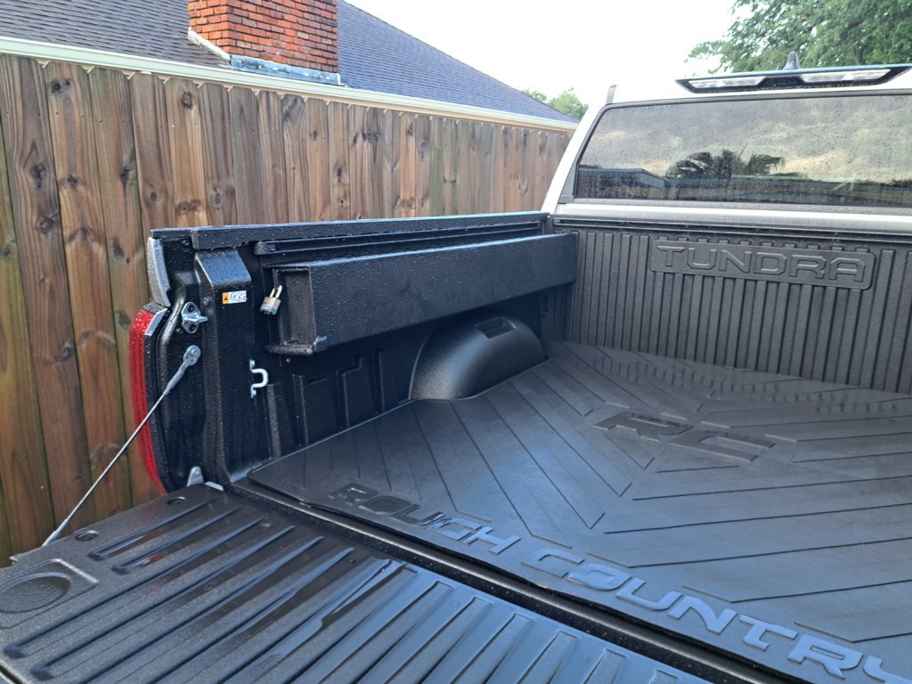

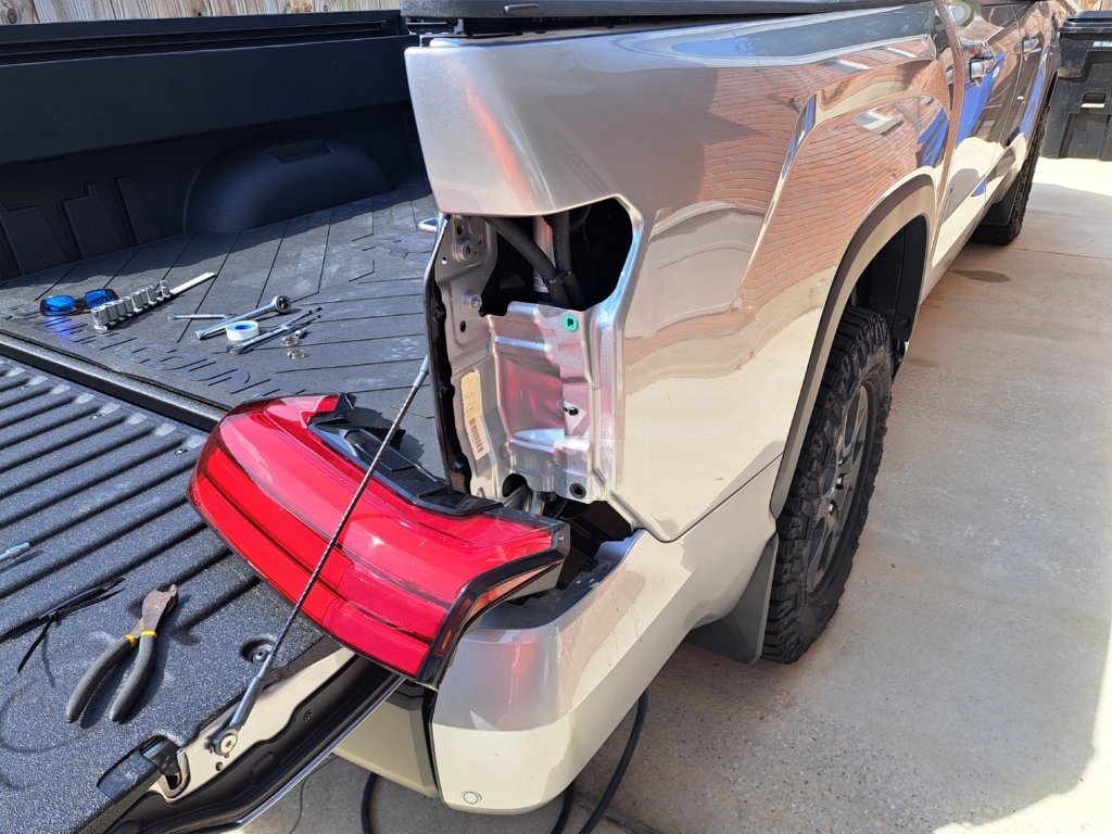

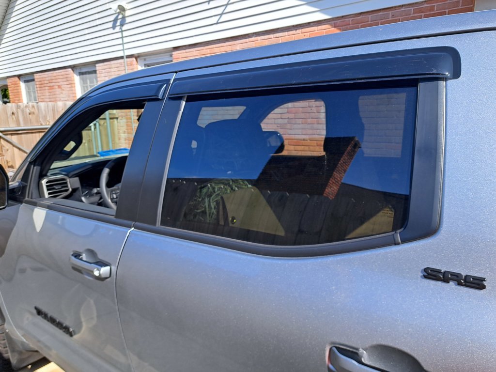

  22. May 30, 2025 at 1:27 PM
    Over the LINE
    Over the LINE New Member
    May 1, 2016
    #3273
    692
    New Orleans
    2016 Limited CM 4x4 2025 SR5 CM 4 x 4

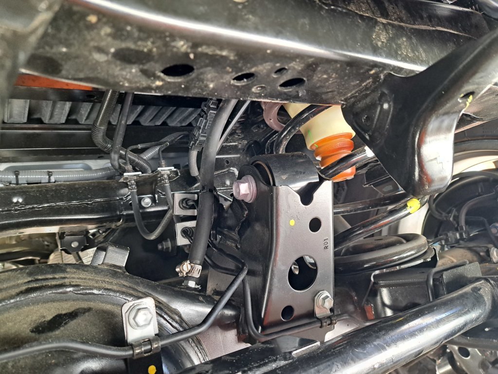

    Installed "Tool" box, relocated rear differential vent and installed AVS window vents.20250529_075445.jpg 20250530_105725.jpg 20250530_100903.jpg 20250530_091517.jpg
