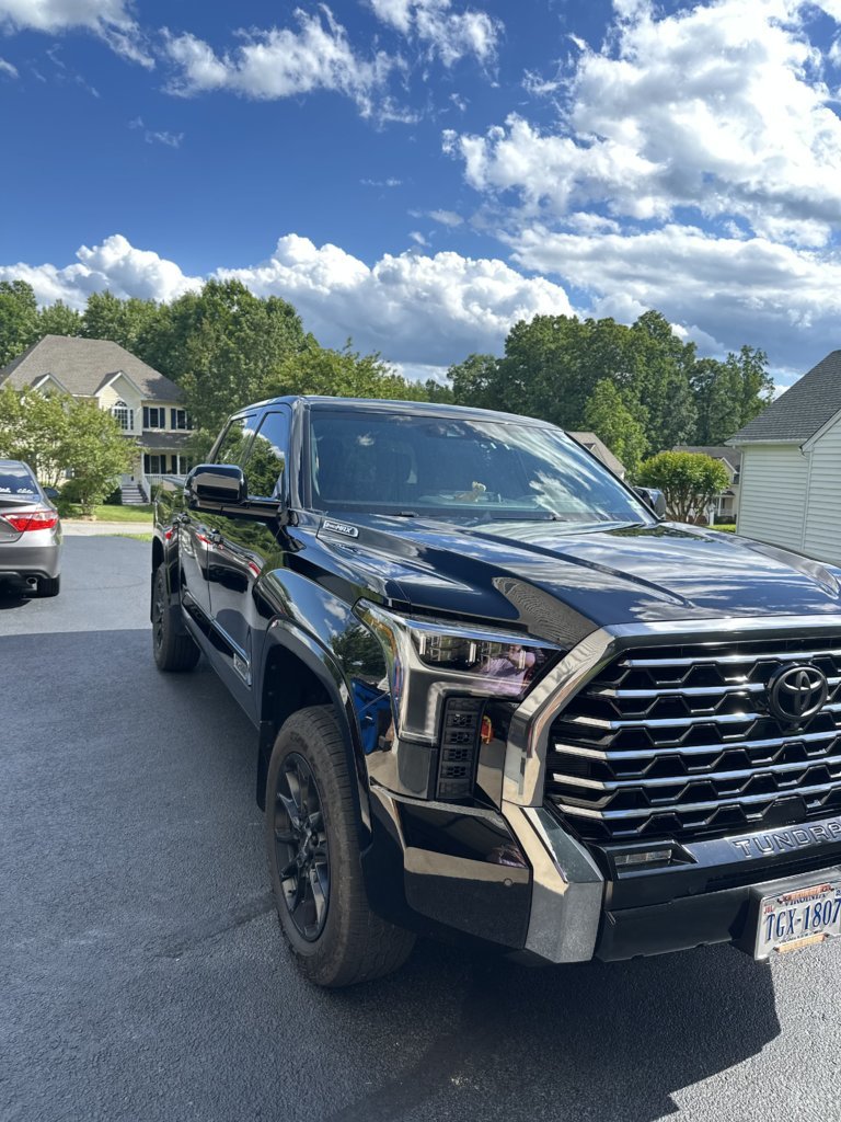

    Black is definitely the best Tundra color. Looks great. What front grill is that?? It’s close to my Platinum but slightly different?

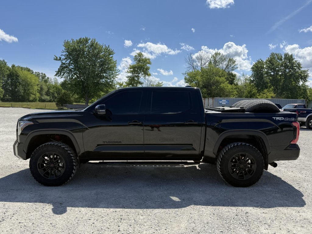

    3” TRD Suspension Lift
    35x11.50 Nitto Trail Grapplers
    gorhino RB20 slims

    It’s the factory grill for the 2024 1794 Limited Edition, I do believe it’s based on the Platinum grill.

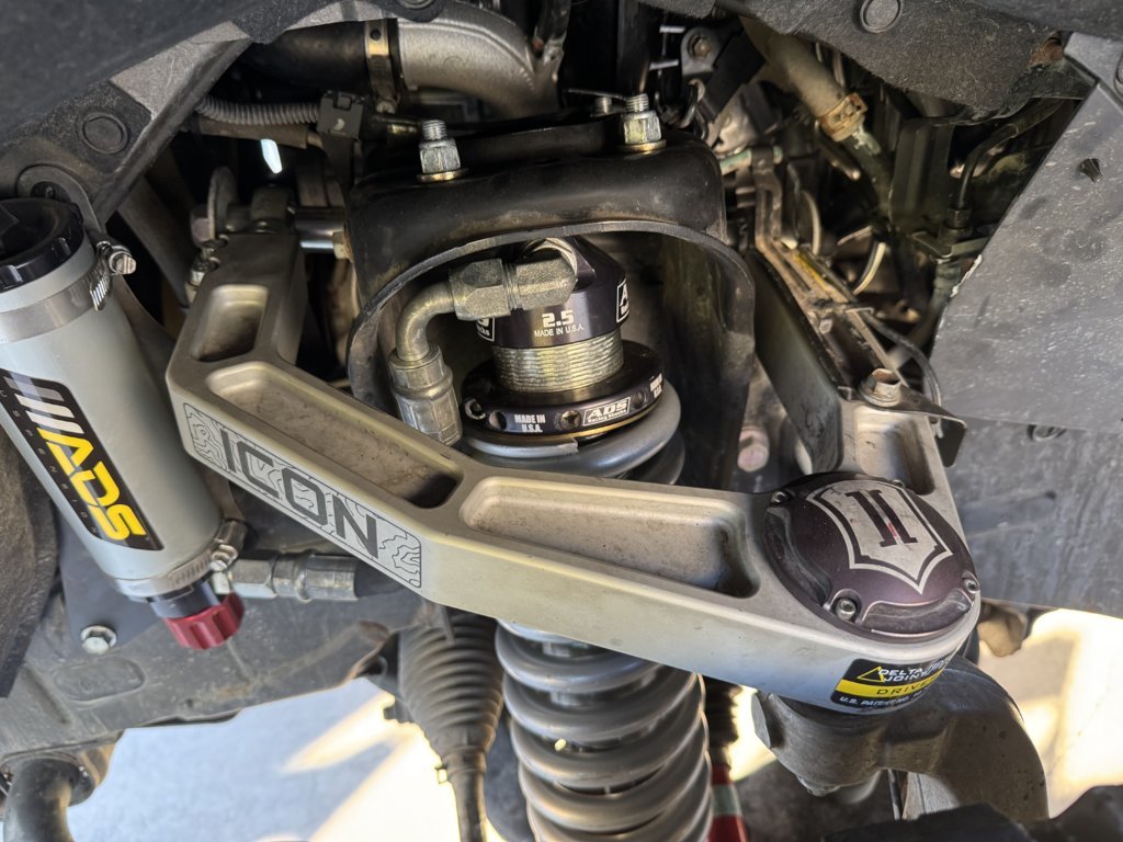

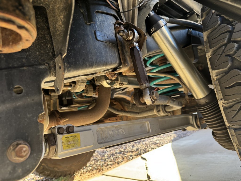

    Got a huge suspension upgrade to my truck today:
    • ADS 2.5 adjustable shocks
    • Dobinson springs
    • Icon billet upper control arms
    • Icon billet upper/lower links and panhard bar
    • Drkdss track bar correction kit
    • Durobumps
    • Red TRD axles

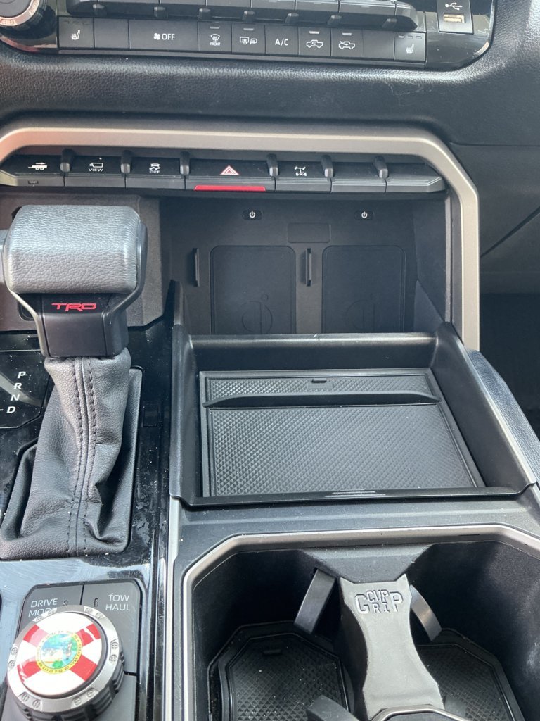

    What’s wrong with stock?
    Got tired of all the wires when charging. A bit pricey. Spent the money. No regrets.

    The suspension upgrade is clearly the star here, but WOW that's a really cool shot of the lighting!

    How’s the ADS suspension I have those vs the Kings, any initial impressions?

    So far they’ve been riding really nice but I will need to take them off road to really find out. I need to fine tune the adjusters too, currently have them on the softest setting. I heard ADS has more clicks of adjustability. I was also looking at Kings but decided on ADS because they were different and local to me. I’ve got friends with the kings, would love to compare them back to back especially on the trails.

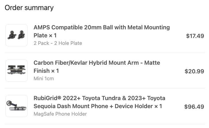

    Dash cam is fine. I don't mess with it much. It turns on with the truck and starts recording automatically. No complaints.
    Here's my order from Bulletpoint. Got it all on black Friday - magsafe phone holder & then the mini mounting arm with 2 extra ball mounts for the dash cam. Super sturdy, looks cool, love it.

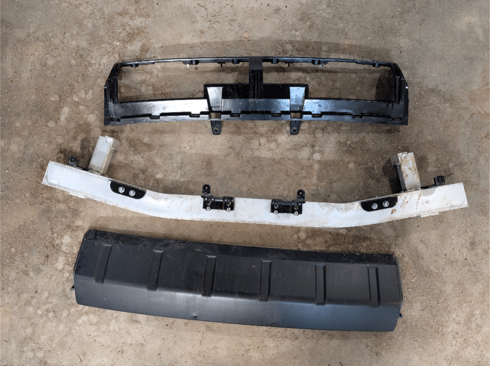

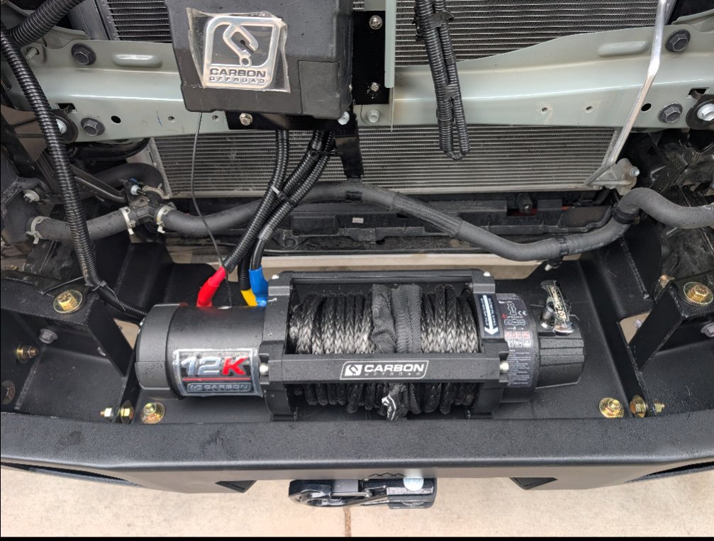

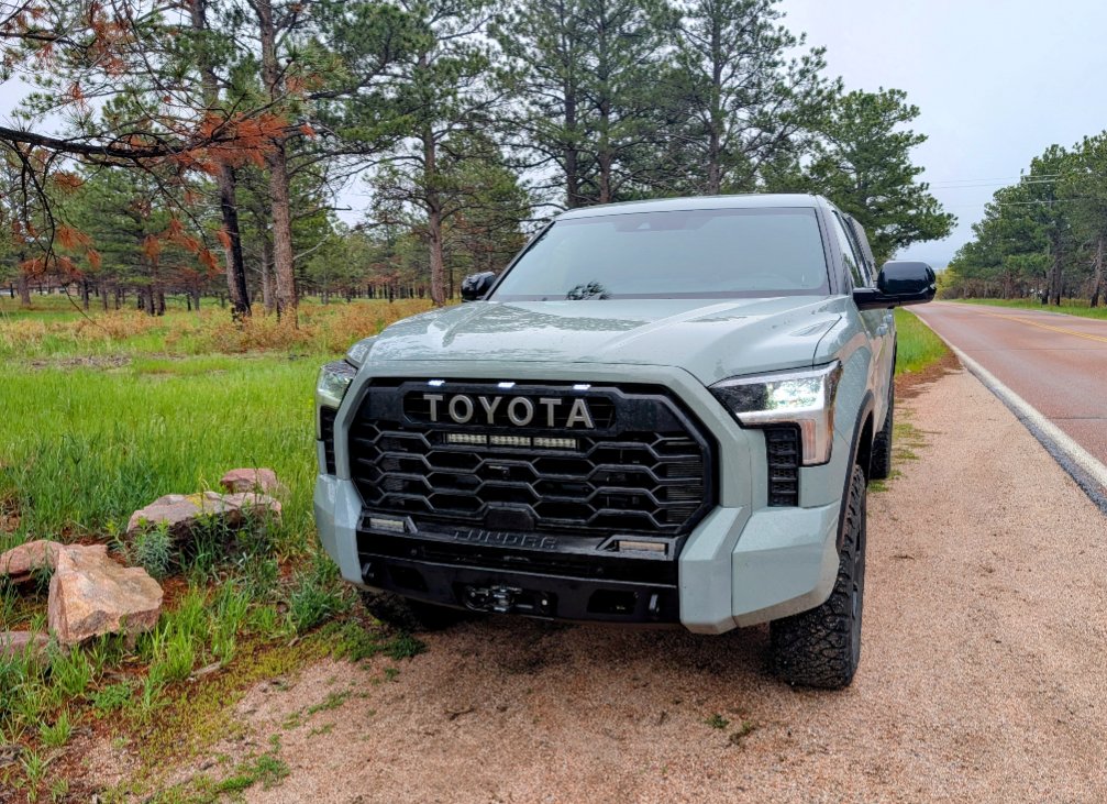

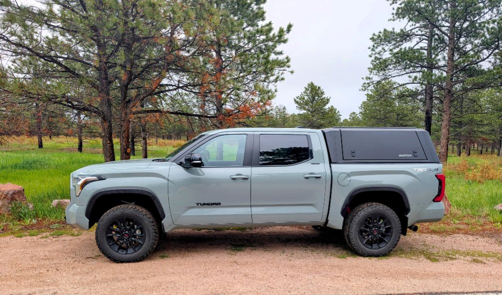

    Installed a Backwoods Adventure Scout Bumper and a Carbon Off-road 12K winch.
    I chose these due to the light weight. The Scout bumper weighs 58lbs. It consists of a winch tray, two frame caps with tow points and an aluminum bumper front fascia. The tow points mount directly to the frame horns and poke through the bumper. The winch weighs 42lbs.
    The factory crash bar weighs 26lbs and the front valance+plastic frame weighs 3.75lbs combined. So add 100lbs, then subtract 30lbs. I lost 1" out of the front fender height. Don't notice the weight on the front driving or accelerating.
    I had to make a relocation bracket for the control box.
