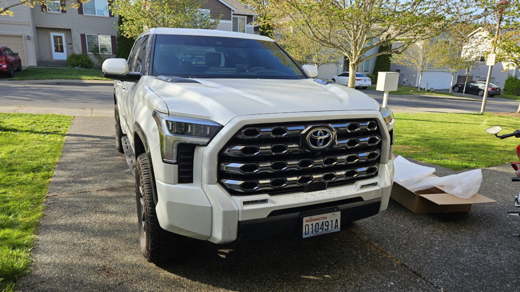

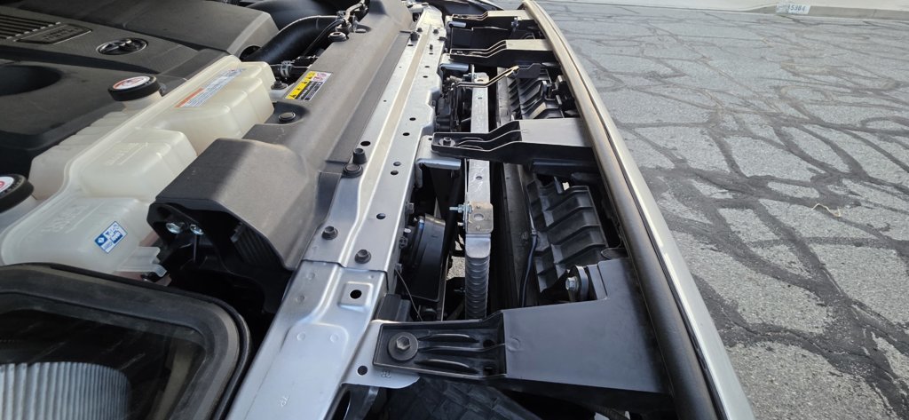

    Took my old grill to the dump because obviously nobody wants it. 6,280 lbs with me in the truck with a full tank of gas. More than I was expecting.

    Where are people ordering Heritage grills from w.o 300+ in shipping?
    I did the swap on my Tacoma and loved it, going to do the same on the Tundra.

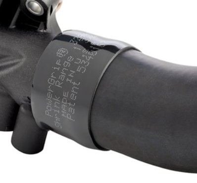

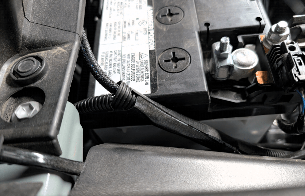

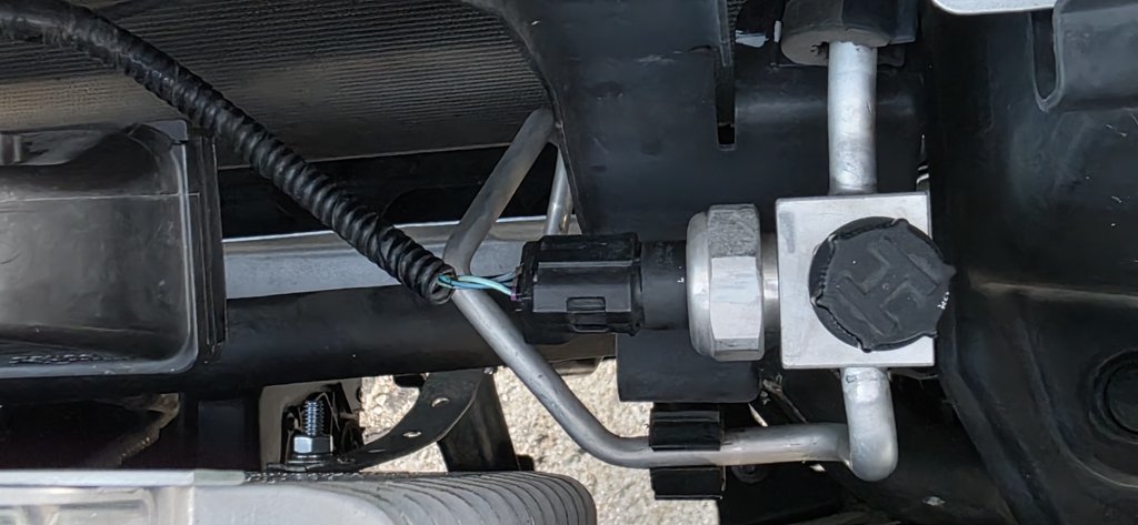

    It arc'd a couple of times when I shut the hood but haven't had any issues so far....
    Kidding. That was just testing prior to using connectors, heat shrink, and conduit. If I took a picture of the button'd up splice it wouldn't show anyone anything. The point of that picture is for someone that has a CanM8 and is trying to figure out how to wire it to interrupt the relay power and trigger.
    Here's what it currently looks like. Not really helpful showing the order of connections

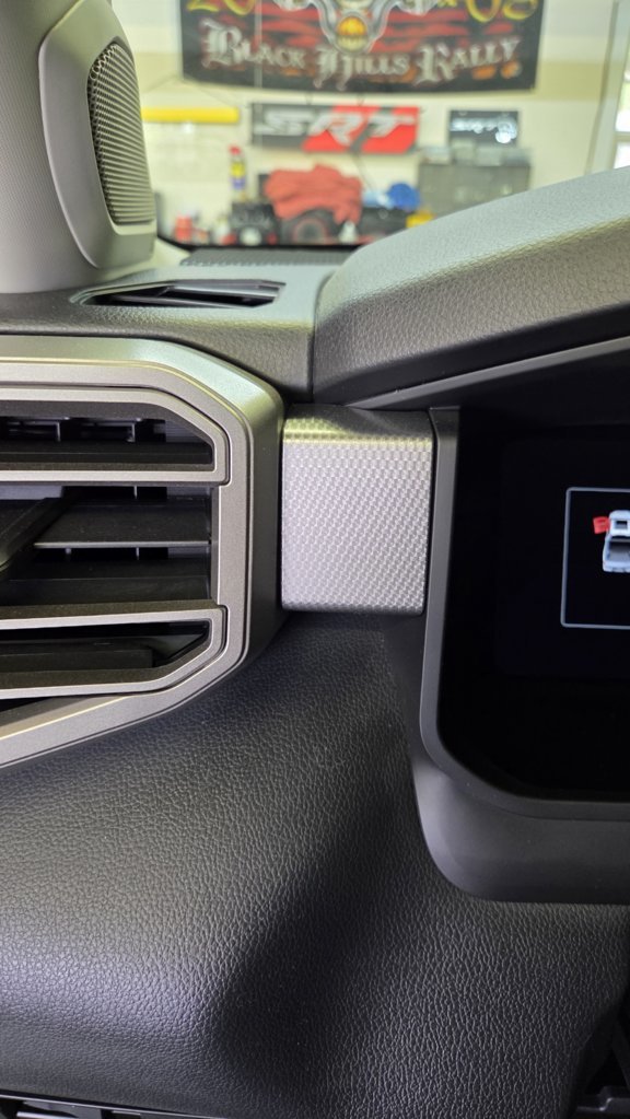

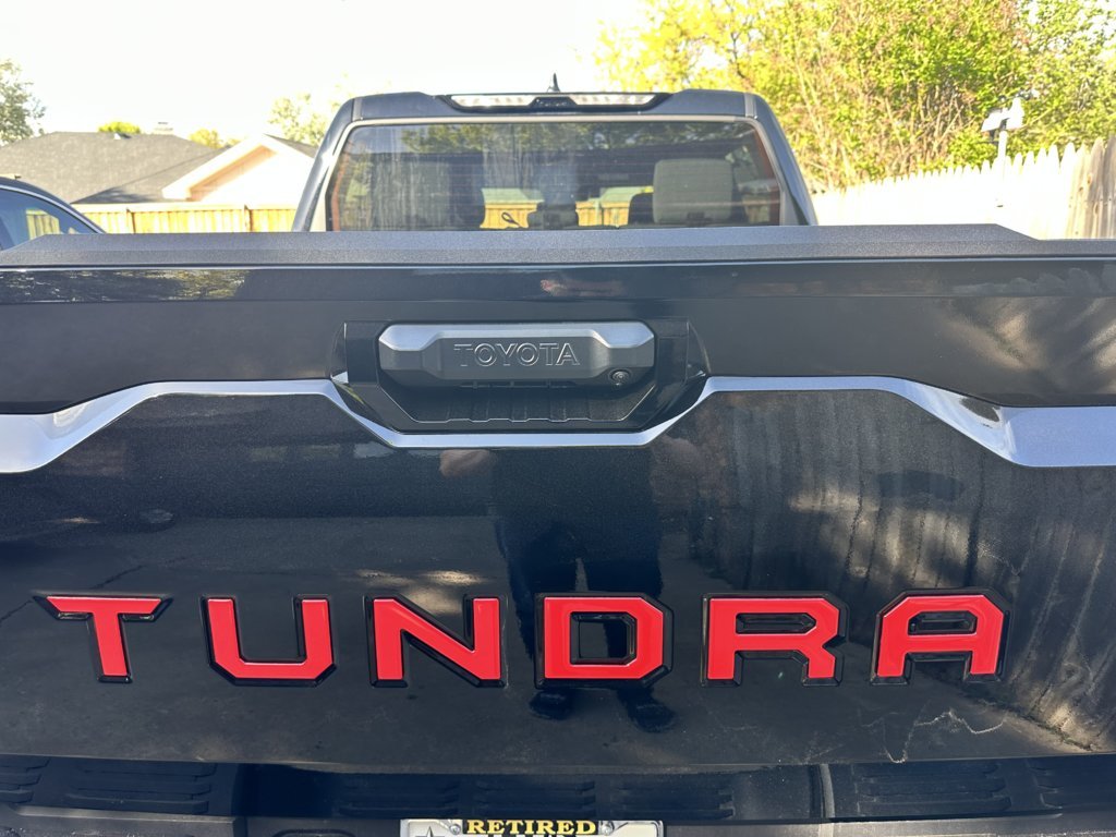

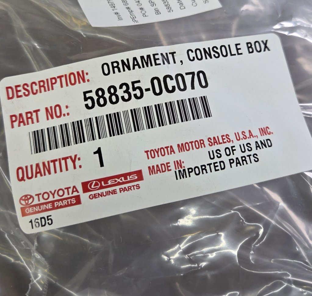

    IMG_9599.jpg IMG_9603.jpgQuick upgrade to the new tundra!

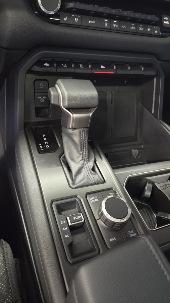

    Did you have to take the whole dash apart, or does that trim just pop off?

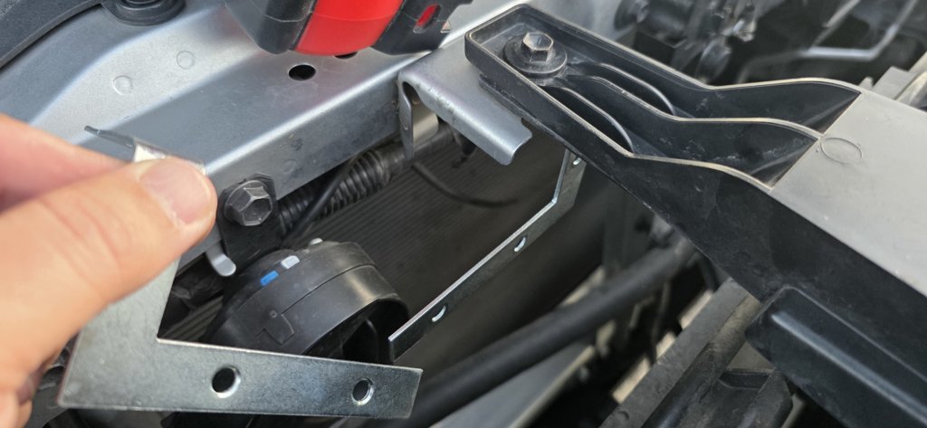

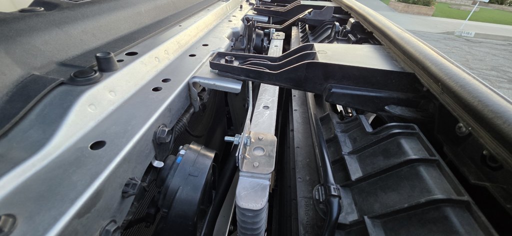

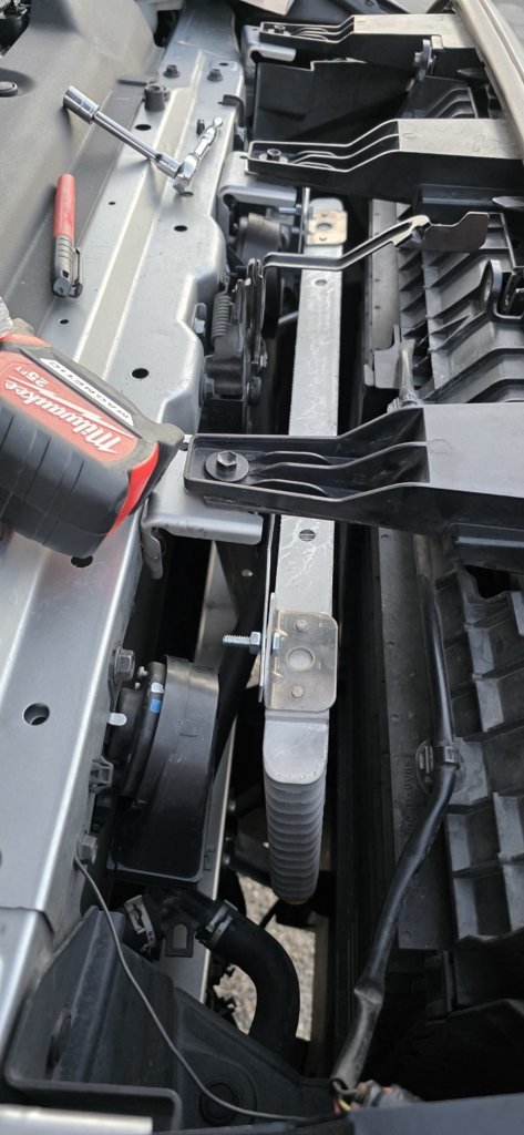

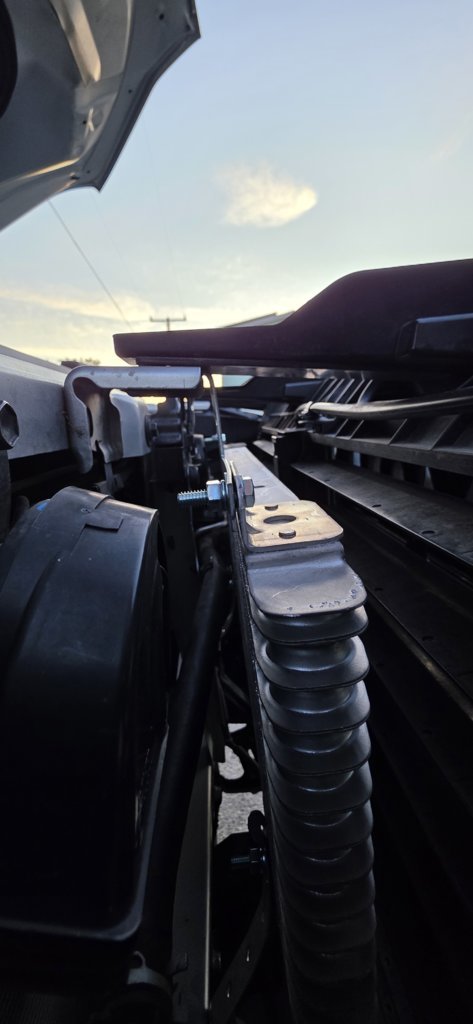

    Started my trucool 40k trans cooler install. Bent some 4in flat corners and drilled two holes to mount the cooler. Now I gotta install the lower straps and its ready to plumb.

    There are several YouTube videos on how to remove the pieces you are asking about. It took me less than 10 minutes to do the console trim.

    Took 5 min. Or less. The two side panels pop off by hand & a small plastic pry tool to remove that trim, which slides back toward the rear of truck.
    As far as the 3 pieces on dash, I'm not sure.

    So it seems like the consensus is to mount in the middle of the grill rather than offset. Cool. Makes my life easier with the derale unit i've got collecting dust at the house.

    I just go with whatever is easier. I did one on my parents Nissan Juke and that was offset just because of ease of installation.
