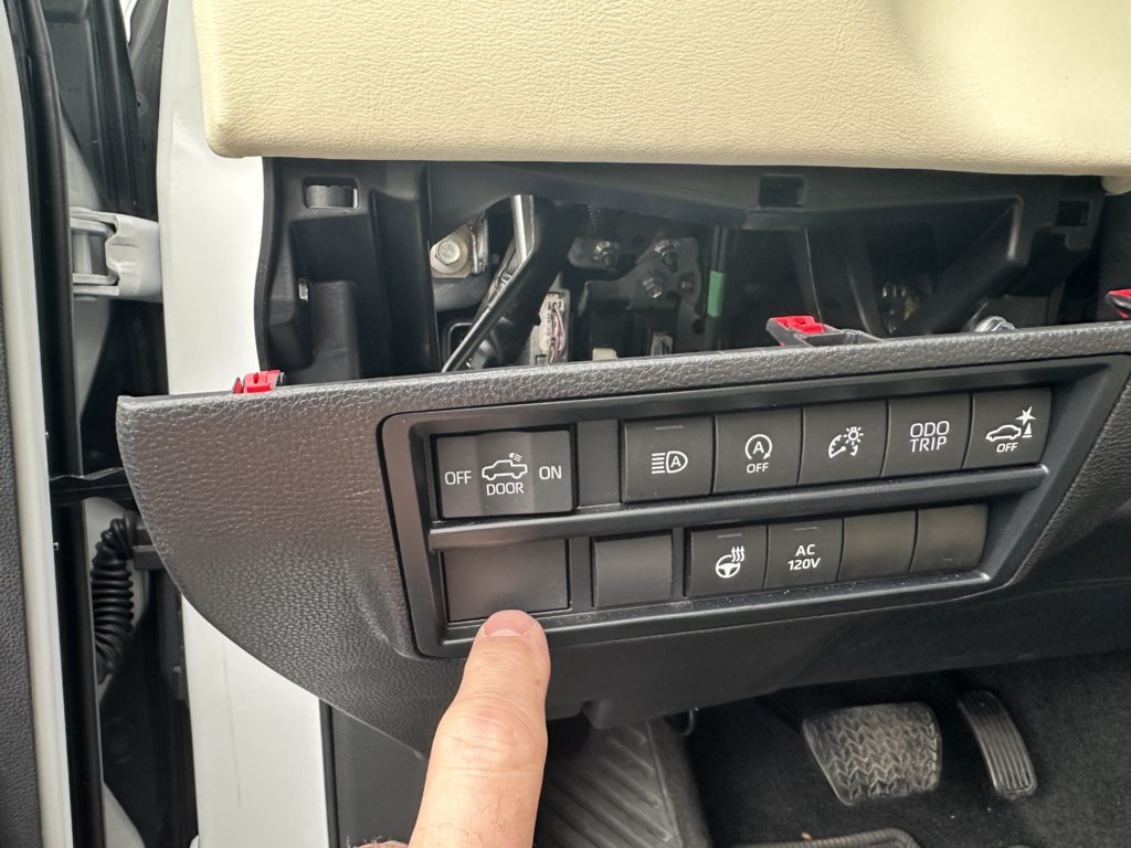

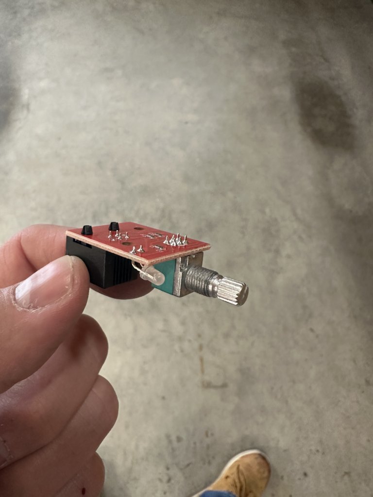

  7. Apr 21, 2025 at 2:25 PM
    #9667
    SilveradoSwap
    SilveradoSwap New Member
    Apr 11, 2024
    #115157
    633
    2024 1794 Edition Tundra
    Derfla and eddiefromcali like this.

    Why do all the blanks have wiring going to the back of them in the panel??!?

    Looks like a board from the LC2i. It was too wide for any of mine. If you have a blank where I have my TRD Light bar button, it should fit there.

    They are live wires for the buttons that go there for other trims. When I installed my ditch light button, I tapped into the beige wire from the connector I pulled out to get illumination.

    It looks like it will fit here. YT vids say to push it from the back to pop it out the front. I pushed pretty hard and wouldnt trust doing it any harder. IMG_8410.jpg

    I installed mine to the right of that. That button pushes in. The retaining teeth are at the top and bottom. The videos you are watching are for the other ones where the teeth are on the left and right and push out.
    DM me if you got any more questions. Sorry for flooding the thread!

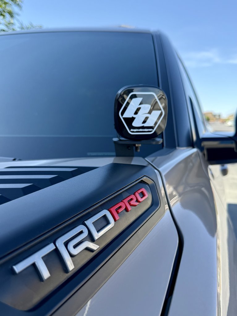

    Just installed my new Baja Designs covers. Loving the Amazon brackets with cable management holes for my OCD!

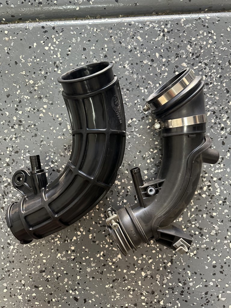

    I had the AFE pipes but ended up selling them...never got around to it. Only K&N claim any hp gain...everyone else just says it can flow more...makes me think K&N just went with the random dyno run that showed some gain in hp and called it good.

    Increase in flow was evident when I did the turbo outlets. I think I gained more from those outlets than the intake itself.
    The S&B intake you installed already has them incorporated with their system. I wonder if they are as big (inner diameter) as AFE’s are.

    My hangup with the S&B is the MAF sensor is scaled to a specific cross-section diameter of the OEM tube. Change that and it alters the measurements that it takes.
    If Banks ever comes out with an intake for these trucks, that's what I will go with.

    I thought it was a different diameter but I looked at the insert and it chokes it down a lot. It would throw codes or fuel trims would be out of whack if the lbs/min were way off. Fuel trims this morning (First drive with intakes) was spot on though.
