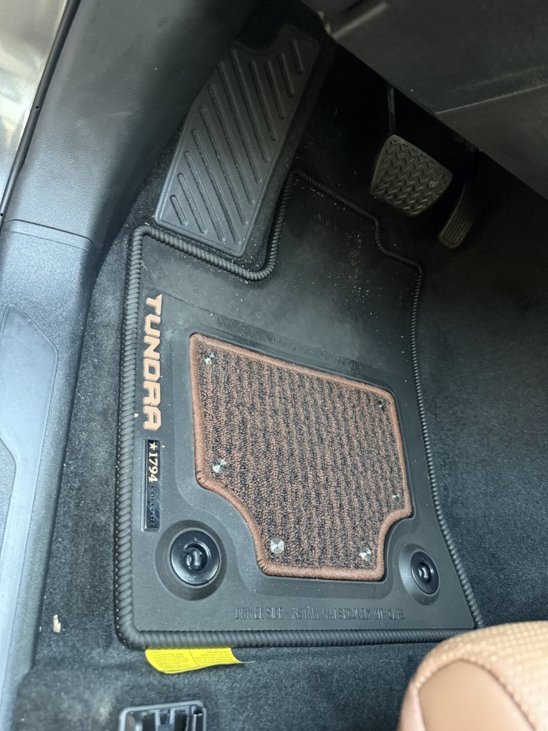

    I have OEM all weathers and they work great. No complaints.

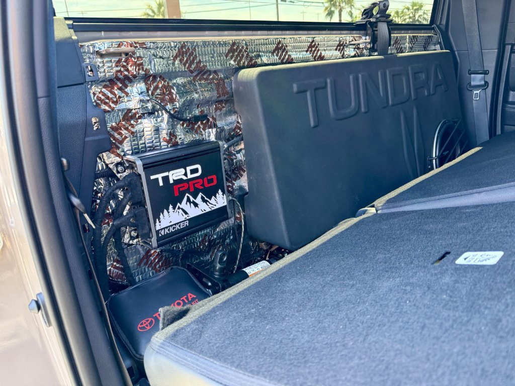

    I deleted the rear panels. I don’t have any rattling in my cab. I can feel the bass from JBL door speakers near my knees after the Beat Sonic amp. Doors on mine aren’t rattling either. Maybe if I went dual sub there would be rattling everywhere. One sub is more than enough for me.

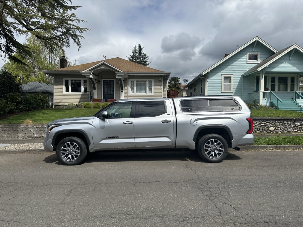

    Added 1794 wheels. I was going to put some 34” Toyo AT3s on soon but these came with brand new factory tires. I’m going to run these down while I work on paying off the truck.

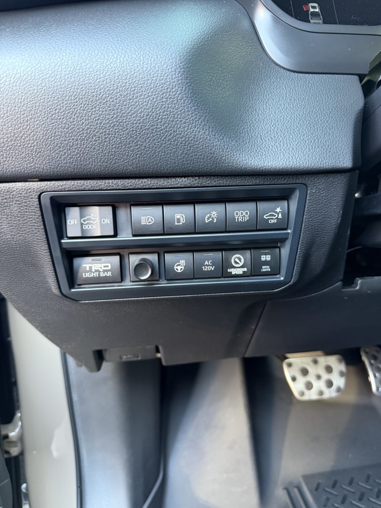

    I wasn’t happy with the clearance under my driver seat with the JBL amp, LOC, and extra wires/harnesses so I got some seat spacers on Amazon and lifted the front of my seats by half an inch. Now I can reach under there and pull out my LOC if needed for adjustments.

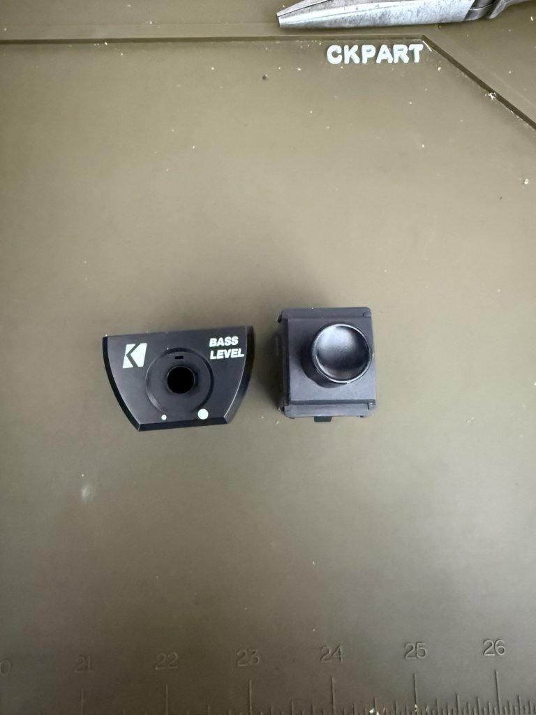

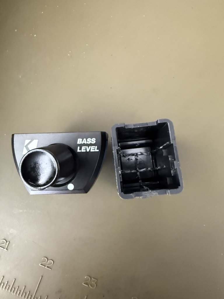

    I googled my model number (Kicker knob) and found that it was possible. I pulled hard on the knob and thought I would break it. Glad someone else has done it before!

    I forgot to mention. I didn’t use the LOC knob. It was too wide. I used the knob for the kicker amp. I had the LOC at flat settings and tuned the amp.

    Any pics of the backside of the mounting of the knob?

    I used dikes to snip through the inside of the button and painters tape and a nail to get my pilot hole through the front. Then I just stepped up on drill bits until the knob shaft could go through.
    If you use the same button I did, it has retaining teeth at the top and bottom and come out pushing the button in towards the front of the truck. All the other buttons are retained left and right (all the buttons touching each other, top and bottom) and come out towards the rear of the truck.

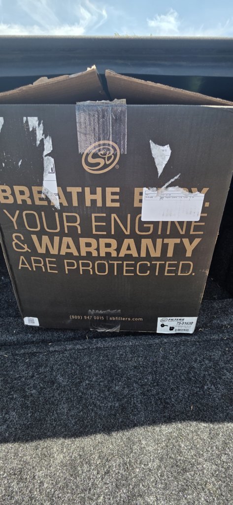

    Picked up an S&B intake.

    Awesome, dry or oiled filters?

    Where from if I might ask?
    Is the "D" in the p/n for dry filters?

    Think it fell off a truck and the nice young man that I got it from was able to pick it up and sell it to me :)

    Correct, "D" indicates dry filters.

    When I flip back and forth on S&B's website, the Dry filters show up white and the Oiled filters show up red, like K&N's.
