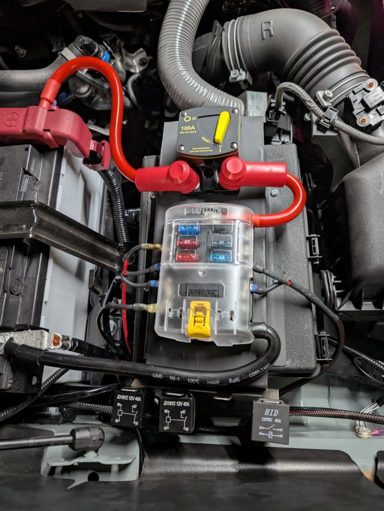

    I bought my '25 Limited TRD Off-road package with 3" lift just about a month ago. I immediately bought BFG TA KO3's in 285/60R20 and had the dealer install the TRD sway bar to make room for bigger tires.
    This is my daily driver and I just want functionality for my lifestyle. I participate in competive shooting a lot. Probably 2 to 3 weekends of the month. Camp in the summer and transport stuff quite a bit as part of household chores as well as up to our cabin 3 hours north. I hunt every fall with a group of buddies and haul a bunch of coolers and camping equipment out to the lease and every thanksgiving drive back to my family's farm in the east coast to hunt whitetail.

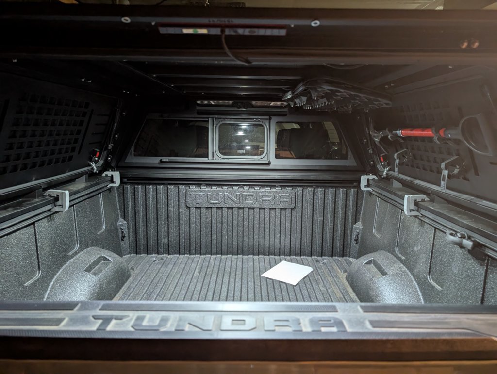

    My last Tundra had a cap and I loved it so I ordered an RSI Smart Cap EvoA and installed it by myself with a garage hoist.

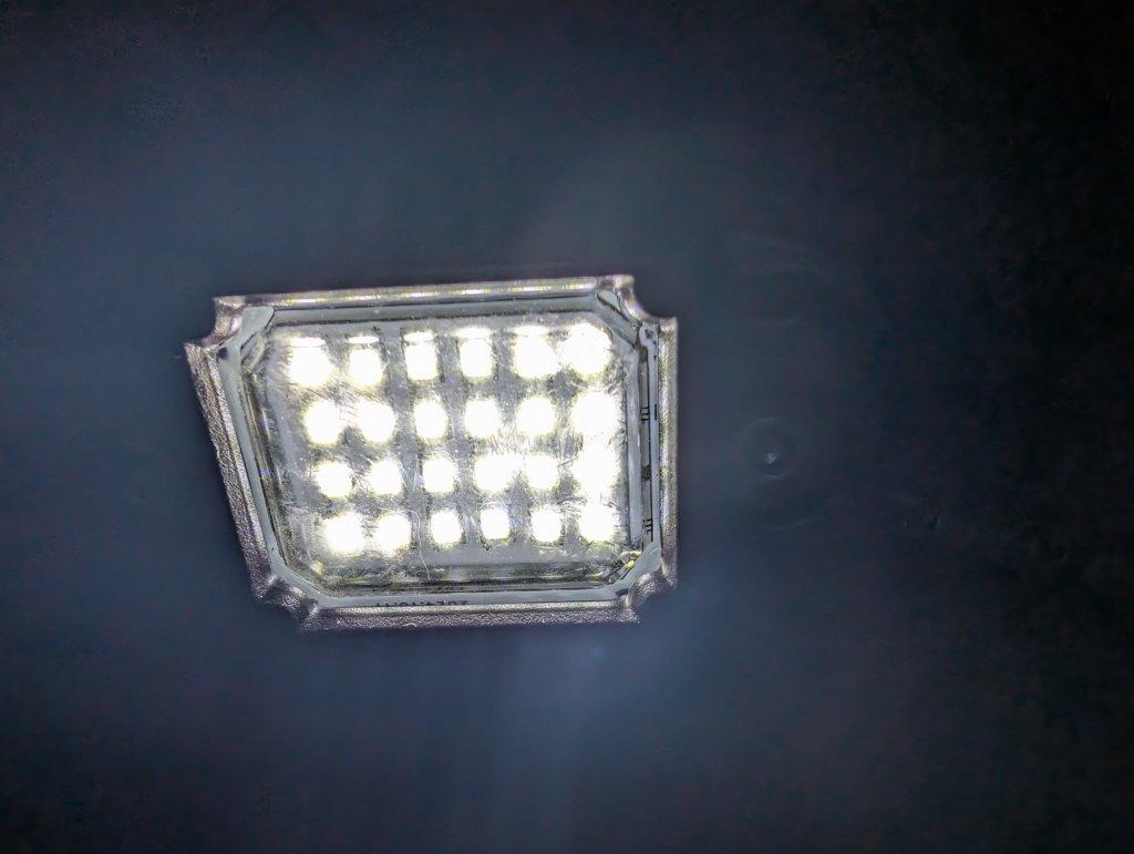

    My truck wasn't optioned with the power package so I installed some rock lights on magnets in the ceiling of the Smart Cap.Ordered some rare(apparently) molle backers for quickfists to store some tools on the doors of the Smart Cap and used M8 clamp screws to hang some traction boards. I also ordered a cheapo fire extinguisher and screwed some magnets to it's bracket to mount to the Smart Cap.
    I ordered all the parts and pieces for the Heritage Pro grille swap and ahead of the install prepped the battery for multiple power accessories with a Blue Seas 6 gang fuse block and a 100amp circuit breaker. I bought some sheet steel and made a mount for the fuse box cover.
    As I was finishing the wiring for the Diode Dynamics light bar in the Pro Grille I realized how nice it would be to have a dome light under the hood. I had one rock light left and ordered some more magnets but surprise!....the hood is aluminum, lol. So I copied @60centenergy and used a strip LED I had lying around. Last Friday RCI emailed the skid plate was ready so I drove up and picked it up and installed it at work. Super easy install and it looks great. I got aluminum for the weight savings and the fact that I'm not building a hard use 4 wheeler.
    Next planned additions. I ordered a CAN M8 high beam switch and reader to link my light bar to the headlights. I also have two 30"L x 10" tall x 13" deep tool boxes that I'm going to mount to the bulkhead bed rail end to end. I'll probably have to build a little bench for them to sit in to bear the weight. Have at toolroll incoming and will pick up a Morrflate air compressor. I'll store the bottle jack, tools, air compressor, coveralls, snow chains, tire repair kit, jumper cables, tow strap, and hitch in those boxes. I plan on ordering a Backwoods Adventure front bumper and installing a 12K winch in the next couple of months. Lastly I plan on buying the Electrolatch auto locks for the Smart Cap to link to the doors lock/ unlock functionality. I think that will round the truck out and give me some preparedness and flexibility when dealing weather and conditions in the mountains.

    Nice work. Now you can see under that hood!

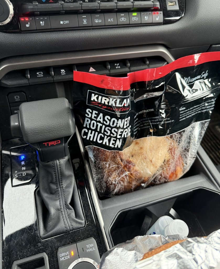

    Today I figured out the best use for the console cavity. Wireless chicken warmer

    I'll bet it's much better at that than charging a phone!

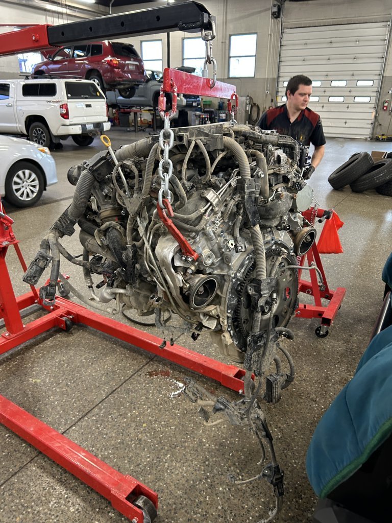

    Out with the old and in with the new

    Damn that old engine was filthy!

    They have done about 60. I have worked hard to have a good relationship with my service advisor and he put the best tech at the dealership on it. He can usually do the swap in in about six hours. The dealership also has a couple little tricks they’ve learned to make everything go smoother. For example, Toyota‘s work plan dictates to use chains off of the cherry picker to lift the engine, but they found that it puts a lot of stress on the hooks so they made a bar to lift the hooks straight up. Small thing, but made me glad to see that they are experienced
