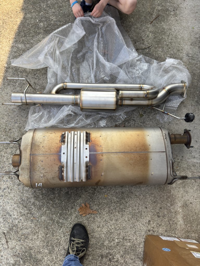

    Initial driving impression.
    nailed the 1/4 wave. Shocked at how quiet it is at light throttle cruising.
    But man, when you step on it the thing comes alive.
    Getting serious GTR vibes out the back.

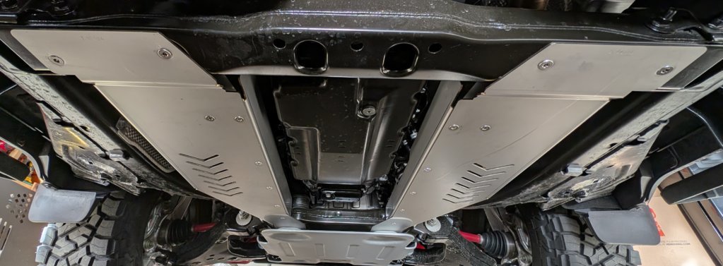

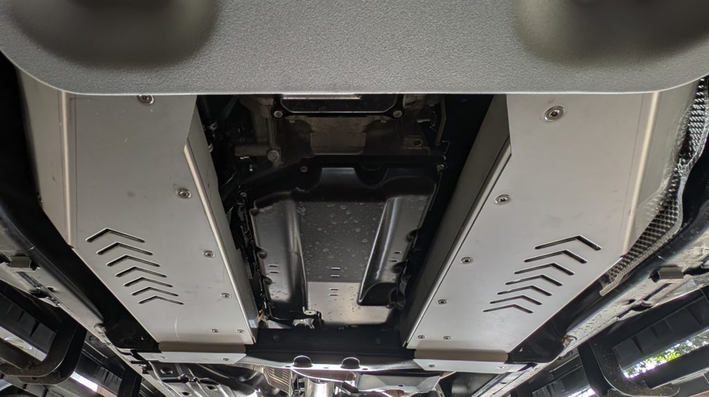

    Installed MillerCat v2 stainless cat shields.

    those looks good!

    Theft or rock protection!? Looks burly!

    Little of both! They are precision-machined and fit perfectly. Stainless everything including backer nuts and hardware. Very pleased.

    These seem very reasonable for stainless… I think they are going on the list. Do they just bolt up to existing threaded holes on the truck? On my 2008 I had to install rivnuts.

    Yes, existing threaded holes and backer nuts are used. No rivnuts. Less than 30 min install.

    If you don’t mind, please; what was your decision to go with the stainless steel over the aluminum? Knowing the higher cost, was there a decision to go that way?

    Harder to cut and will always look nice.

    Looks great! Should definitely hold up to trail abuse and tweakers!

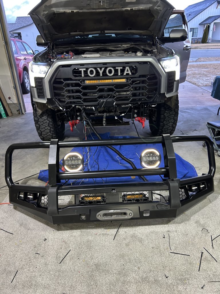

    That bumper is awesome - I need something like this for our 1000’s of deer out here…..LOL
    Couple questions, tell us about the install, how long did it take and level of difficultly? Look like you have a lift but does this bumper require any modification to the front suspension due to weight, I think it is around 250lbs right?

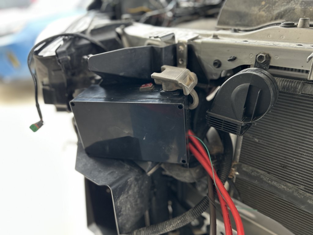

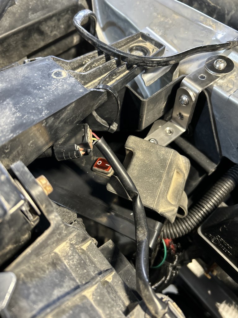

    It has taken longer than I expected. Ironman’s instructions are a video and it is lacking to be sure. They don’t really tell you which hardware and such for each step along the way. I had a CBI stealth bumper that I had to take off and that ended up being a chore with a couple bolts, then my winch that fit with that bumper does not with the new one; the winch head is too big. So I had to relocate the head but given the shape of it, it’s still kinda huge. So I used a project box and moved the electronics into it and mounted above the side intakes as pictured. Then I made fog light mounts in the center as the fogs are too wide for the side wings which was my original plan. Then waited for my Strands cubes to come in. I’ve been working a lot this week and weekend, so all this got stretched over a couple days and I should finish soon. But I would say 8 hours or so. It lowered the front by about .05-0.75 inches or so, and no you don’t need a lift.
    But the bull bars are huge which to me gives it a great look and protection for the trail or road. Deer are stupid.
    Winch head relocation and re-boxing
    Winch head hard mount and access perspective with the grille on and hood open

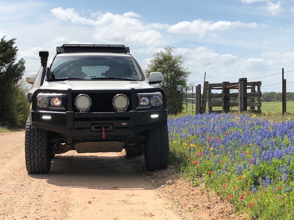

    What winch are you using ? I'm down to the Ironman or the ARB......I know on the 200 my winch install was a lot longer then the shop expected....but the result was worth it, and it held up really well over time.

    I have the Harbor freight badlands 12k winch which has been great. I’ve used it a bunch. It comes with a master battery switch and relocation kit which is great, it’s just the shape of the head that proved to be challenging.
    I like ARB’s new tundra bumper but it was $2495 w/o the option of a bull bar or grille protection, that’s what I need.

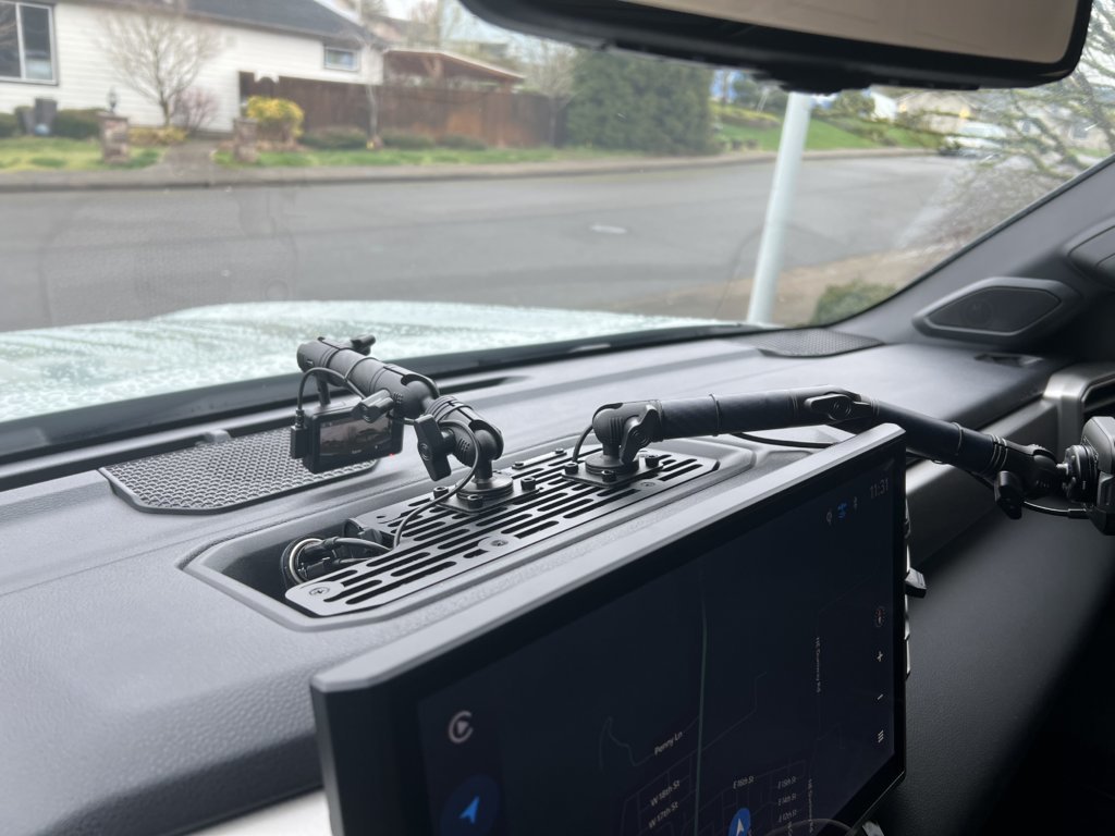

    I added a garmin cam today.

    Thanks. $100 extra is a small price to pay for security and longevity.
