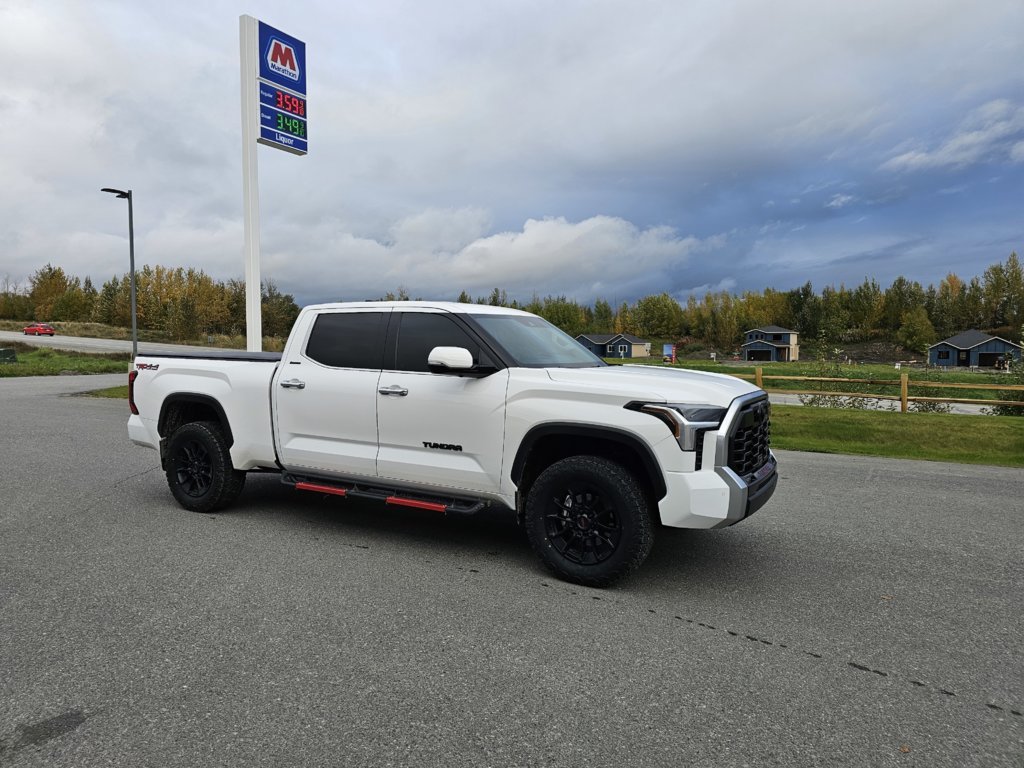

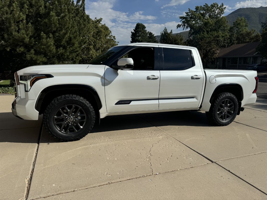

    285/65R20’s! BFG KO3’s. Stock suspension. No AVS. No spacers.

    Nice! Had some KO2’s on my old truck and they were awesome. Smooth ride, fairly quiet. How do these KO3’s ride?

    Compared to the stock tires they’re definitely rougher. Got use to it quick but I’m happy I did it. Truck feels stable now. MPG took a hit. And the speedometer is off 3 MPH!

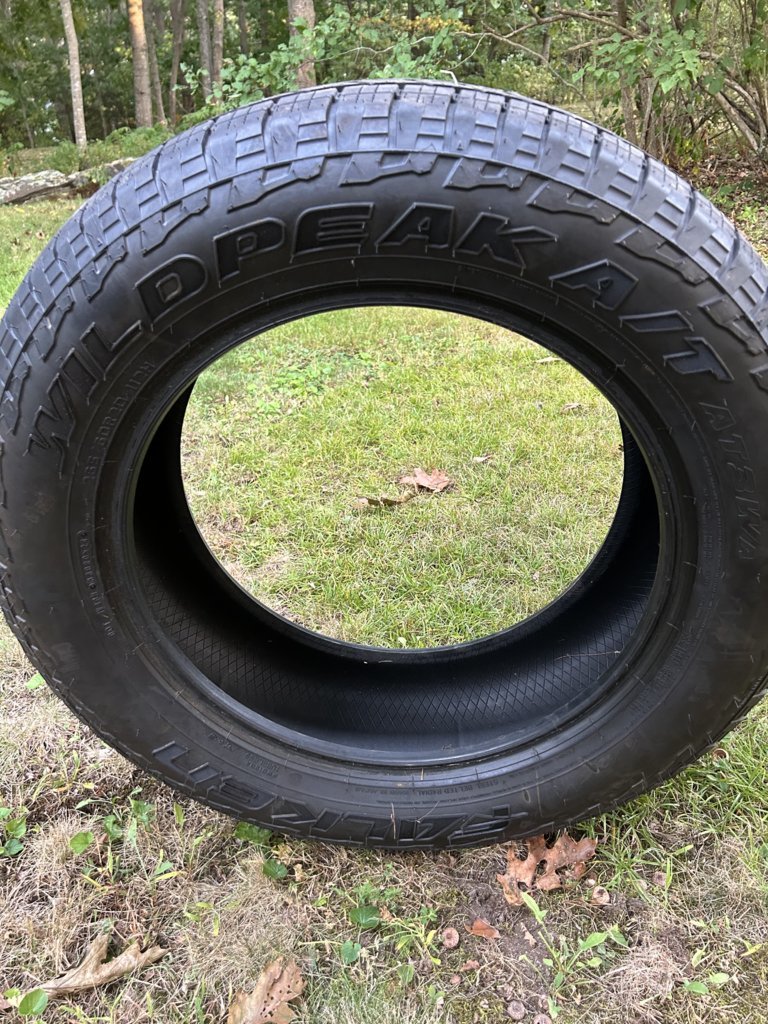

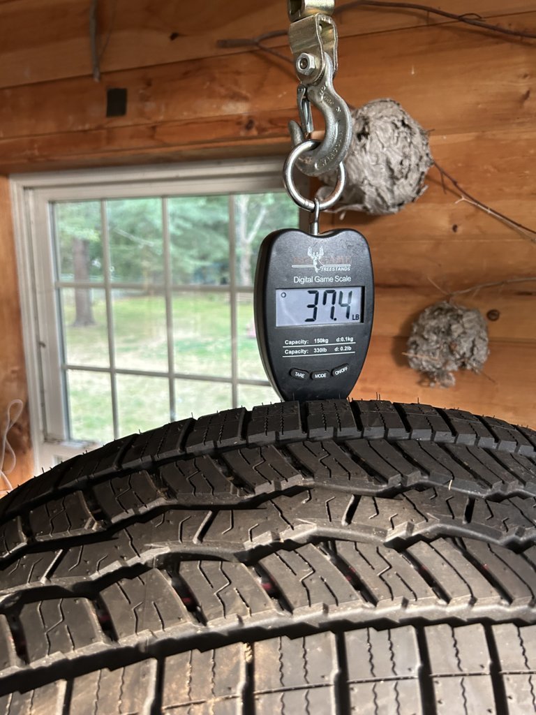

    Tow Hooks! 285/65/20 KO2 Yakima Rack Carlinkit Carista tweaks
    I’m off 3mph at 77, actually going 80.
    Related, are the mildpeaks really only 37 lbs? The new KO’s are 63. Math is hard, 26 lbs difference seems wrong. 188 miles on them.

    No rub? Looks good

    Looks like it should! But no rub at all!

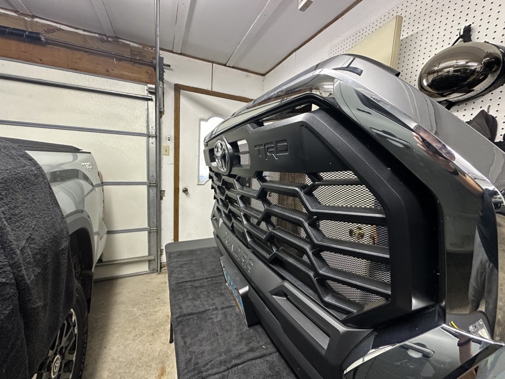

    91
    24 Lunar Rock TRD-OR
    What size mesh did you buy for this? Was it the 40" X 13"? Just want to make sure the roll I buy is wide enough.

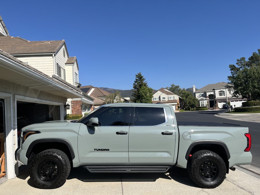

    120
    Sharp lookin' Tundra! The X4ts looks awesome! I hope you're enjoying the tonneau cover!

    Thank you Amber! Yes, love the cover.
    Anybody on the forum ordering from RealTruck, I highly recommend contacting SantanaRealtruck (aka Amber C). Great customer service!!!!

    2" RC Leveling Struts
    The stuff I bought is made by AggAuto and it is 47x16 (Black). Pattern is 4x8mm rhombus.

    40x13 would work fine as well. When I trimmed them down to fit, each mesh piece was roughly 15x12.

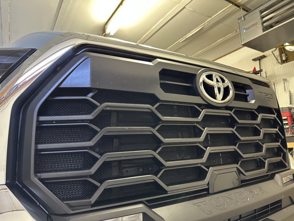

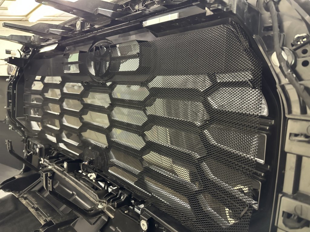

    I have seen others do this right over the intercoolers but I also wanted to protect the radiator and condenser.
    The roll off Amazon is only 47”s so there is a small gap on each side. I figured this would look better than two pieces. Maybe I will still add trim on the ends but for now I’m happy with it.
    Exact link: https://www.amazon.com/dp/B097XJZN18?ref=ppx_yo2ov_dt_b_fed_asin_title
    I used small zip ties to hold it in place.
    I don’t tow heavy in the hot days and so no worries there. Also this is to help with small rocks and bugs. A big rock will still go through but maybe there is a chance it could slow it down. We will see how it holds up but it's cheap insurance.

    Thats a good Idea.

    That turned out really good. I used the exact same stuff off Amazon on mine. That mesh is perfect because it's really rigid, small enough to block most debris, plus it still lets plenty of air through. I was thinking about trying to do the whole grill, but the main radiator on the hybrid is mostly covered by electric fans so I just focused on the turbos.

    That’s a great idea for summer use . Not sure where you live but I’d be concerned about snow and ice blocking it solid in the winter . Just something to consider if you get much snow .
