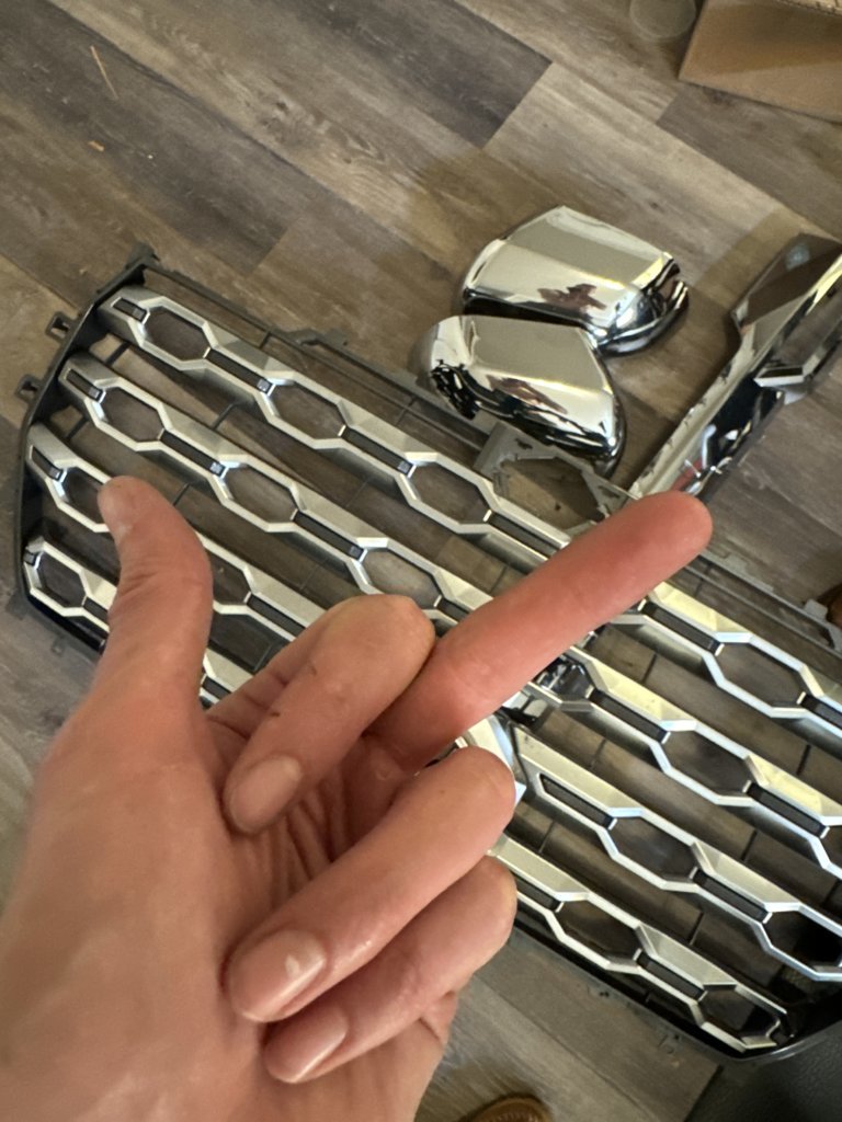

    Chipping away at the chrome. Tailgate is next…mustache, suspension, wheels, giant Punisher stickerS…slippery, expensive slope

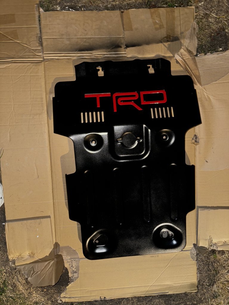

    Got my trd skid plate finally and installed with some spacers due to my drop kits

    Looks good in black
  9. Sep 12, 2024 at 8:34 AM
    #7209
    iScramble
    iScramble New Member
    Nov 29, 2023
    #107718
    51
    2023 Tundra SR5
    Yea, the black looks great

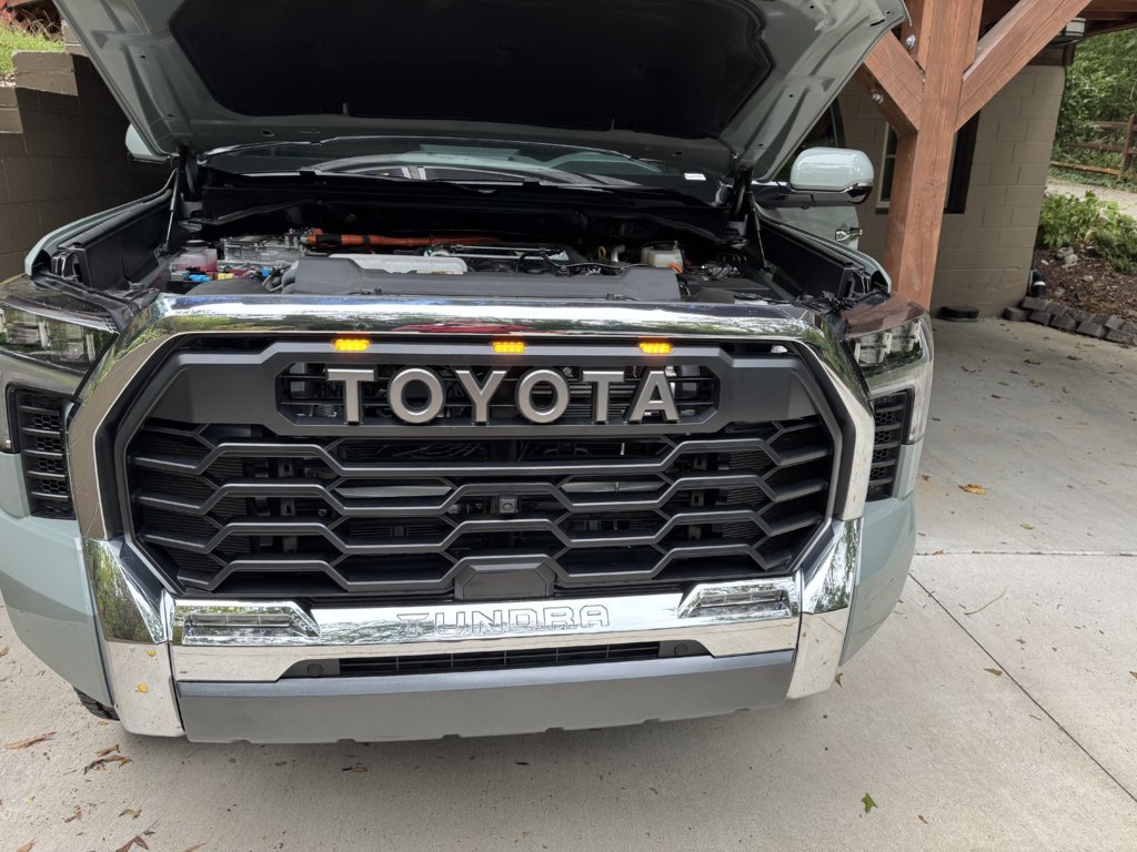

    added some color to the front

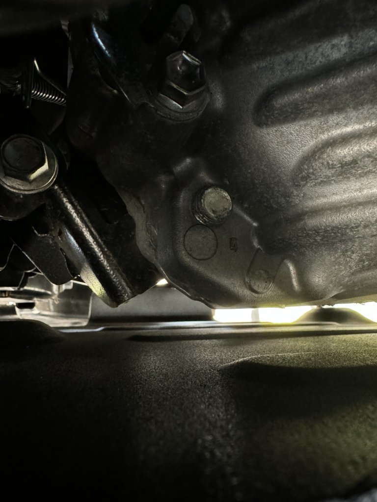

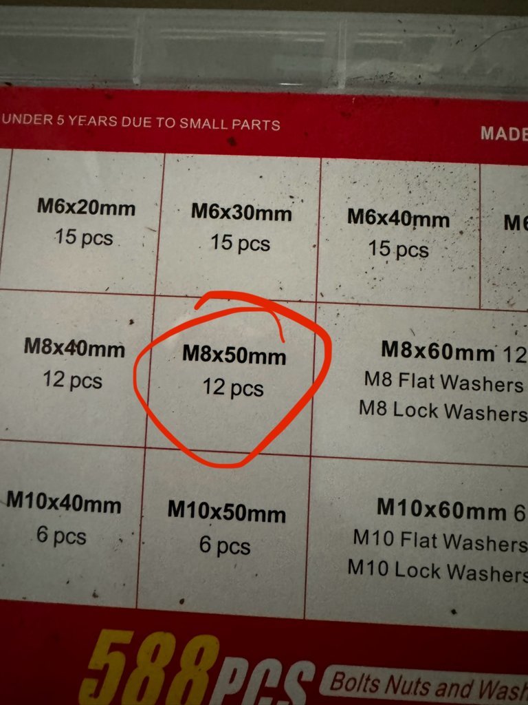

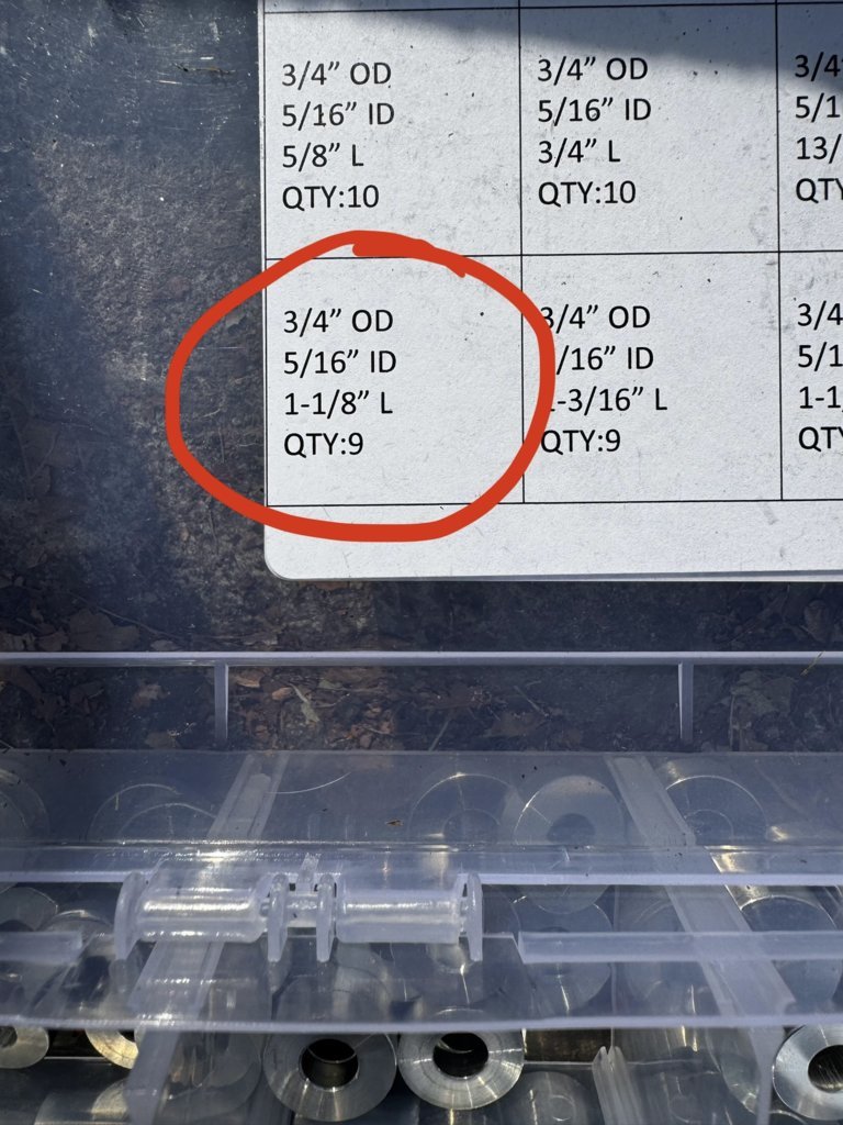

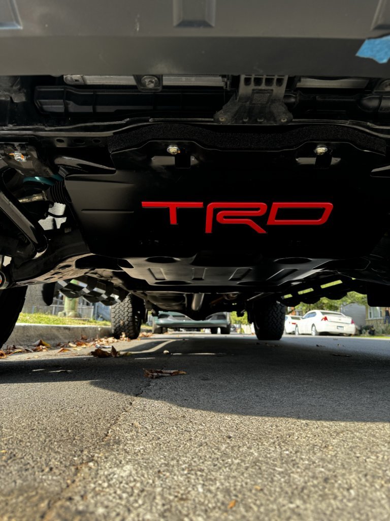

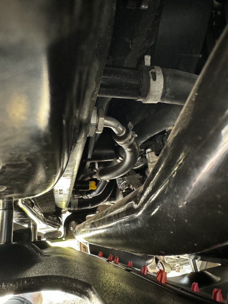

    IMG_2109.jpg IMG_2104.jpg IMG_2106.jpg Updated my spacers on my skid plate IMG_2110.jpg IMG_2111.jpg
    Spacer set was purchased to fit the 3in Toyota lift kit and its bigger size block sway bar drop kit
    Those sizes are
    Spacer — 1 1/2” tall — 3/4” OD 5/16” OD
    60mm bolt
    I have a regular drop kit not the big block that is used for the Toyota kit. So my spacer size is allot lower and I probably will go even lower to maybe a 1inch spacer to pull it up closer to the frame. But for now I’m happy. Sorry for the late info I had forgot how I originally ordered compared to what I installed, figure I could help everyone with both kits now seeing that I needed a smaller spacer

    Tada - thanks @maldo012 for skid plate info !

    So I assume you have to remove the skid plate to change the oil, that alone would keep me from putting one of those on. It does look good though.

    It was honestly my first thought but if you get this from factory it’s the same thing Toyota has to take it on and off for service. Only difference is I have a spacer in between. Personally I just like the look so I don’t mind the extra work.

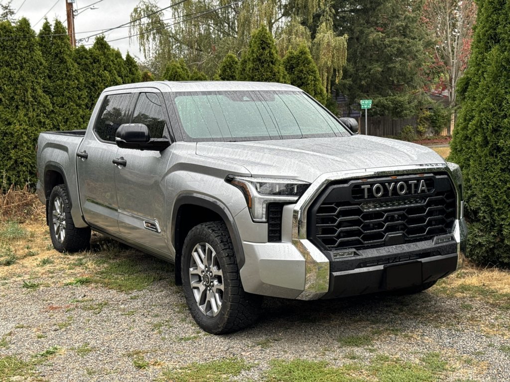

    Got the windshield tinted with SolarFX FX Plus 65% ceramic. It has a slightly blue hue on the roll but it turned out fine.
    And apparently it’s raining because all it does is rain now.

    Yup. I have the Talon and the first time I changed the oil after installing the skid, I thought it would just drip down the hole cut-out… I was wrong. So wrong.

    Just get a Fumoto valve or similar and some tubing and you'll be fine.

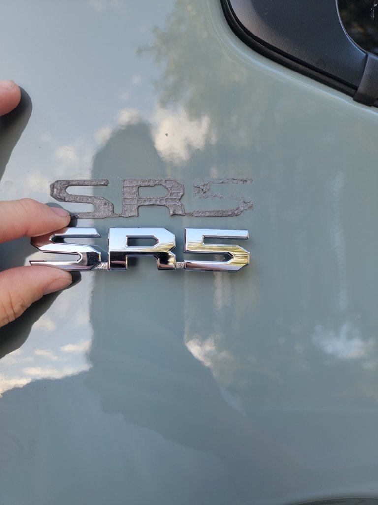

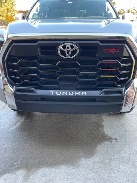

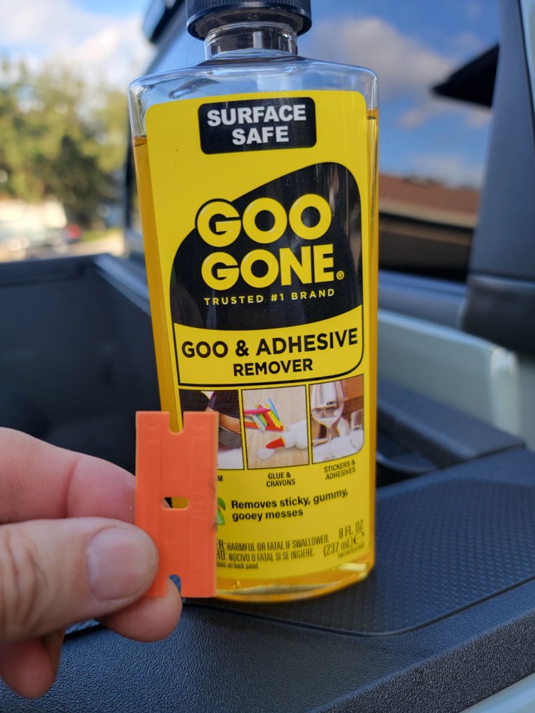

    Last of the chrome!

    Looks beautiful. Food for thought you may have had an easier time with some heat applied and using some flouro fishing line makes them come pretty much all the way off with minor residue left on paint. Even could use a hair dryer. Just a little bit of heat goes a long way
