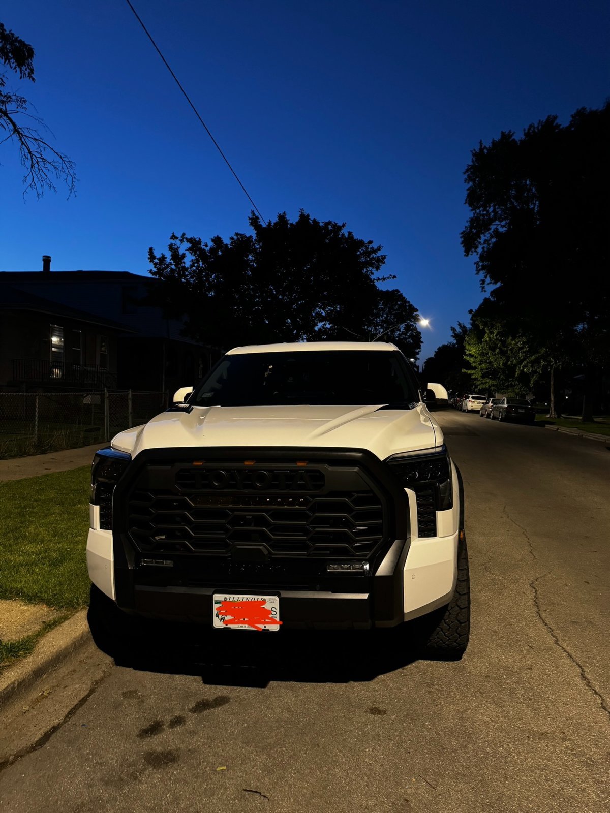

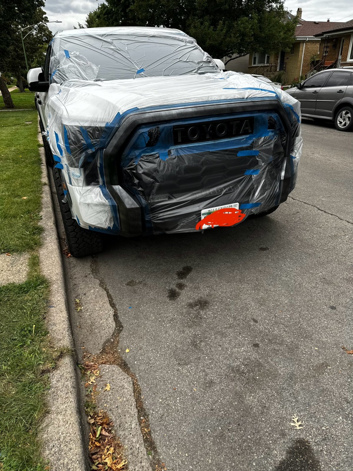

    Blacked out the mustache. Came out better than I expected. Only one thing. Do not spray hyperdip in the wind lol I was already set up so I went ahead and sprayed. Didn’t come out too bad but had some run spots because I had to get too close. Just take you’re time and tape off correctly and you should be good

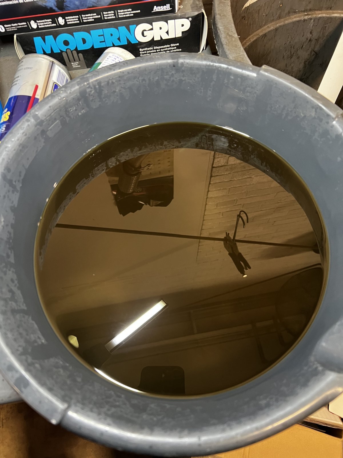

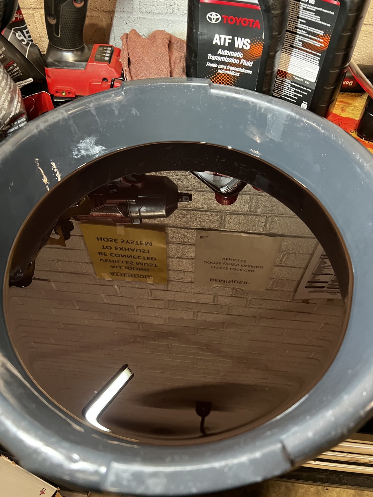

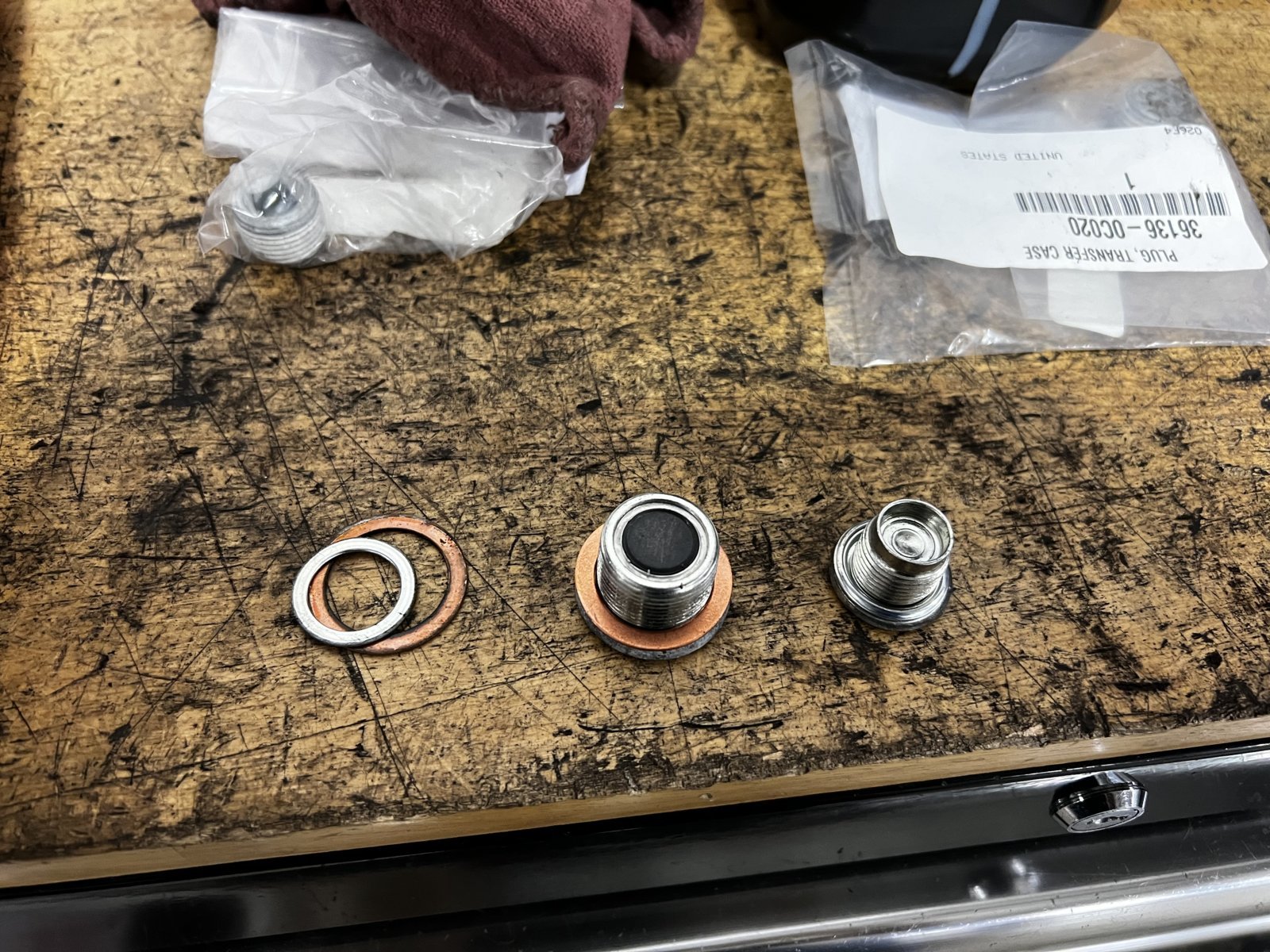

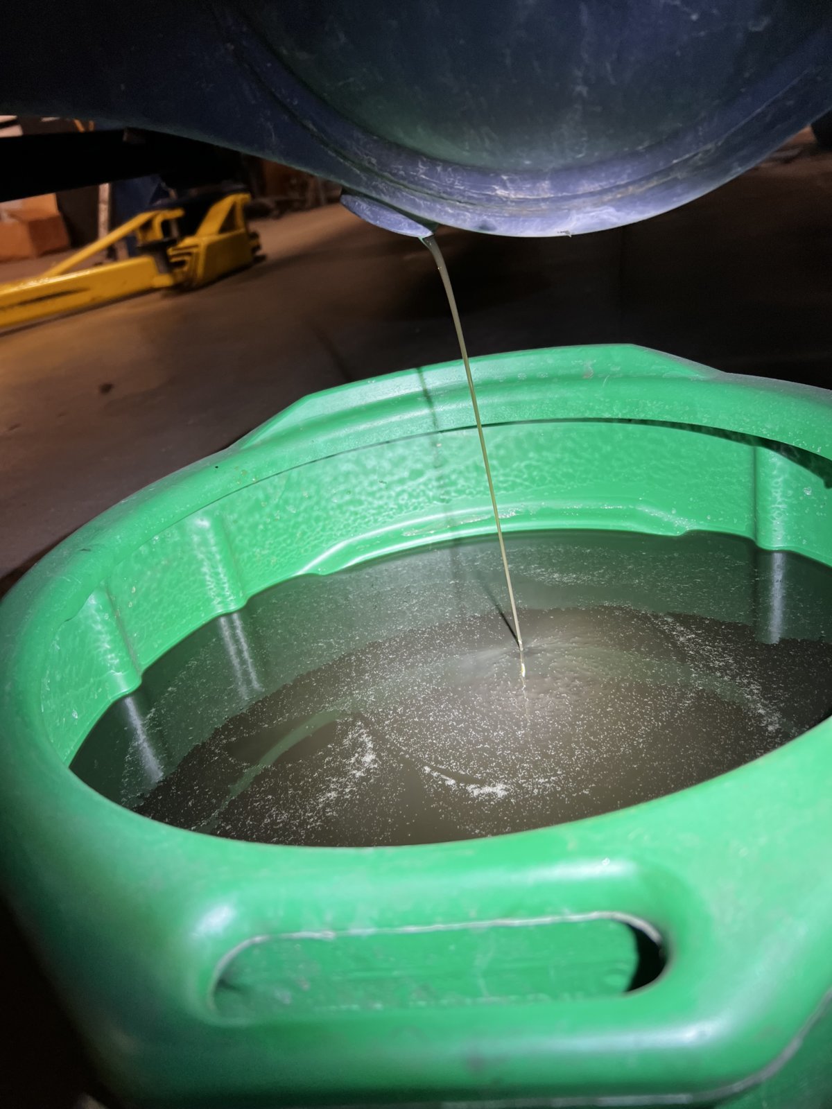

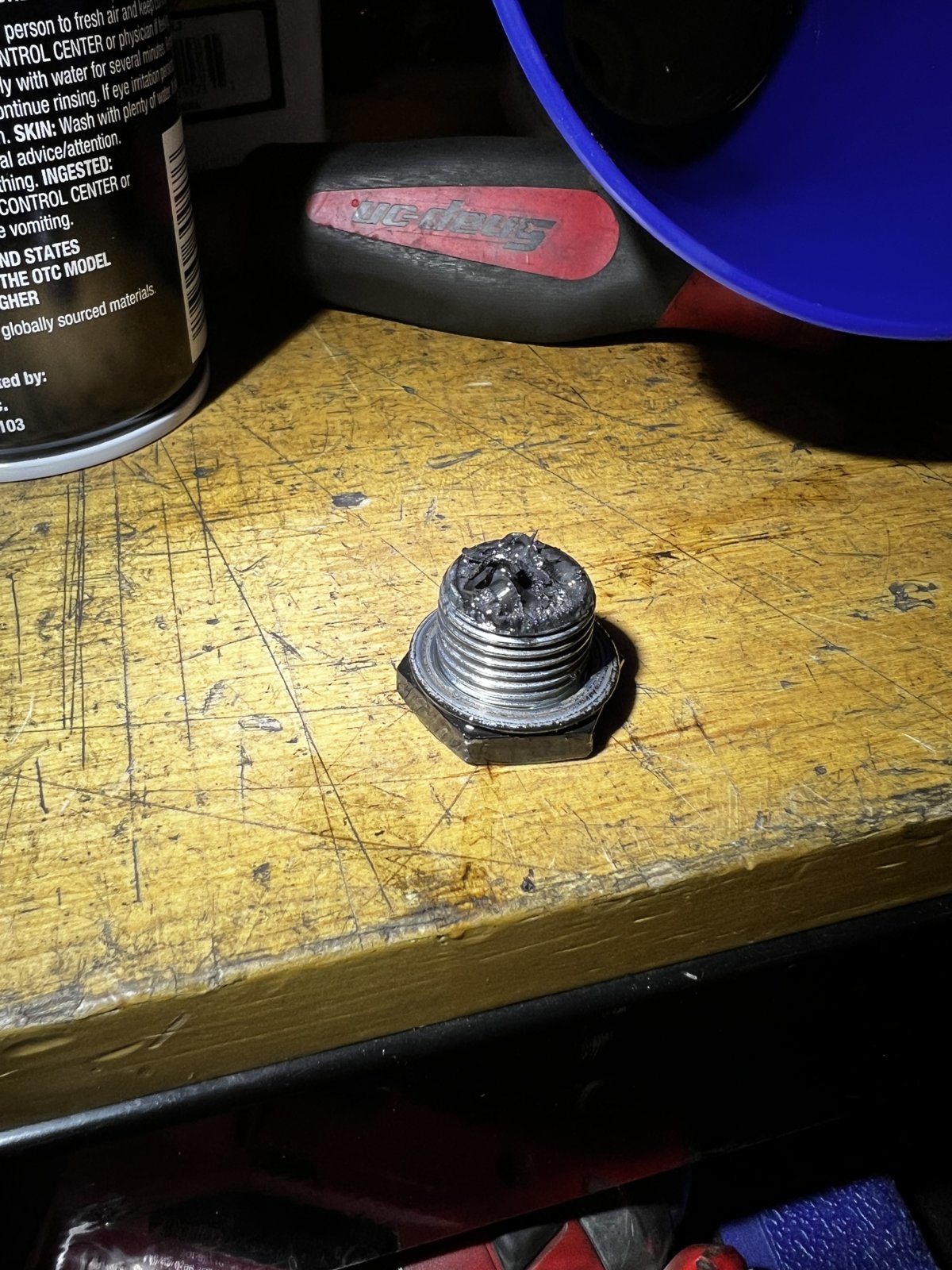

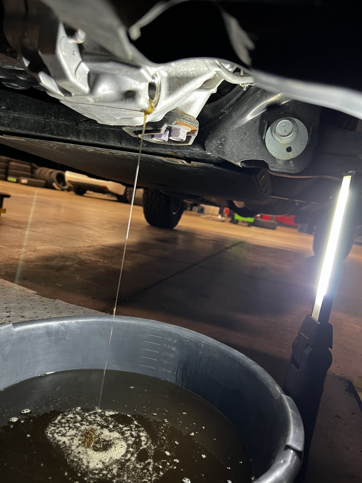

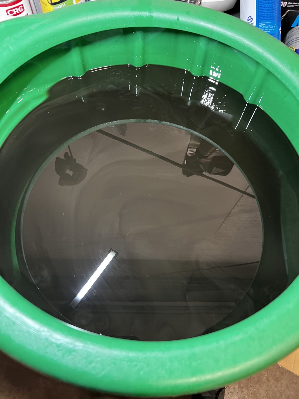

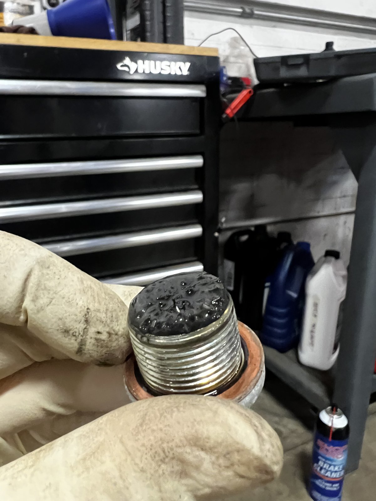

    Did some maintenance. 31k miles.
    Oil change and rotate tires. Every 5k.
    OEM Wiper refill, 2x OEM engine air filter, cabin air filter to Lexus LS500 Charcoal filter.
    Front diff fluid change to Amsoil. OEM honestly still good. Still gold. Probably going to do 60k interval.
    Rear diff change to Amsoil too. Decent amount of metal and glitter in fluid. Definitely doing 30k intervals.
    Transfer case oil looked good too. Probably stick to the 60k miles interval too. Came out still red. Forgot to take more pics. Was running out of time. Had to remove RCI skid plate.
