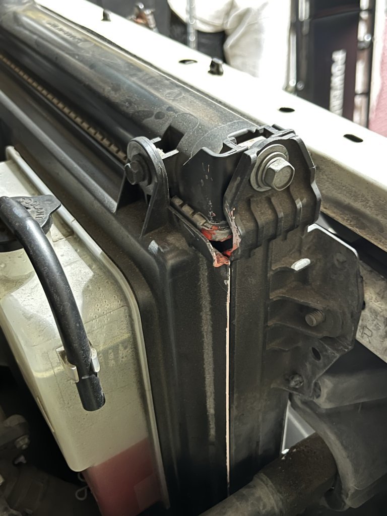

  8. Sep 15, 2025 at 2:15 PM
    joseph_womack
    joseph_womack @ 4x4bound
    Nov 3, 2020
    #54467
    1,357
    Joe
    Louisiana
    2007 RCLB, 4WD, 4.7L V8
    3/1 Lift, 35s, Front Bumper, etc etc
    Yours looks to be the seal at the body of the radiator and then the tank up top, that might stay gradual for awhile but 9/10 times it’ll always get worse
