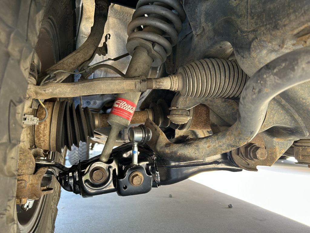

    Finally finished my LCAs. I only drove it around my neighborhood, and while the alignment is a little wander-y, I do wish I replaced my passenger side outer tie rod because the truck steers so much easier with only the driver's side being new. At least that's an easy replacement when the time comes. Luckily I didn't have to cut three of the four sets of cam bolt that were on there because whoever replaced the LCAs before used a generous amount of anti-seize (thx u), saved myself some coin there.
    New OEM LCAs on both sides
    New OEM sway bar end links on both sides
    New OEM driver's side outer tie rod
    Next up, new eibach coilovers & rear reservoir shocks.

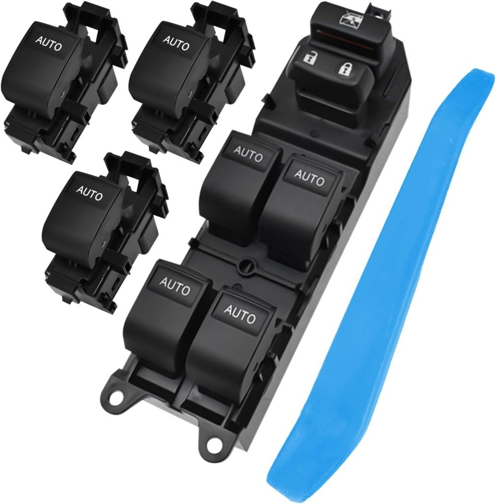

    Installed this cheap upgrade today. Nice to have one-touch auto window controls on all four windows. And the one-touch up as well, not just down. The white LED instead or orange is nice too, but now I'm gonna be tempted to swap all my orange lights, haha. A guy had it locally on Marketplace cheap after selling his Tundra, so I decided it was worth the price.

    Just be careful if you have kids, those switches seem to be lacking the ability to do the anti pinch feature
    grave, OldGuy03 and rmeyer7[QUOTED] like this.
  16. Jul 30, 2025 at 4:20 PM
    rmeyer7
    rmeyer7 New Member
    Mar 10, 2023
    #93599
    165
    Roy
    2008 Double Cab 5.7L
    Thanks for the heads up. My 5 year old always likes his window up, so it should be good on his side. We'll see how the younger one is as he gets older...but we have a couple years before he can reach the top of the window.

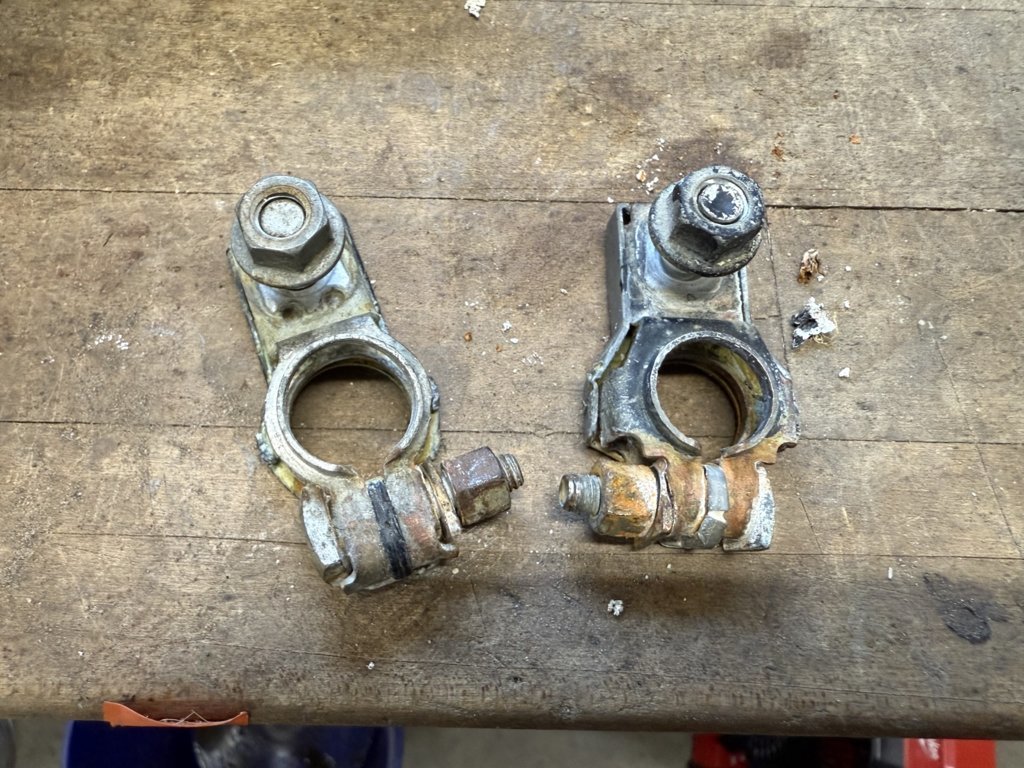

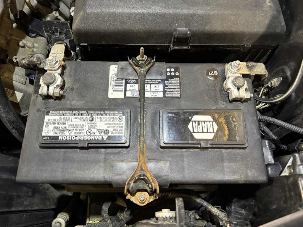

    Cleaned underneath and around my battery tray today and installed new post clamps. It ain’t much but it’s honest work. Does the truck always not start the first time after disconnecting the battery?

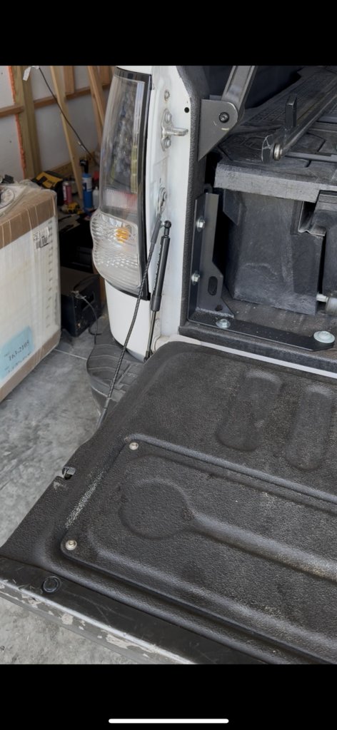

    You don’t have the one inside the driver taillight?
    Wynnded likes this.
  28. Aug 3, 2025 at 12:06 PM
    Hauschm76
    Hauschm76 New Member
    Sep 13, 2019
    #36050
    39
    melanie
    2009 Tundra SR5
    No, it’s the one where you add a metal hinge.
  29. Aug 3, 2025 at 12:20 PM
    Half Assed
    Half Assed me ne frego
    Jul 6, 2020
    #48947
    1,042
    Heartland Florida
    10 crewmax, 07 reg cab
    There's a factory one hiding behind the left tail light that's probably worn out.
  30. Aug 3, 2025 at 2:15 PM
    Hauschm76
    Sep 13, 2019
    #36050
    39
    melanie
    2009 Tundra SR5
    Thanks, thought you meant RC type at first. Yeah there used to be one there but it busted and also took off the attachment point. RC’s was an easy solution.
