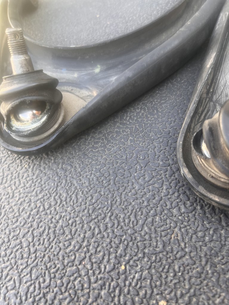

    nice work! i just did the same thing. driver's side finished, passenger side started yesterday. hopefully i have time to finish it this week. i noticed my passenger side UCA bj looks a bit leaky, too =/

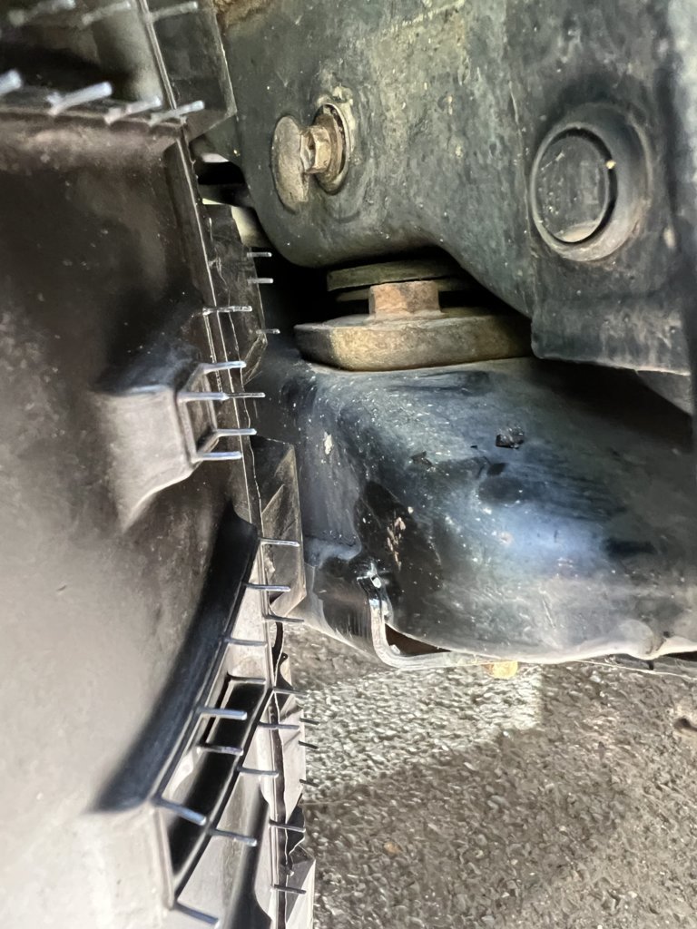

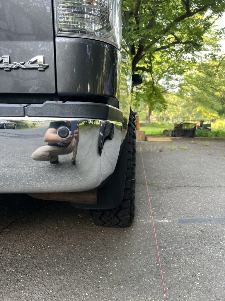

    Driver’s side cab mount and passenger side wheel well plastic. You can see cleaner metal in first pic and then at its peak contact. No contact with skid plate at all. I will be installing Eibach stage 2 pro truck kit along with SBC UCAs

    Oof, just a smidge.

    I was rubbing my body mount on factory wheels with 3” lift and 35s, adding a 2” spacer or wheels with wider offset fixed the issue

    It's exactly at 1.25 revolutions of the the steering wheel, while turning left. I can probably fix it by slightly adjusting caster. And as I mentioned before, I'm gonna install UCAs and coilovers.
    Wheels are at +25.

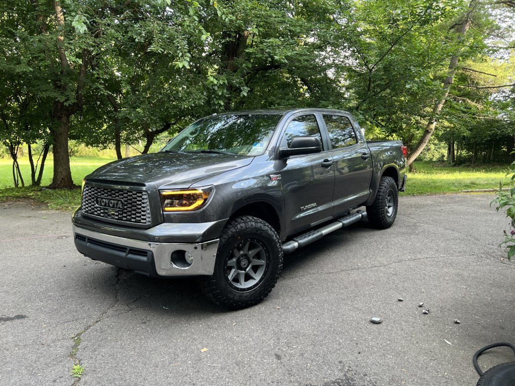

    What headlights do you have?

    Uhhh I always have to verse myself in which direction is positive and negative, but how far outside the fender are they?

    OEs are +60 for reference...

    So with the OE’s and a 2” spacer the wheel was about 1” to 1/2” outside the fender, where are yours sitting now?

    I'm thinking that reduction in offset may be enough to be causing his rubbing; that and not all same size tires are the same size.... 285/75s are about the limit depending on brand for not getting rub w/a +60 offset

    1" outside the fender
    I think that's the case. I read someone here is running the same size on OEM TRD Pros if I'm not mistaken, with no rubbing. I agree that not all same tire sizes are the same size. These are 35.1"

    Yeah might be a hare too big, just chop the body mount and be done; going with more offset might make it worse
