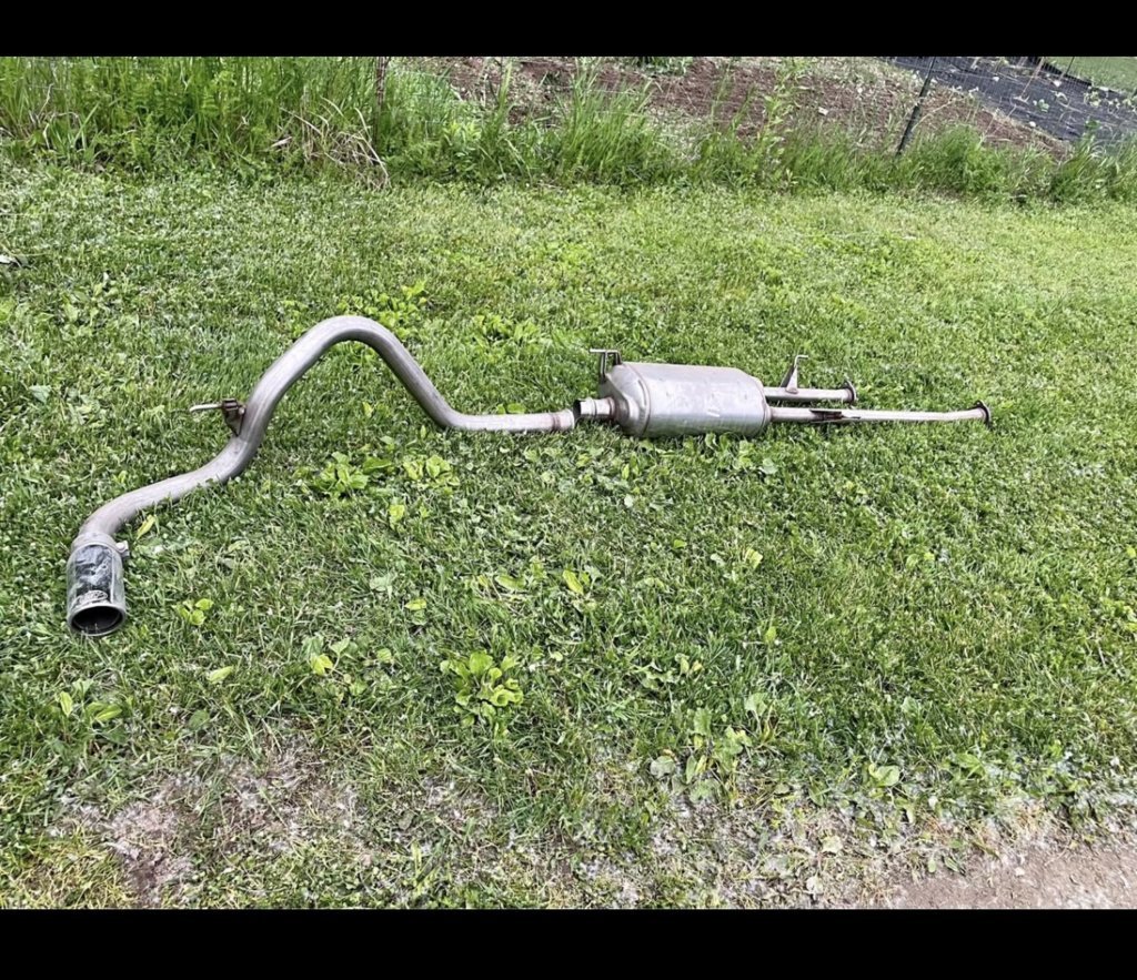

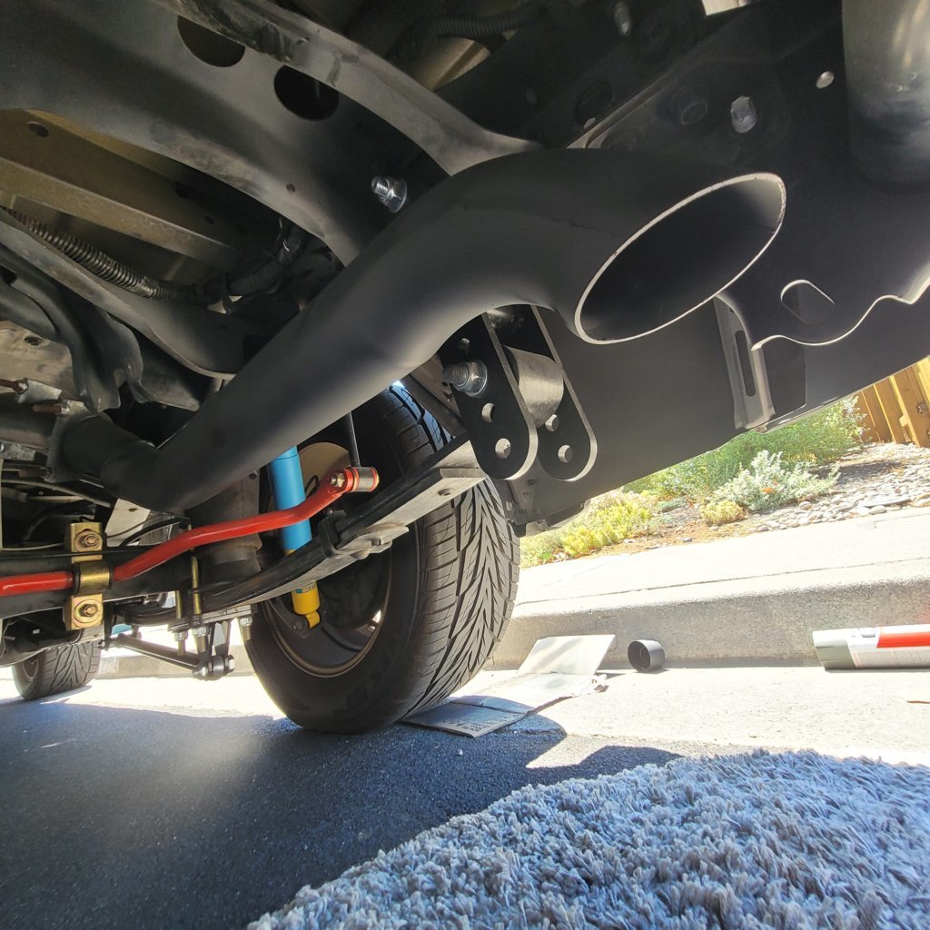

    I found a TRD exhaust from a 2018 Crewmax for sale for $400 on marketplace. Muffler and tailpipe, everything on the Toyota parts says it should fit my 2013 double cab.

    Is it just me, or am I seeing a picture of a stock exhaust fit with a chrome end?

    Everything I know also says that it should fit, BUT, I don't believe the seller knows what they have. That looks to me like a standard exhaust and would probably be a like for like swap for what you already have on the truck. It looks identical to this exhaust that was sold on this site - https://www.tundras.com/threads/2018-limited-crewmax-oem-exhaust-sold.30329/
    TRD exhaust normally refers to the dual muffler dual exit system - https://www.tundras.com/threads/trd-dual-exhaust-muffler-section-w-custom-h-pipe.46730/

    I thought the Crewmax and Extended cabs had different part numbers for the exhaust. I would think the length dimensions would be different.

    Crewmax and Double Cab 6.5ft bed have the same exact overall length and wheelbase, but I don't know the exhaust part numbers so they could very well be different.

    This is definitely not the TRD dual system

    Thanks everyone. Yeah just seemed like a decent replacement for a 12 year old exhaust.

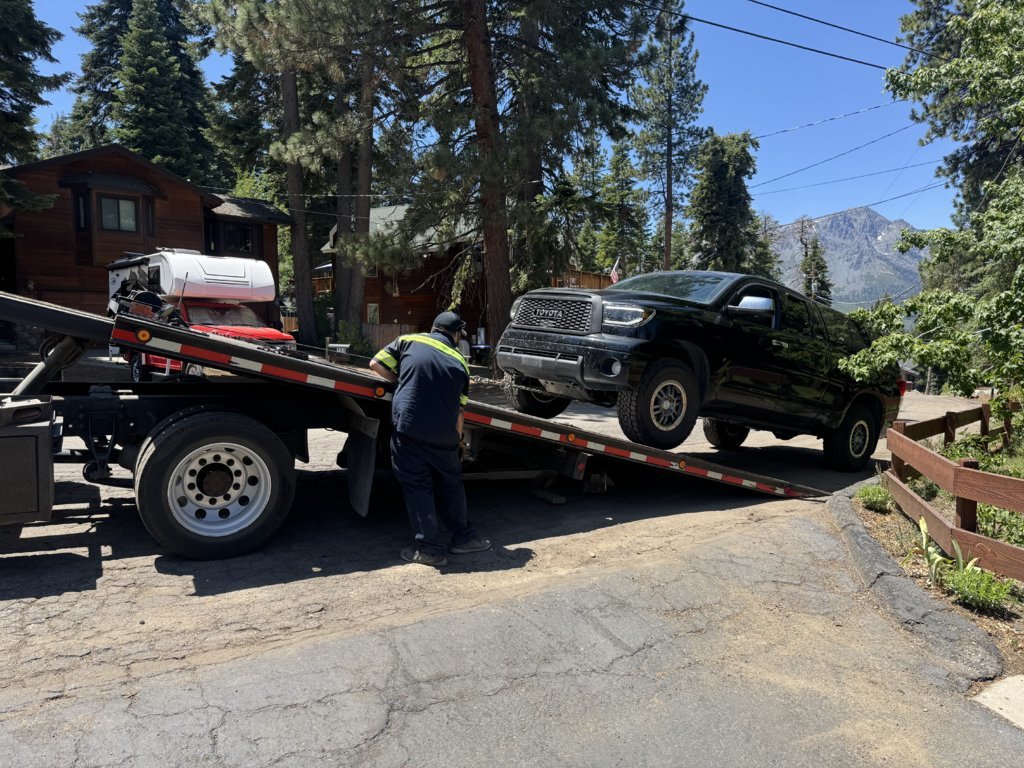

    Said good bye to the old girl today. 20 miles short of 200,000 in 12 years. Drove coast to coast 4 times. Saved my skin in that accident. I’ll surely miss her.
    I’m trying my luck with a 2024 4runner, so I’m saying goodbye to you all too. Thanks for all of the help/advice over the years.

    They totalled it?!?! Shoot!
    [moment of silence..]

    I would of love to buy the wheels and camper shell before they towed it off

    they did. It sucks

    I tried, but the ins company said they’d pay me even less if I removed anything

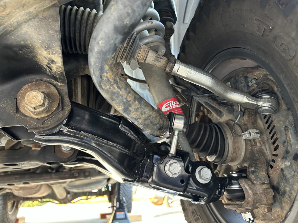

    finally finished my driver's side LCA replacement after a couple weeks on jacks. the shitty MOOG ball joints were toast, the sway bar end link threads were stripped so the sway bar was disconnected on one side, so i just said fuck it and bought new LCAs. from experience, i figured all the bolts would be seized so i ended up buying every bolt needed with the intent of returning what i don't use. luckily the front bolts came out pretty easily, so that's like $100 saved there. it needed a new shock bolt and sway bar bolt, though. and the ball joint on the outer tie rod was toast so i replaced that, too.
    on to the passenger side...

    On average, when do you know you need to replace your LCA's and ball joints? My truck is 13.5 years old now but only has 100k on it. Steering still feels fine on mine. Is this something you will feel or is there a rough time frame to replace these items?

    take a look at your ball joints. visually, mine were fucked. they were loose as hell, wobbled like crazy. they're supposed to be practically immoveable. and i could shake my LCAs enough to see some play in the bushings as well. that and the stripped end link threads made my mind up for me. you can always just replace the ball joint and bushings, but you'll need a hydraulic press to get them out and back in. some shops might do that for you for a price. i didn't feel like adding all that to the mess, plus i have a toyota dealership parts connection, so i just bought new ones.

    Press or the ball joint press tool; you can rent one for free from AutoZone’s or Oreilly’s

    Depends on driving habits, road conditions, on or off road; not necessarily a time frame for when they go bad
    when they are bad you might hear a clunking or popping when accelerating or braking, possibly turning the wheel or hitting bumps; you can verify by getting the wheel off the ground and checking for play
