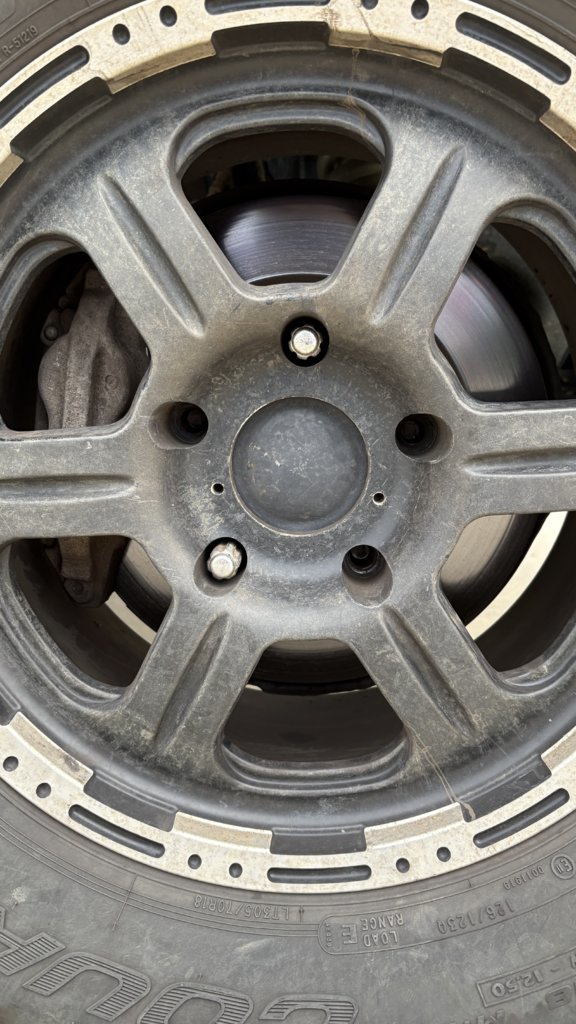

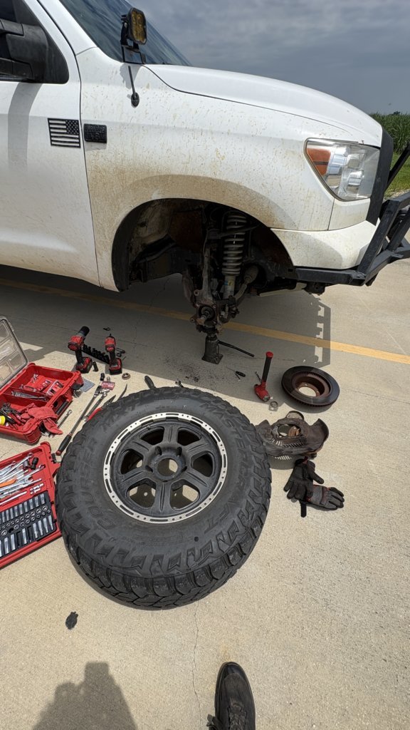

    Managed to break 3 lug studs on the highway; but I was blessed two held and I could pull over; limped it to the O’Reillys 5 miles away and left it overnight to swap in a spare hub assembly I hadIMG_4607.jpg IMG_4603.jpg

    Loose wheel broke them?

    Honestly I’ve been scratching my head about it; it’s been driving fine, no wheel shimmy to indicate the wheel was loose; but the wheel was indeed loose when I tightened the two remaining lugs

    That's usually what will do that. Did you have that wheel removed recently?

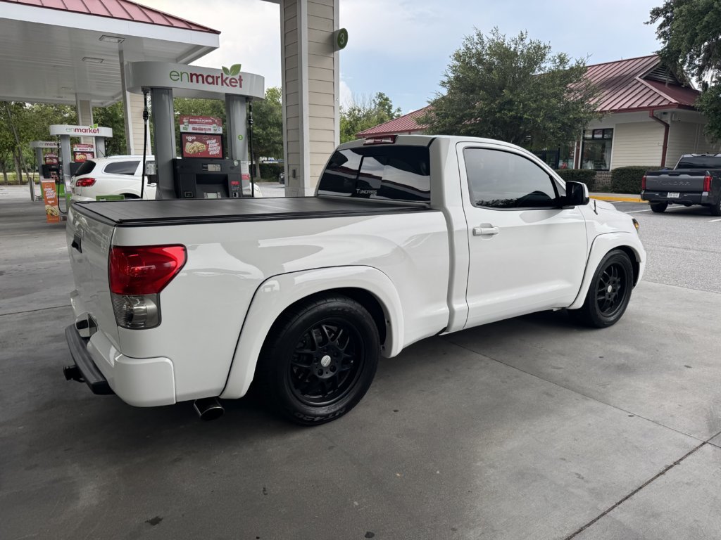

    Damn that looks good. That's just the belltech 2/4 drop and that's it?? Looks slammed

    Yeah I know
    but no, wheel has been on for about 1k miles since when I changed the tranny
