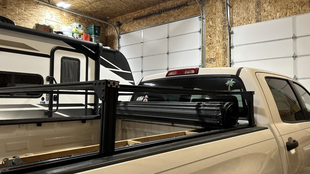

    A few... Definitely more than 2

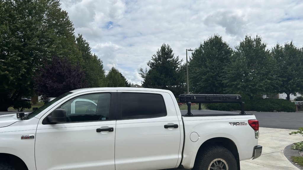

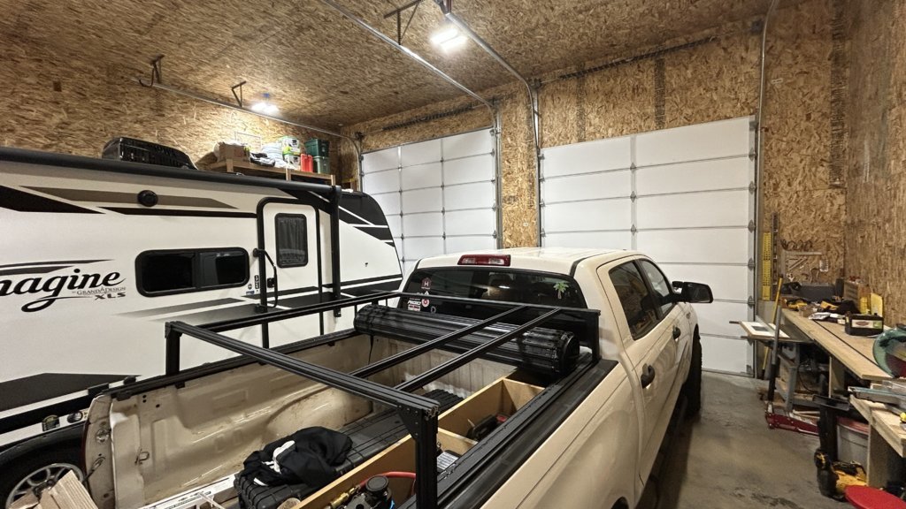

    Custom bed rack to go along with the tracks in the new cover.

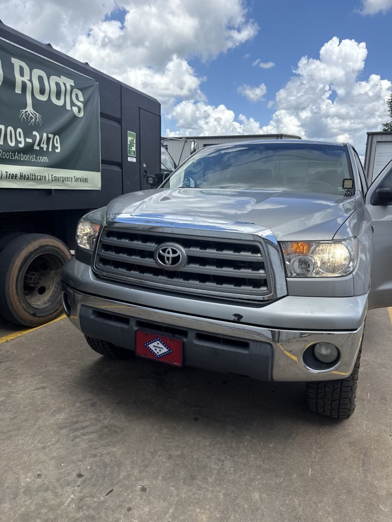

    Added this 13 sequoia grill today. Had to do some minor configuration to get the top four brackets. ( just used different bolts ) it rides fine but there is gapping at the bottom. I’ve read into some other forums on here about lower brackets for needed for the 07-09 that come on the 10-13. Have yet to find them anywhere but as of now it rides fine. Going to paint match soon.

    I know when I swapped my 07 grill I had to replace both brackets. I found some knock-off brackets on ebay that worked with a little persuasion.

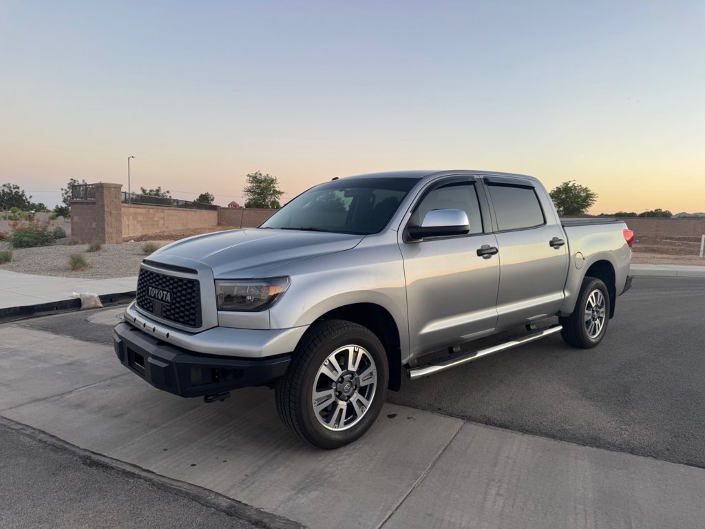

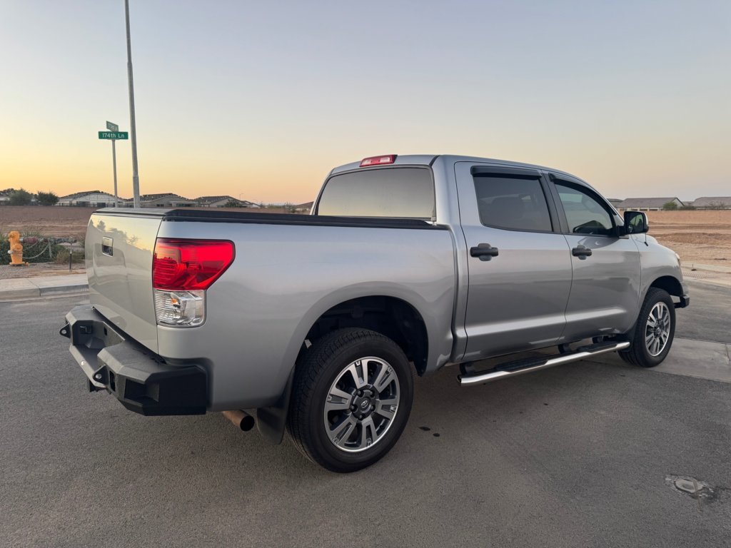

    Swapped a bunch of parts off the new to me 2021, got it cleaned up, and . A bitter sweet moment for my Toyota resume!
    She still cleans up nice for 173K miles - someone will have a well equipped Tundra!

    I have used 80/20 for so many projects, your imagination is the limit.
    80/20 is the best...until you need to click "pay now" lol

    True, I was going to buy from them, but I shopped it around after I built my cart and found tnutz.com. It cut the price almost exactly in half which definetly made my wallet happy :thumbsup:

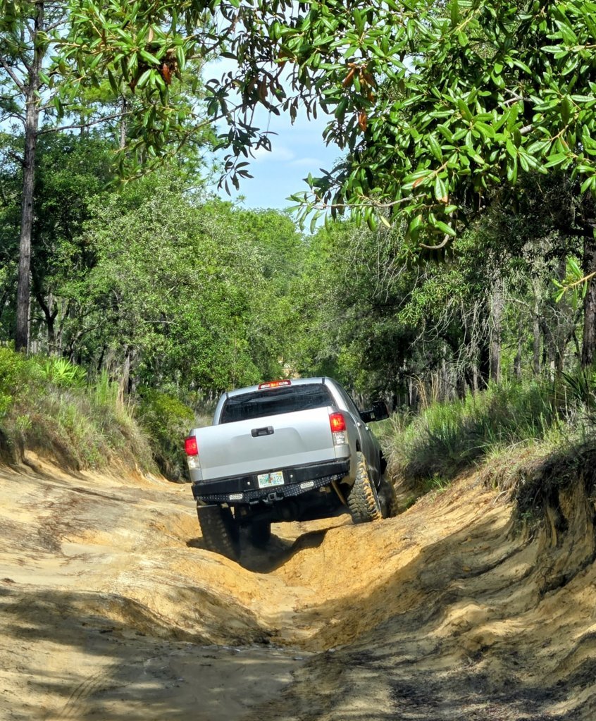

    Ill be cleaning the engine bay but figured I would share the latest thing I did in/to my Tundra.

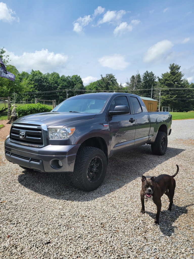

    Gave it a makeover. I didn't do the painting.

    Looks great!
    Did you go with VLEDs or OEM? I did VLEDS.

    Went with the vlands. How has yours held up?

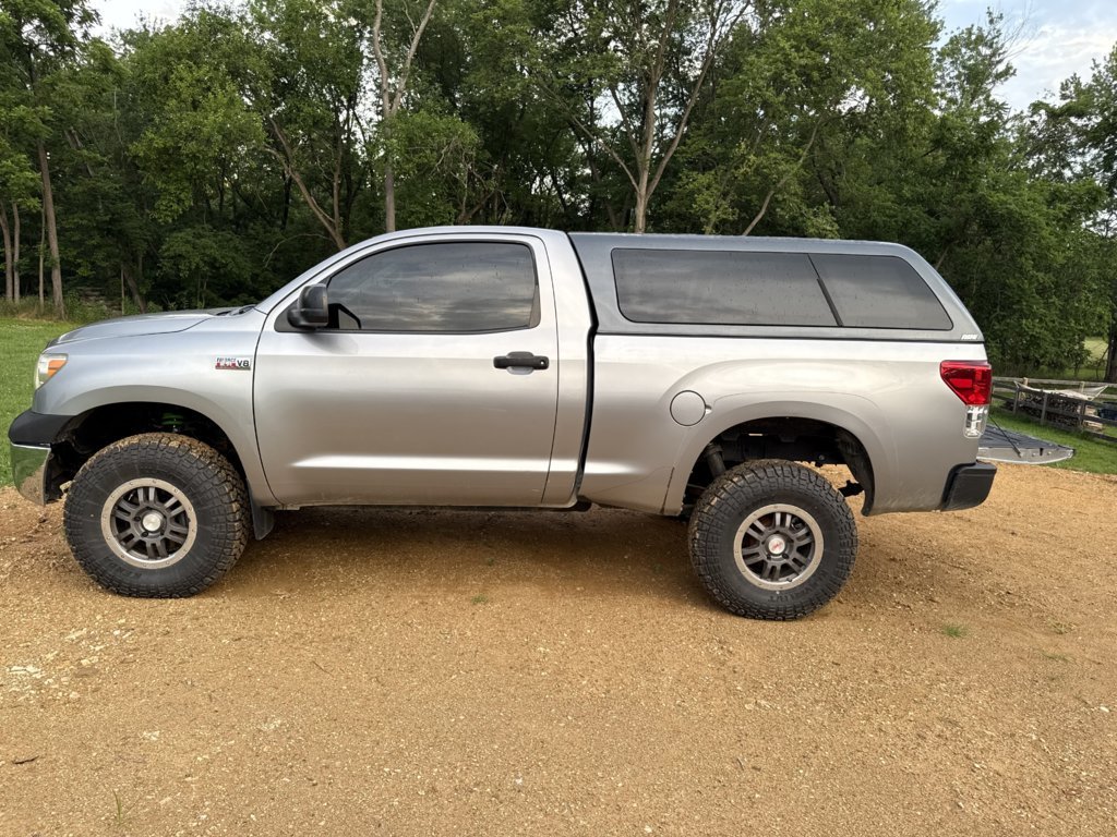

    Found a topper on my way from GA to VA
    Had to get creative to load it!

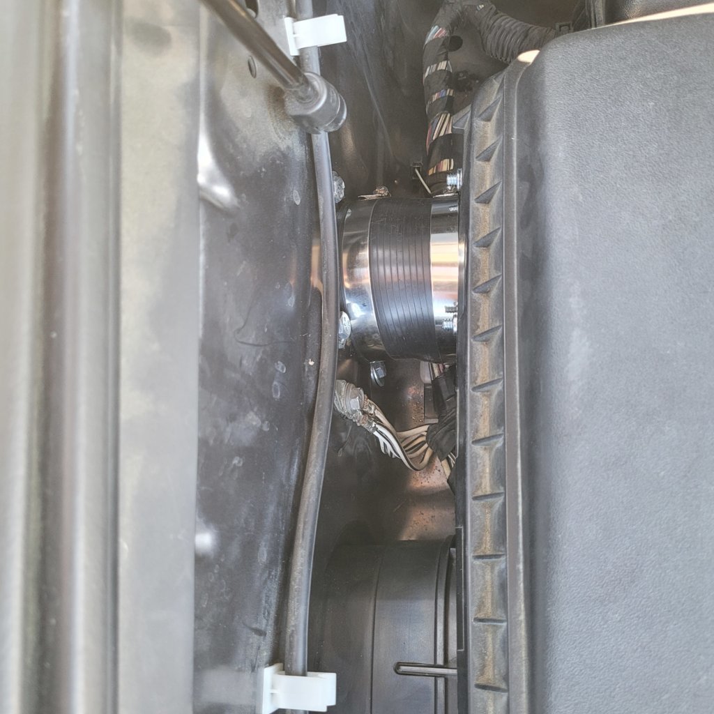

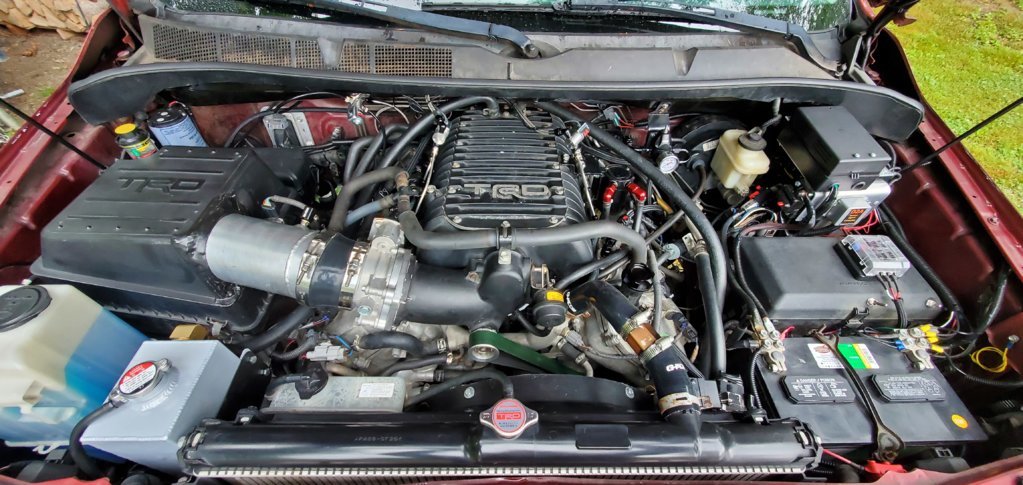

    Replaced snout bearings and coupler in the tvs 1900. Installed Snow W/M direct port injection with nozzle at intake for rotor cooling. Installed Mitch Made billet carrier bearing. Oil change Mobil1 0w-40 Euro spec oil. Antifreeze change with new T-stat.

    Still holding up great! Hope you like them!

    Sweet lookin' rack! When you say custom, do you mean you had this fabricated specifically for your setup or you found this from a vendor? It appears to be super lightweight, and by the looks of it your cover works perfectly underneath it.

    Custom is a bit of a generous description of what I did:rofl:. Basically, it is just generic aluminum extrusions that you can purchase from many different vendors. The most popular and well-known being 80/20 (https://8020.net/), or Tnutz.com that I bought from, and many others. I just needed a tape measure and a bit of imagination to come up with what I wanted it to look like, and then I ordered sections cut to whatever length I specified and picked connectors to go with it.
    My inspiration was the Xtrustion Overland XTR1 rack, but they did not have an option to do the low rack that I wanted, their starting price is $1,500, and any options just go up from there. I also was not convinced that any angle on the rack would work with the roll-over design of the Bak Revolver, so I opted for straight vertical legs on the one I built. My final out the door price, after the painful $90 shipping fee, was $415 and the shipping weight was only 26 lbs :eek:

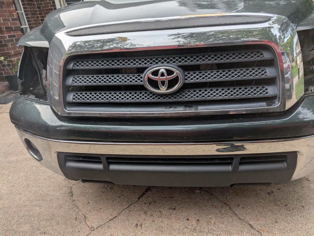

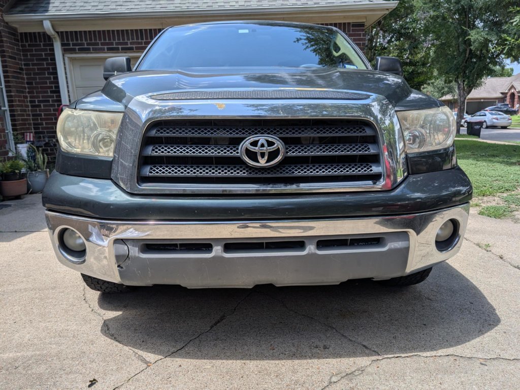

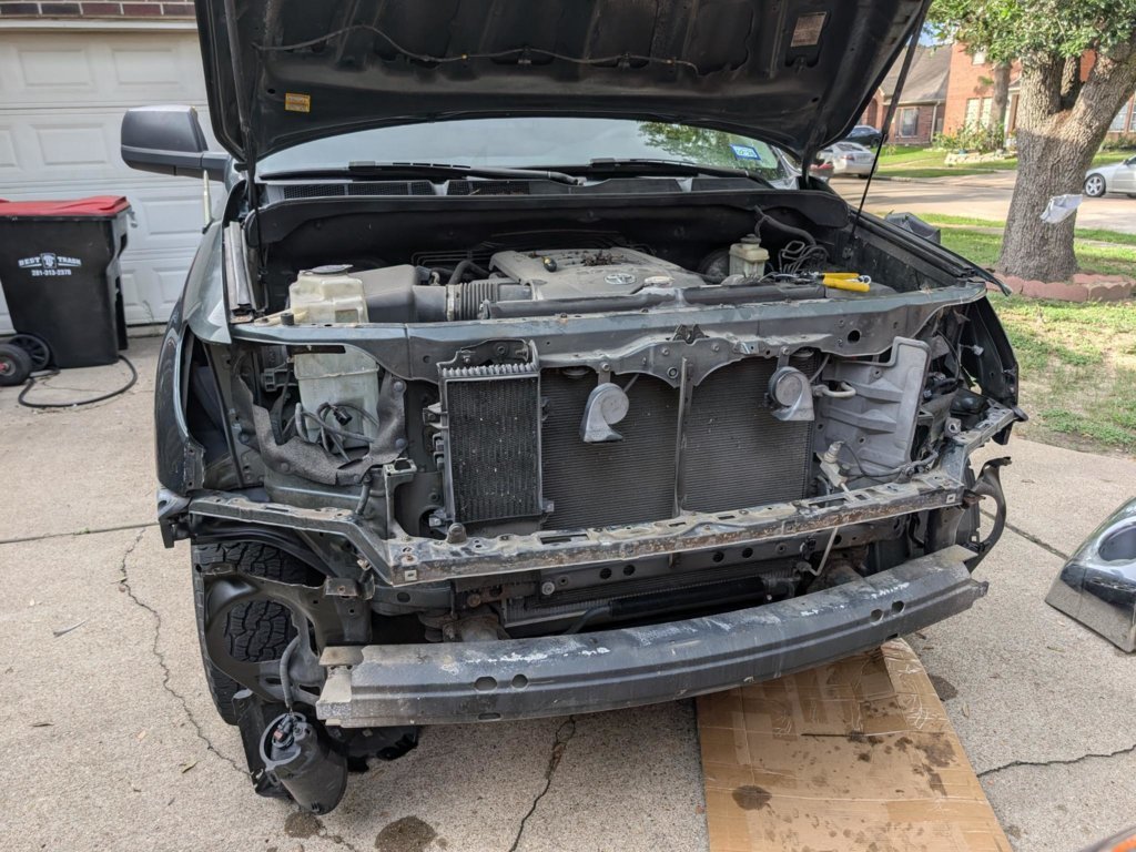

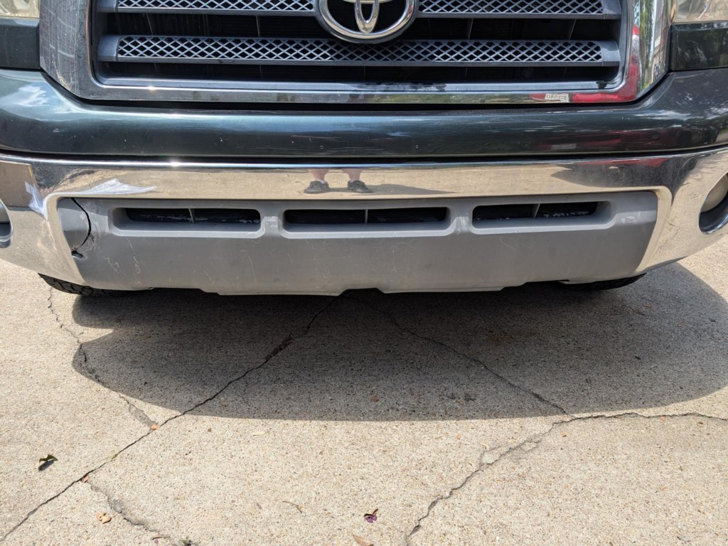

    I had some minor damage that happened a few weeks ago, so I had to replace the lower valance on my front bumper. I liked the look of the 2010-13 valance but couldn't find any confirmation that it would fit my '08. The bumper part number was the same even though the valance wasn't, so I rolled the dice. Discovered that it's a direct bolt-on replacement, so if you ever want to upgrade your early 2nd gen with the later 2nd gen valance, it will work. Bumper removal was necessary, headlights were not. But I took them out because I'm also planning to sand off all the yellow, do a full restoration and clear coat on them. Also want to replace my grille since it has some cracked off chrome. Replacing one part has turned into a larger facelift project...

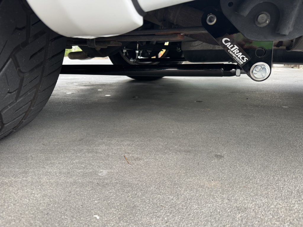

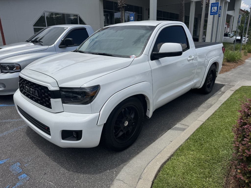

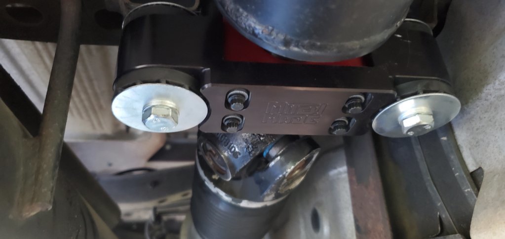

    Just got put bell tech kit on and track bars

    Another view

    That thing is slick!!

    That bell tech kit is low, looks real good though. Looks like a 3/5 drop compared to me. What tire size are you running?

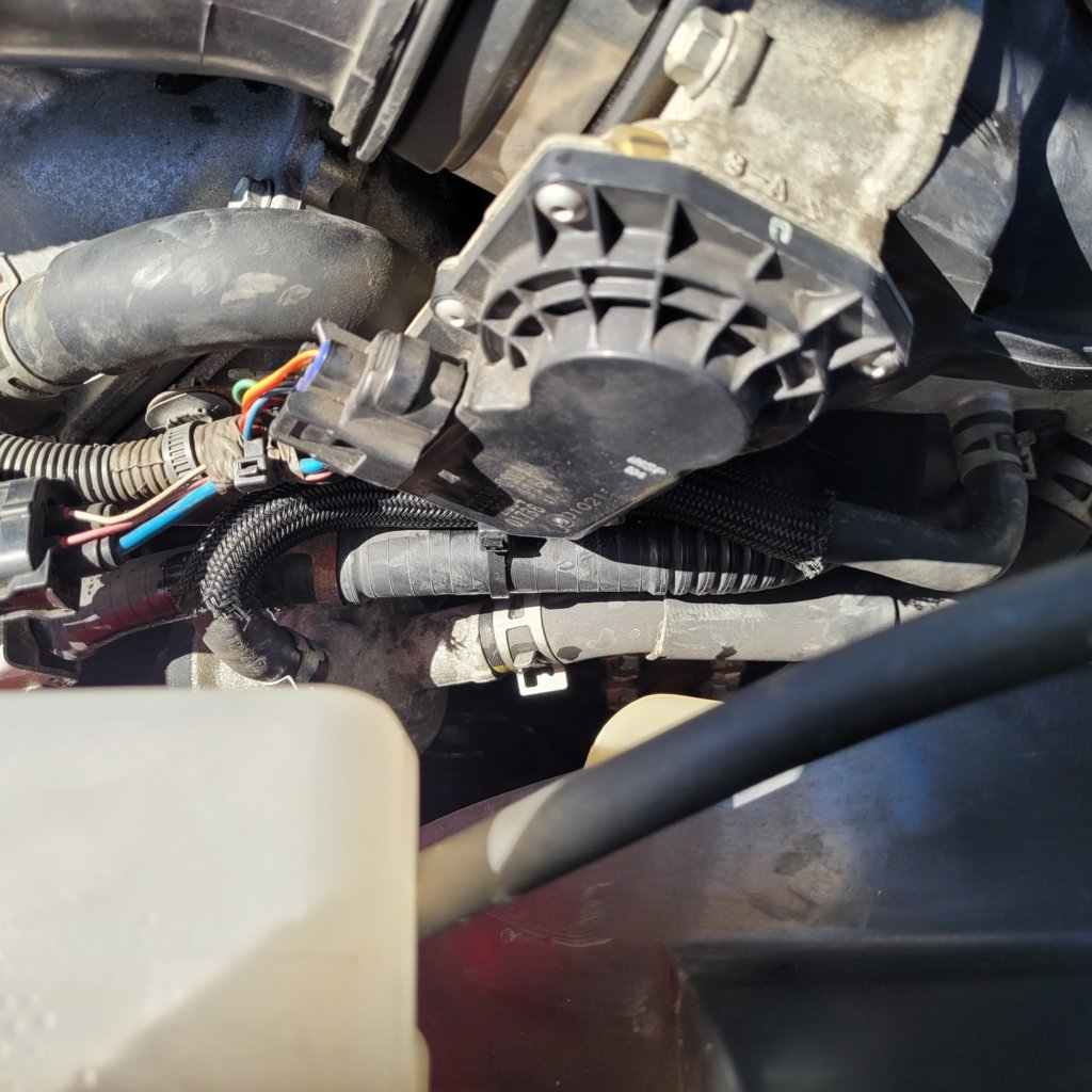

    Finished up the SABM/added the Toyota Vornado and throttle body coolant bypass today in preparation for the Whipple. Need to clean up the tb and burp the system still.
