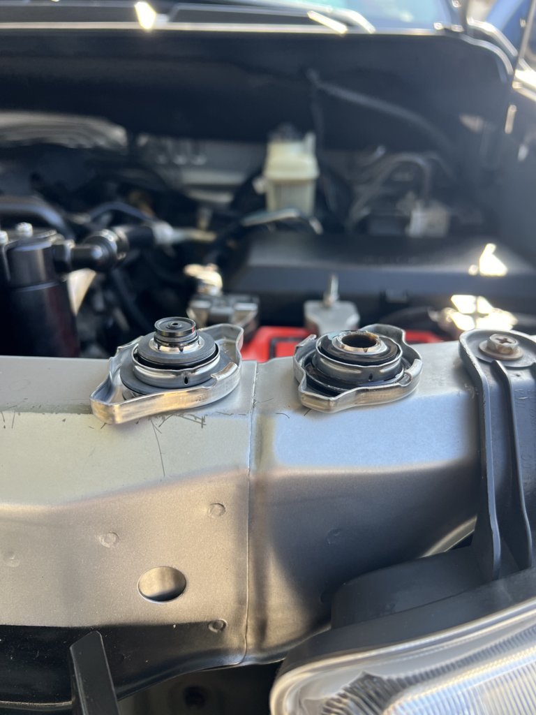

    New TRD vs old stock. Mine broke and I had to go fishing.

    I feel like mine was on its way to breaking. The trd cap is super high quality

    Hell... I didn't even know I needed a new radiator cap. Damn you guys....

    The TRD cap along with Toyota red coolant(not premixed) will give extra cooling range. Raises boiling point a little bit.

    You totally NEED one lol

    It’s a mandatory replacement item every 100k from what I have seen

    pop the cap off and give it a quick inspection. If anything have one ordered and leave it in the truck when you need it. There’s been other members like myself who chased overheating issues due to a broken radiator cap in the system

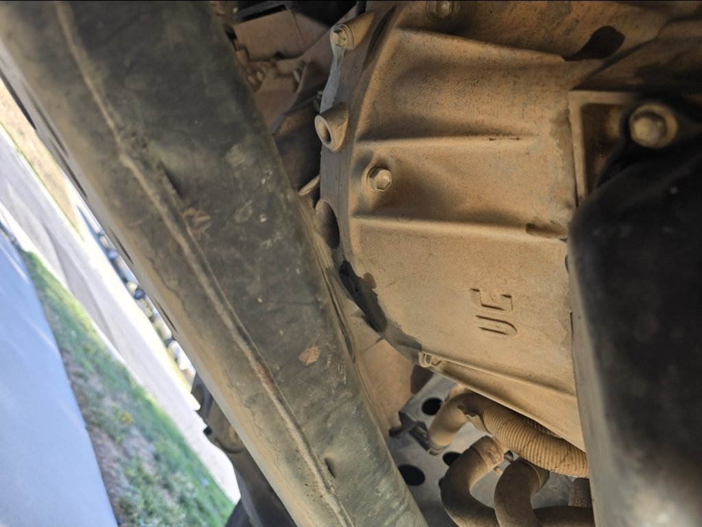

    Changed my oil yesterday and transmission fluid and I have a leak. Looks like high engine, rear main seal getting worse?
    Screenshot_20250525_081112_Gallery.jpg Screenshot_20250525_081029_Gallery.jpg Screenshot_20250525_080952_Gallery.jpg

    Are you actually showing pics of a 17 year old engine?
    If yes, then you got nothing to worry about.
    A tiny amount of oil will travel a loooong way.
    You should not lose any sleep over this.

    By the way it wraps higher up check your valve covers and that side of the block, if it was just at the bottom then I would say rear main but…

    17yo and 312k I'm sure I'm good. Lol

    Actually second thought; 1. Again probably not rear main because it looks like coming from higher up
    2. when I pulled my trans years ago I thought I had a rear main before but it was actually leaking a little at the back of the upper oil pan, so when I put the new rear main gasket in I added some silicone and that fixed it (so you could have a similar problem and it’s leaking out the side of the bell housing)

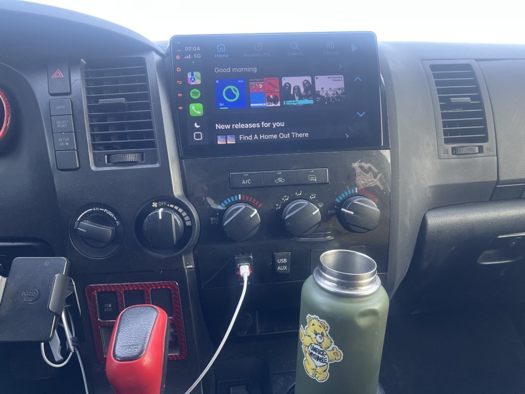

    I only have one photo right now, but here's my 12 RW interior paint job. I didn't leave any silver/dark gray. I used some eBay TRD red carbon fiber to accent the rings on the dash cluster and around the base of the shifter. I also painted my shifter knob red. SEM paints and adhesion promoter.
    https://ebay.us/m/a4zq3M

    I couldn't figure how to get rid of this last bit of silver and still keep the dial displays where the dash lights come through. A future project I guess. Eventually I want to replace the climate control nobs with the AJT design ones in black with the red "bolts".

    The climate control knobs were an eBay purchase. The 4x4 knob was from Toyota parts department. If you search around the climate assembly can be had used for $60-$90 and the 4x4 knob can be had for $80 or so.
    Edit:
    eBay black climate assembl https://ebay.us/m/sHCFmY
    eBay blackout shifter knob
    https://ebay.us/m/kSoCDC
