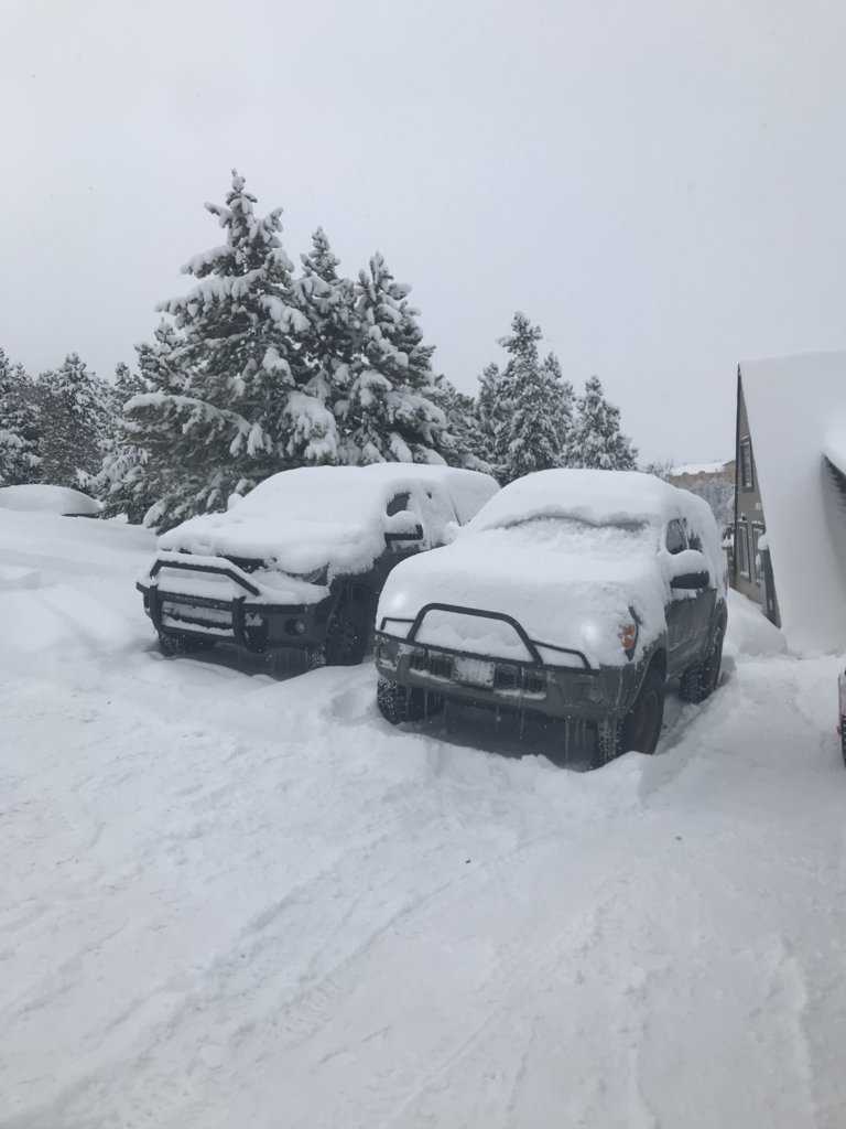

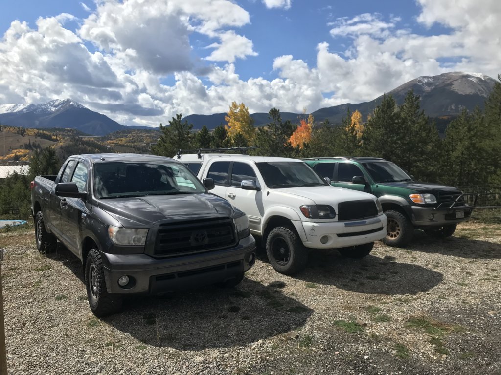

    1st. 04 sr5 in jade mica. Other than the clear coat deteriorating its in great shape. Not the best pics but here's a few.

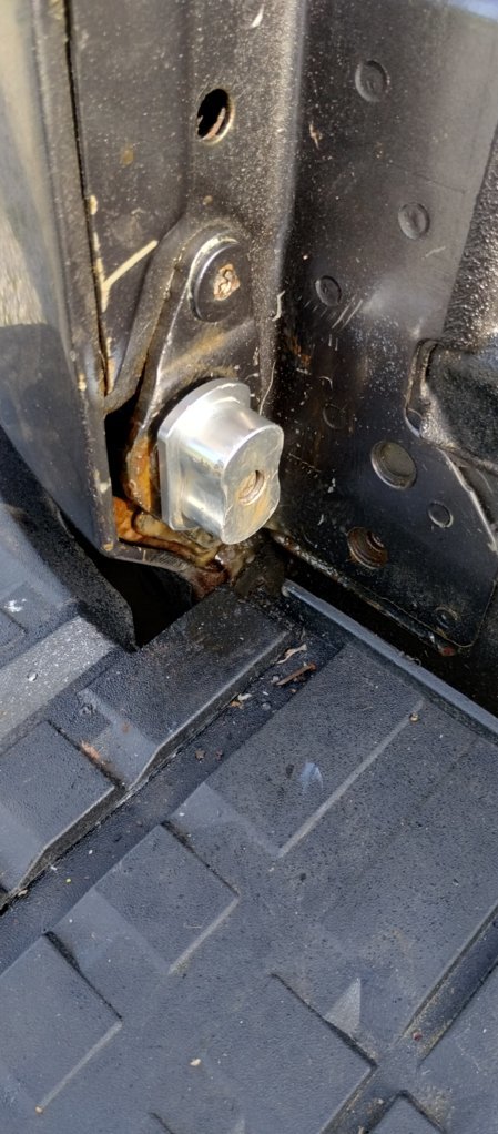

    Replaced my tailgate shock and also replaced the broken plastic bushing with this aluminum one. Had to use the Dremel and sand out the receiver side of the tailgate and sand the bushing some as the initial fit was very tight. We'll see how it holds up. I plan to keep some grease in there to prevent any oxidation since it is aluminum against steel.

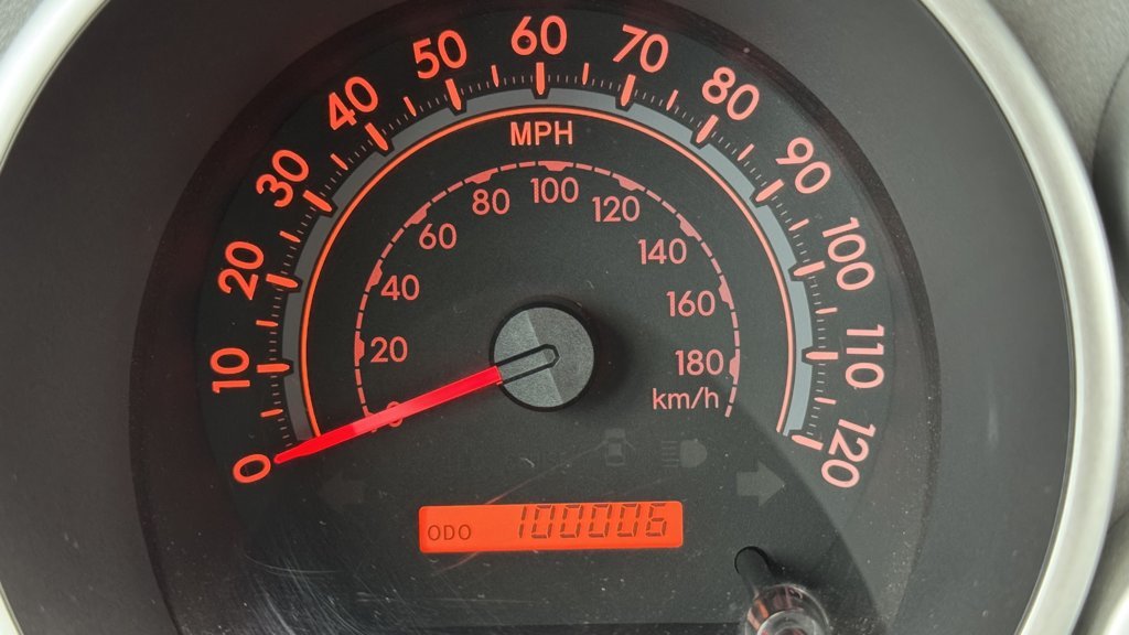

    Well my 13.5 year old Tundra finally broke 100k yesterday on the way to work.
