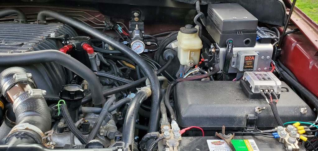

    Chrome delete, Sequioa grill, bed lights, LED + head, fog & tail lights, Dynamat throughout, front & rear cameras, Pheonix PX6 13" head unit, 8" subwoofer, JBL speaker upgrades, tonneau cover, custom shifter, steering wheel cover
    Congrats!
    You skipped a few steps though. Did you do the install yourself? How was that? What about the ECU programming?

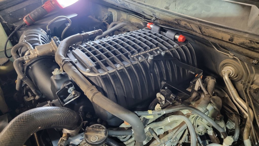

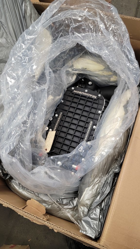

    The Magnuson is a dream come true. It's been on my radar for a long time. It's every bit the cat's neow! Haven't turned on the radio in the truck since the install. My truck makes beautiful music by itself.

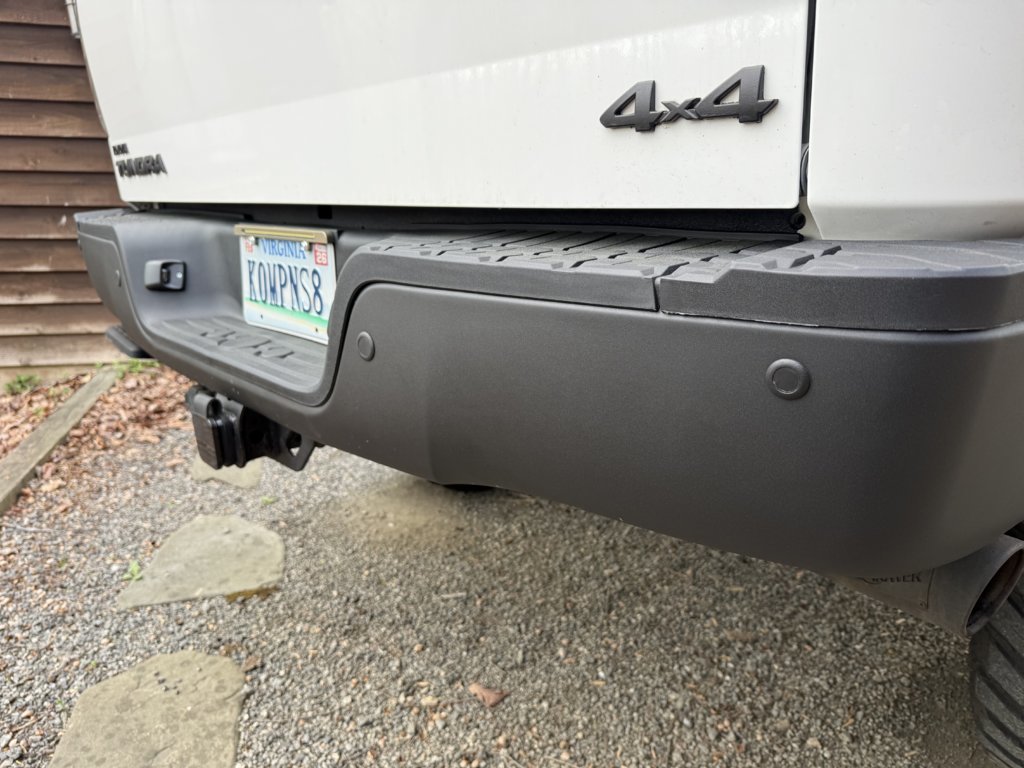

    I replaced the rear bumper on my 2012 Rock Warrior with a brand new Toyota replacement bumper. It was cheaper to get the brand new one than to have the original one taken off, cleaned up and resprayed. Anyway, now I have to clean up the rest of the truck to make it look as good. Don't mind the dust on the bumper already.... I live on a mile long gravel road.1000003678.jpg

    Total, installed was right at $500. Realistically, I was just lazy. The original bumper had surface rust on it. I was just too lazy to pull the bumper off and strip it. I probably could have removed the original, had it media blasted and then rattle canned it for $200-300. That said, I've had several projects going here on my land that took precedence.

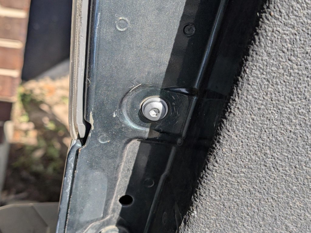

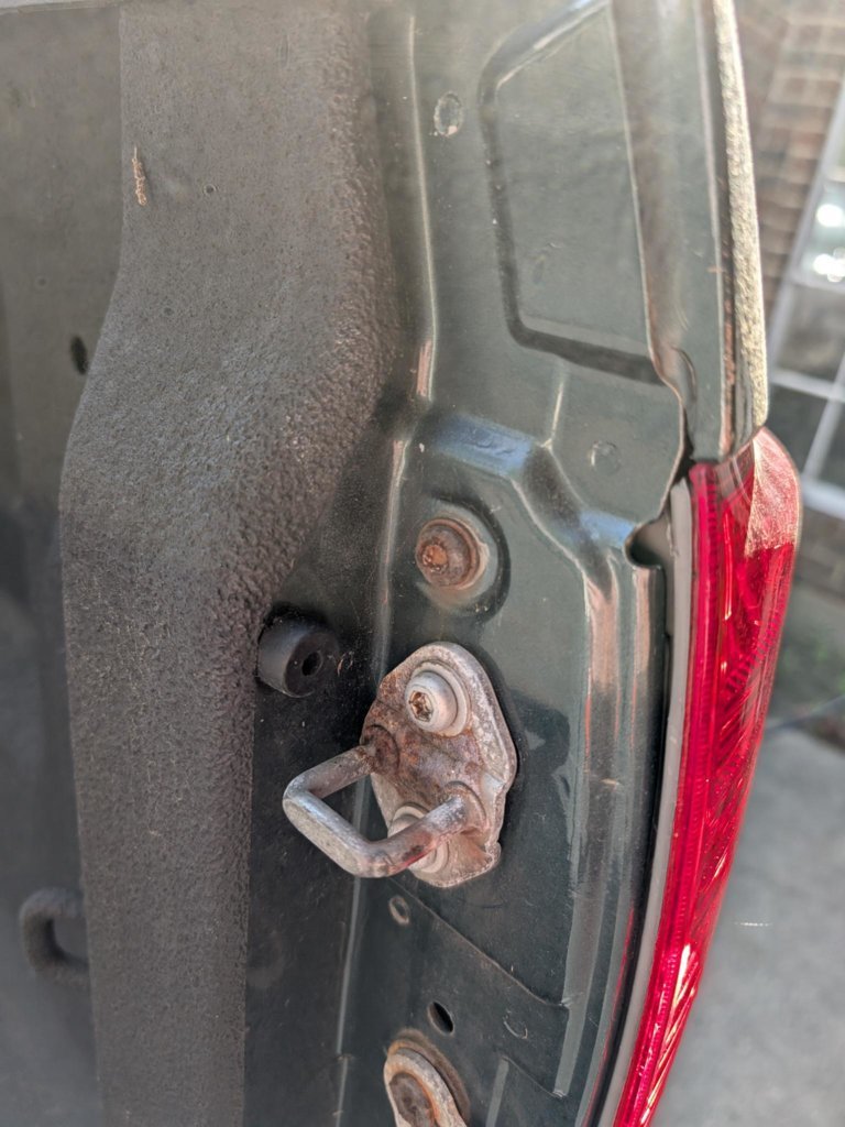

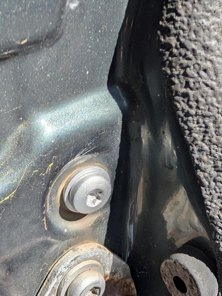

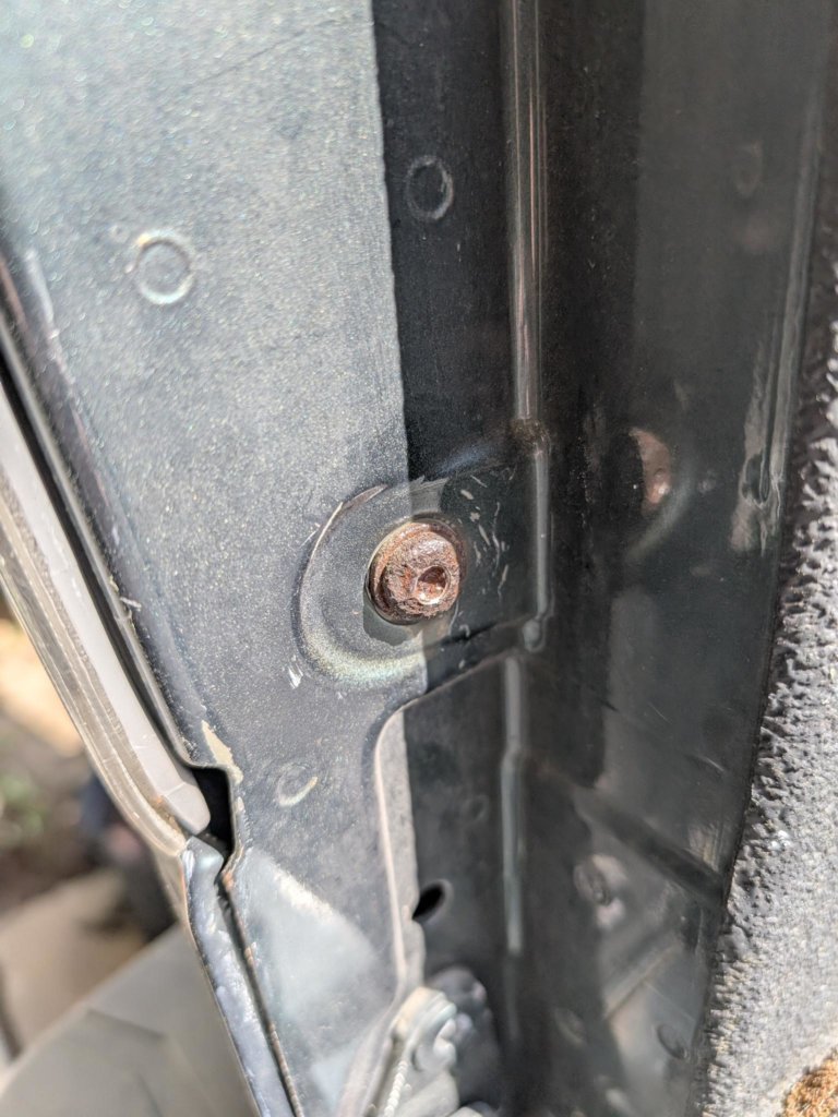

    When I swapped my taillight assemblies a couple weeks ago, the old bolts were rusty and one was stripped so bad I had to turn it with pliers to get it out. So, just a small thing but I got a new set of them and now they make everything else look its age...might have to replace some more hardware around the tailgate soon.

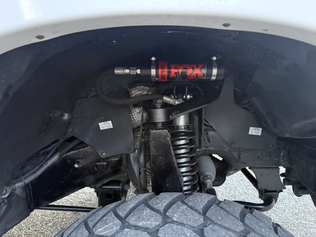

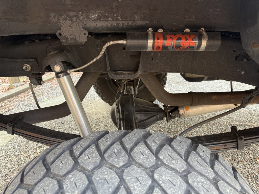

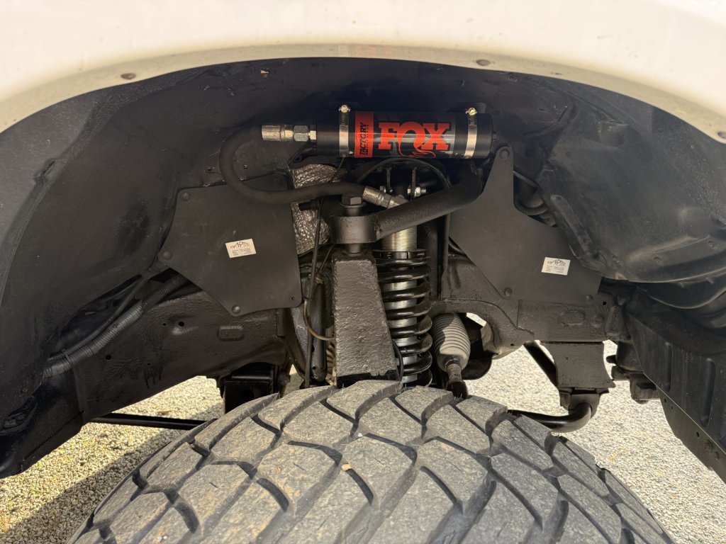

    Also bought a set of brackets to install my front reservoirs above the shocks. However I’m not sure about the clearance if the upper control arm moves up. If I decide to stay with this setup I’ll get longer hoses to route through the control arms. If not, I may locate them towards the front of the frame vs the back of the wheel well like they were before.

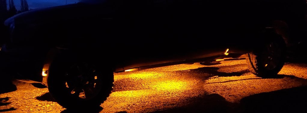

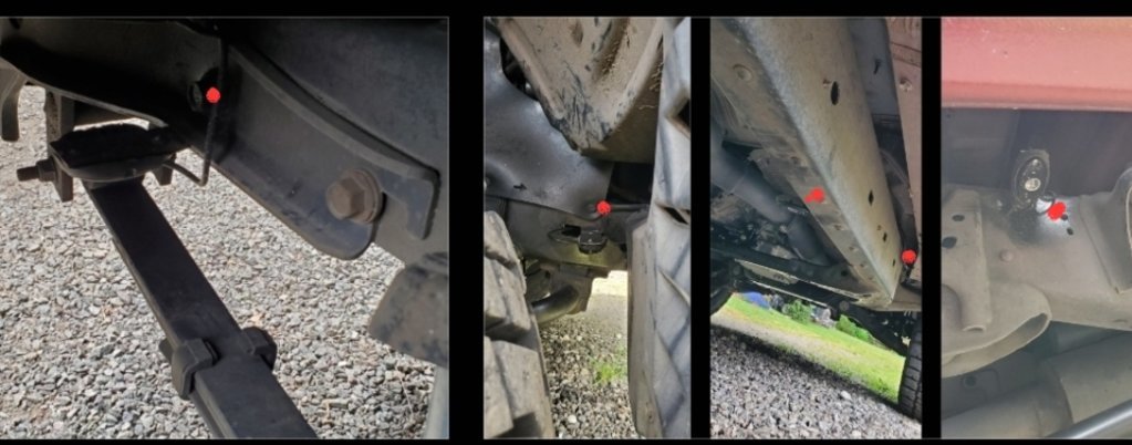

    Finally installed rock lights, 5 each side, from last year. I welded tabs for the rock lights as I wanted them in specific areas. Triggered by the footwell door lights/fob/unlock and a separate switch to turn em off or on independently. Used negative switched wired solid state relay with a diode. Also an independent switch to have on without door open. A oil change with my 5w-40/30, 5qts each, mix and a new wix 51516xp filter. Switched up to 16qts of AISIN 0WS atf from the DEX3 I was running. Will try type T-IV next time. Installed a relay box to try an tidy up my wiring mess.

    i had the same lights under my civic 25 years ago

    Over the past couple months I’ve replaced my suspension, front and rear brakes and rotors, front dust covers, and this morning I replaced the rear bumper bc my OEM chrome with plastidip had finally started peeling. Still not sure I’m keeping that reservoir location on front.

    I would change that resi location before you bust them open hitting a bump too fast

    It’s definitely too close for my liking, but it’s not as close as this angle/photo makes it look. Suspension is also pretty stiff so not much movement either. Will definitely locate to the frame area in front
