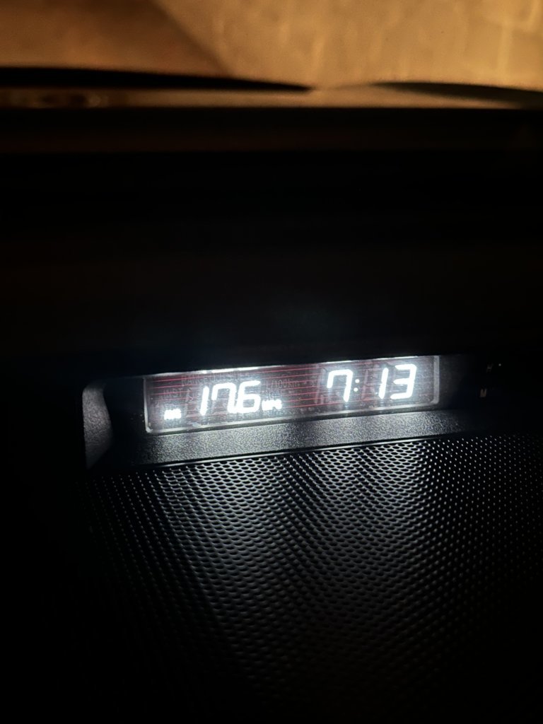

    I always hand calculate and my milage is always better on the trip cpu compared to my calculations. Gotta be a marketing thing so they can claim I'm getting 14.6 when I'm really getting 13.5

    I think it’s just really the fact that it’s showing you your current mpg and not the mpg of the whole tank

    Toggling through settings I can see data for current, avg, and miles to empty.

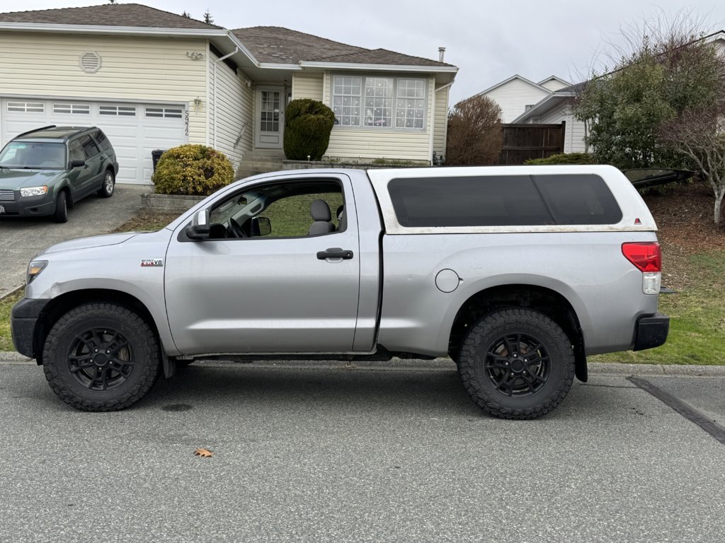

    Yesterday I drove up north about 30 miles to respond to FB ad for Leer 100XL cap for $500. It was not bad but doesn’t clear the cab of my reg cab. I had to look!! Anyways, turns out it was left by the guys wife’s ex-husband about 8 yrs ago and had been cluttering up the yard. Got onto the truck all covered in mud and slugs. Told the guy it just didn’t work. He says ‘look it, just take it we want it gone!’ So there. A FREE Leer 100XL canopy. Haha. Free has a price. I’m having a bitch of a time removing the key latch. Totally corroded and seized. Maybe tomorrow after the penetrating oil has got to it I can remove to replace. Also went by local wrecker and picked up intermittent wiper switch from a 2014 Tacoma, which took almost 2 minutes to switch out. So less than $100 and some gas money. Pretty good couple of days! LOL.

    Nice score! I think the topper looks good at just below cab height for what's it's worth.

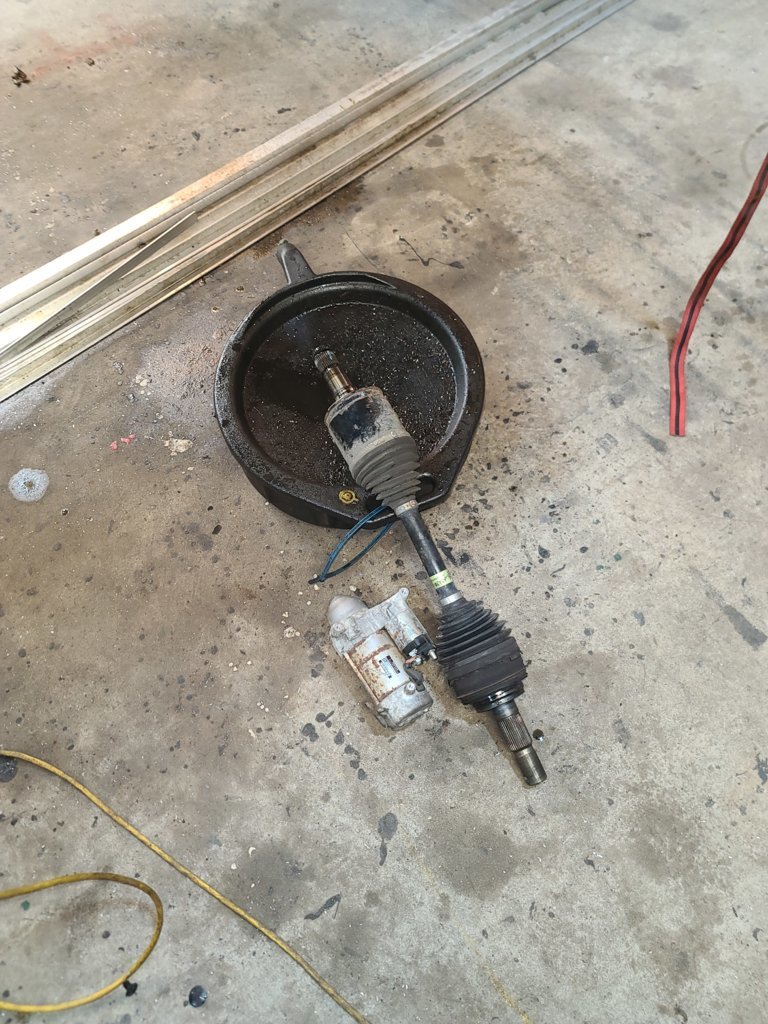

    4 hrs to pull a starter.
    Why don't the vids tell you its easier to remove lower ball joint boltsto remove the axle?
    They want you to pull the upper ball joint nut and remove all the brake and wheel speed sensor wires. Job still sucks when you have a 4wd and transmission cooler lines to work around.
    Pick up the new starter tomorrow. Hopefully the install is much easier.

    Yes, it is so easy just pulling the lower knuckle bolts/axle bolt and swing it out of the way. I've never pulled the axle to do the starter. Even with long tubes I just pull the passenger manifold now.

    Seems there's several ways to skin this cat. I just jacked up the passenger side of the engine :notsure:

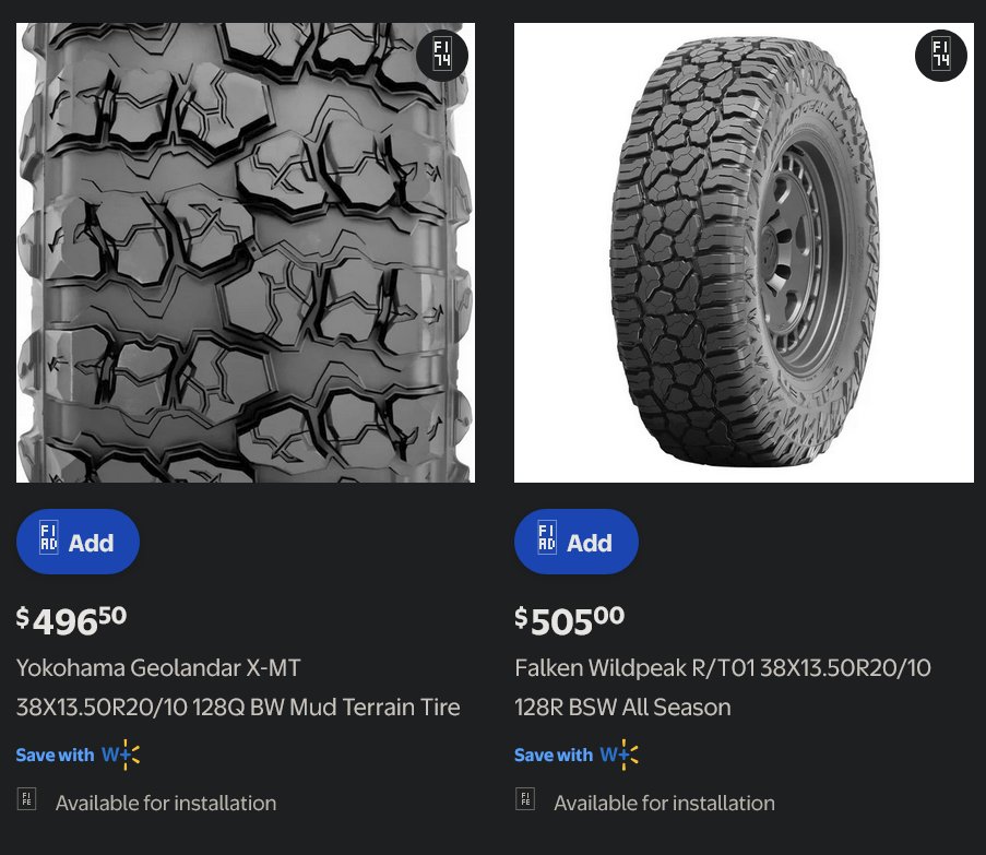

    Anybody know the best deals for some 38/13.50R20 MT’s?
    Found the Maxxis Razr MT’s, same as what I have now, for 515.00 a tire with free shipping.

    a few
    walmart has the yokohama mt for 496, and the maxxis razr mt for 468
