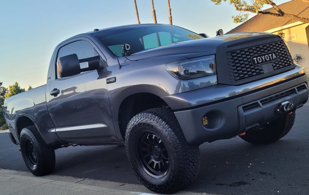

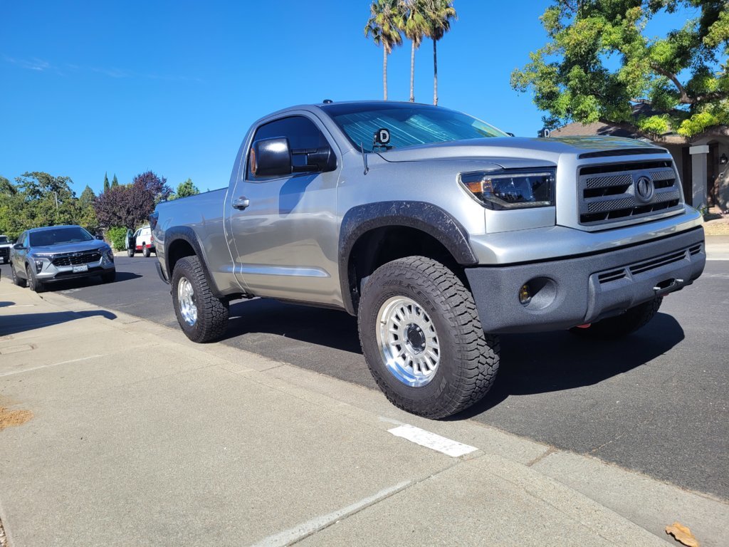

    Yessir it was, thought I'd try something else. I have a hard time keeping anything stock/normal etc.. mind is always on.

    I like the mgm color but it shows dirt so easily. That silver looks so clean and fresh.

    Paint or wrap?

    It's a wrap.

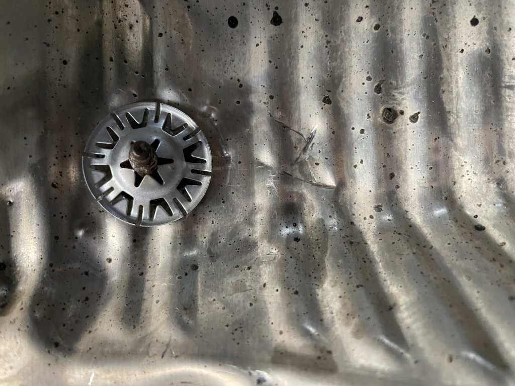

    Replaced a cat heat shield nut that was rusted through with one of these. IMG_9826.jpg

    I can appreciate it, I can’t keep anything stock. Need info on those flares.
    They look fairly low profile and smooth. No bolt holes or anything.

    I got the ebay version of these;
    Bushwacker OE Style Factory Front & Rear Fender Flares | 4-Piece Set, Black, Smooth Finish | 30910-02 | Fits 2007-2013 Toyota Tundra Fleetside w/o Factory Mudflaps

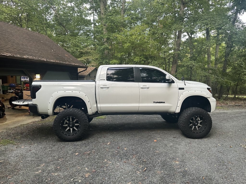

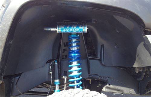

    What happens with that front reservoir hose when you hit a bump? Looks like it’s right on top of UCA at rest.

    It is close, and I mentioned I want to change that, but it’s not resting on it. There’s enough room for travel for now.
    I want to find a bracket that will allow me to mount it right above the shock itself to the shock tower mount. Trying to find an image as an example for this reply I may have actually found something.

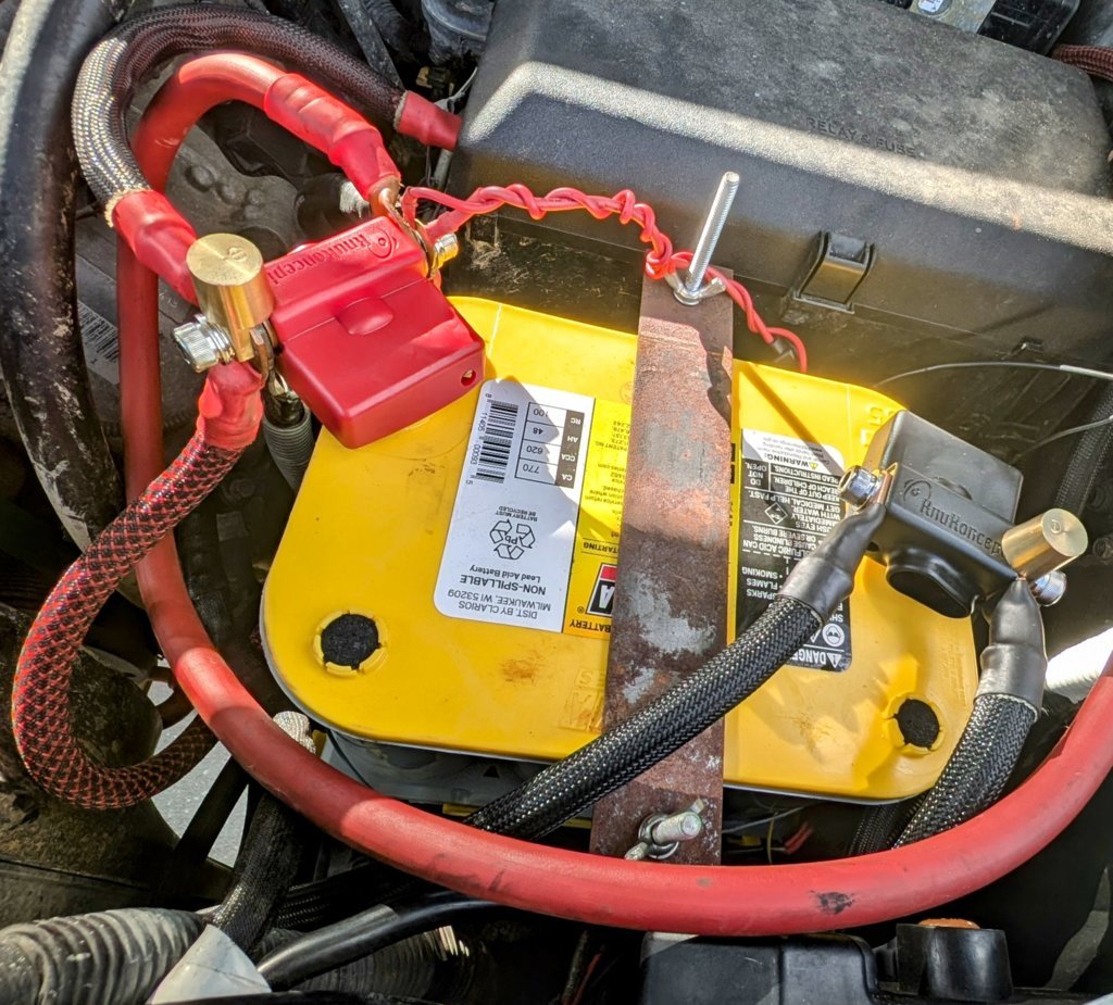

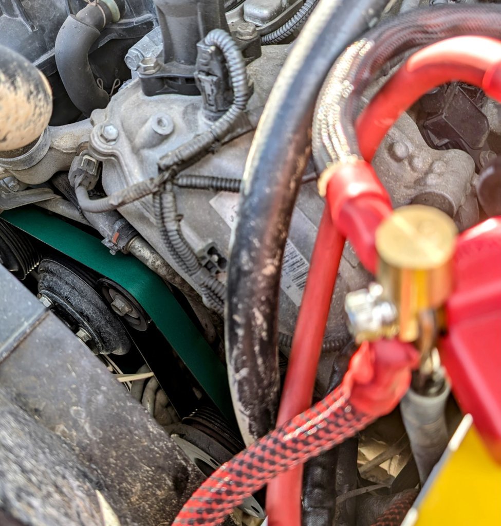

    I had a bad battery as well as belt squeal so I also changed the serpentine belt to a gates (green) and a litens tensioner arm.
    I replaced the bad battery with a new one and I replaced the old Amazon military terminal terminals with the KnuKoncepts battery terminals and they are really great, much better than previous.

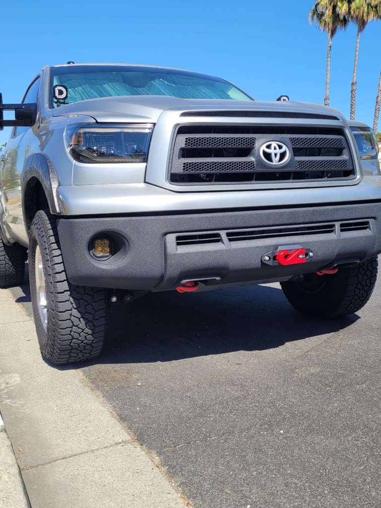

    Nice! Always fun to use your winch when you can. Wish I had my setup when I moved in to my house as I had a similar need to remove a miniature palm I dug out by hand. Curious, do have the Apex badlands, just found out mine won't winch out all of a sudden.
    Recieved my fairlead/hook combo powder coated and installed back today. Sprayed the Toyota emblem a similar color to my wrap and installed last weekend as well, all back together now.

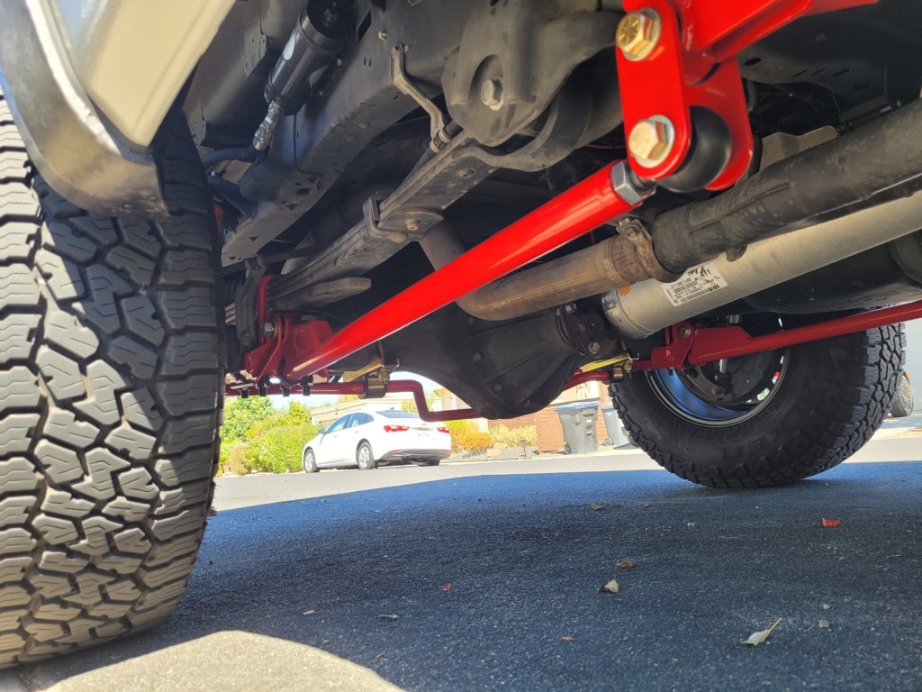

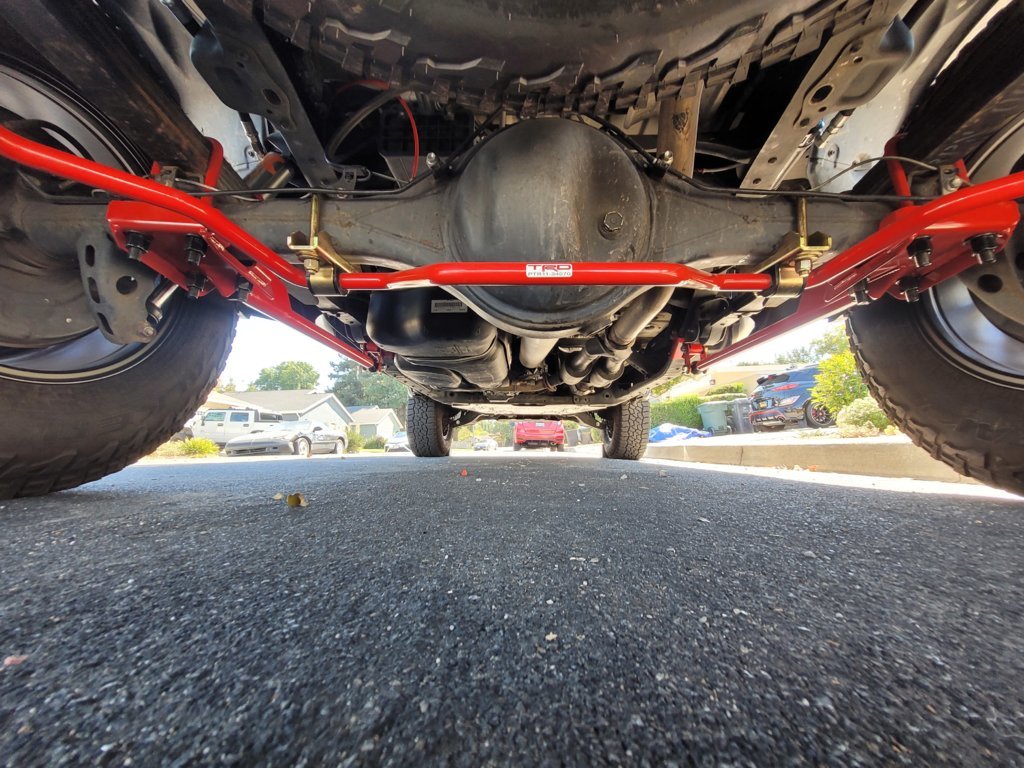

    Installed Traction bars and unfortunately had to remove the air bags as they were interfering with each other. Left everything loose as I have to go back and reinstall oe bumpstops.

    maybe just me... but looks like something to get hung up on offroad.

    It's deceiving, also I have a RCSB (shortest wheel base) but fitment is as follows;
    Rear: 1/2" of clearance gained at the rear axle.
    Front: 1/4" of clearance loss at the shackle near the gas tank if you do not have a gas tank skid plate.
