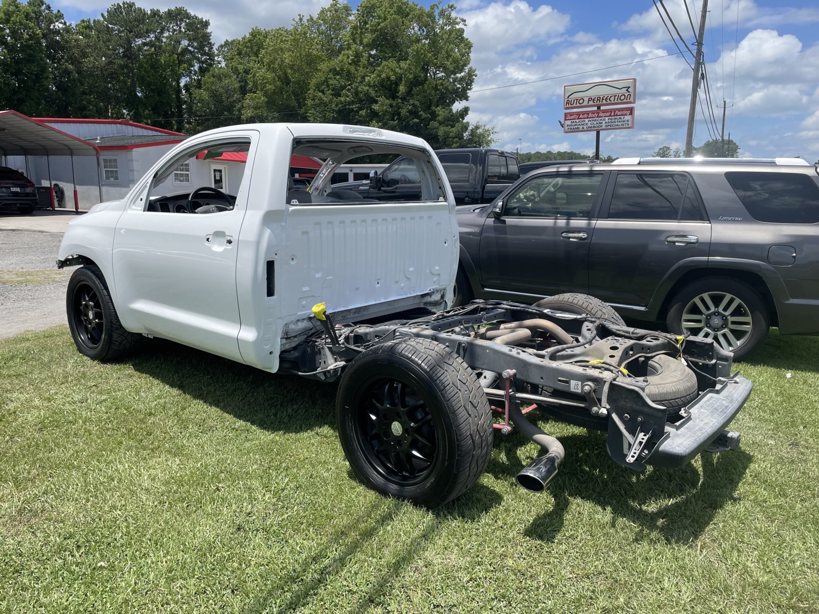

    Harrop 2650 supercharger TRD suspension TRD intake Custom exhaust Dirtydeeds cross pipe Fully built bottom end motor Manly Rods Crowder Pistons ARB Stud Kit National Speed Tuned Redesigned fuel system XAT Fuel Rails Twin Demon Fuel Pumps 83cc Injectors Morimoto Headlights

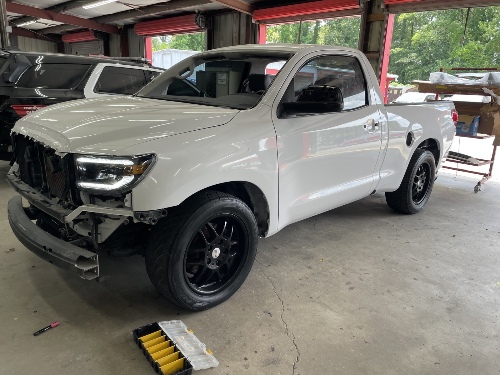

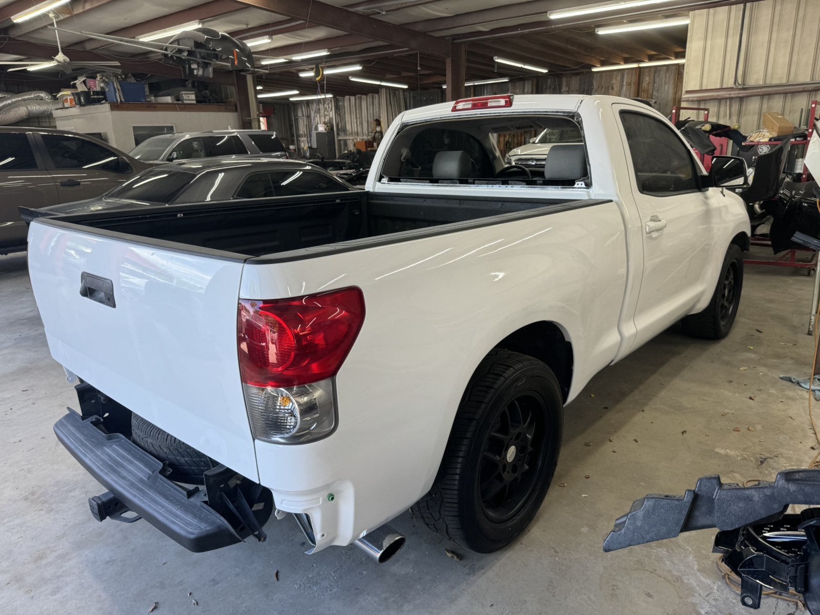

    I still need to update suspension… not sure exactly what I’m going to do… want to lower in in rear but need to be able to help plant it for more traction. I’ve decided not to add air ride.

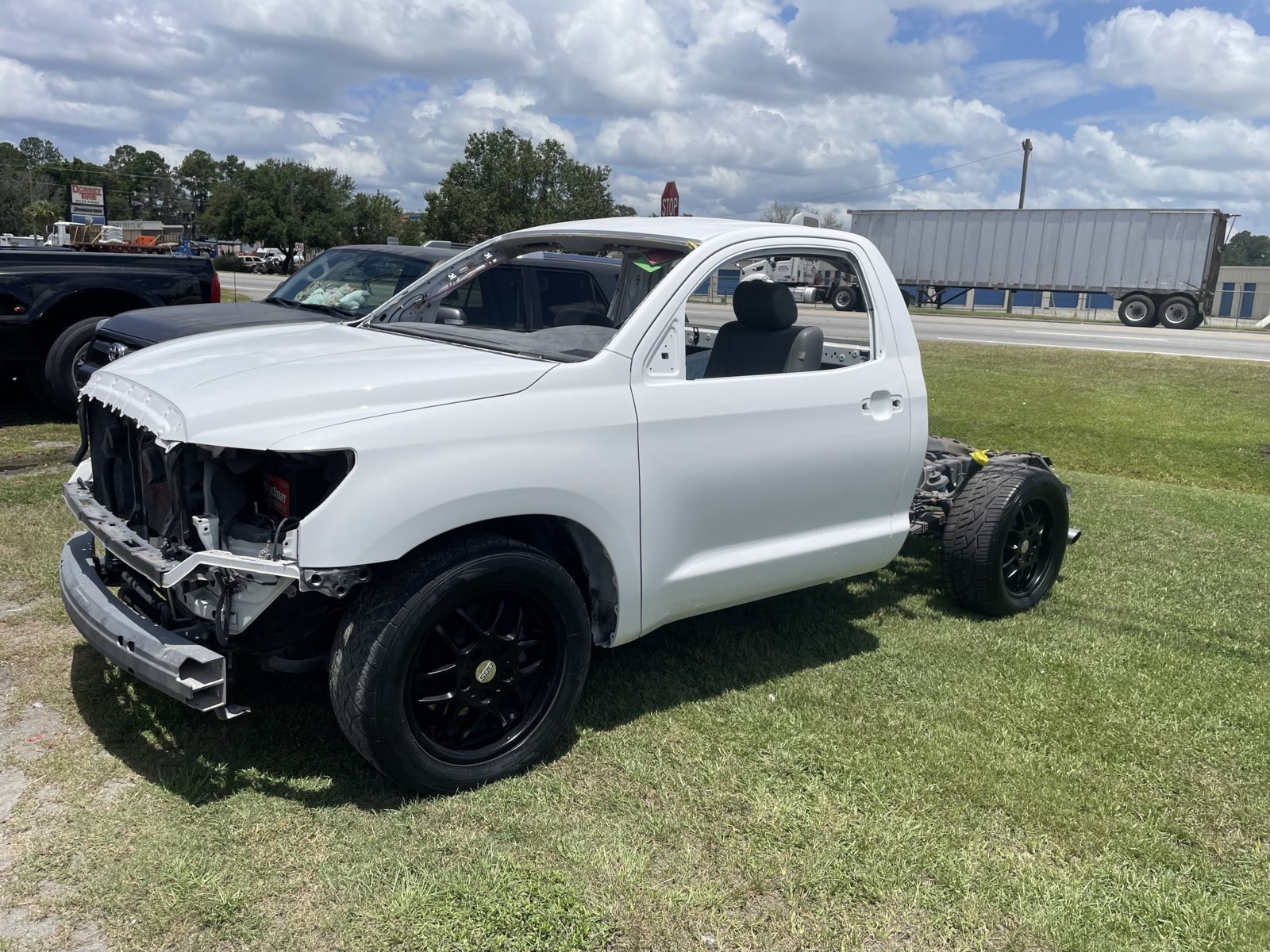

    Here are some other pics…. The cool part is I got toyota warranty to cover the costs.

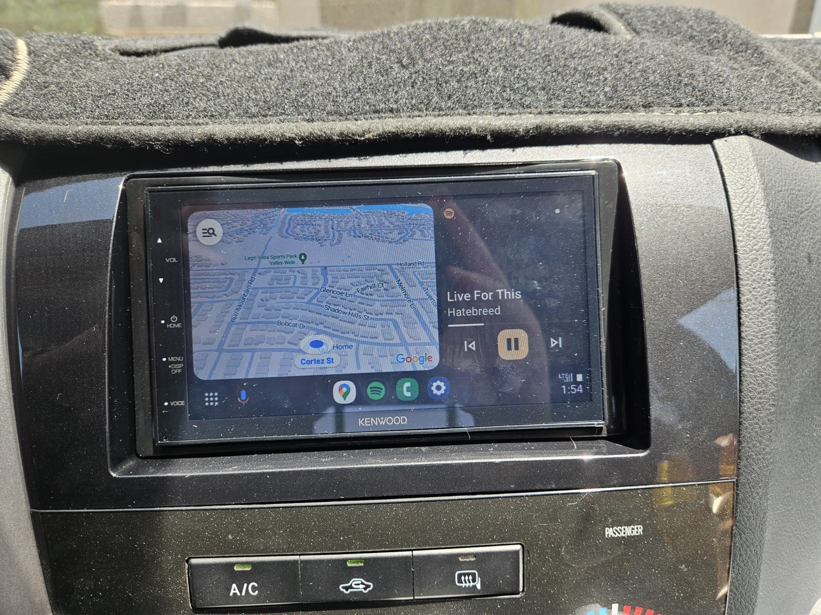

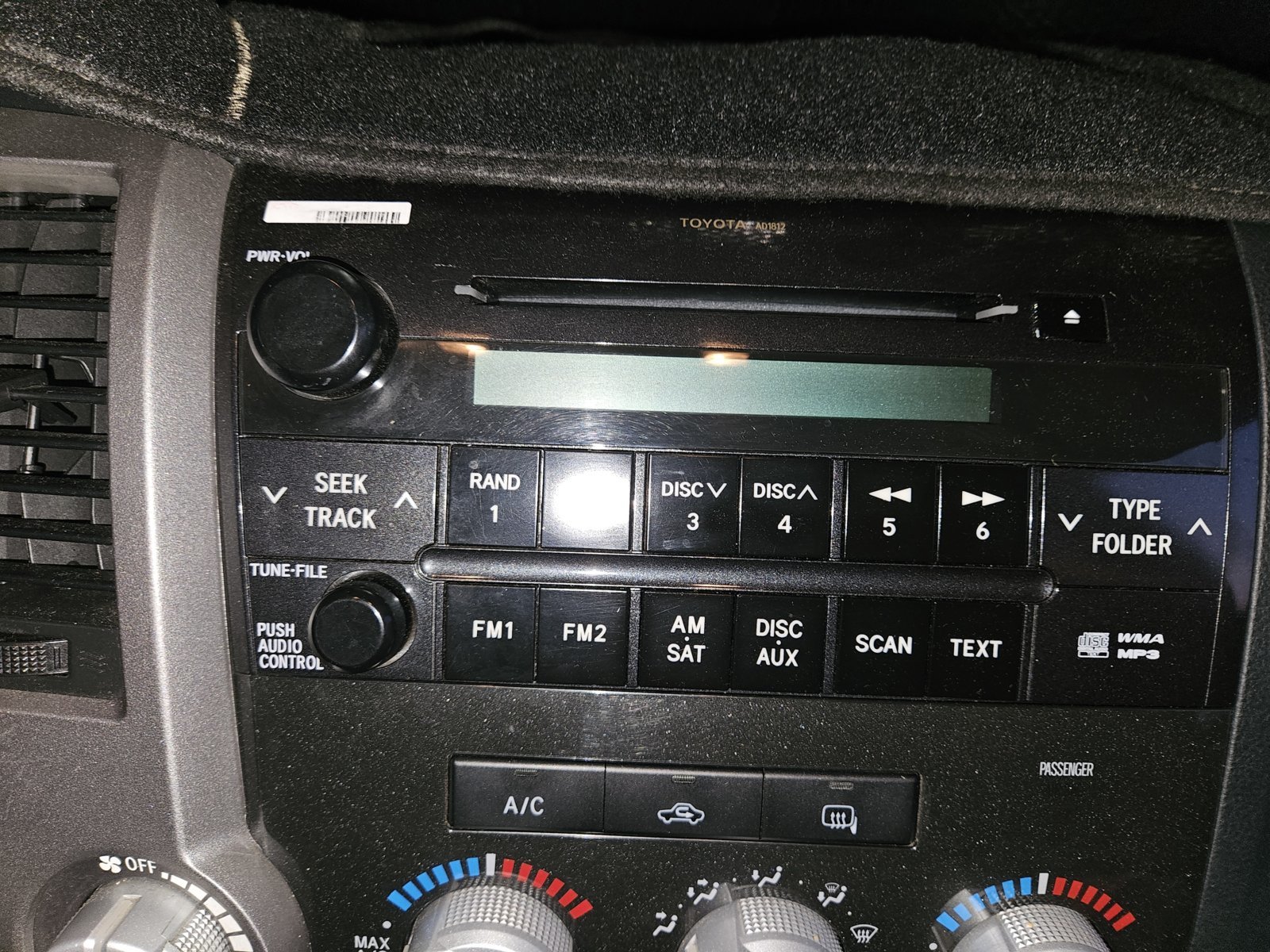

    Had the head unit installed and then added the power window controller that does all 4 window with the auto up and down. Slowly adding and adding... before and after of the head unit.

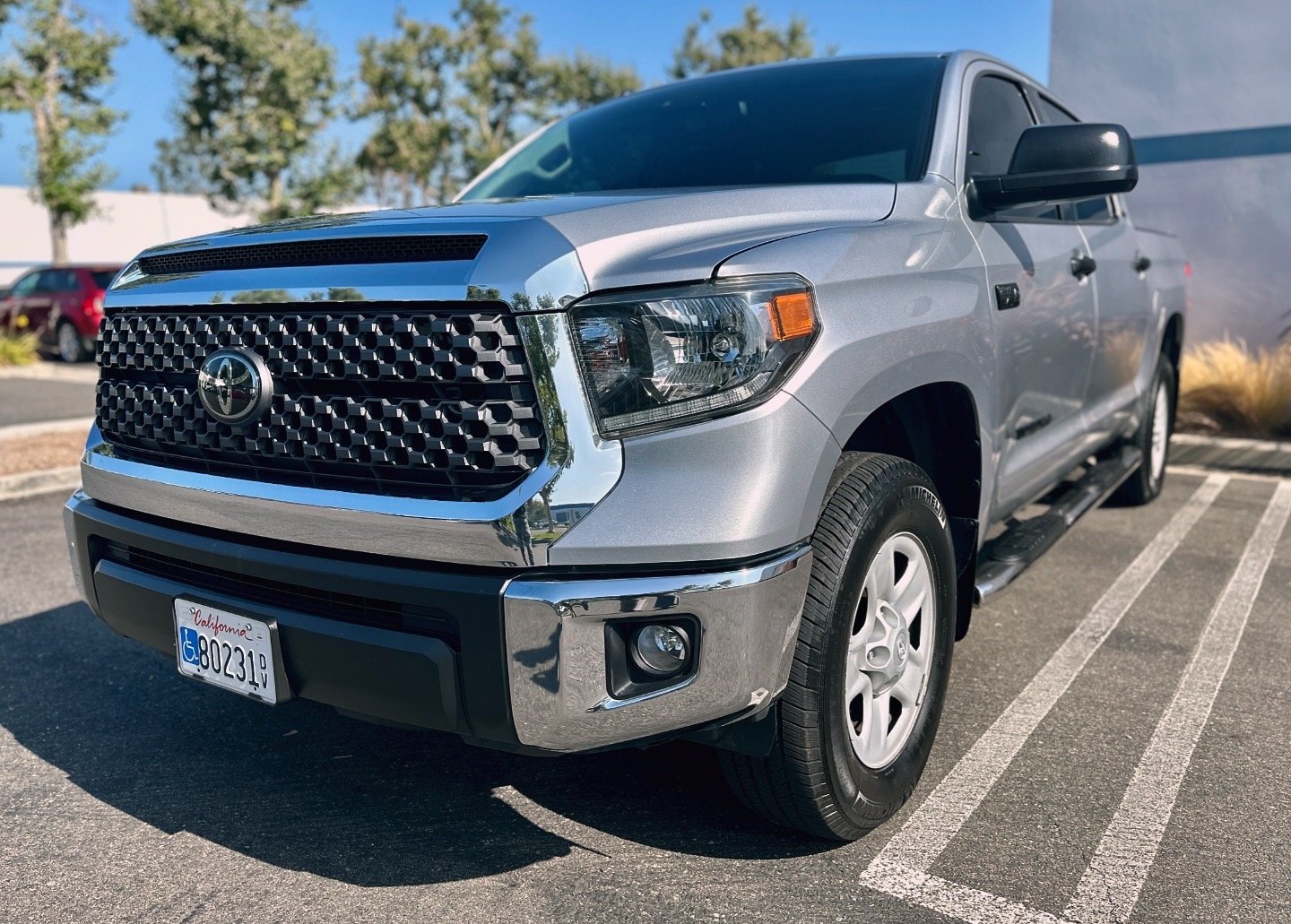

    I need to do this on my '08. Been dragging my feet.
    Said the hell with it and picked up a '21. Figured it was less of a hassle.

    Expensive radio lol

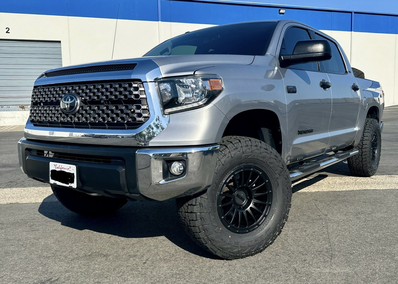

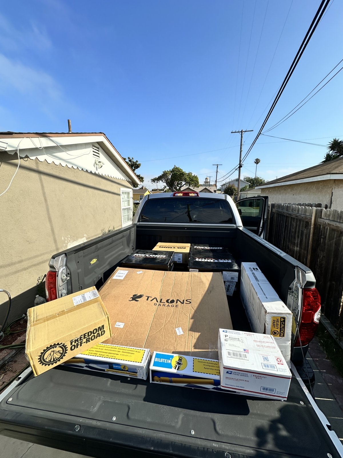

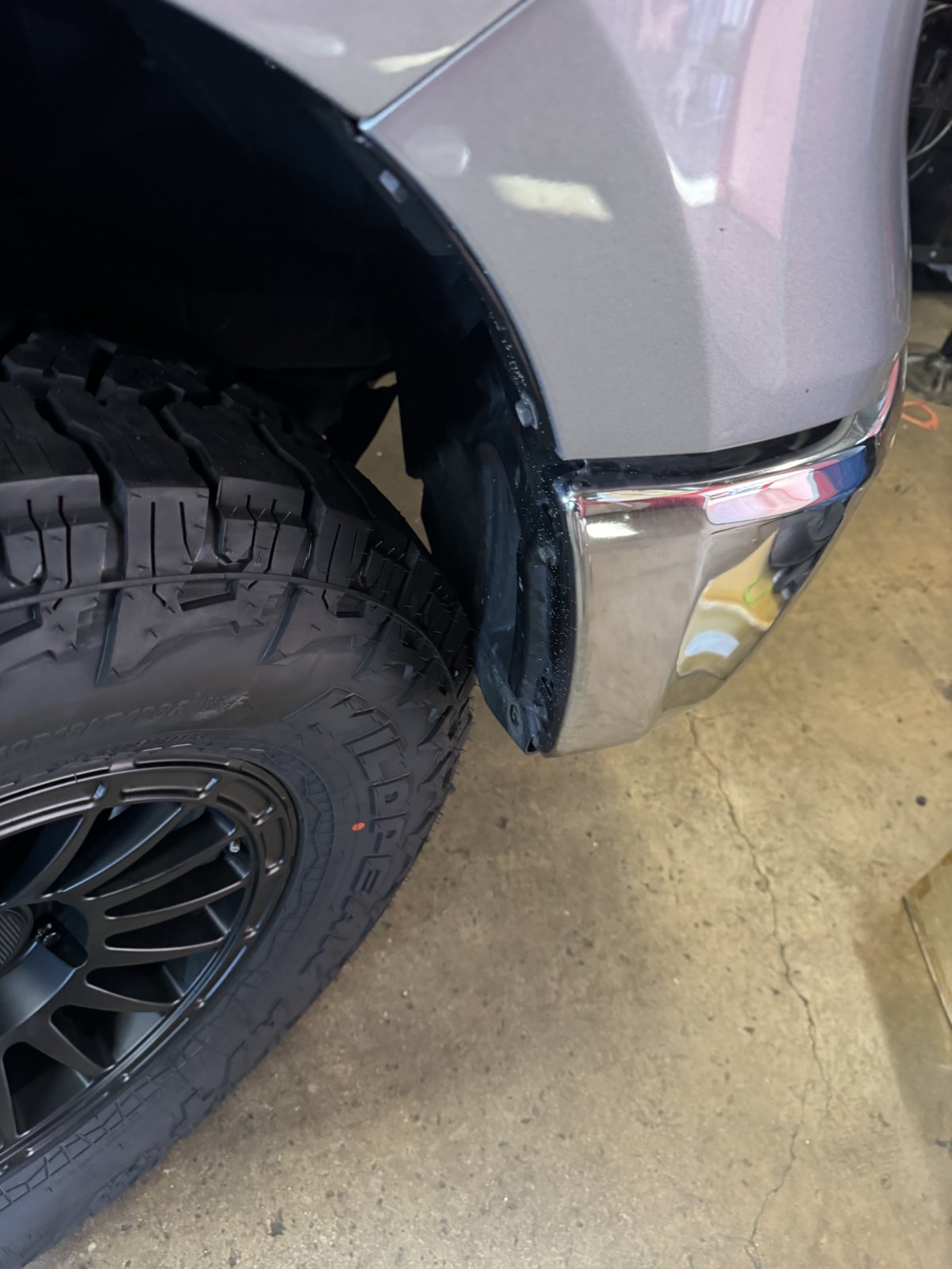

    Got all the parts installed!
    I had Bilsteins 6112 and 5160 + x1 shim on passenger side and x2 on driver said for a total of 3’, Freedom Off-Road UCA, Coachbuilder 2” (1.25” actual) Rear Shackles, Talon's Garage Skids, Method MR314, Falken AT4w installed.
    Before:
    After:

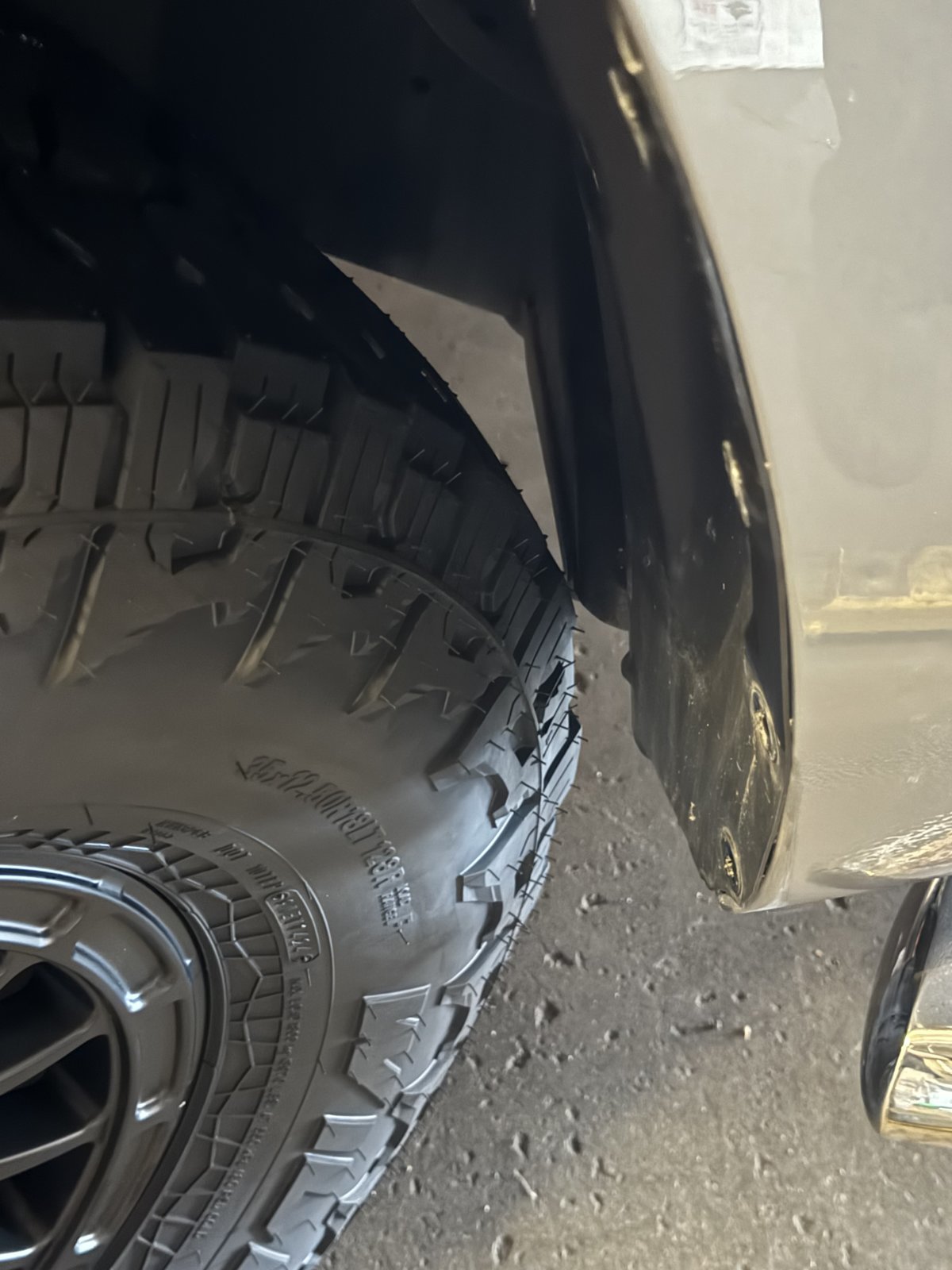

    What size Falkens
  13. Jul 24, 2024 at 6:45 AM
    JeffsTundraFTW
    JeffsTundraFTW New Member
    Jun 2, 2024
    #117811
    32
    They are 35x12.5r18. Had to do BMC and trimming of the liner and removal of the mud flaps. Apparently they are big for 35s but worth it as they’re super quiet on road from 0-65
    here’s before

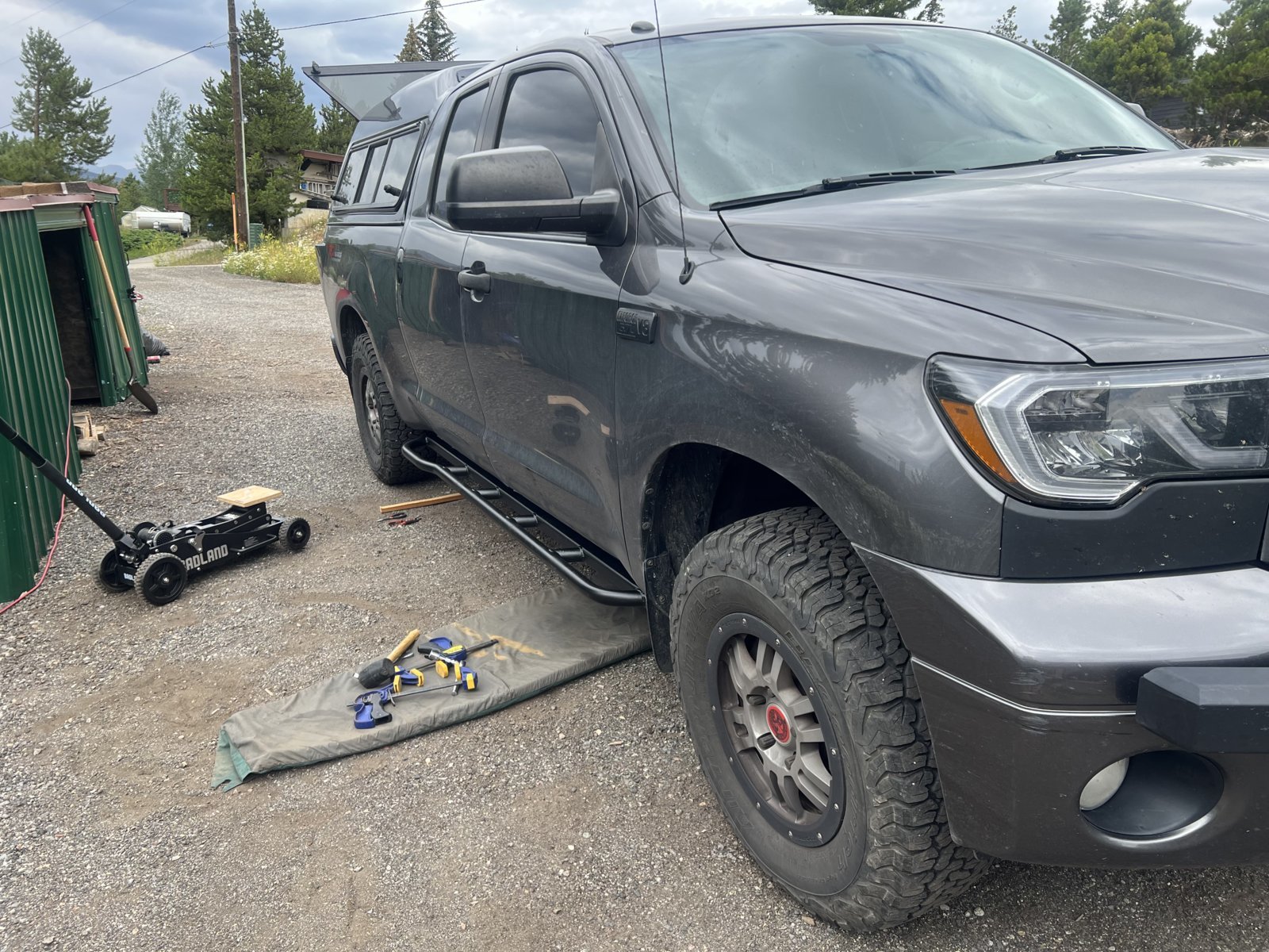

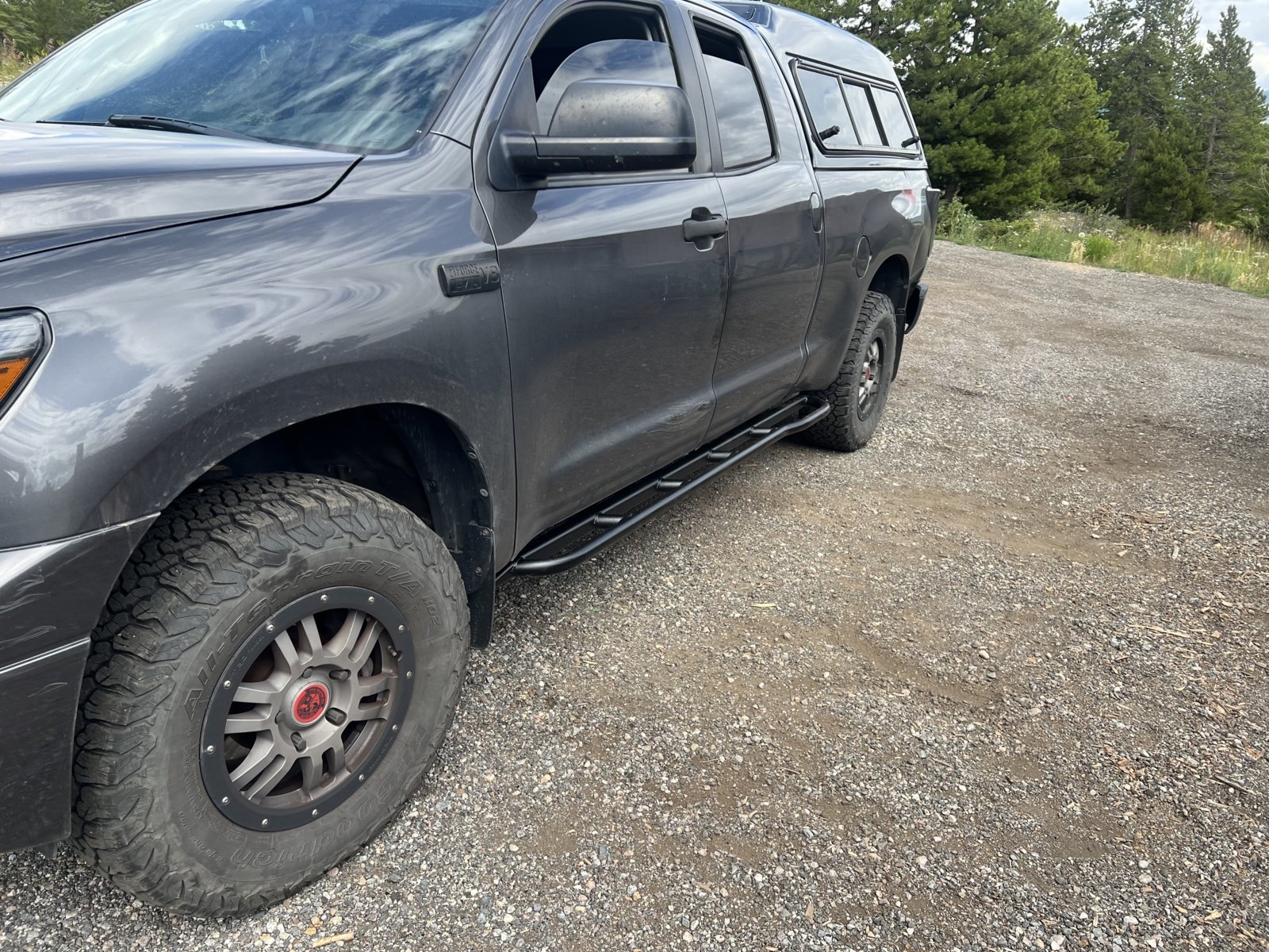

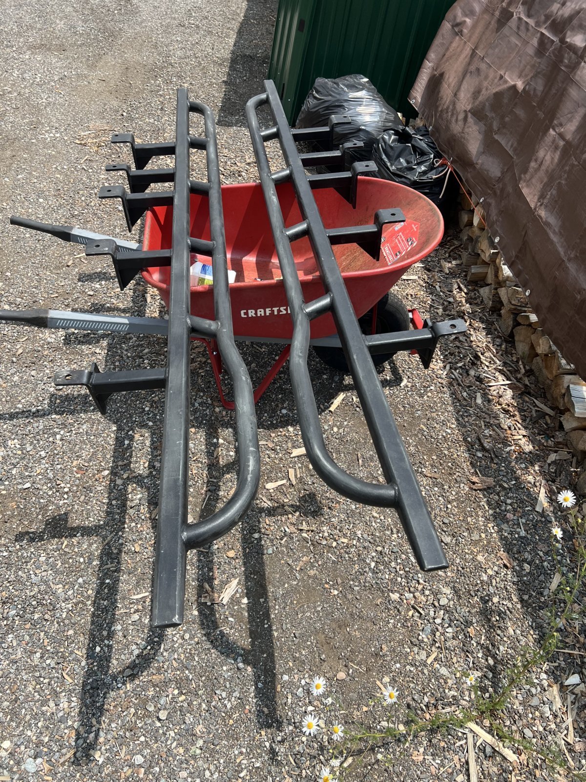

    Picked up a used set of WKOR sliders. I sanded them down and repainted them with a Hurkuliner. Pretty happy with the results. IMG_8473.jpg

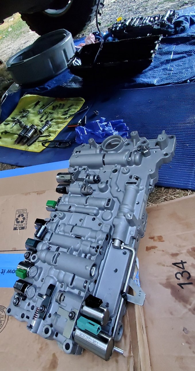

    Installed IPT valve body. Went well except for spilling a quart of ws fluid in my fender and cowl...

    Nice find!

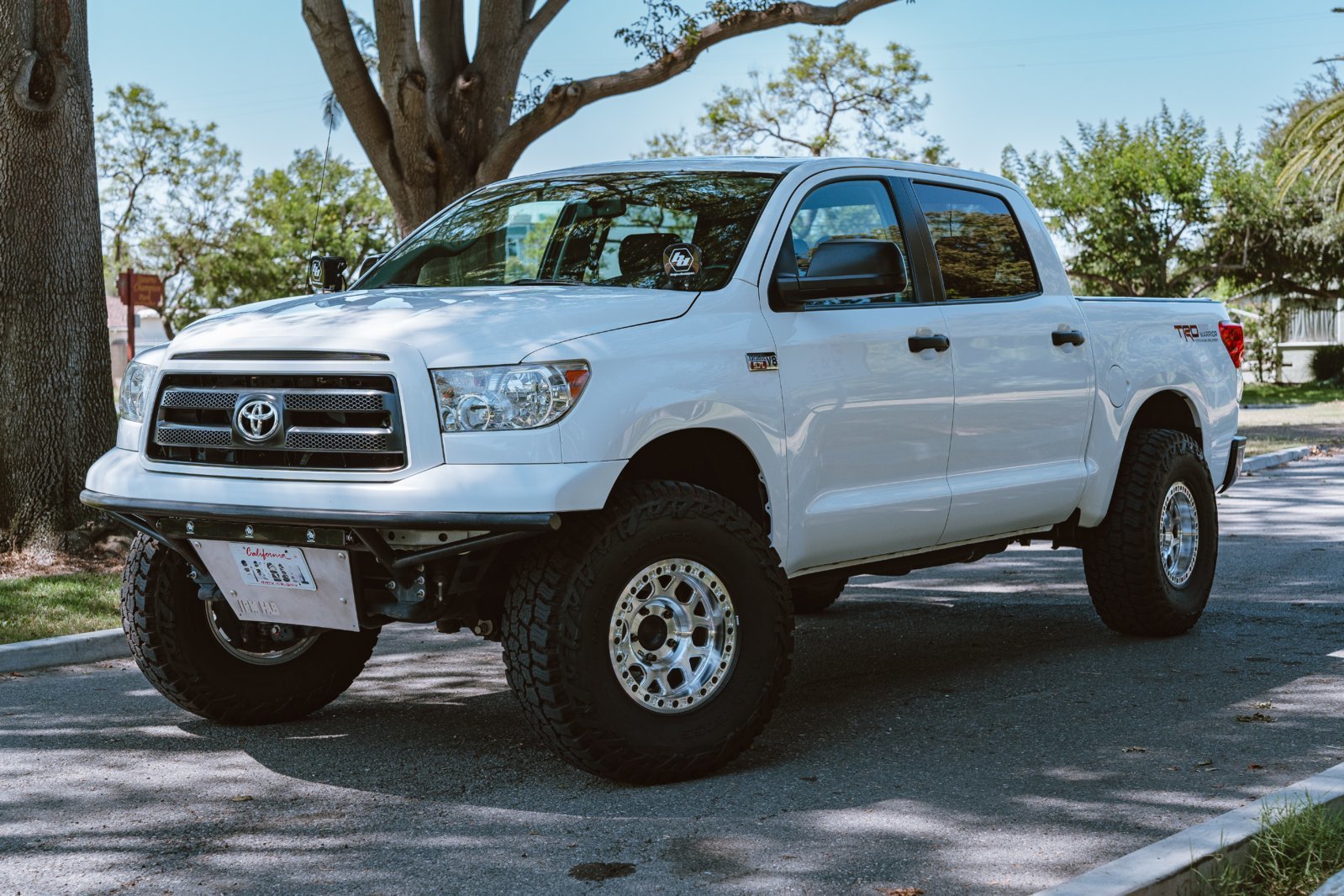

    Wash and little photoshoot

    @dittothat posted them in the Craigslist finds thread. Got a great price on them to boot.

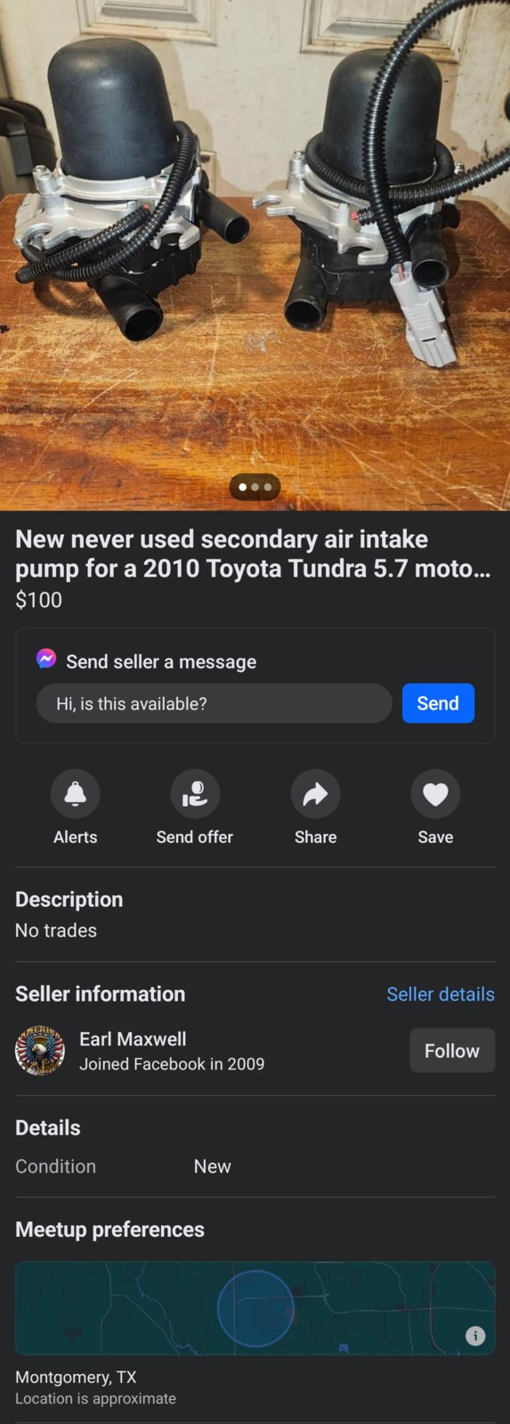

    Anyone looking for a spare SAI setup or need one now here's one in my neck of the woods

    Where are these located on the truck?
