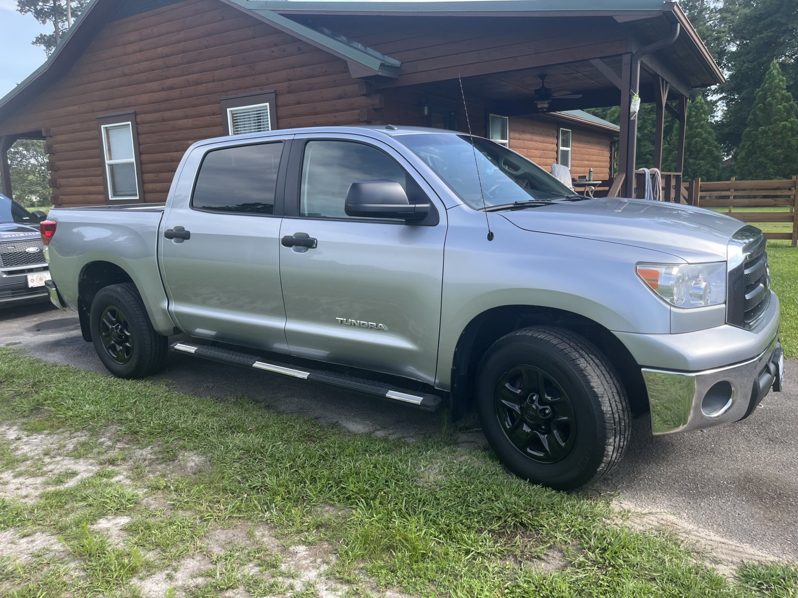

    I painted the stock wheels. Very minor change but I think it makes a big difference.

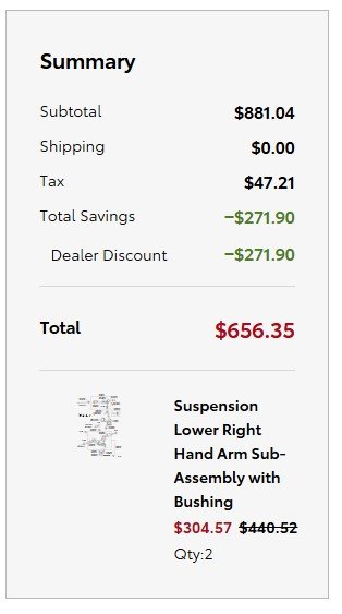

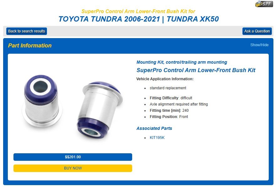

    So I pulled the trigger and bought OEM LCAs. Last weekend I installed some MOOG LCA ball joints. During the install they went in crooked and then slapped in straight the last couple of inches. Seeing the LCA ball failures on the 1st Gens, I didn't want to be the first person to have a 2nd Gen with a failed MOOG LBJ. Additionally, I offroad a bunch which also means a lot of highway time. In October we are going up to Port Angeles, WA from San Diego and I wouldn't want to have a failure going 70mph. I can't even imagine what that would look like.
    I was going back and forth between OEM or Dirt King but it was hard for me to justify spending an additional $1700. I'd go Dirt King or Total Chaos if my rig was on some crazy crack head shit but it's just on 3.5 inch lift and 35s.
    What I'm eye'ing at now is going the extra mile and installing the SuperPro bushing kit.

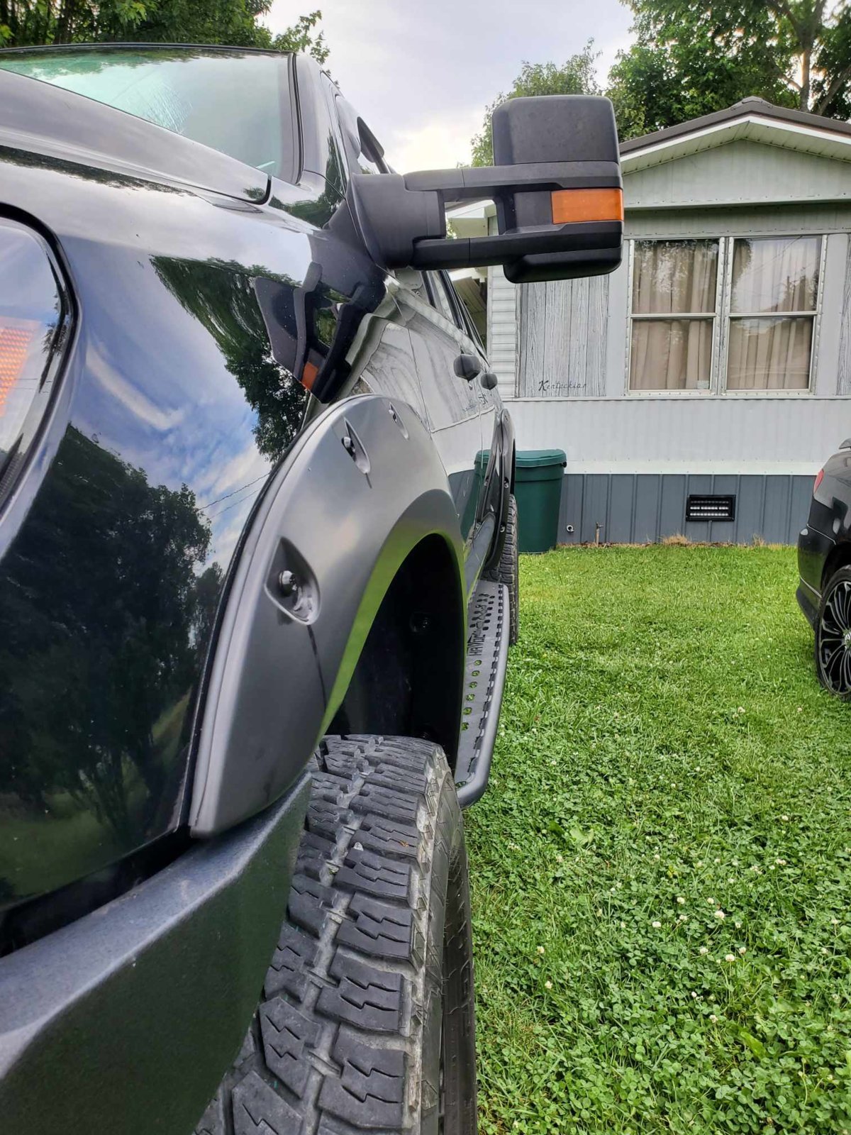

    Finally got the fender flares on. Came out really nice. I'll let the sun fade them some then I'll go back and raptor line them. These are the Tyger Auto flares from Amazon.

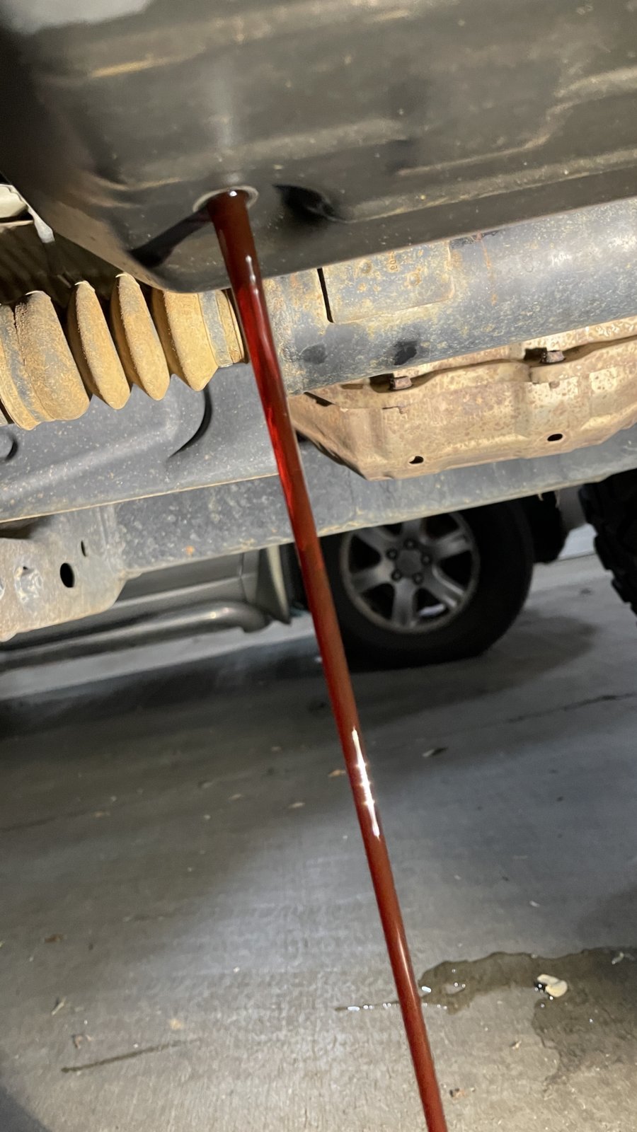

    Greased the drive shaft and pumped out the steering fluid and refilled. I am almost caught up on the PM on my truck.

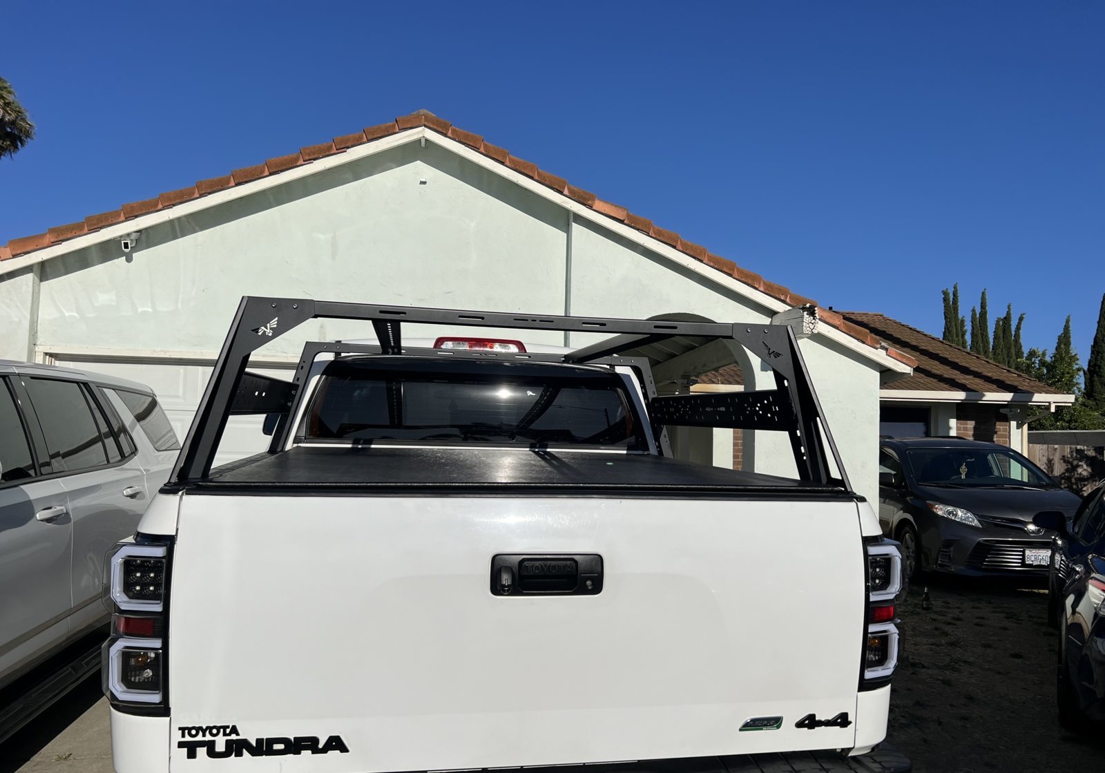

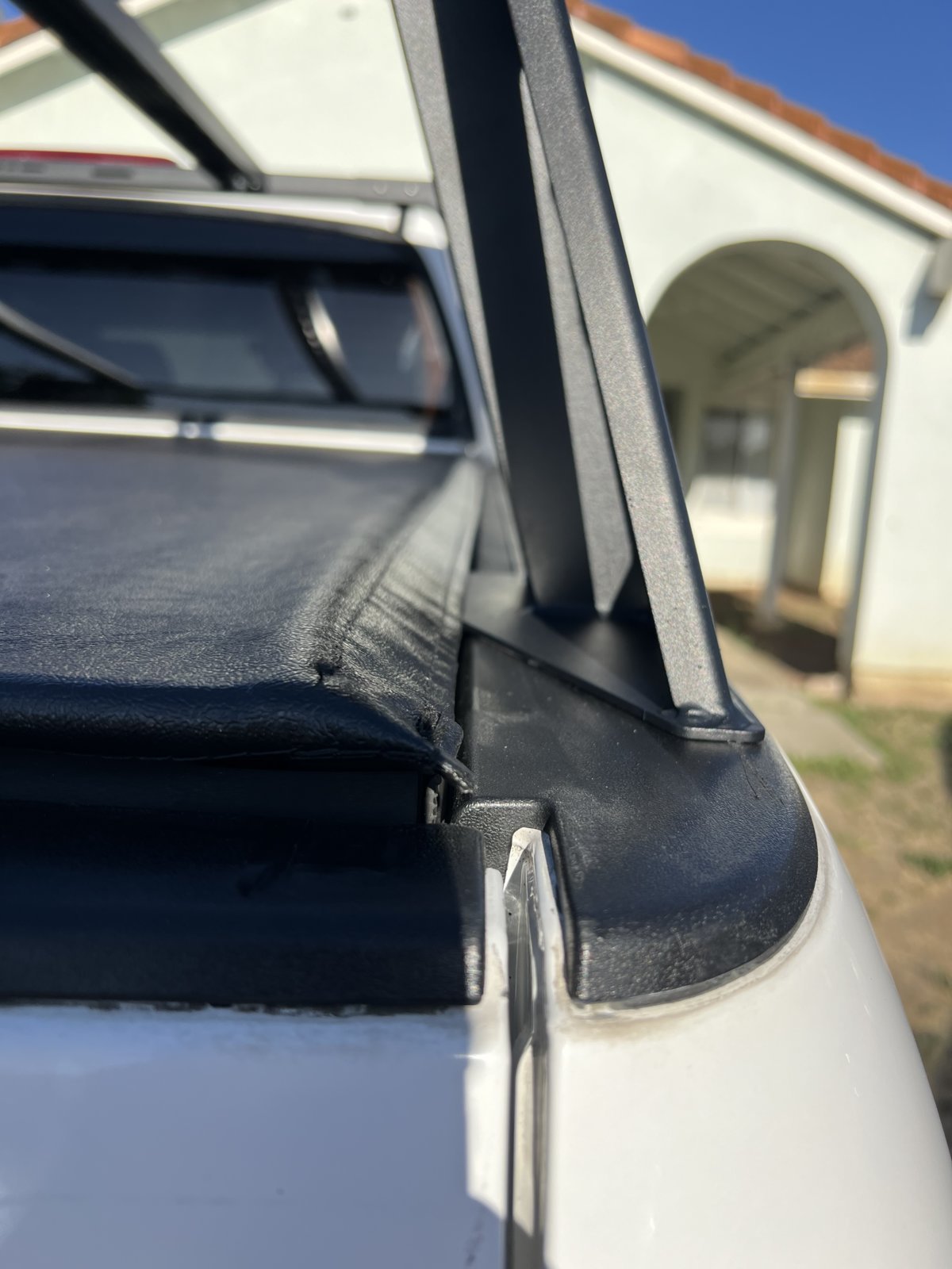

    Installed my roll up tonneau cover and Victory 4x4 bed rack. Going against the norm and will mount my normal style Jerry cans instead of a roto fuel can. Waiting for those mounts. Supper happy with the change and functionality compared to my old camper shell.

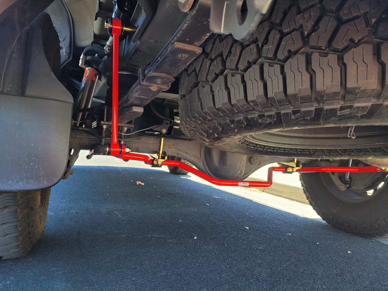

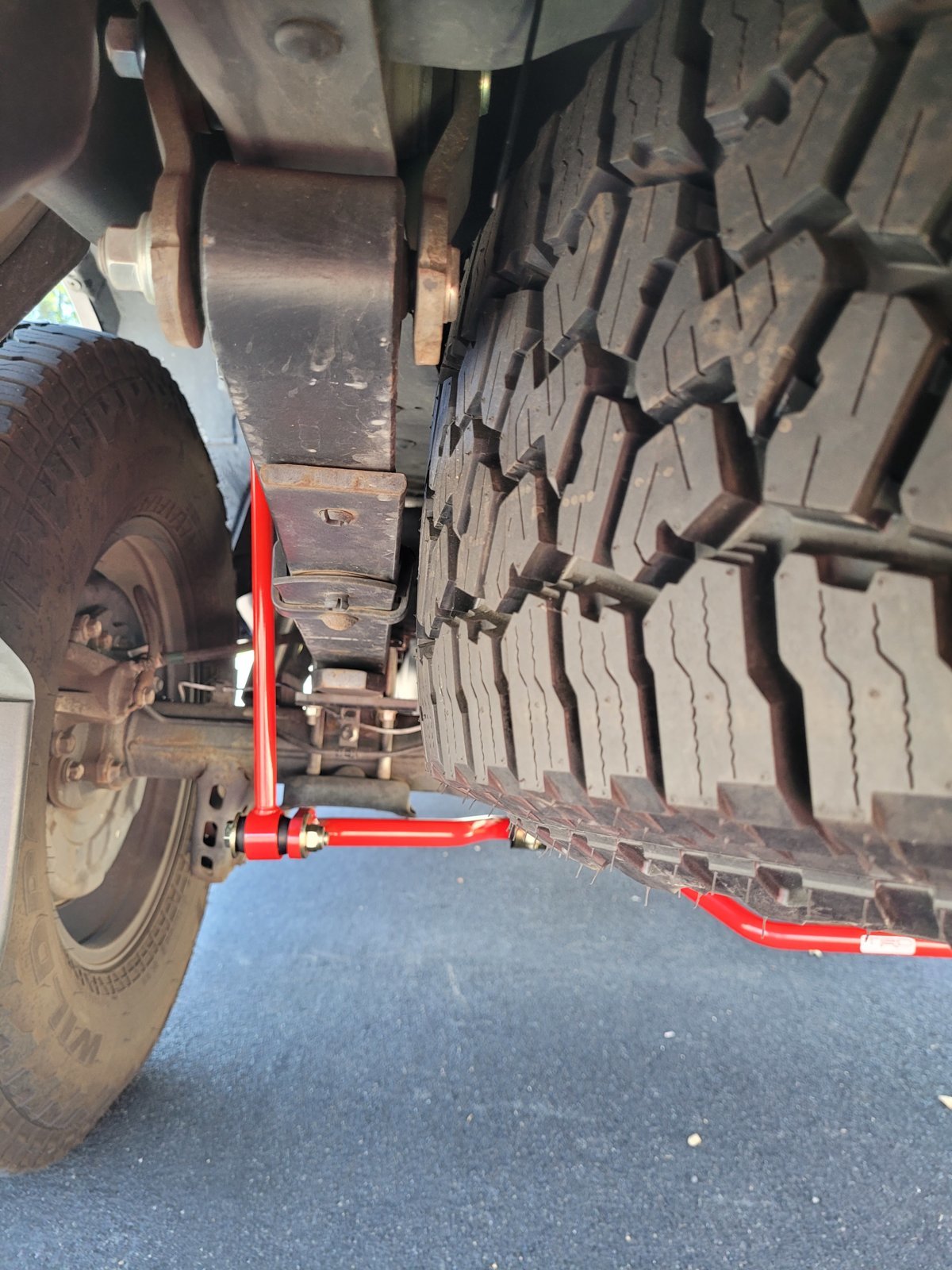

    Installed a TRD rear sway bar yesterday and a close up of the 35" spare tires clearance since I was under there.

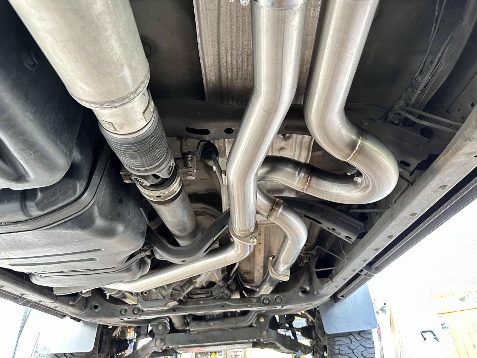

    Installed the full SPD equal-length exhaust system (downpipes + cat-back). I witnessed a drop in boost pressure with it flowing so much better. The truck sounds MEAN!

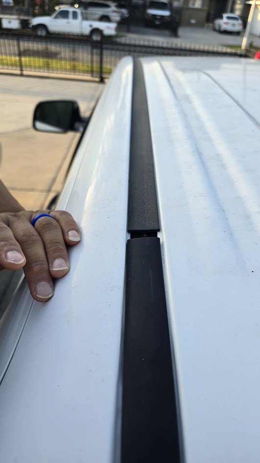

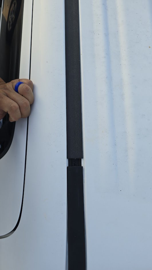

    Replaced Ebay roof drip mold with OEM. Stay away from the Ebay ones. They're inches shorter. See pic below.

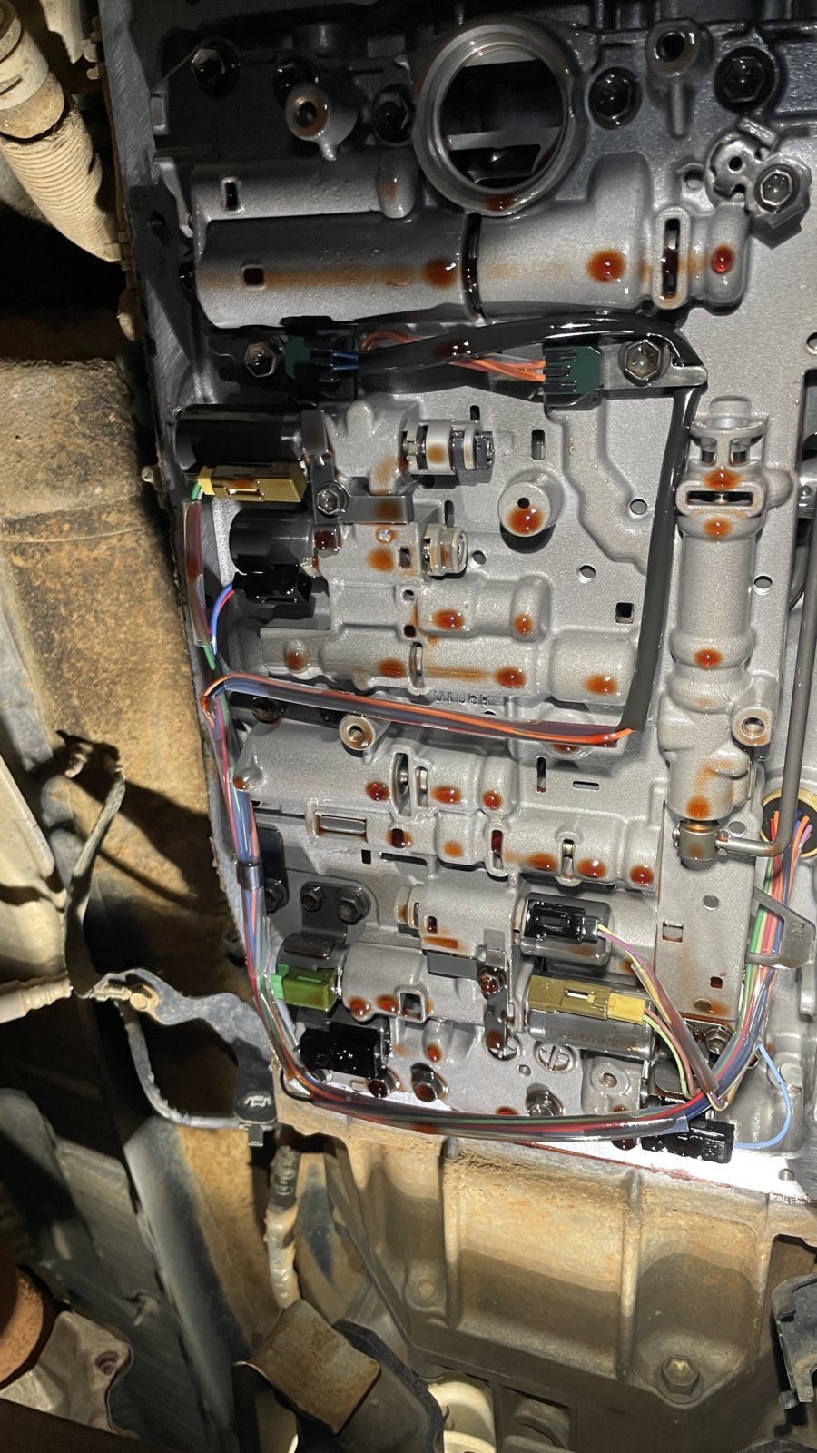

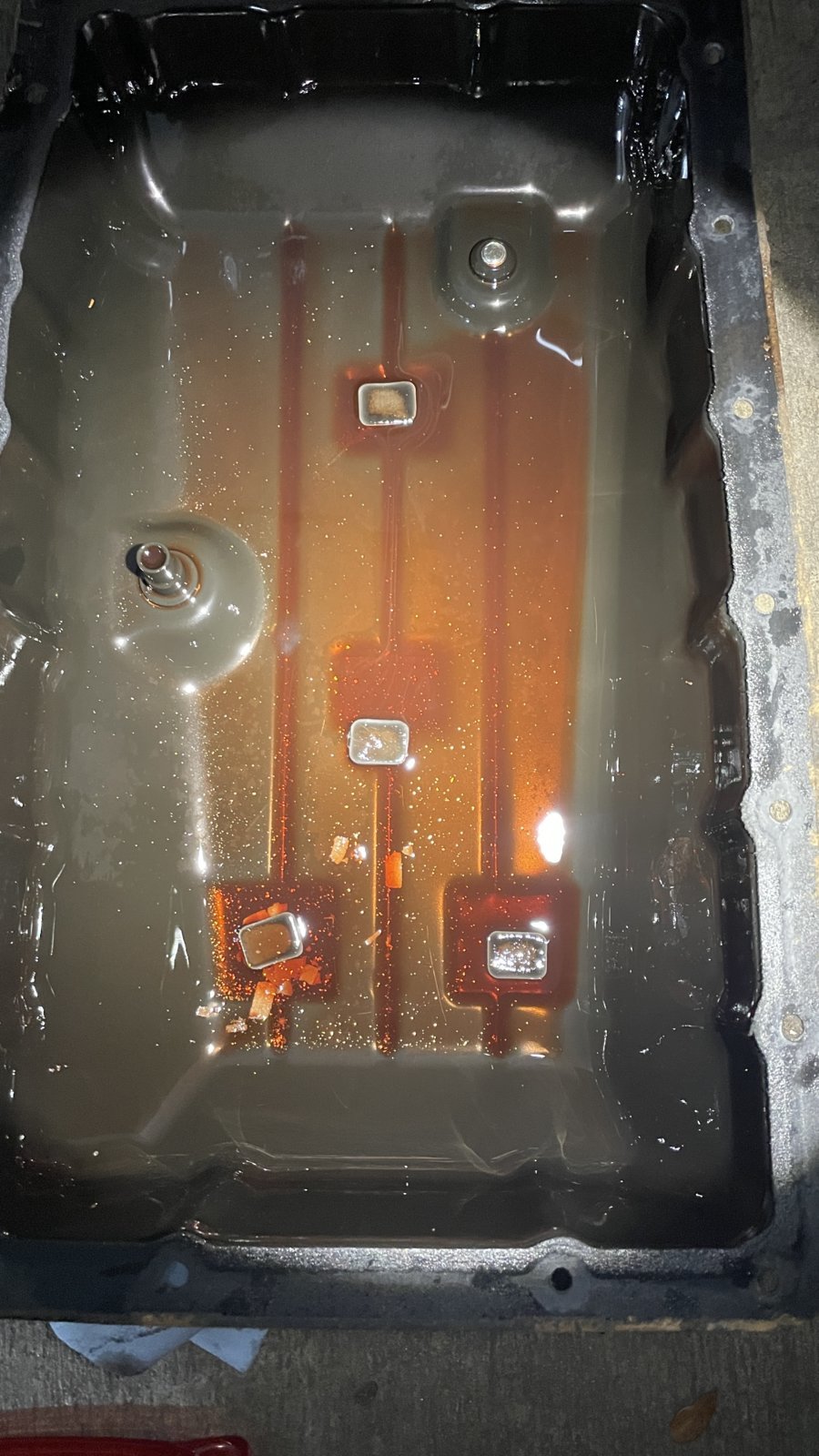

    Finally pulled my transmission pan last night, fluid actually looks really good; it had gotten flushed about 22k miles ago when I swapped my torque converter. I confirmed the SLU solenoid was indeed bad (reading 6.1 Ohms instead of 5-5.6). Gonna dig into finding one today, valve body and wiring all look really good as well. Only bad thing was the clutch material in the pan, unsure if that was from the new torque convert breaking in or the old one going out, not a crazy amount of metal either
    when this is all said and done I’ll also throw a transmission cooler in to keep the trans temps town a bit, it likes to get hotter than I would like

    I had been getting shudders for honestly like 30k miles; they were relatively infrequent until they started getting worse and then I put Shudder stop in the trans which made the shudders quit until the trans finally threw a code.
    probably started getting light tc issues at around 200k and finally changed it at 230k when the cell finally triggered.
    Apparently the 2007-2008 had tc problems
