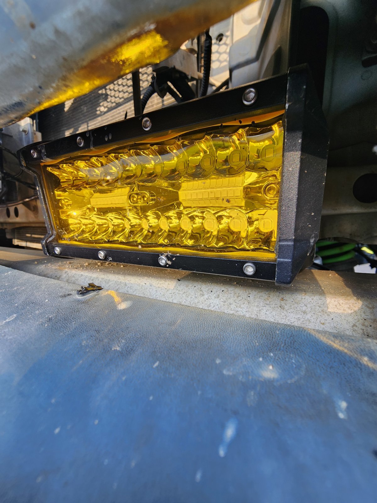

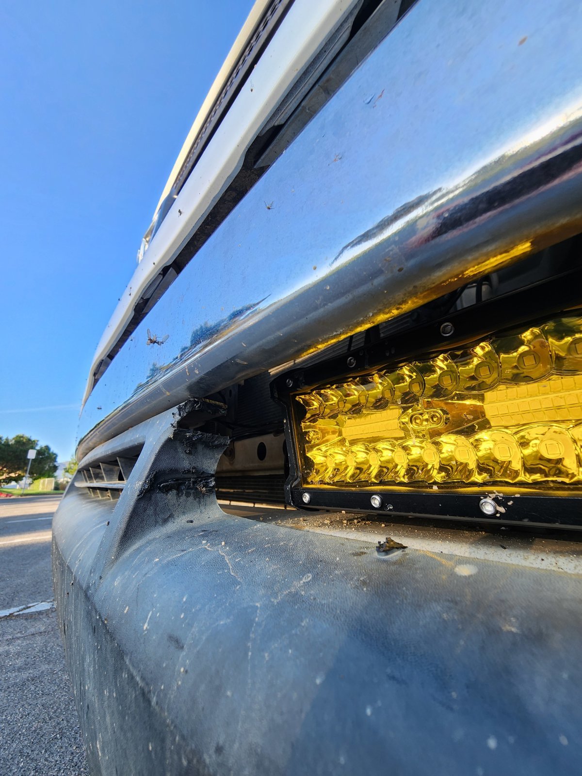

    I've done a lot today. Changed the engine oil, transfer case, rear diff, installed ditch lights, aftermarket heat sink PS cooler, installed the ValoMax plug and then went offroading.

    Those lights look good! How do you mount the ditch lights?

    Are you talking about the lights in the bumper? I had to cut some of the plastic, cut the inside of the bumper and then I used a chisel and hammer the roll the material up so that the lights would clear. If you don't roll the metal up, some of the lights bounces off the inside of the bumper and reflects back into the engine. I then used metal screws to secure the light bracket to the aluminum bash bar.
    I'm thinking about pushing the lights forward so they are closer to the outside. When that happens, I'll take more pictures.
