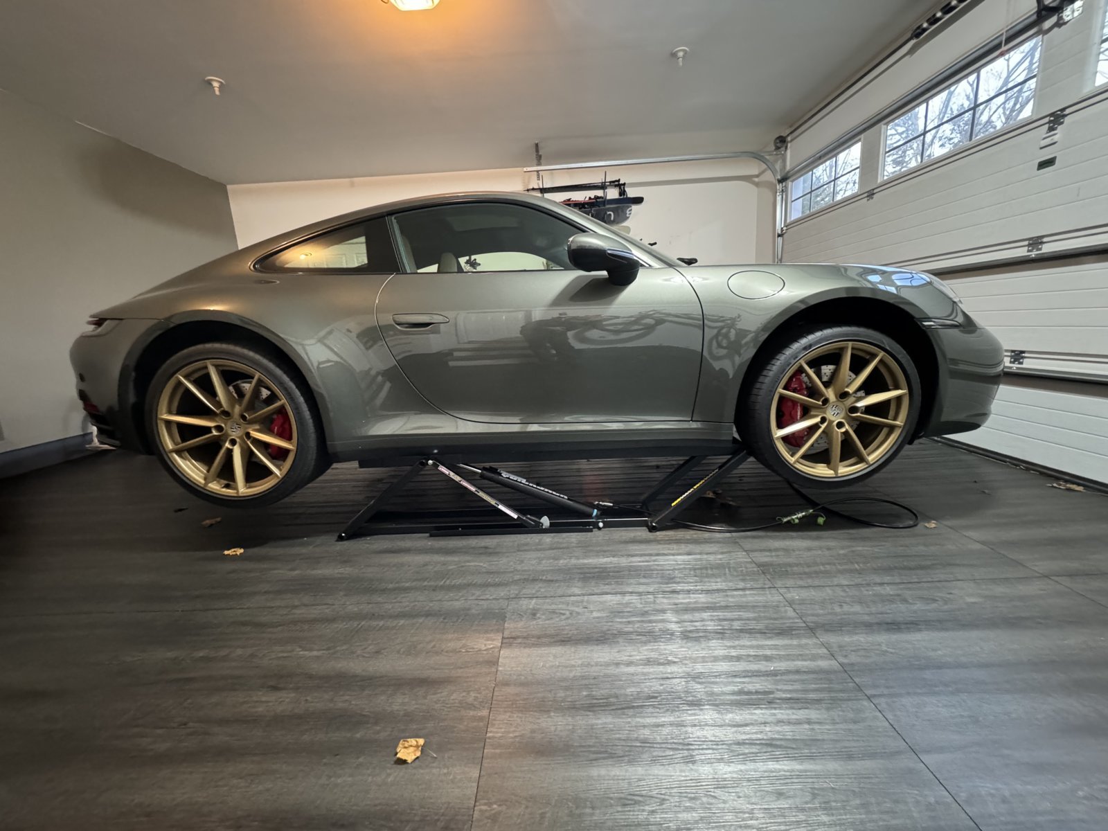

    I love it! That FreeFlow XL lets water drain through so I was able to power wash the frame indoors and the flooring never became slippery. You'd need a pad under a regular jack but the QuickJacks work great.
    Dropped screws don't bounce away, they get trapped, which is nice. Small screws can slip through, which is a pain.

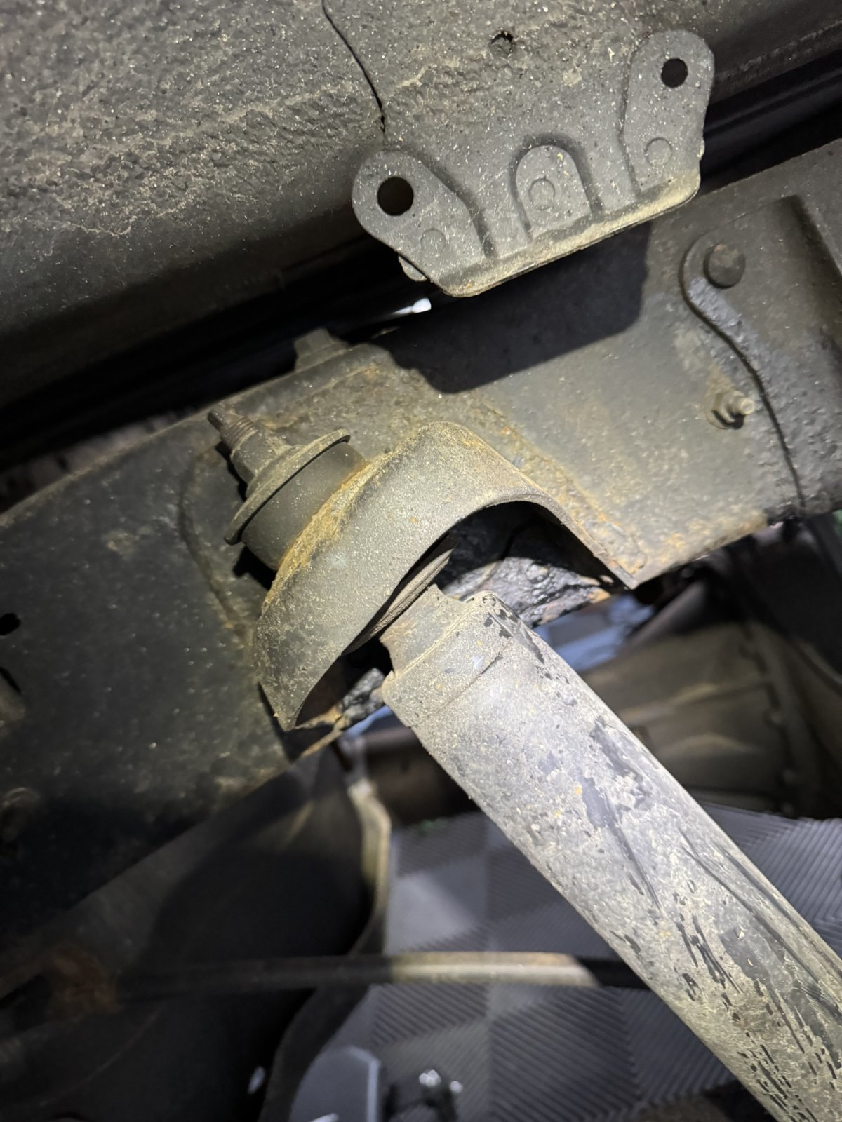

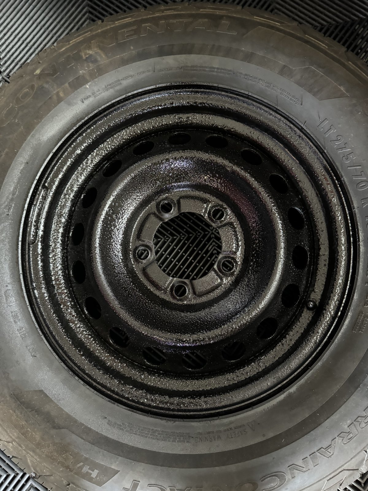

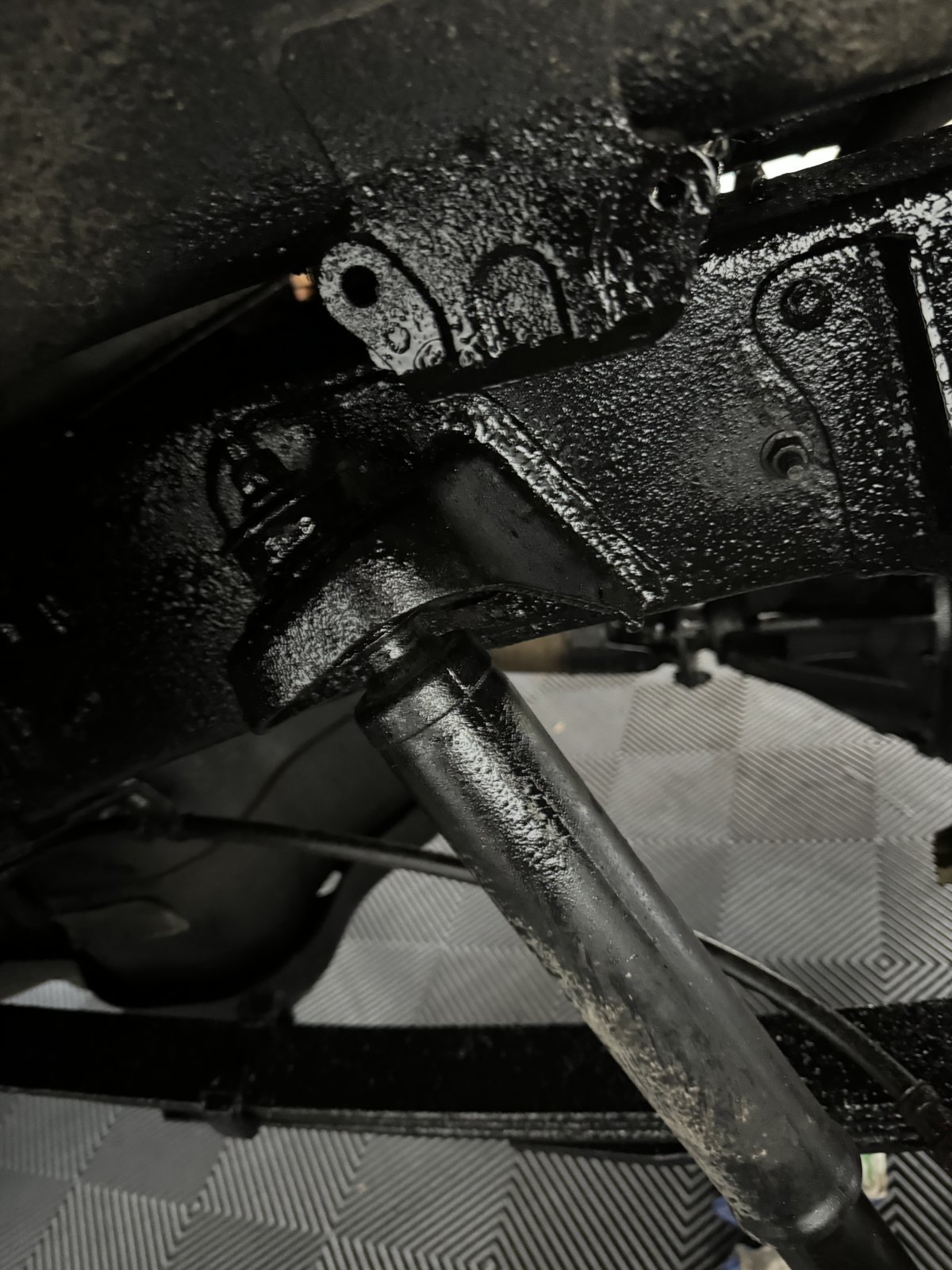

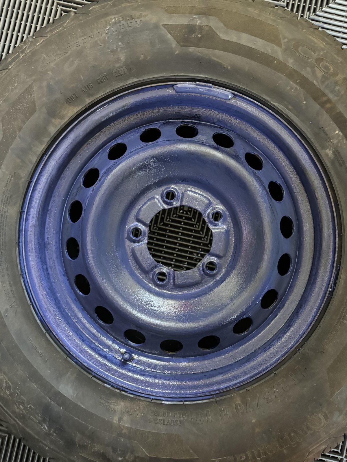

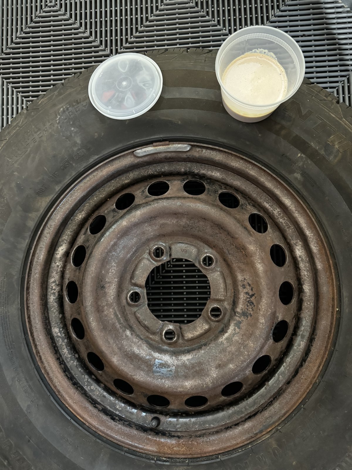

    Anyway I finished my Fluid Film Black application today. Here's a before, during (applying Corroseal to reverse the surface rust) and after Fluid Film of the spare.
    Suspension, but I did this to the entire frame on the underside:
    I have the race deck charred oak in the other garage bay which looks nice and doesn't absorb fluids.
