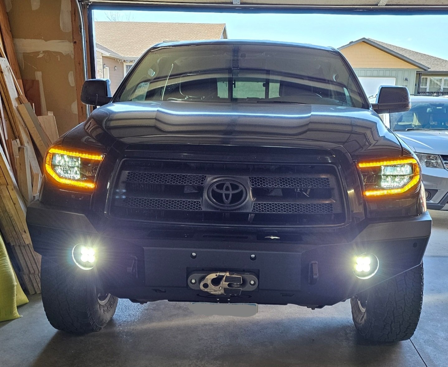

    Took advantage of the BF sale and sprung for these Morimoto XBs. Fog light mod is next!

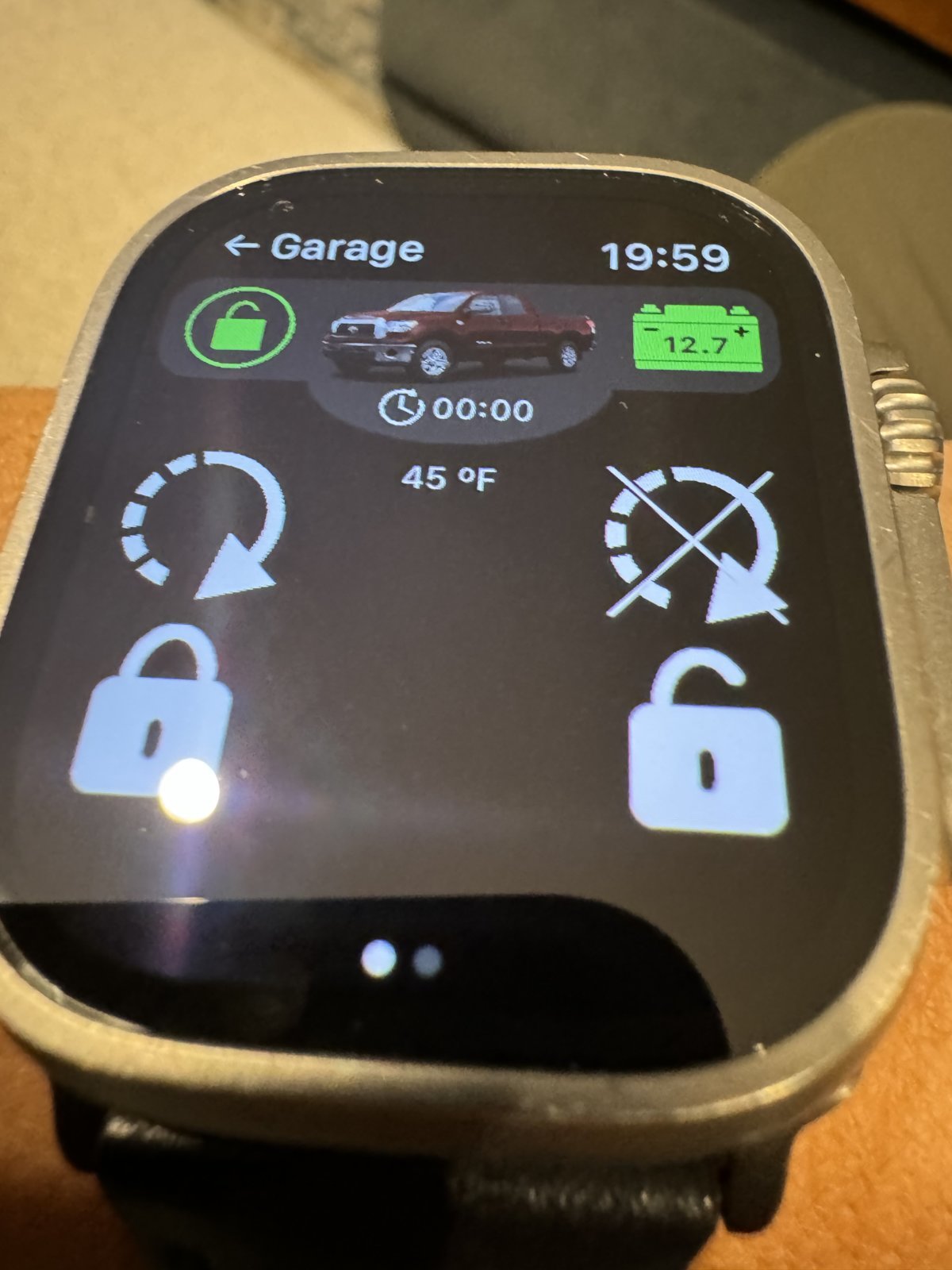

    Chrome delete, Sequioa grill, bed lights, LED + head, fog & tail lights, Dynamat throughout, front & rear cameras, Pheonix PX6 13" head unit, 8" subwoofer, JBL speaker upgrades, tonneau cover, custom shifter, steering wheel cover

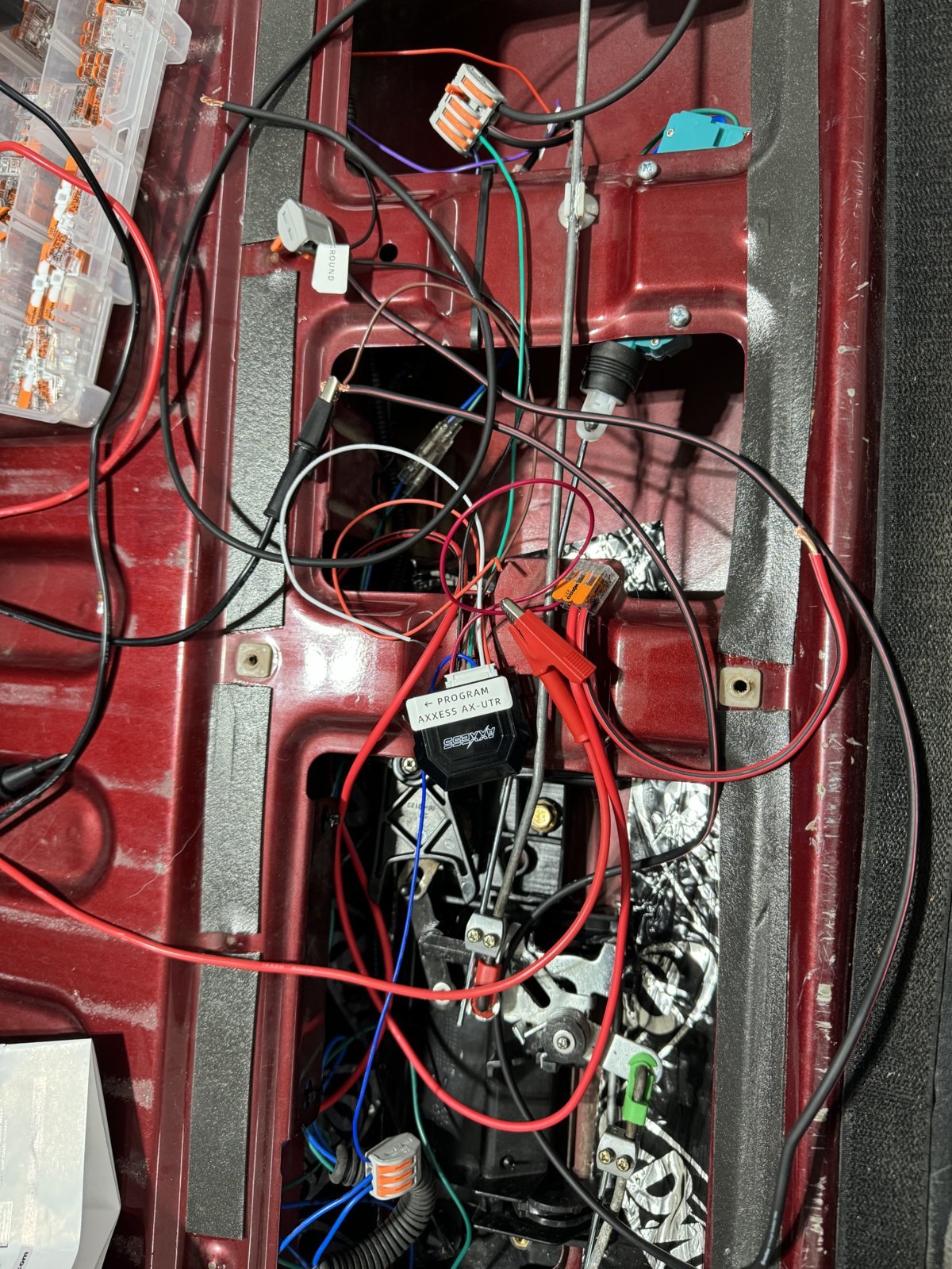

    Setup my tailgate to open when I press unlock twice. I used this trigger output module set to #14. I has previously installed a pop-and-lock so the door lock wires were already in the tailgate, as well as the actuators to open the tailgate with a button, so this should have been pretty easy...
    Except the instructions for the trigger output module were awful. They were definitely written by a Chinese programmer because they had lots of if-then statements and variables. Anyway it works now and here's a picture of the wiring mess I made while working on it.
    I can open the tailgate from the cab by pressing the unlock button twice, so I don't really need another button. I can also open it from my watch in the same way.
    Of course I previously added tailgate open buttons to the corners of the bed. Anyway that's the many different ways to open my tailgate and I don't know what I'll do with all the time I'm saving not pulling the mechanical latch.
    P.S. Suck it, Cybertruck.

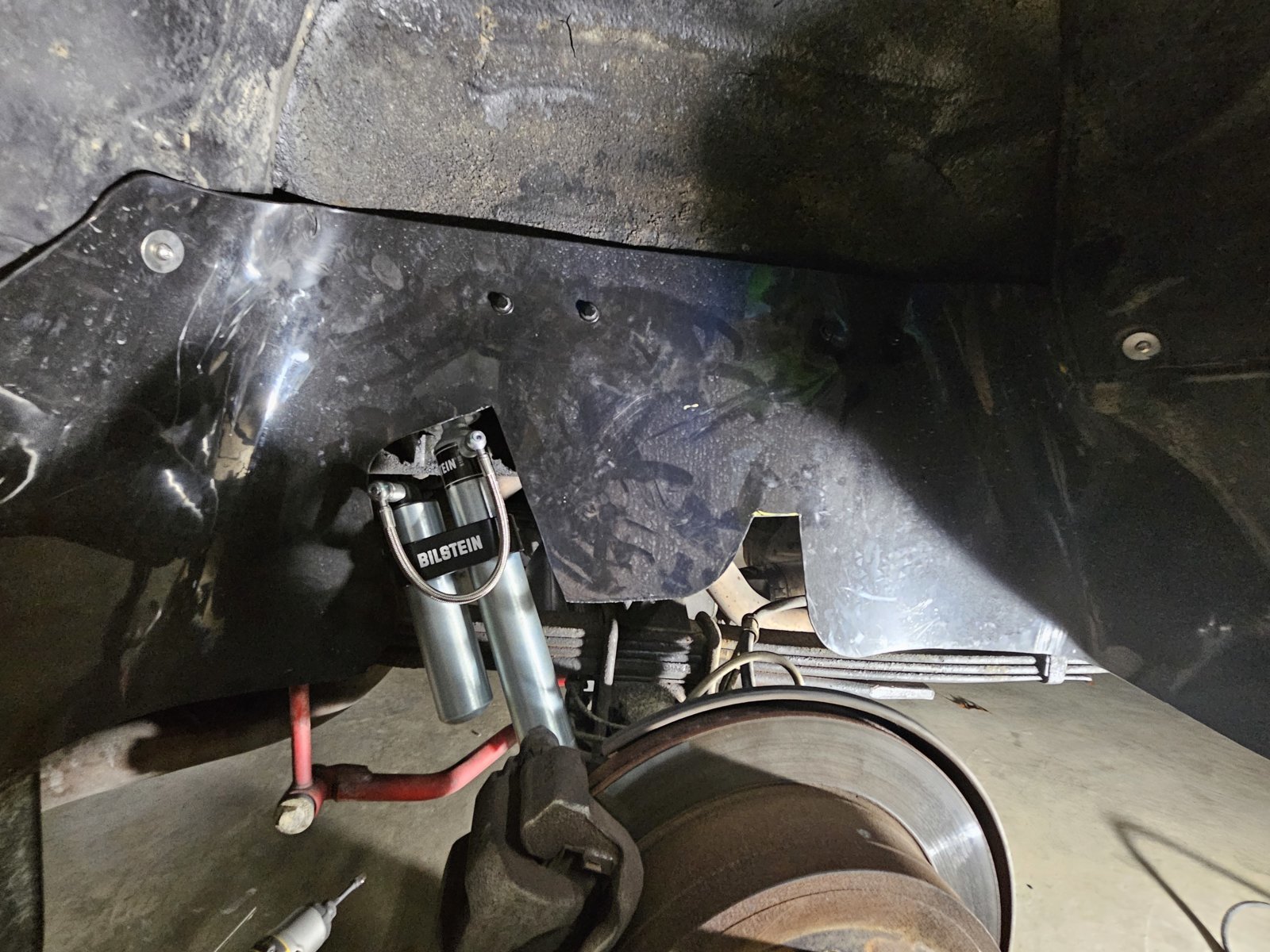

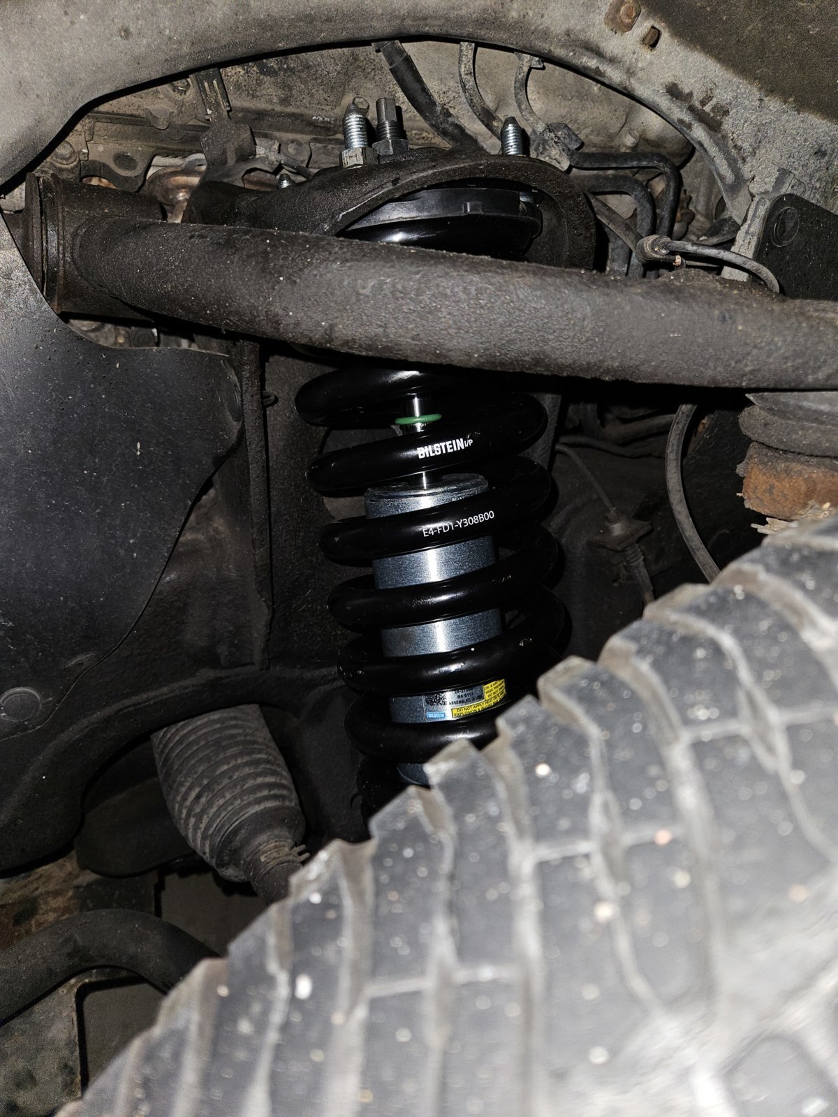

    Installed my cyber Monday score, bilstein 6112/5160. I bought the fronts unassembled and set them at 0.75" (lowest clip) with kyb upper strut mounts. I might be the only person who set 6112s on the lowest possible level but from a 10 min test drive so far I'm very happy. Netted 1" lift but hoping it'll settle lower.

    the ride quality with the preload set low is super nice.
    Also how did you like those spring compressors?

    I still own a pair of the cheap style you rent from auto parts stores, the ones that bend when you look at them. Sketchy! But these shankly spring compressors are amazing. I got them to swap from 650-700lb/in springs on the white tundra and they did it no problem. Smooth and secure, no visible deflection at all. So they were of course no match for these 650lb springs with very low preload. Would highly recommend them for any truck spring.

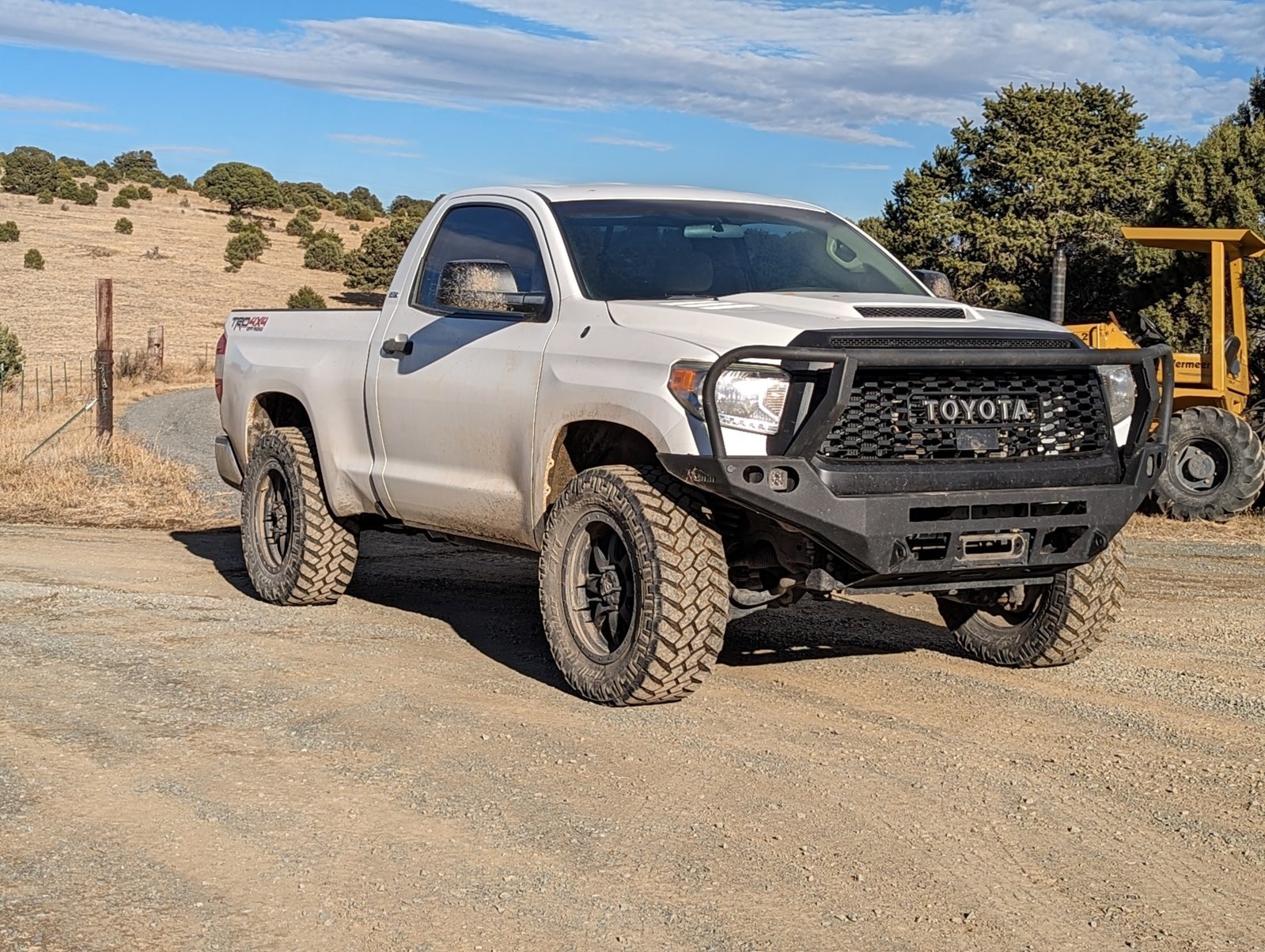

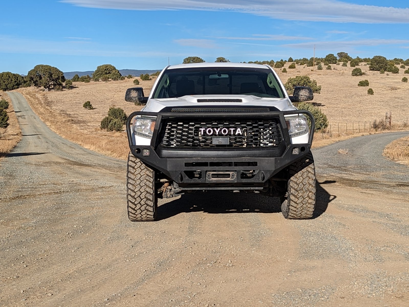

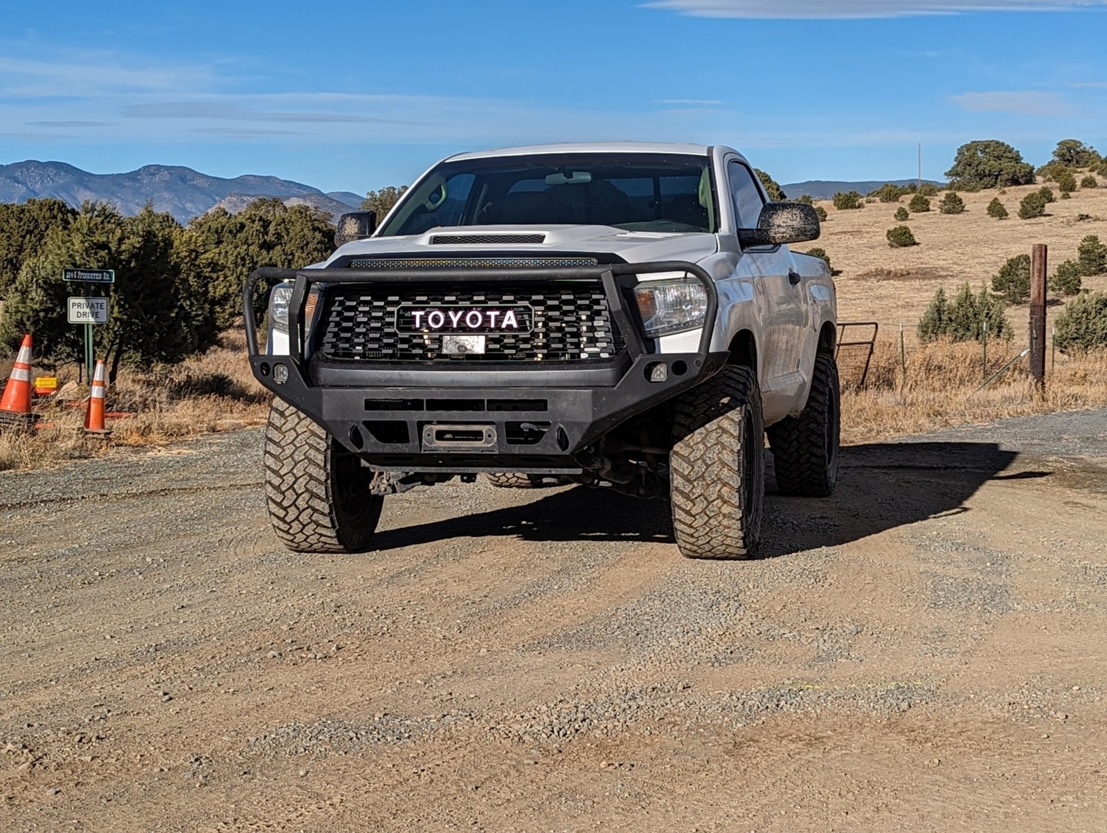

    I got the bumper off of my other truck swapped onto the regular cab.
    PXL_20231204_213709971.PORTRAIT.ORIGINAL.jpg PXL_20231204_213659056.PORTRAIT.ORIGINAL.jpg PXL_20231204_213652164.PORTRAIT.ORIGINAL.jpg

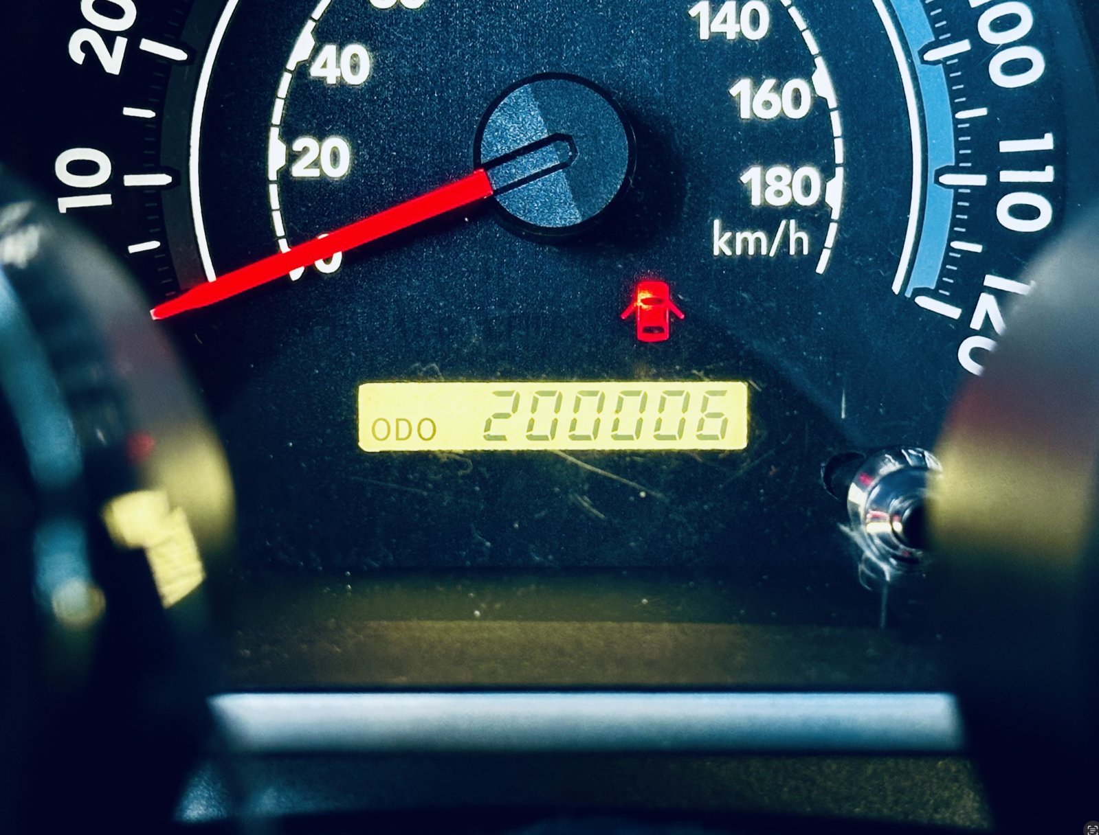

    My trusty steed hit the 200K mark this morning :woot:

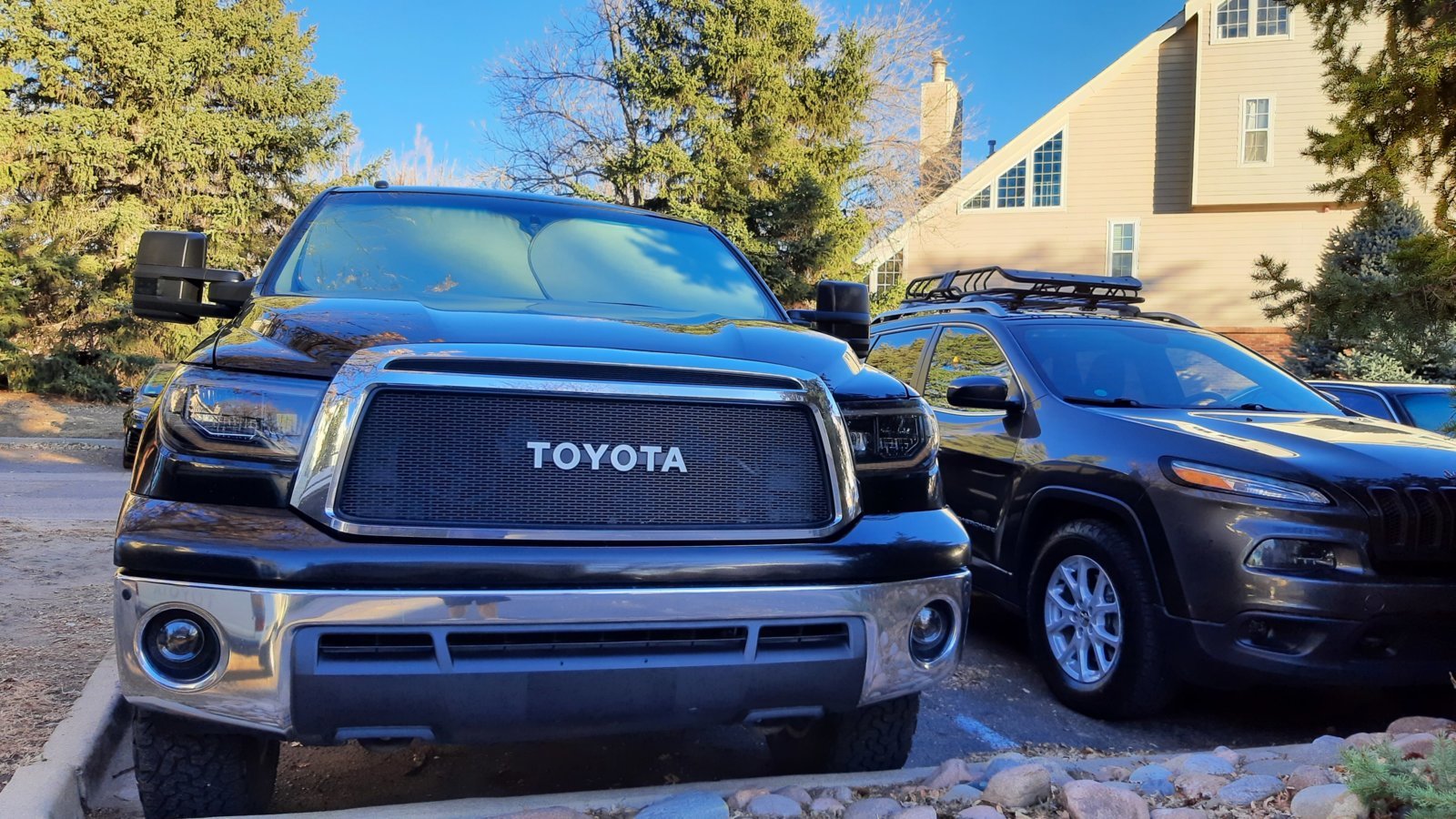

    Installed an early Christmas present, tow mirrors from Boost Auto. They should come in handy for pulling around our 26' Jayco travel trailer... when the spring comes.
    Ran leads for the "reverse spotlights", but have yet to hook them up to the Cargo light switch.
    I DID take the opportunity to add some extra sound deadening material to the inside of the doors. Doors sounds much more solid when closing with vigor... It makes me very happy.

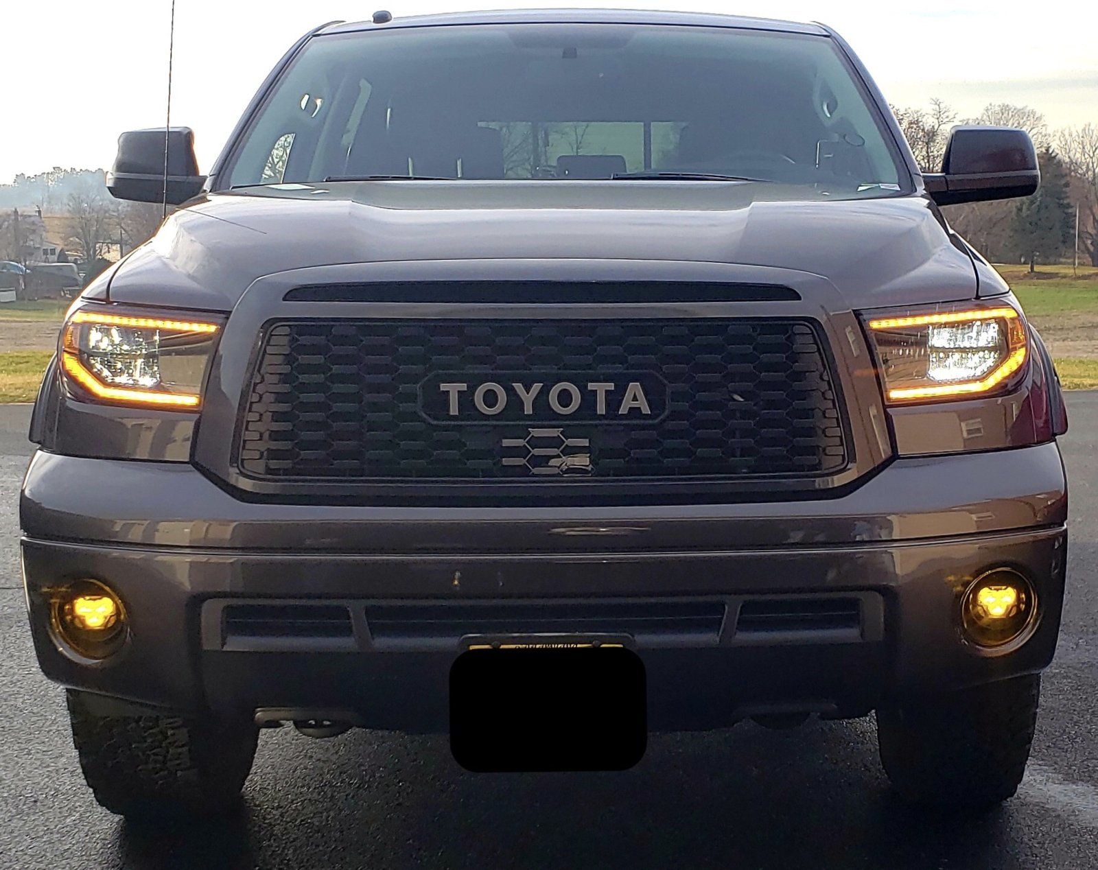

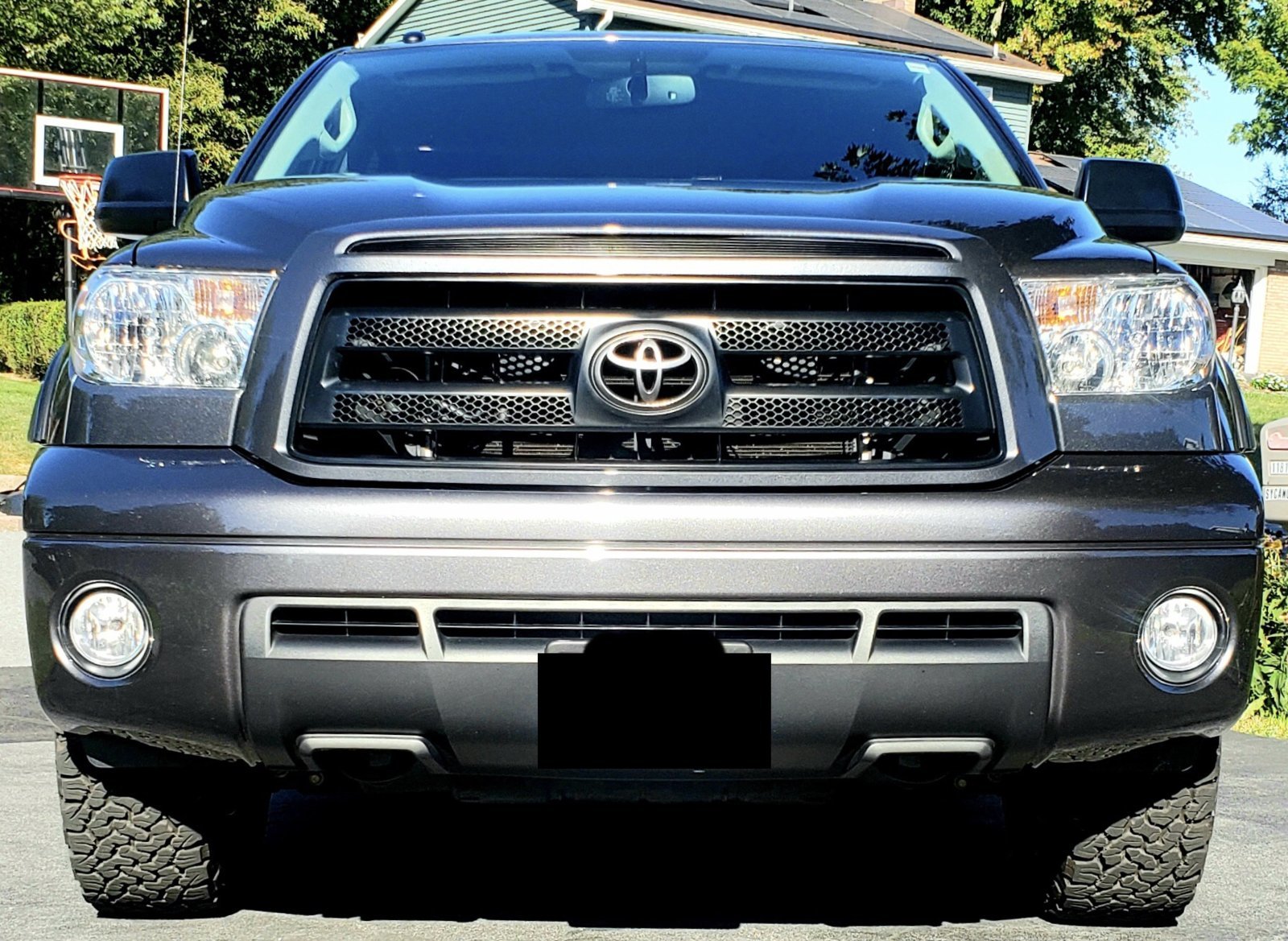

    Heated Leather Seats, Morimoto XB LED and 4-Banger fogs, TRD Pro “style” grille, Bushwhacker Flares, Line-X, Leer Cap, Yak Rack
    Front end makeover thanks to Black Friday Sales.
    Morimoto XBs, 4 Banger Fogs, and Toyota “Heritage/ TRD Pro” style grille.
    Before:
    After:

    Where did you get the grille insert?

    NP Motorsports

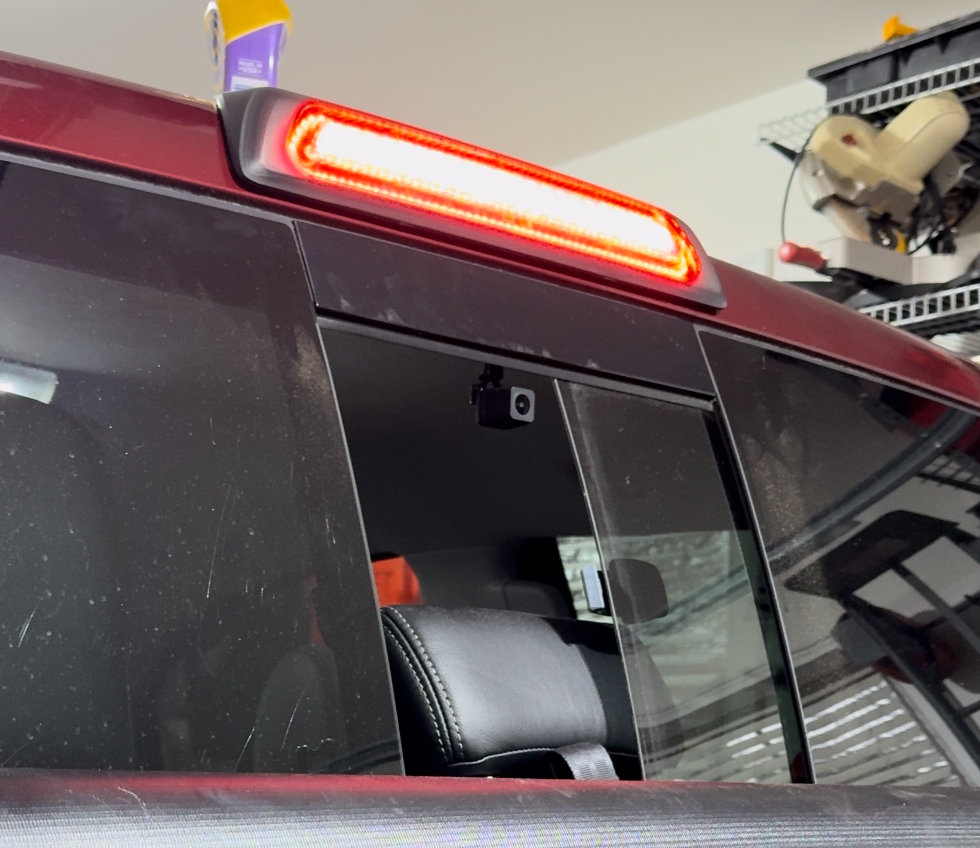

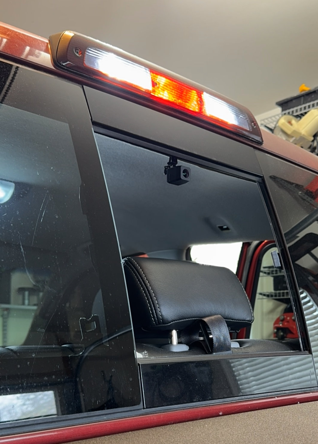

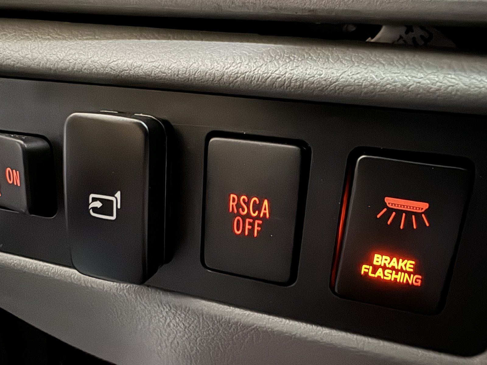

    Upgraded my third brake light thanks to this thread. Before:
    After:
    I guess the cargo light is a little brighter though I had upgraded the bulbs to LED. The new brake light definitely looks more modern.
    I'd heard the install was a nightmare but it's not bad... Maybe 60-90 minutes if you did only the brake light replacement.
    It has a feature where it flashes when you press the brake light if you have a switch flipped on, like Formula 1 or an ambulance. I don't normally want that, but I would use it during bad conditions like snow or fog, so I cut their switch out and ran a pair of wires to the dash connected to this custom "Brake Flashing" switch from ch4x4.
    So now I can flash when needed.

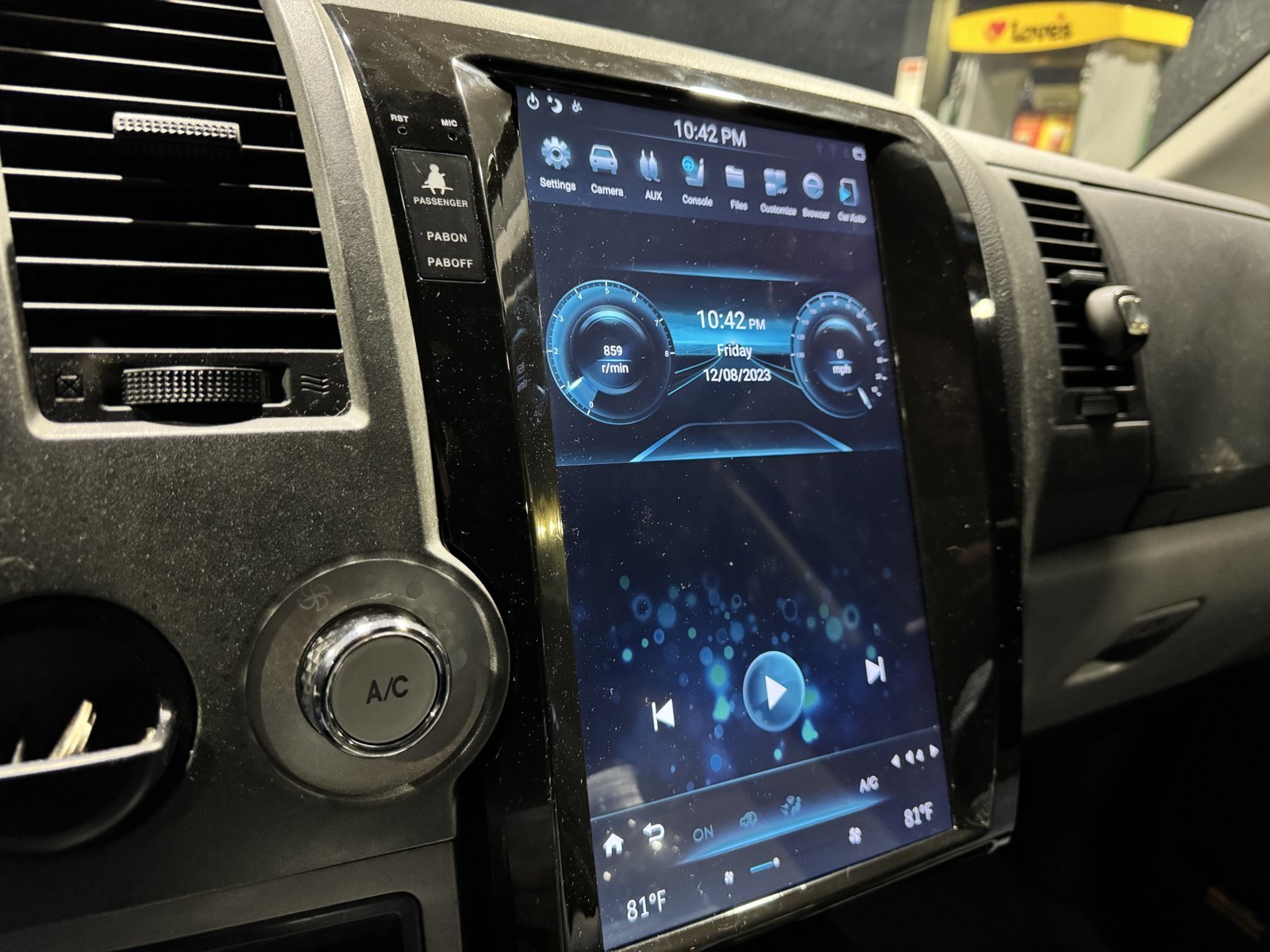

    Thanks to @PhotoNerd I got a new (to me) Tesla style radio installed. Worked pretty well for me. Still working out some kinks with CarPlay, but for now it looks way more modern than what I had before. Thanks PN!!

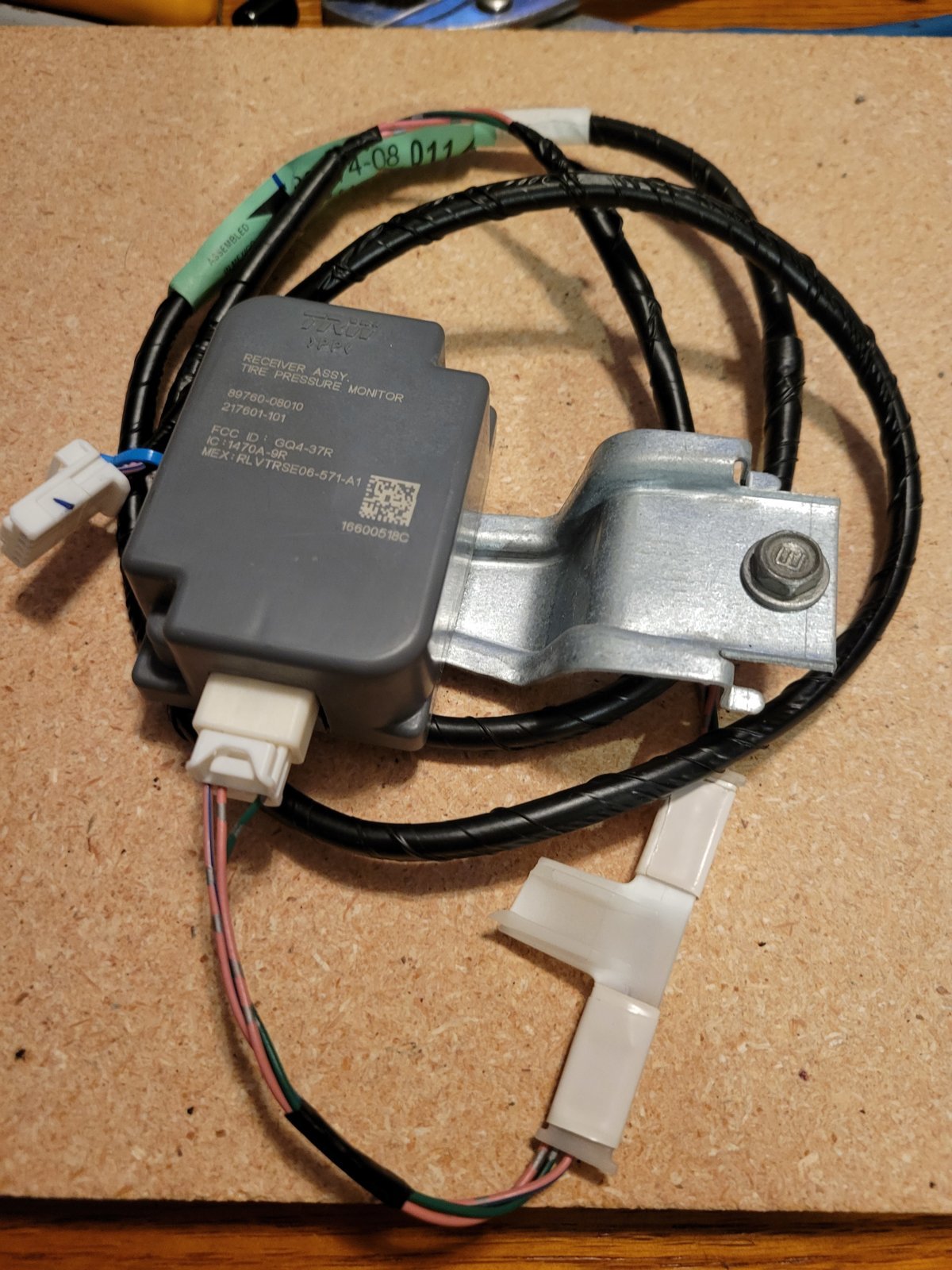

    What did I do today?
    1) Determined my black 2008 Tundra 4x4 will one day be all black outside save the optional 20" wheels, and every 'red' TRD option available except... 'black chrome' TRD exhaust tips. (They were an option)
    2) Sourced a replacement TPMS Receiver/Antenna from a 2008 Sienna: $5.00 at Pick-A-Part! (Yup... $5). Took me an hour to find it, only to discover how easy it is to access:
    Sit in the driver seat and pull the headliner down right above the steering wheel. You can't miss it! Bring a 10mm socket: Pull the A-pillar and chase the harness down to the dash/windshield corner.
    Part#: 89760-08010 (pictured).
    Now, to see if it's "good"...
