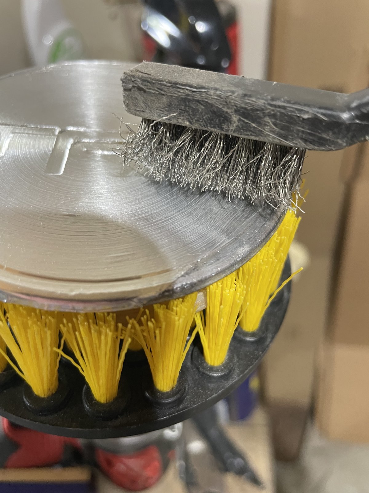

    Finally got new tires for winter just after the second snow. 285/70r17 load range C Falken Wildpeaks. Also dressed up my center caps with some foil tape and new TRD decals.

    Foil tape! Please tell me more.

    Foil tape! Genius.
