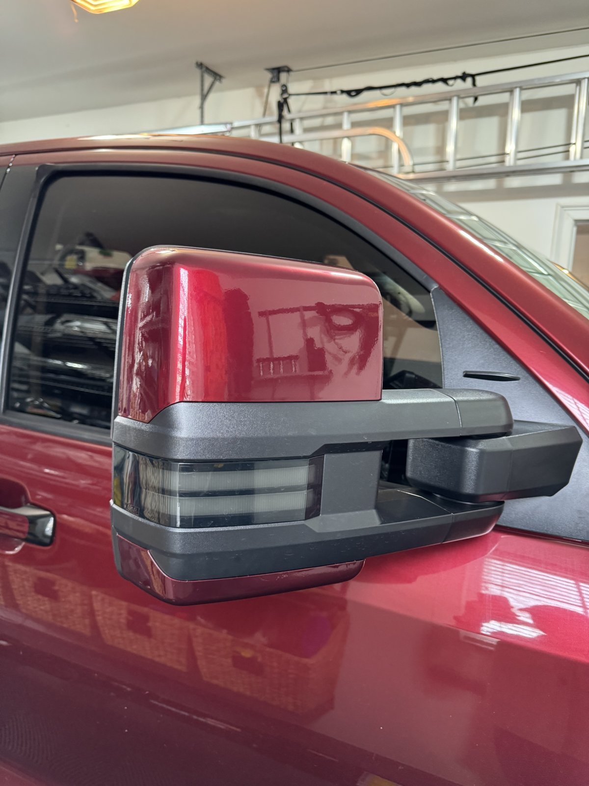

    Wrapped my boost auto tow mirrors using this wrap that pretty closely matches my Salsa Red 3Q3.
    Before/after:
    I need more practice at wrapping but it still turned out better than when I painted the previous mirror caps.

    Looks really good

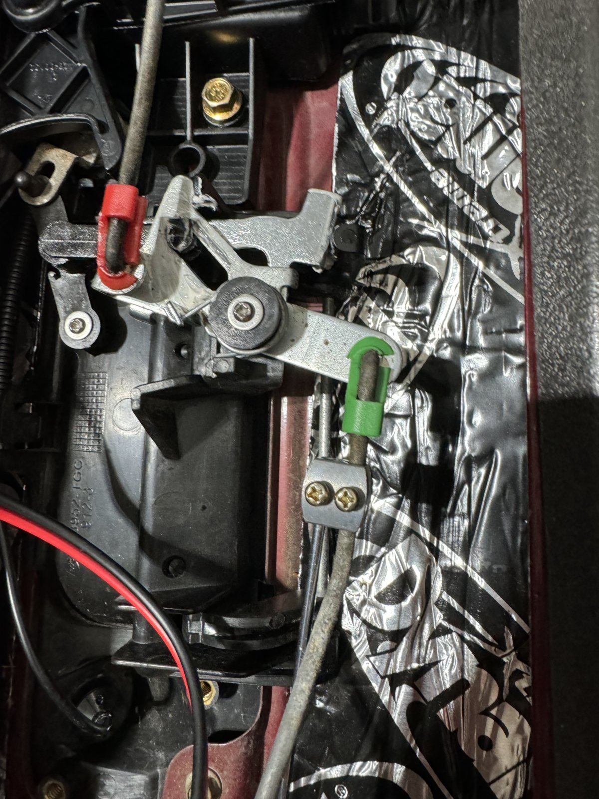

    I added tailgate open buttons to both sides of the bed. It's nice when you're pulling up with a cart or you have your hands full or you're packed into a garage and using the regular tailgate handle would require awkward maneuvering around the tailgate as it lowers.
    It's useful enough that it's a feature on the new Tundras, but really, I'm just trying to upgrade my electrical skills.
    I installed two door lock actuators inside the tailgate and attached them to the poles that connect the tailgate handle to the latches on either side. When they get 12v to the blue wire, they push pretty hard, opening the tailgate if it's unlocked (but not if it is locked). One actuator was powerful enough, but I bought two so why not hook them both up.
    Closeup of the actuator screwed into the tailgate:
    Closeup of the connections between the actuator arm and the two tailgate latch poles:
    I ran the wires to a momentary button I drilled through the plastic cover on top of the bed (there's a hole in the sheet metal underneath so this was easy). I put one button on both sides and connected them to constant power that I had previously run for my bed lights. The buttons poke up enough I can easily push them with my elbow if my hands are full.
    This is partially based on this thread. In the future I'm going to add a tailgate release button to the cab but I need to run more wires the length of the truck.
