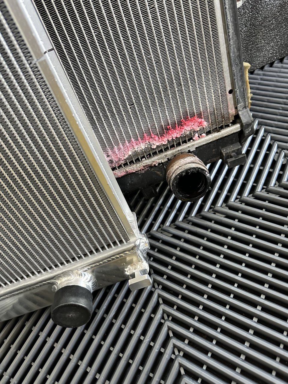

    Please talk me out of replacing my water pump.
    I pulled the radiator. Here's the leaky old vs the new.

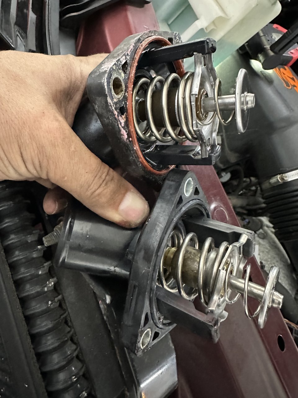

    I preventatively replaced the thermostat, which looked brand new.
    Now people say, "While you're in there, do the water pump." But now I'm tired and it looks like it's still a pretty big job since I need to remove the fan and like 15 hoses. Truck has 90k miles and I assume it's never been changed (I'm not the original owner). No sign of leaks.
    If I leave the pump, am I going to regret it?

    Only when it fails!

    Agreed. If it doesn't show signs of weeping or makes noise, leave it alone!

    with the radiator out, you might as well do it with the extra room you have.

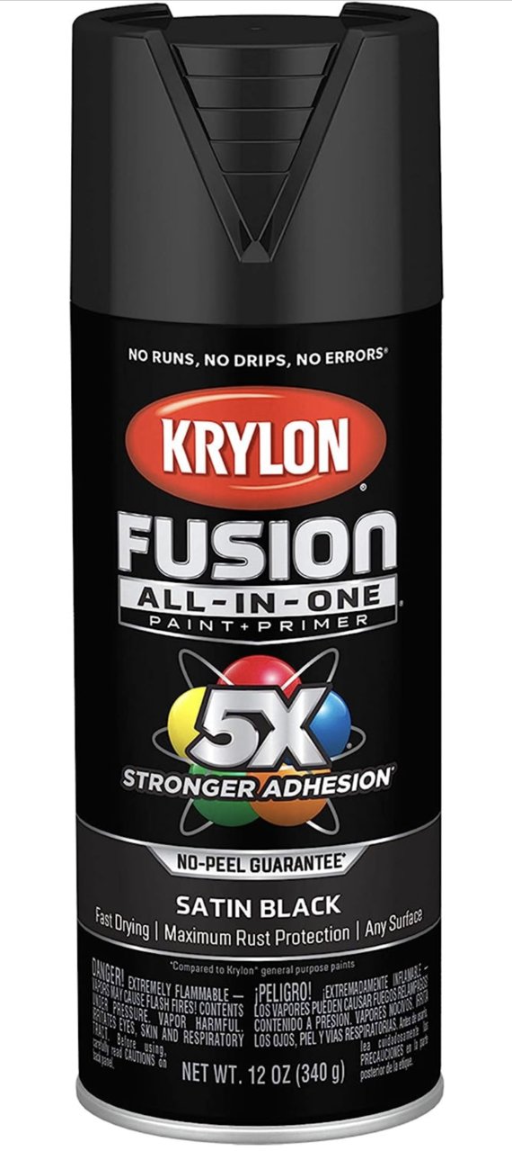

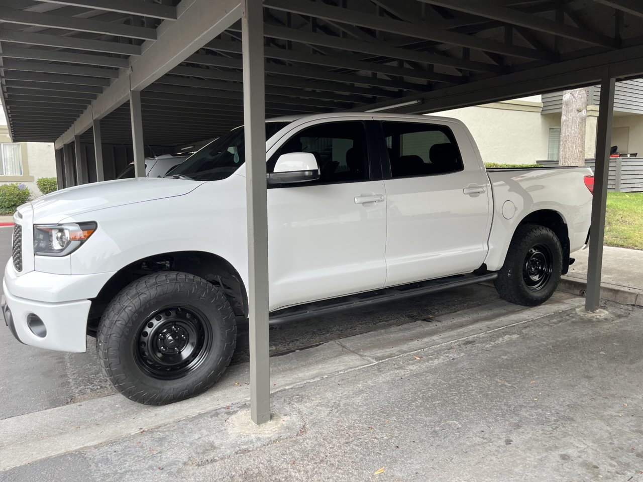

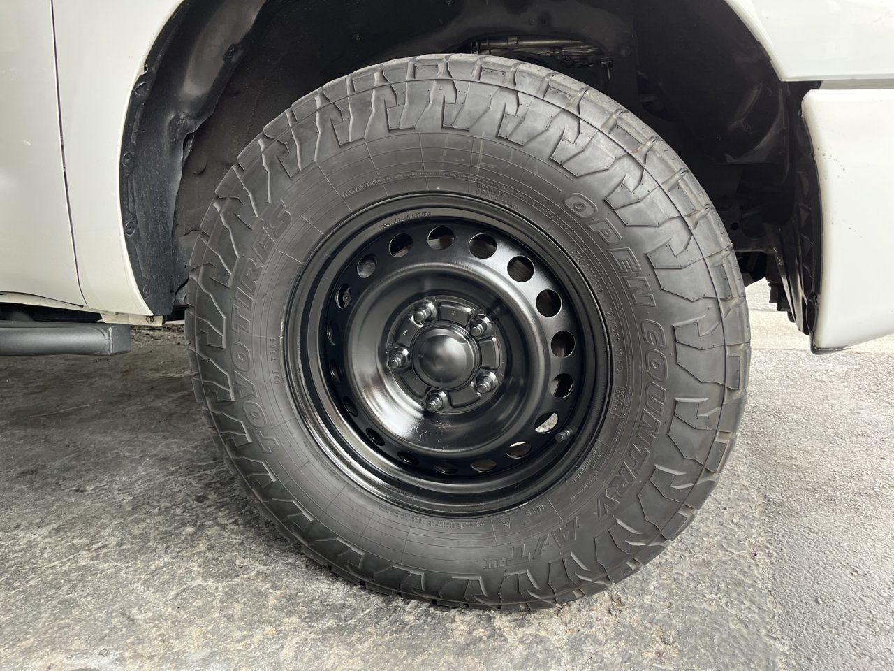

    Got the steelies rattle canned satin black…it’ll do! Tires are 295/70/18 IMG_7308.jpgIMG_7314.jpgIMG_7313.jpg

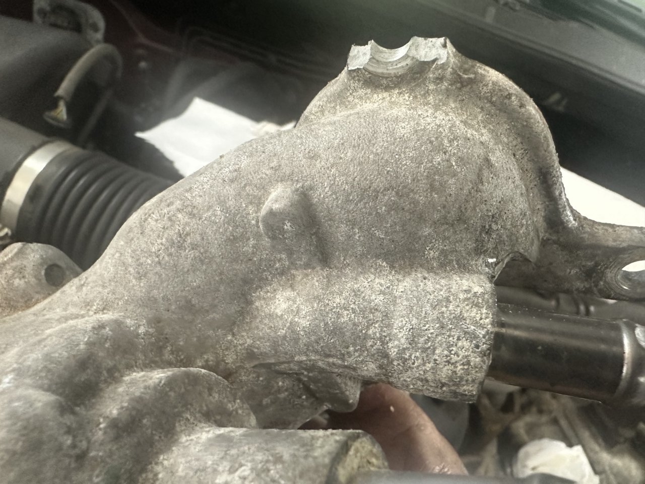

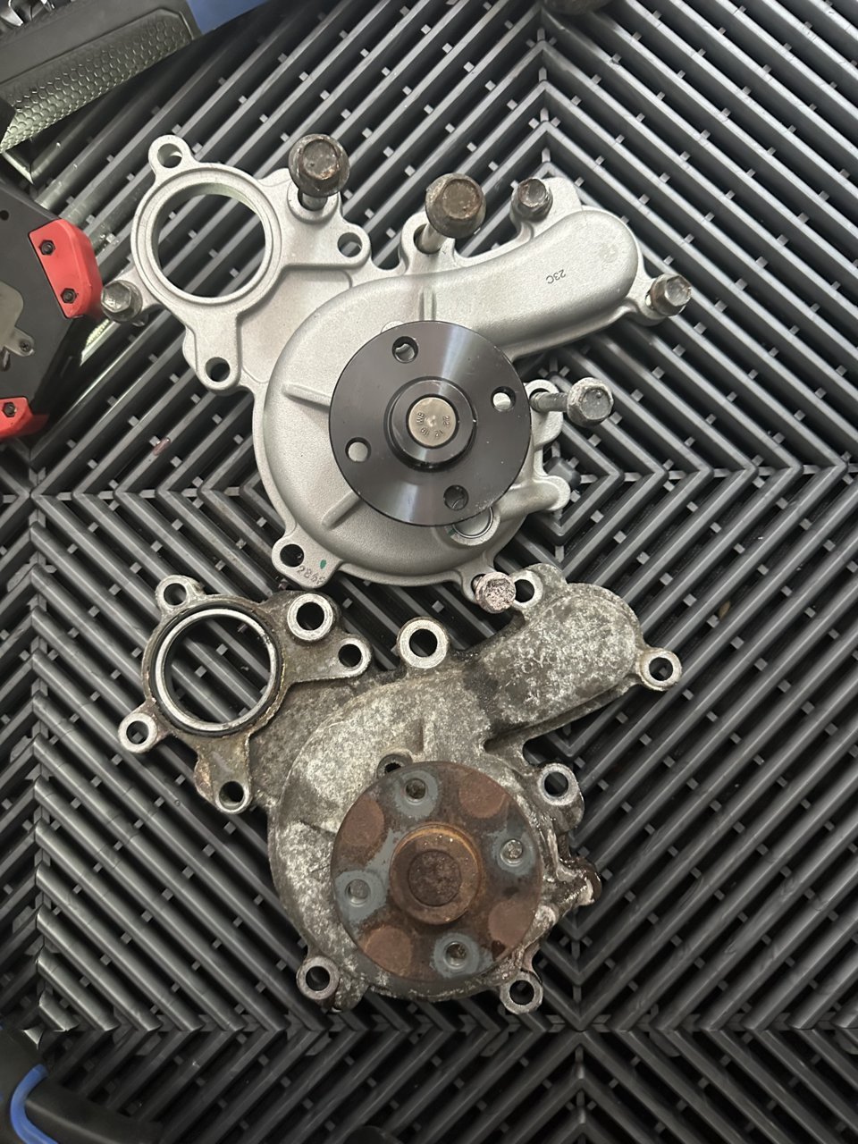

    I put away my laziness and pulled out the water pump. What a PITA to access! It WAS leaking; the gasket was dry and cracked. New/old:
    I broke the thermostat housing by trying to remove it with a hidden bolt still present. So I'm outta commission for a few days until that part arrives.
    I ordered a Haynes manual hoping it does a better job than randos on YouTube of illustrating all the bolts and hoses.

    I had black steelies on my Taco. I loved the steelies. They are simple and look good.

    And easy touch ups!
    Bonus I already have the matching spare underneath!!!

    It's a good thing you found the pump problem now, they're no fun when they go out away from home. The last one that went out on me (non-Tundra) did it on the highway and it took the radiator with it. The pump seized and spun the fan off the shaft into the radiator. As for the thermostat housing......

    Agreed do pump now.

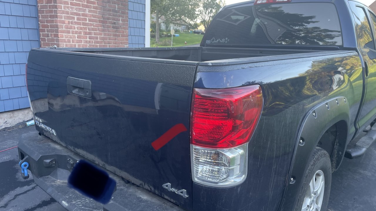

    I've seen the paint on the bed rails get progressively more chipped and worn down by the plastic caps. Was starting to rust pretty good in a few spots, and I didn't think painting would help much as it would just wear off again. Line-X didn't want to touch the rails, as they said the material would be too thick to place the caps back on. I sanded and Raptor-lined the rails, two thinner coats, and it came out great for a first attempt. I did a thicker stripe on the tailgate where its subject to a lot of bumps and bruises, and I kind of wish I had extended the liner material down further on the outside of the rails too.

    JB WELD is you're friend!

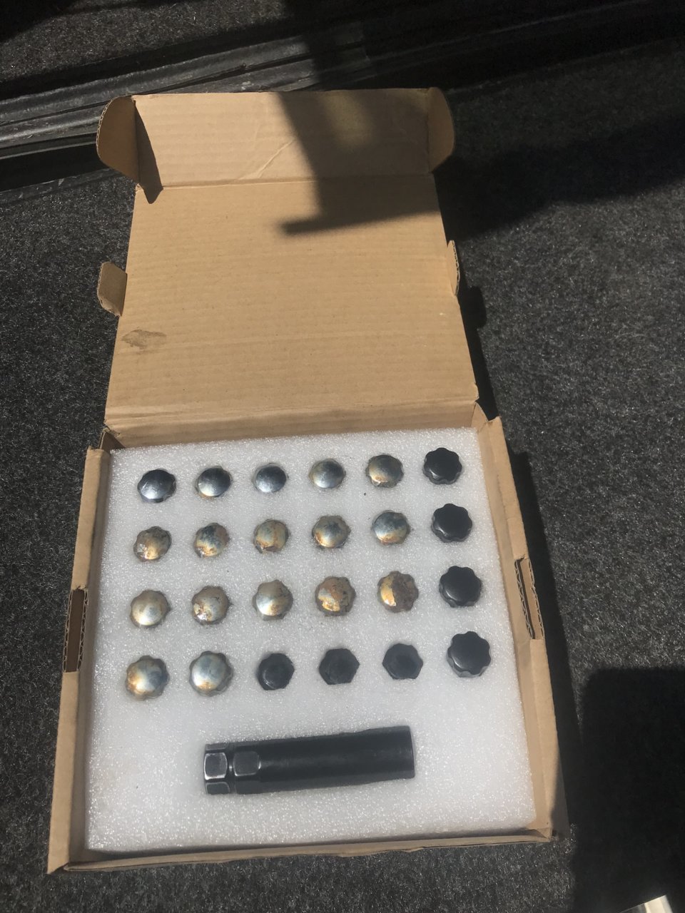

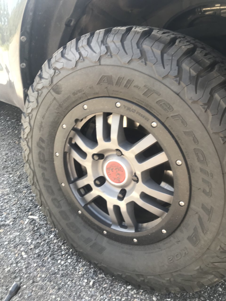

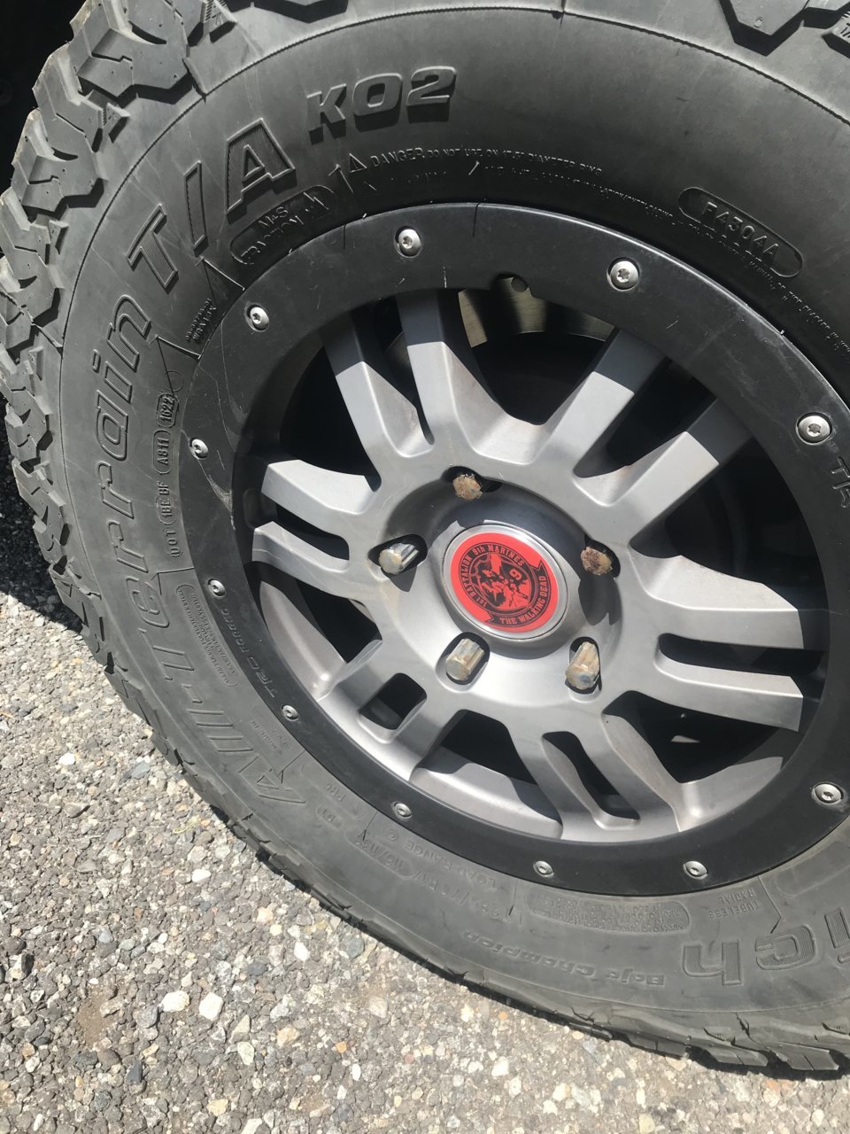

    Last week I had 3 different lungs nuts break the studs off when I tried to rotate my tires. They broke off at the base of the stud and after talking it over with a few friends and a trusted mechanic, I've concluded that the mag chloride CDOT uses on its roads all winter and spring could actually be my culprit. The corrosion was built up inside other lugs and on other studs as well. So I went to Amazon and ordered up a new set of lugs. This A.M. I cleaned all the studs and installed new lugs.
    Before-you can see rust on my old lugs
    After-color matched to boot.
    The old lugs with the chrome coating coming off and rusting.

    Where does one get a set of steelies? I would much rather run 17-18" steelies than these 20" monsters I have now (at least make a few bucks in the process to put towards other mods)
