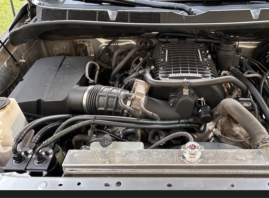

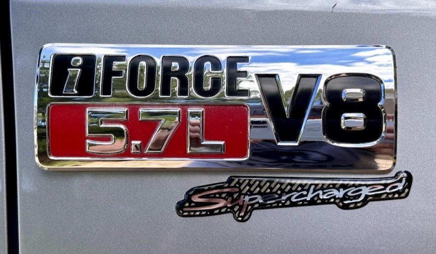

    Stopped by the stealership and picked up some TRD Supercharged emblems for those few extra ponies! Also installed the dual Radium Engineering catch can kit.

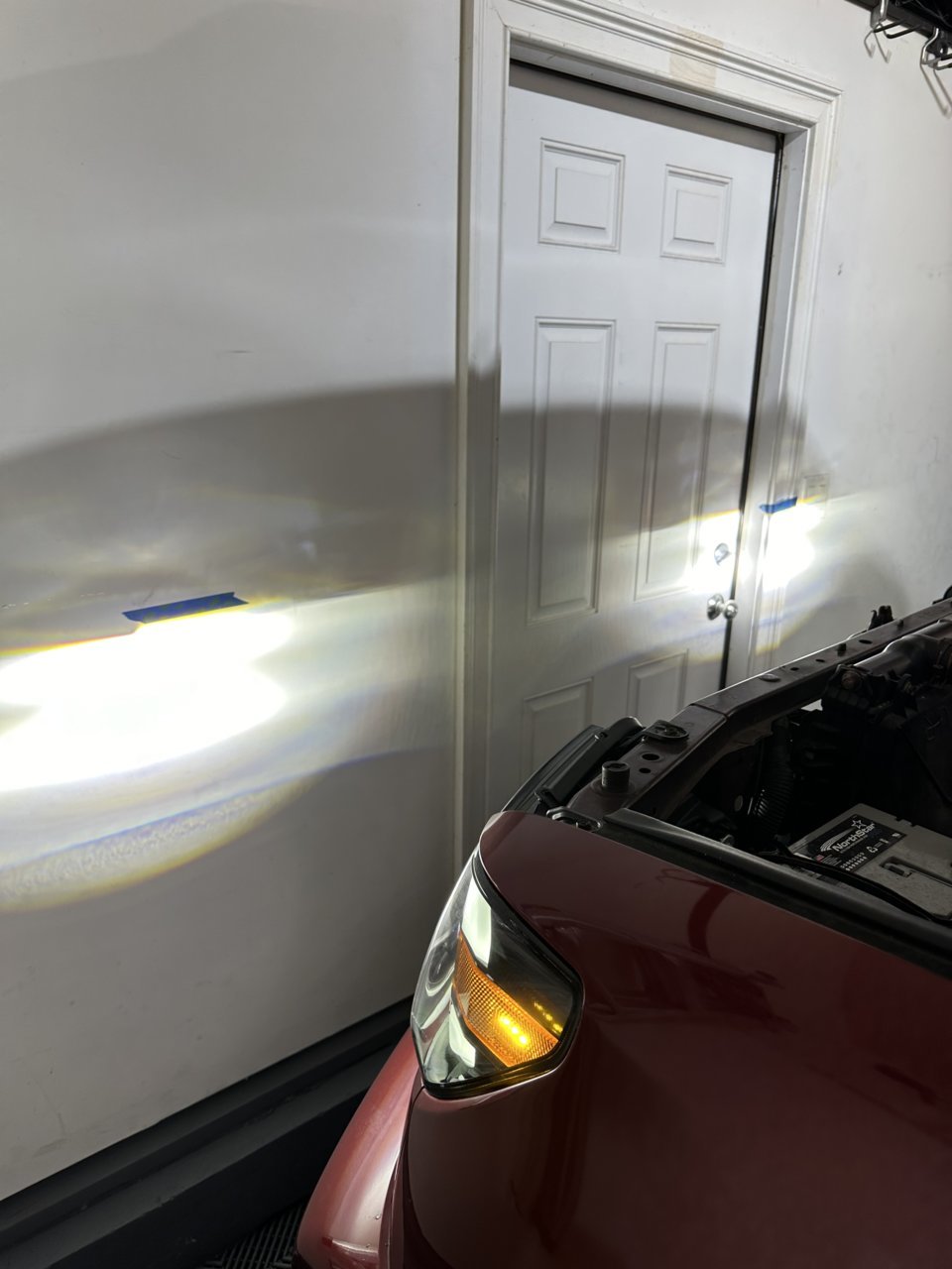

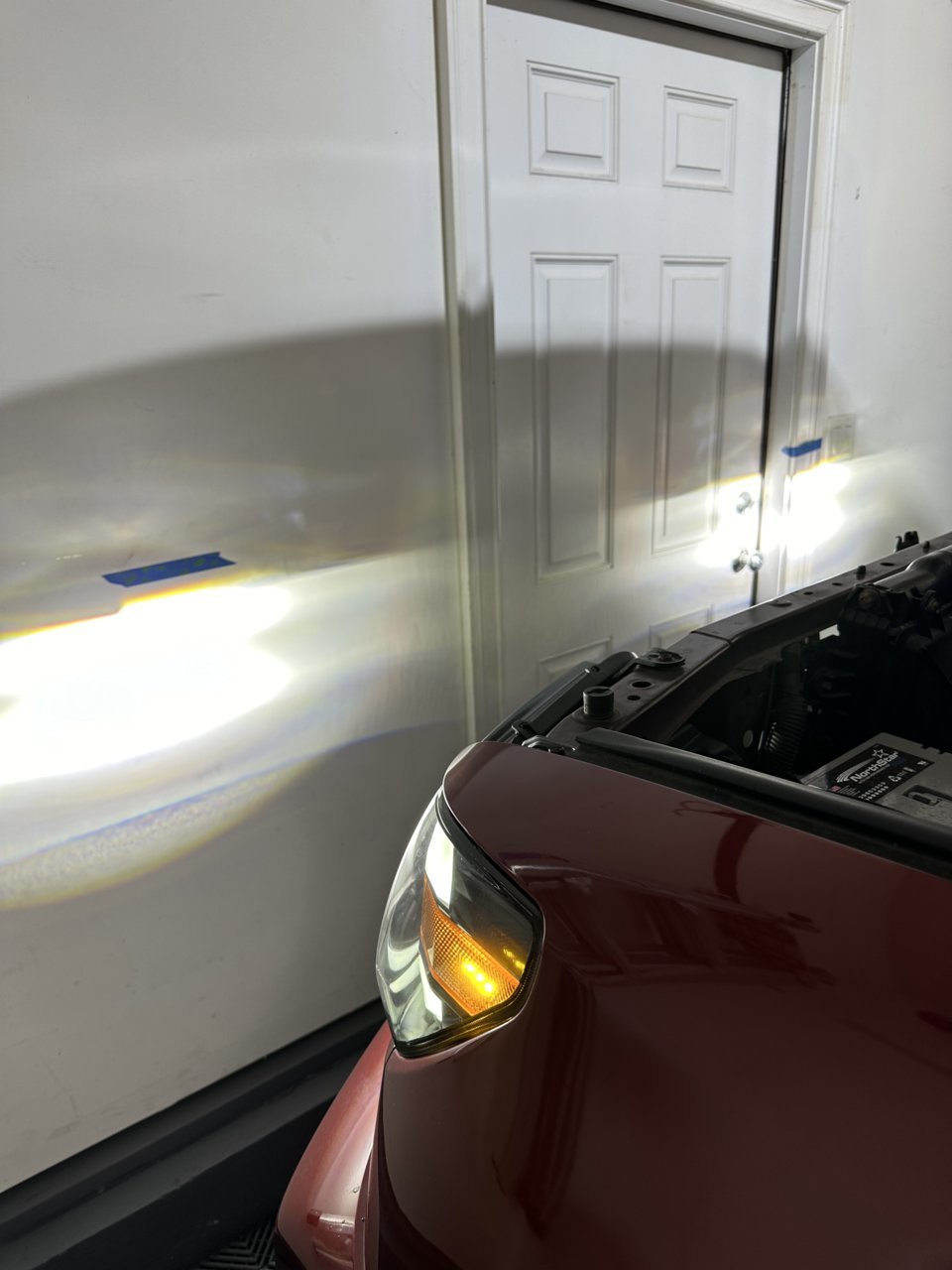

    After installing the Fox 2.0 struts up front my headlights were a little high so I pointed them down some. Maybe not enough, I'll drive it and see.

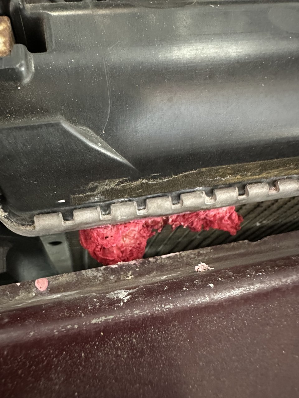

    Also spotted low coolant and this...
    So I guess I'm replacing the radiator at 90k miles. OEM or third-party recommendations? Should I replace the water pump at the same time? Just OEM for that?
    Anything else I should do while I have it out? Maybe install a supercharger?

    The answer to this is always yes.
    My radiator had a small crack in the bottom where the plastic was crimped to the metal. I replaced it with a Denso at approx 133K ish and has been good for the last 11K. I did a new Denso T Stat at the same time as the radiator. My water pump also went at about 130K ish but had the stealership do that since we were in the middle of moving at the time.

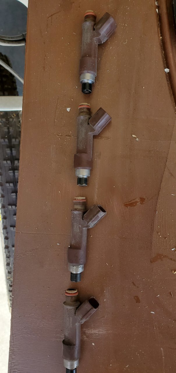

    Installed 12 hole fuel injectors. Pretty straight forward, just had to use a pick to pull the old injector seals out. Too early to say how they perform but so far so good.

    Where did you buy these 12 hole injectors and are they compatible with the 5.7?

    FYI 5.7 already has them..

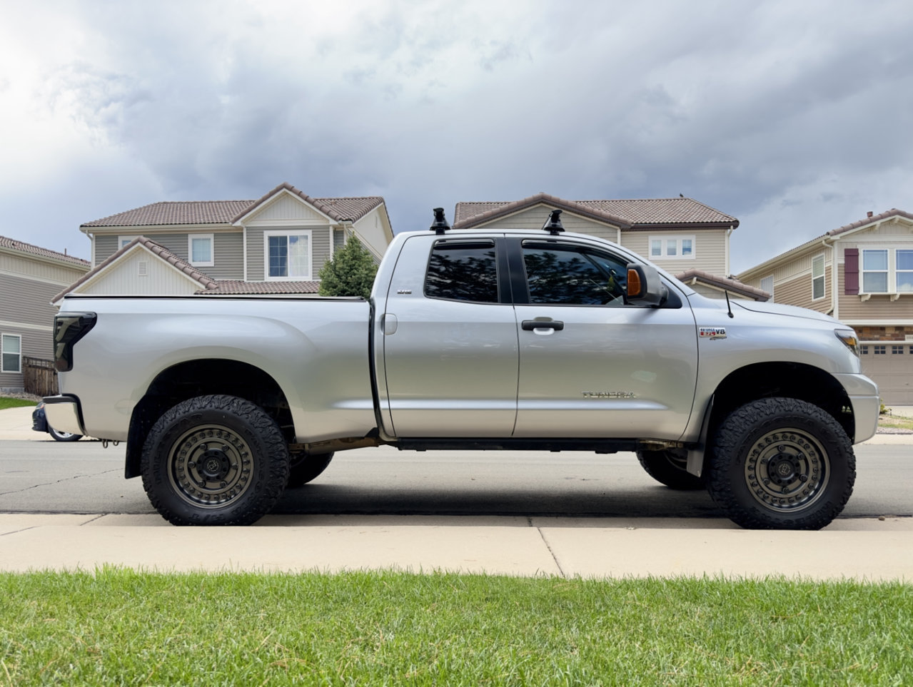

    Added some Alpharex LUXX series black taillights and new wheels, 20x9.5 Black Rhino Armory. Next up is to blackout all chrome and finalize what bumpers to go with.

    Gotta love the Gen2 double cab!! Proportions are perfect, even better dressed up!

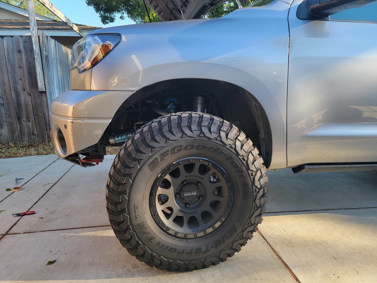

    I was looking to do something similar soon. Something like the viper cut? I want to move up to 40’s next year, so this (or different bumper) and a BMC will be needed.
    Send like those fog light brackets get in the way of a clean cut?

    I don’t know about your current suspension set up; but if your CV’s are stock, be careful on the 40s, stock CV’s are known to be able to handle 37s and wheel without breaking, but 40s would be beyond their limit
    also if not done, it wouldn’t be a bad idea to truss your spindles

    I’m running a 12” Bulletproof lift with 38’s now. Not sure if previous owner did the upgrades you mentioned.
