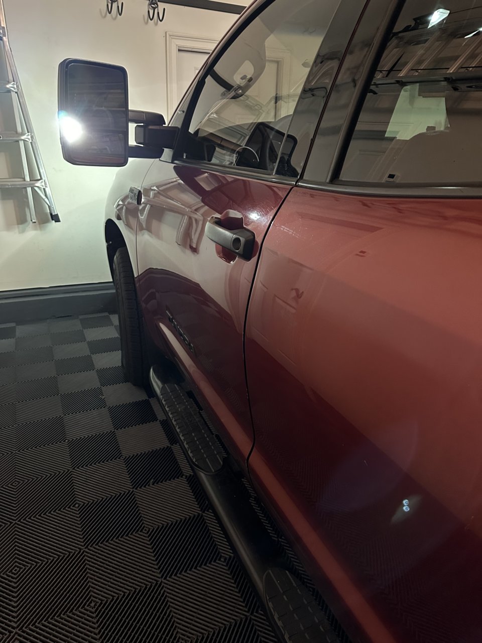

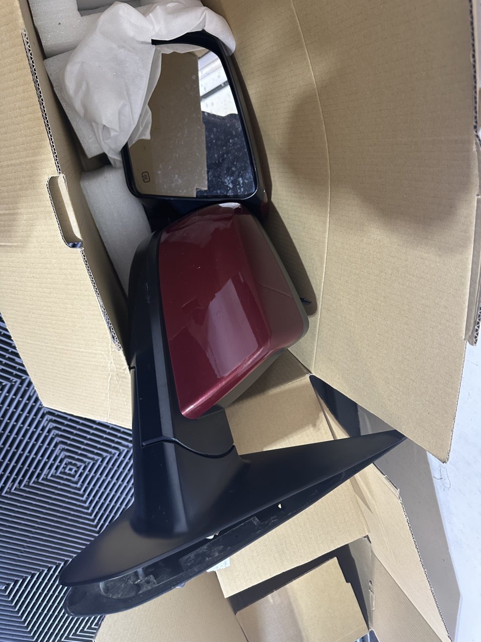

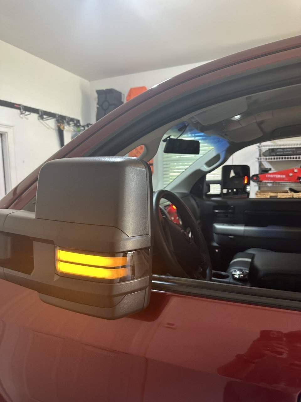

    Finished upgrading my mirrors to power-fold tow mirrors from Boost Auto.
    I wired the white reverse lights into the cargo light (thanks for the suggestion). I tapped into the brown wire in the driver's side door channel, but there are two brown wires and it's mathematically impossible for me to have chosen the correct one so I spent about 30 minutes troubleshooting that thinking my vampire tap wasn't connecting before I just cut the wire and discovered there was a second brown wire. If you do this, it's NOT the brown wire twisted around the red wire.
    Now that I have a cargo light tap I can add some more courtesy lights.
    Here's a photo of both mirrors folded with the courtesy lights on.
    And here's the courtesy light.
    Overall I'm happy with them. I can see the sides of the truck much better and there's no blind spot. It definitely helps me make the tight turn into my garage which has caused me a few scrapes. The running lights look cool when the headlights are on and the progressive turn signals match my headlights. The ability to fold them is great because it makes it easier to squeeze past in my narrow garage.
    I still need to figure out how to replace the ugly fold switch they included, which has some kind of logic in it making it more complex than just swapping the switch.
    If someone wants OEM mirrors that are in good shape but have been very poorly painted Salsa Red 3Q3 send me a DM.

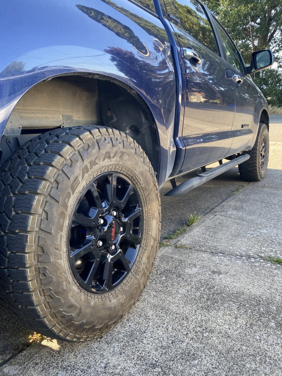

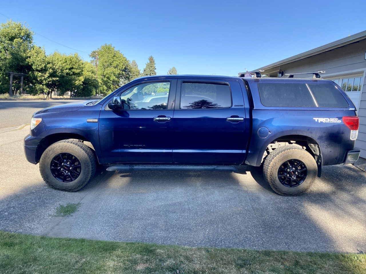

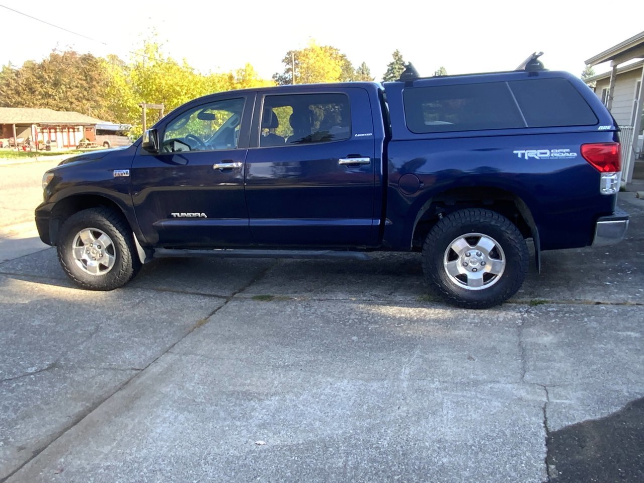

    Upgraded the wheels to some 2017 TRD Pros. Thanks @Rodtheviking !!
    Before
    After

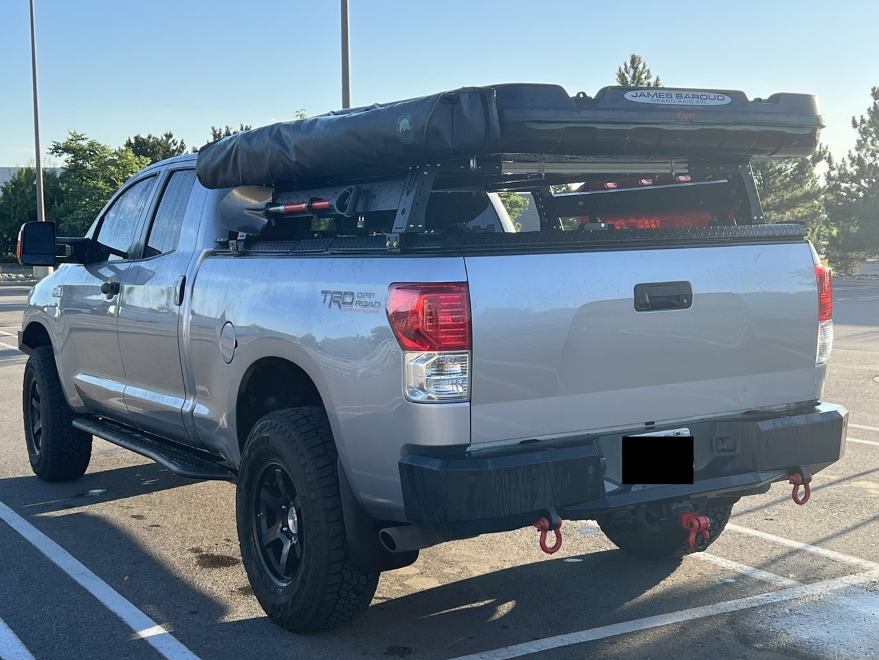

    Won't be installed for a couple weeks but picked up a new rear bumper from SS Built in Phoenix today.

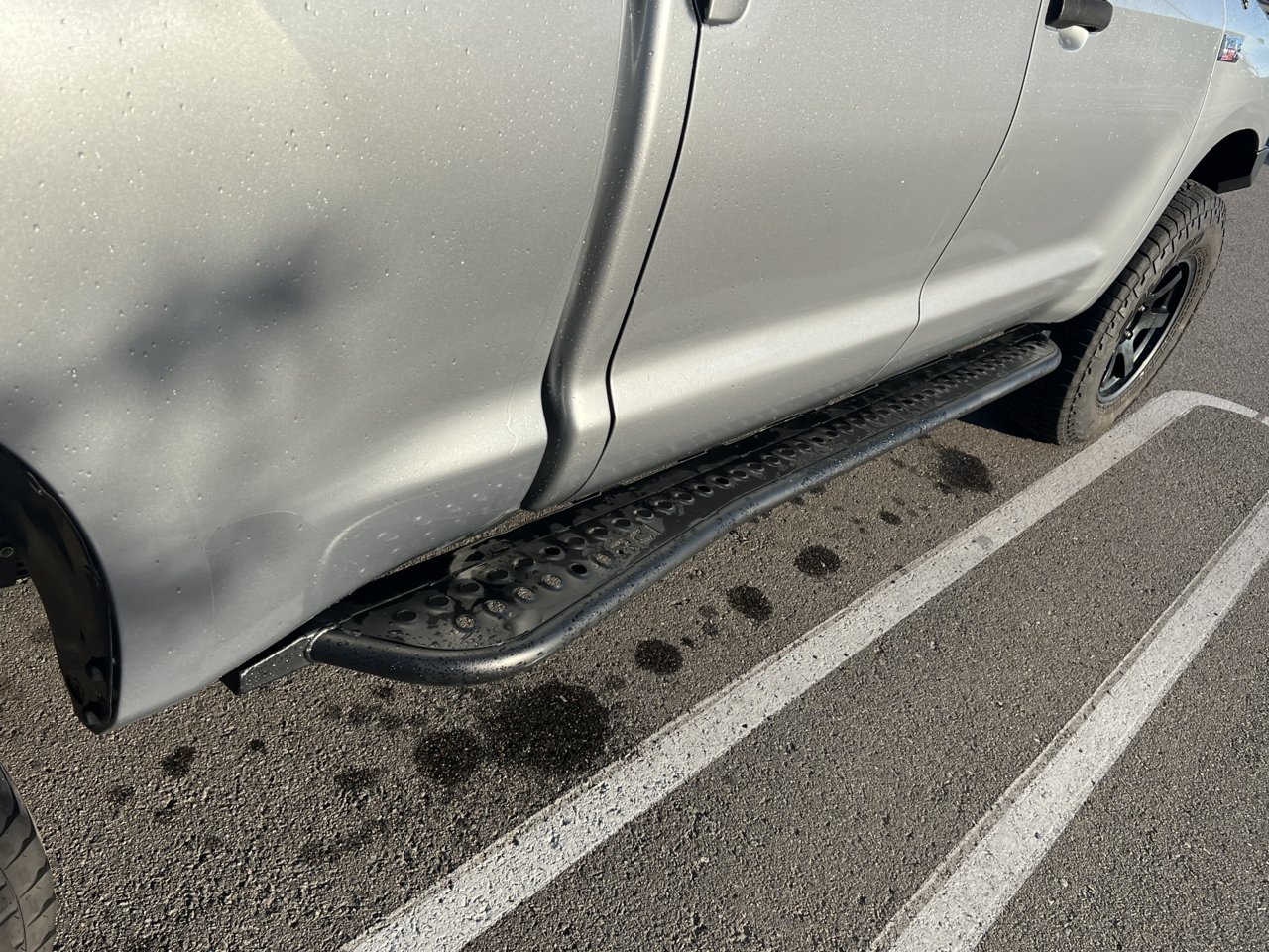

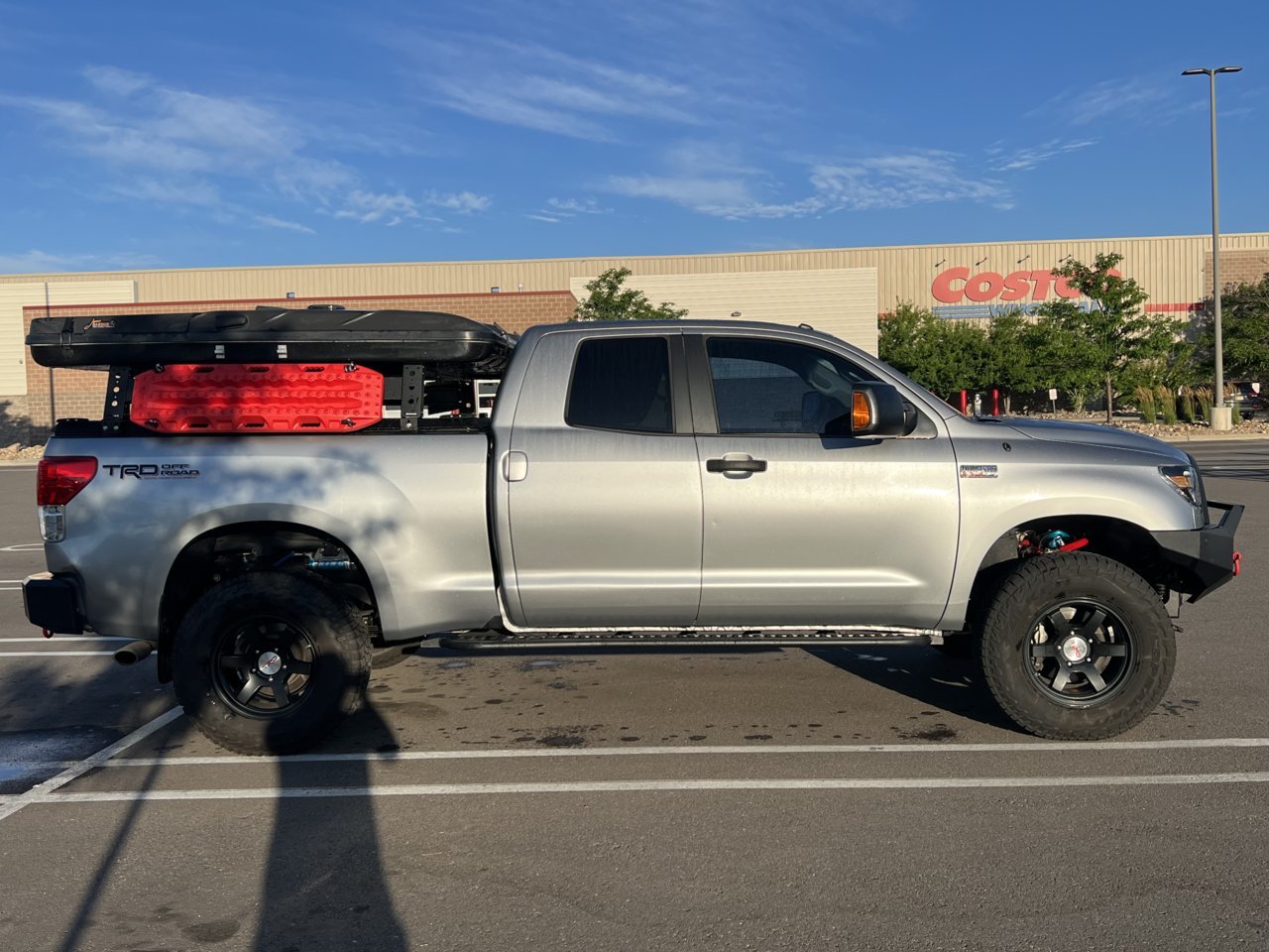

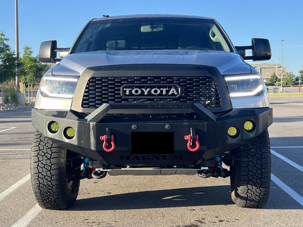

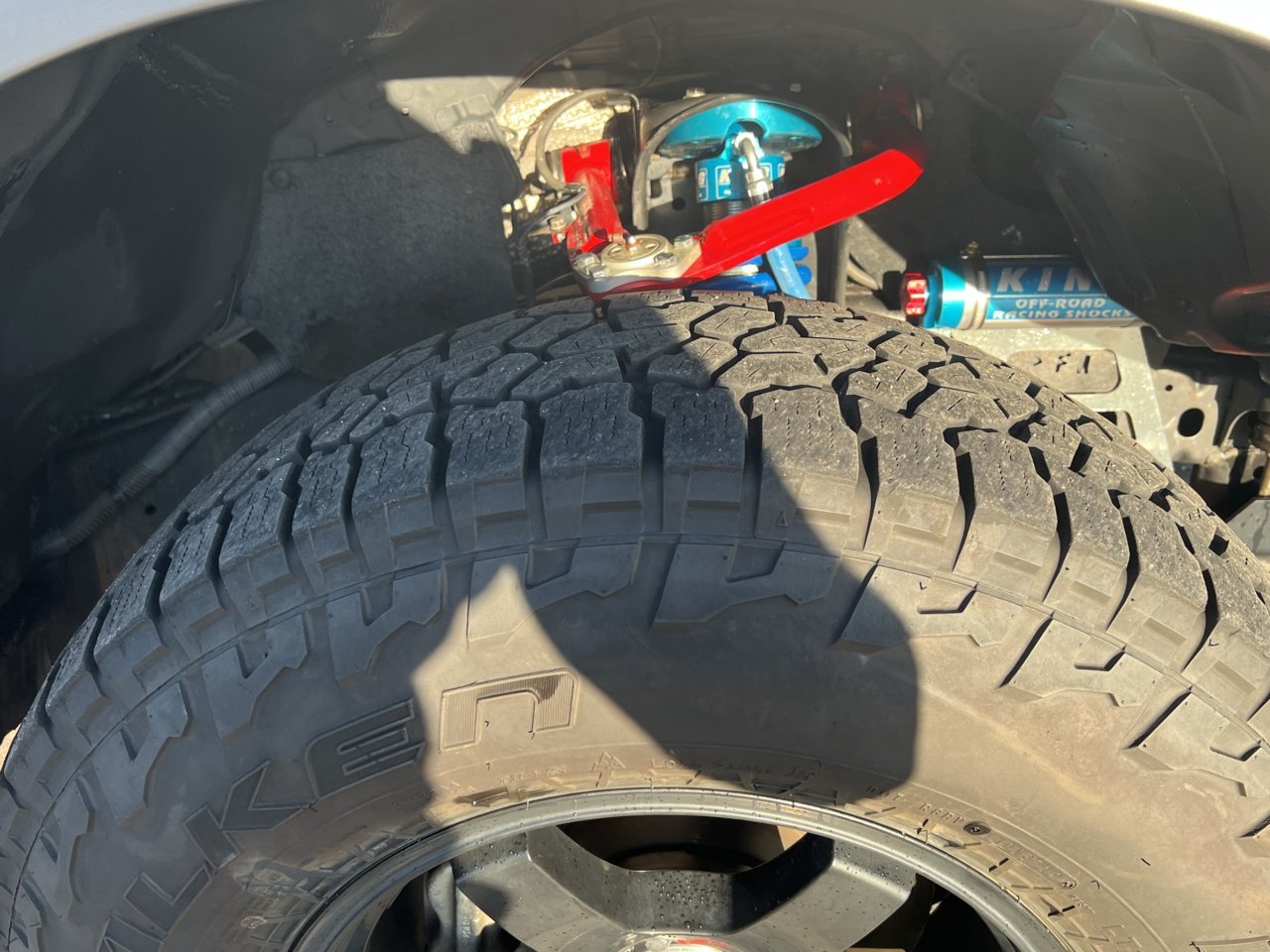

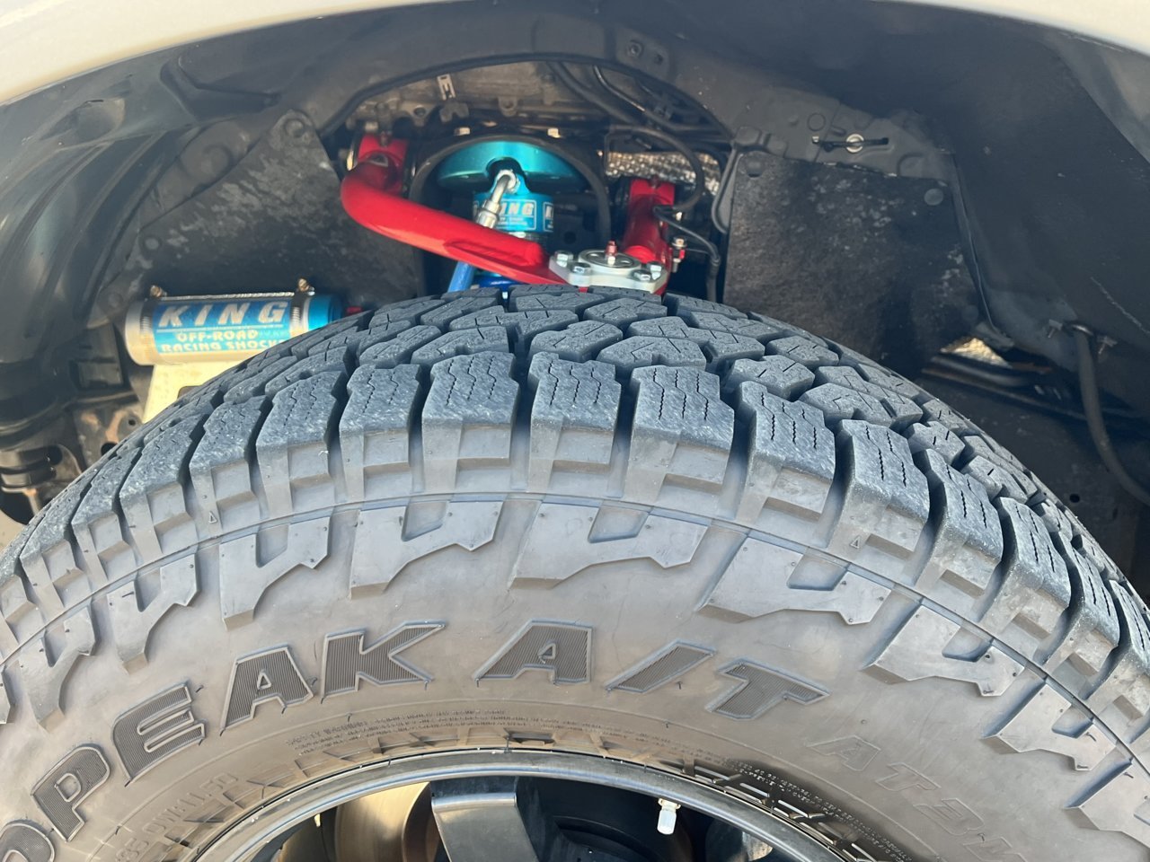

    -Kings 2.5’s shocks -JBA UCA -Wheelers front bumpstops -Torque air bags with Daystar air bag cradles -Alcans leaf’s +700 lbs 1” lift -Dobinson grease-able shackles -TRD front and rear sway bars -RCI Engine, Transmission/Transfer Case skid plate -RCI Catalytic Guard -RCI sliders -Magnum ICI RT series bumpers -Auxbeam 72W Amber 4" round spot off road lights -Morimoto XB LED headlights -Level 8 MK6 +12 offset 18" rims wrapped with 285/75/18R Falken AT3’s with TRD centercaps -TRD dual exhaust with black chrome tips -AFE Power Magnum FLOW Pro DRY S Air Filter -TRD air accelerator -WeatherTech floor mats -Aftermarket Sequoia Grill -MAX Modular bed rack with tonneau brackets -Diamondback HD tonneau -James Baroud Grand Raid XXL -OVS 270 awning -11” Alpine iLX-F511 media receiver

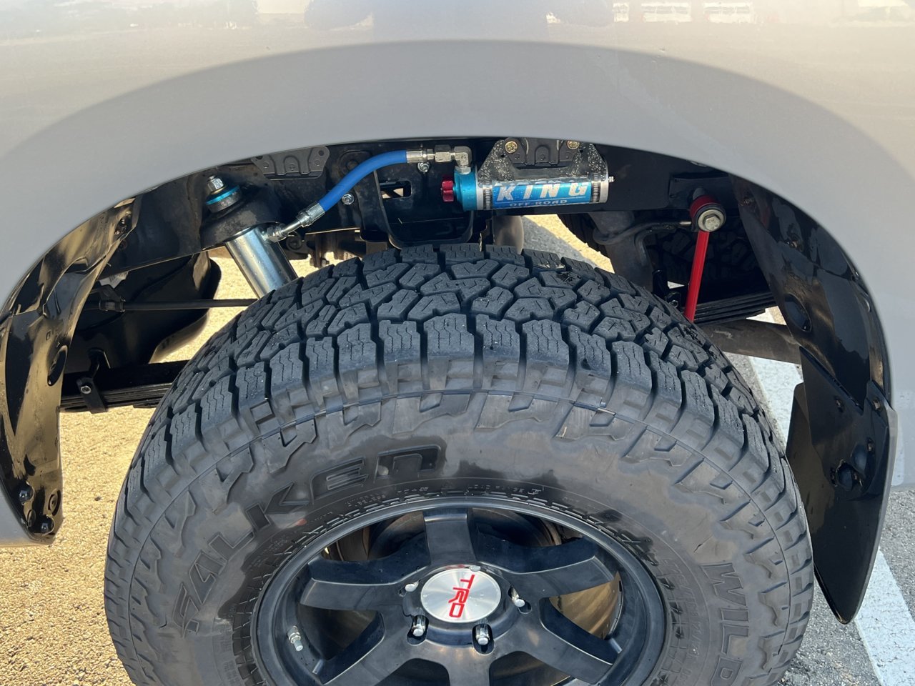

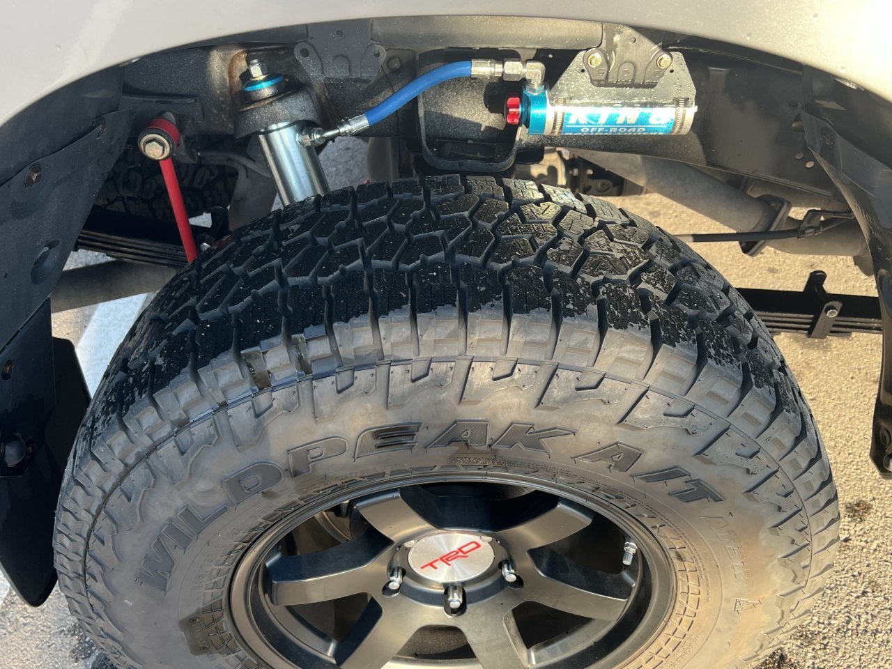

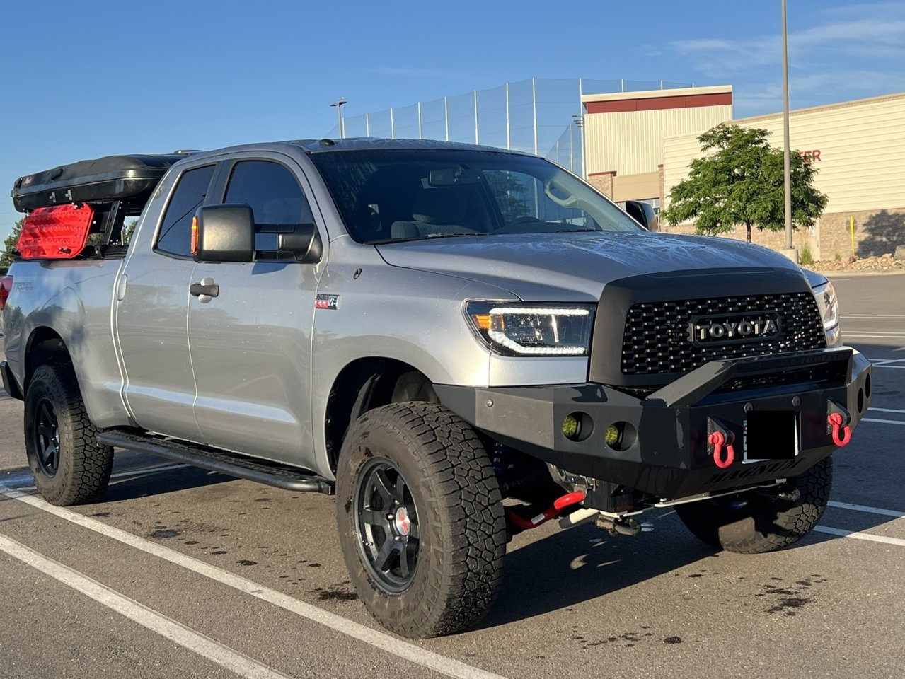

    A few things I’ve done the past couple months. Finally got her aligned.
    -Alcans leaf’s
    -dobinson shackles
    -Airbags
    -Kings 2.5 with adjusters all around
    -RCI sliders
    D4x4TRD, hhenry_, Ricos and 16 others like this.

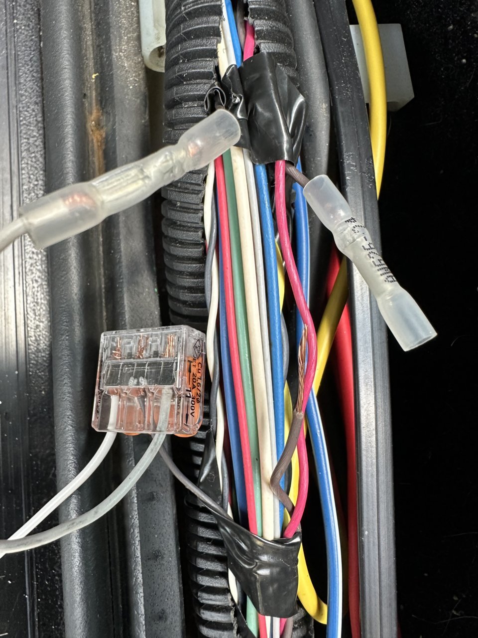

    I wired my aftermarket foot well lights to turn on with either ACC power or the cargo light. Now, the foot well lights are on when I unlock the truck or open the doors, and they stay on when the truck is running.
    I'm new to electronics so this is fun and cool to me. I attached diodes to both the ACC and cargo positive circuits and connected them to a single positive wire that goes to a switch and then to the aftermarket lights.
    Just noticed I forgot to heat the shrink insulation on the butt connectors.
    Yes my wiring is chaos and it's starting to catch up to me. I just keep adding one hack after another and at some point I'll need to pull all the wires out and install something organized and structured... But that day is not today so I just zip-tied all the chaos out of the way.

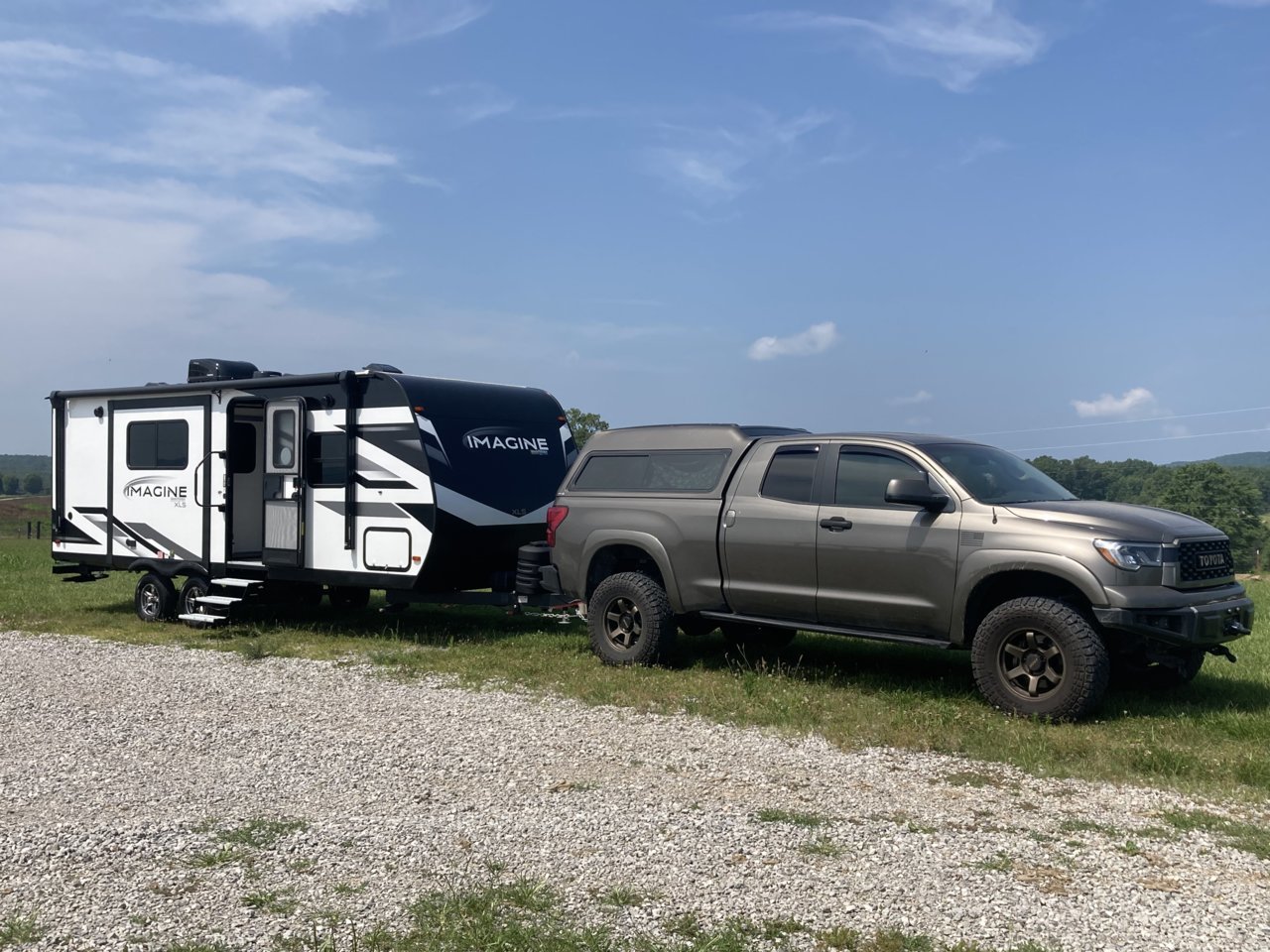

    In-law purchased a travel trailer for the property so he can stay with us for longer periods, it’s a Grand Design Imagine XLS 22RBE. Hooked it up with the Anderson WDH and was a great test run for the new alcan leaf springs. Tundra handled it beautifully on the 45 min drive from the dealer.

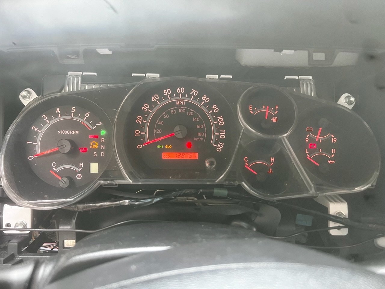

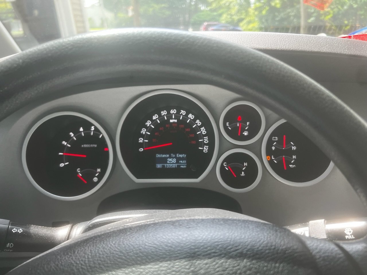

    Grille??
    Worth it or not., i love the new look

    Gorgeous truck I must say!!!
    Are the window vent shades from Weather Tech?

    Thank you! Yes they are WeatherTech window deflectors I highly recommend them. I am a big fan of weathertech products and have put them on every vehicle I have owned, luckily for me the previous owner and I have similar taste so I didn't have to purchase them this time around.

    The only thing that I don't like about mine is that it can't be dimmed down enough to my preference.

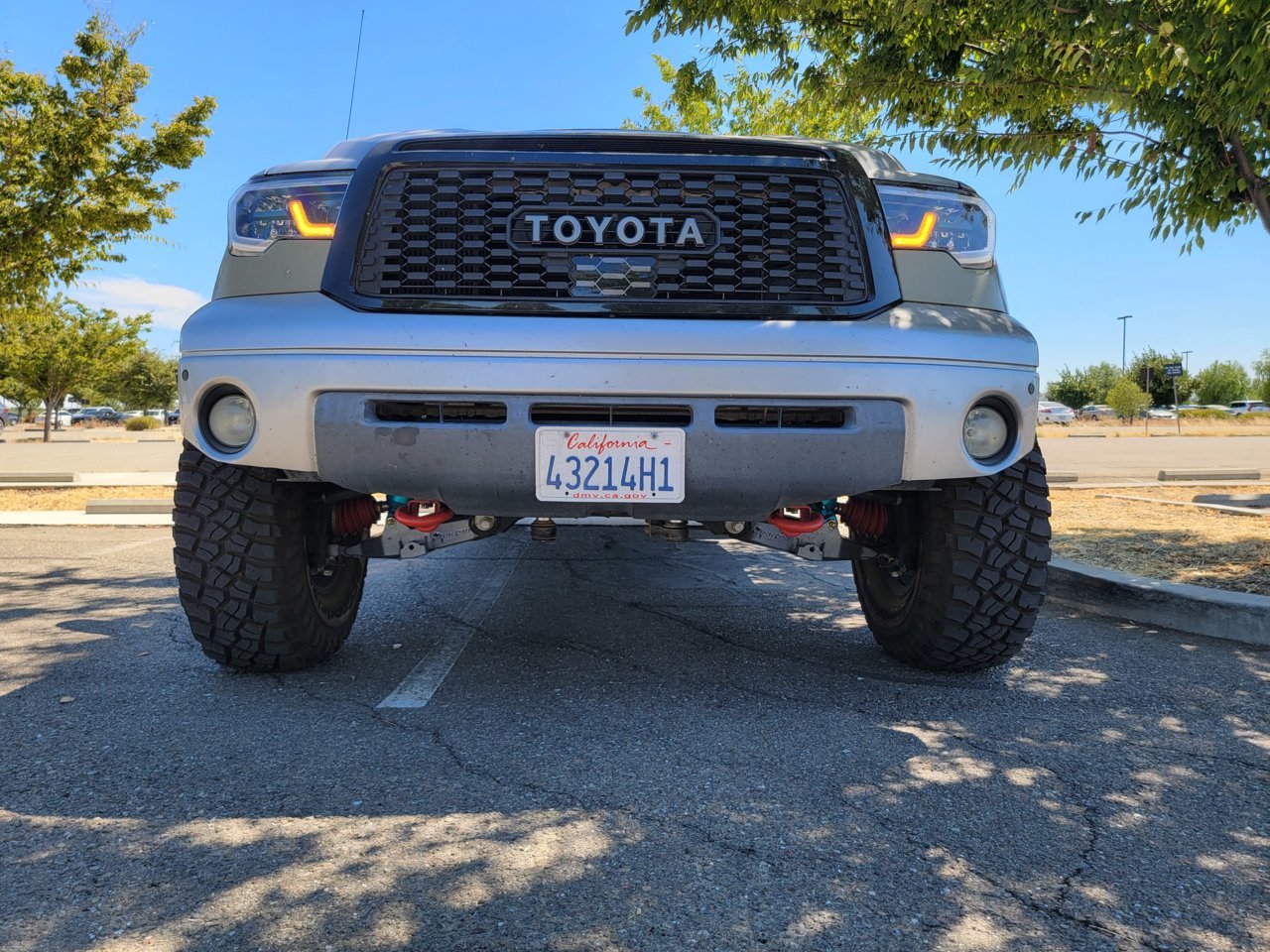

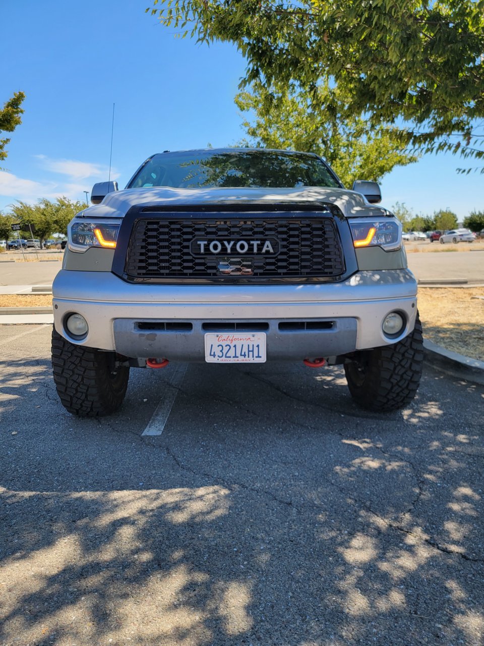

    Trimmed my front bumper and did an oil change. Ready for the next 5k miles.
    D4x4TRD, Pnoy_toy, Zebruaj and 15 others like this.

    Looks a little funny now.

    I like the way it turned out. Should hold me over until I get a bumper made
    D4x4TRD, Skew12, chugs and 9 others like this.

    Yep! Looks great!
