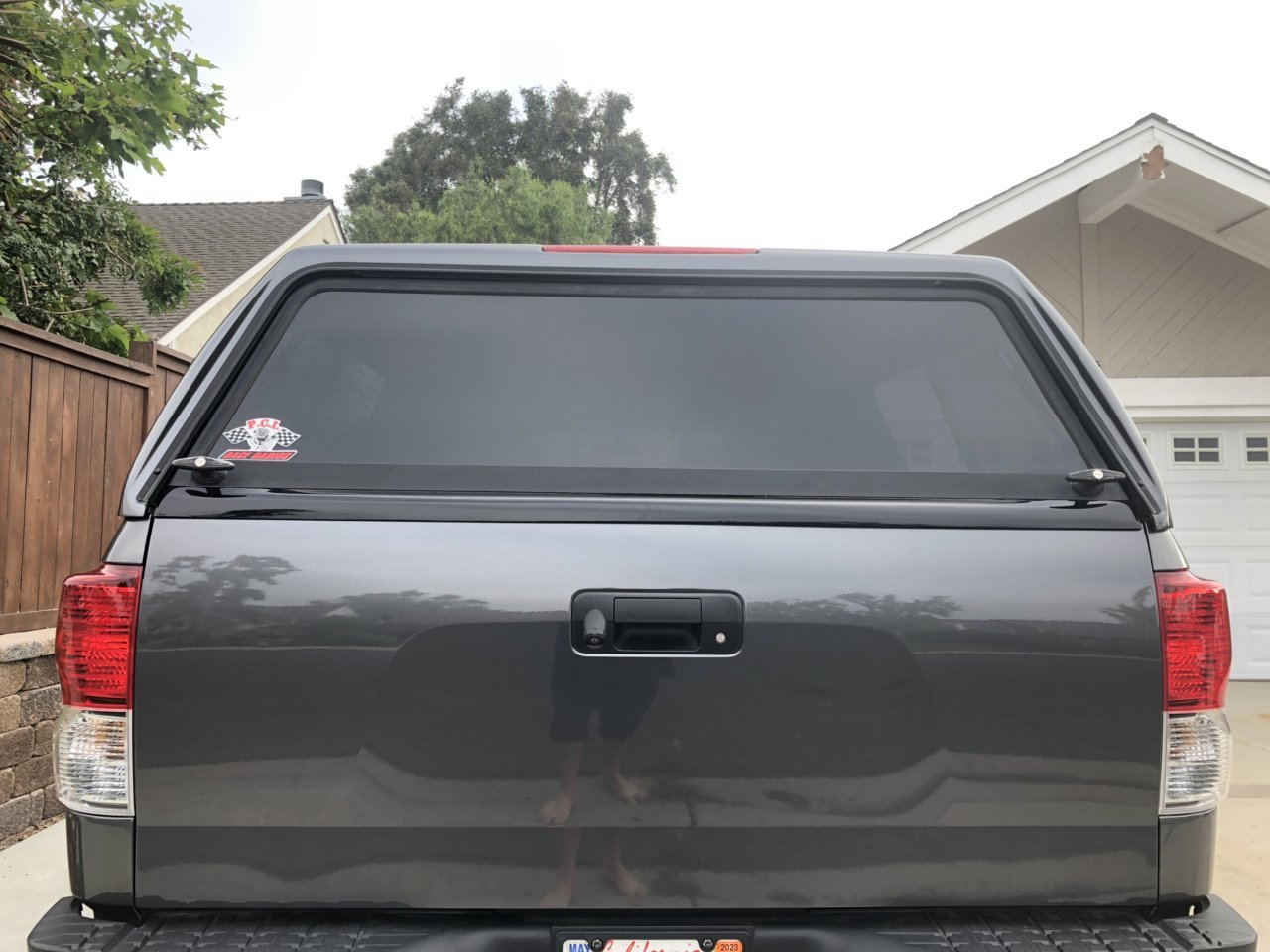

    drobb
    drobb The Feral Snail
    Apr 9, 2016
    #3093
    862
    SoCal
    2013 Tundra CrewMax 4x4
    IMG_4630.jpg Got a new tailgate since my desert trailer decided to put a huge dent/ scratch into the old tailgate :(
    I had the body shop leave off all the badges. Nice and clean looking.
