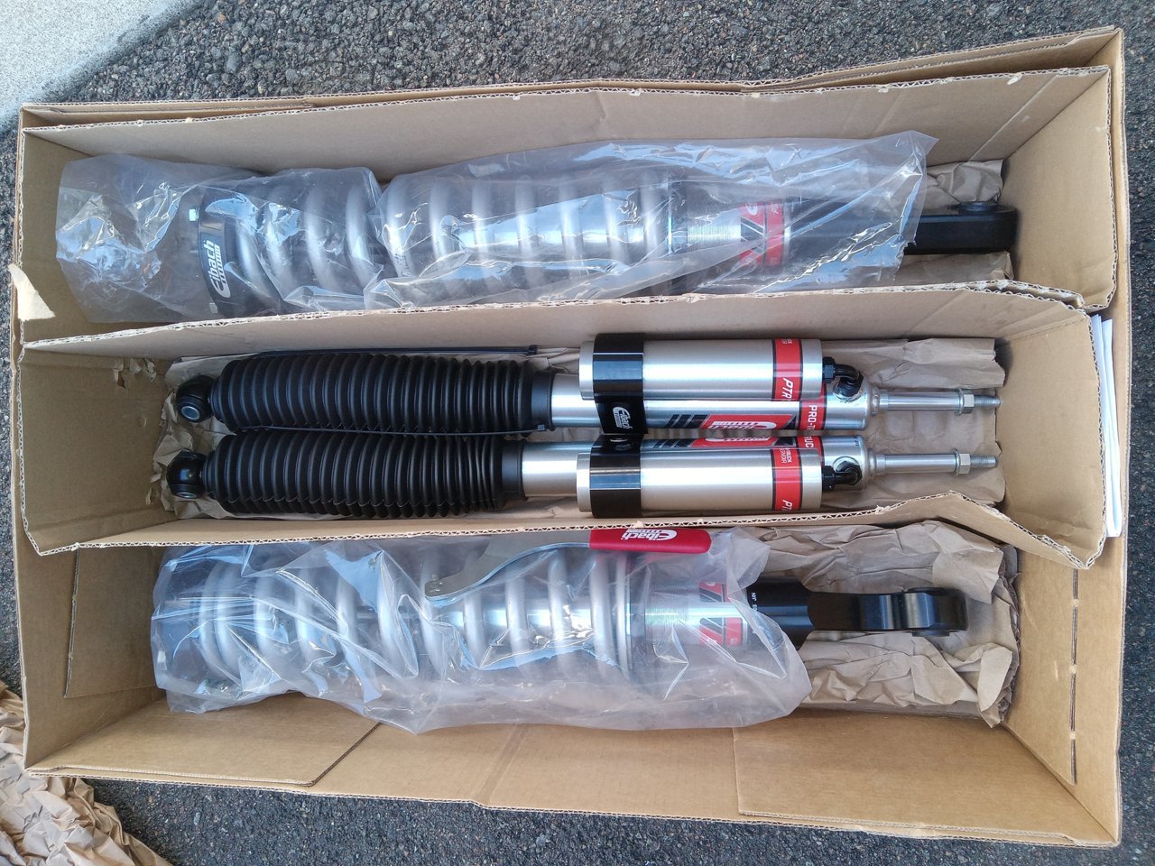

    Not installed yet, but these just arrived.

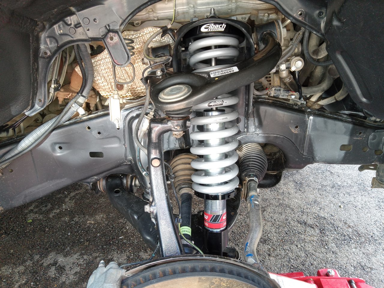

    Edit: pulled the skid plate and front sway bar off. Put PB blast on all the front nuts/bolts that will get removed.
    Pulled the rear shocks off and they were thoroughly dead.
    Tomorrow, I'll put stands under all 4 corners and take wheels off. I will pull the coilovers off and then wash the frame and everything else I can reach underneath with soap, a rag and brush. Then, I will put stuff back together with the new suspension parts.

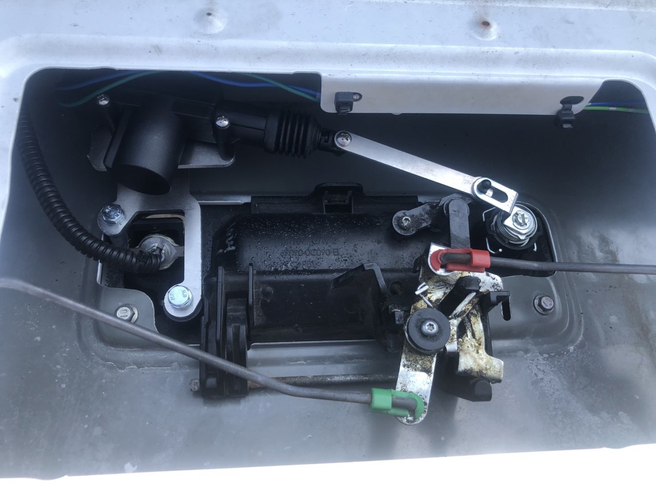

    Installed a KTJO 4X4 power lock for the tailgate. Cheaper and easier than the pop n lock system. I’d highly recommend and wish I’d have done it years ago!

    Plug and play? Did I see that right?

    Yessir! Zero wire splicing what so ever! Check them out! With military discount it was only $85!

    Just need to put the sway bar back on. Leaving the skid plate off until aligned.
    Not perfectly clean, but a vast improvement. I am drenched and there is a lot of mud in the driveway...

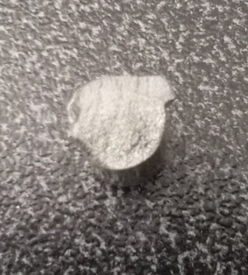

    Adjusting my eibach stage 2 coilovers. Got the passenger side dropped 1/2 inch. Started to do the driver side to drop 1/4" and the damn spanner wrench broke.
    Welded pin was brittle, crystal structure at the point of failure. Ended up cutting the welded pin out of the handle and having a buddy TIG a grade 8 bolt in (cut the thread off so it was just the smooth body of the bolt). It is a 1/4" hole, so I had plenty of bolts in the bin.
