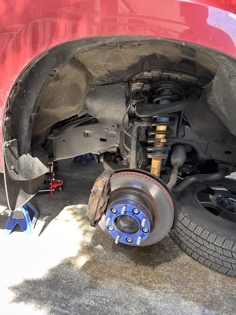

    Chrome delete, Sequioa grill, bed lights, LED + head, fog & tail lights, Dynamat throughout, front & rear cameras, Pheonix PX6 13" head unit, 8" subwoofer, JBL speaker upgrades, tonneau cover, custom shifter, steering wheel cover

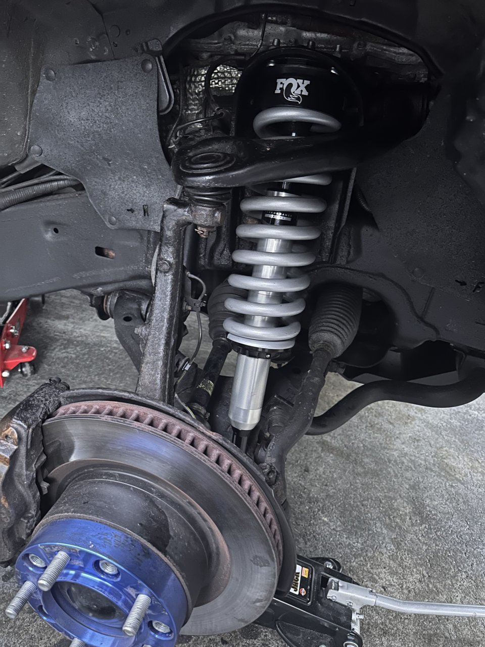

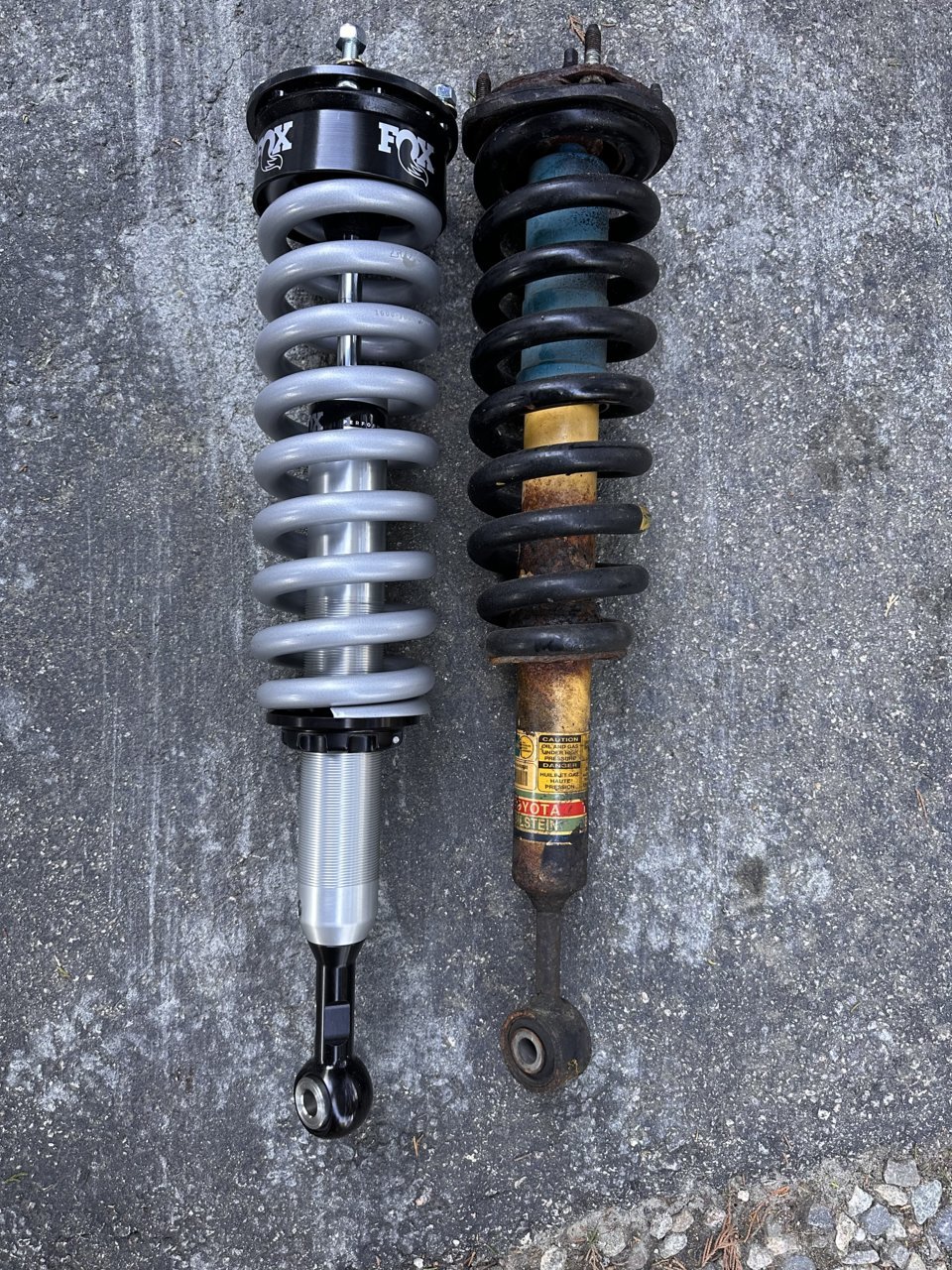

    Replaced my front passenger strut (probably the original!) with a Fox 2.0 to level it and hopefully smooth out the awful CT roads.
    6D8B3AD8-1D3C-400B-B005-32A37A9E0808.jpg 9C3DE5E6-3164-4202-A2E5-CA6E3F1F8378.jpg 90B393BF-80AE-482E-AAB4-0C9ABAB50CFF.jpg
    I'll do the driver's side tomorrow but for now I'm tired!

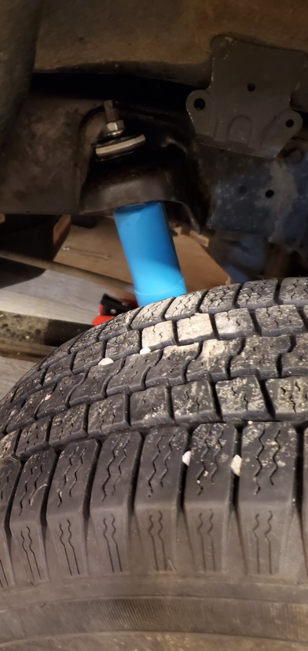

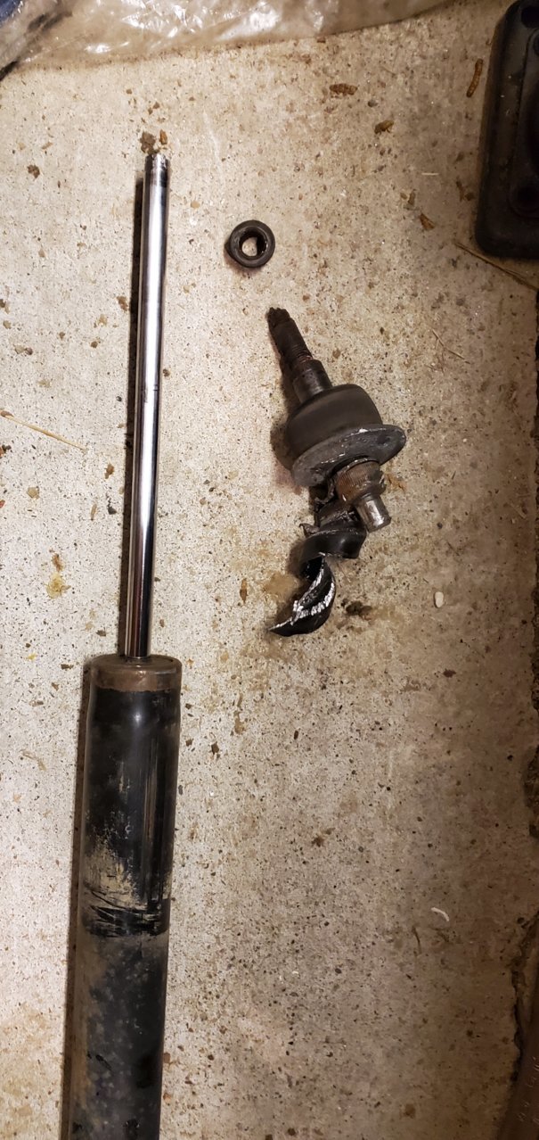

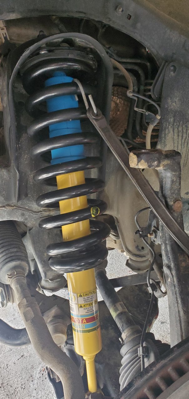

    2.5 Gen Wheels and soon to have the TRD off road suspension.
    All four black shocks of my suspension were leaking (78k miles) and handled terribly over bumps. Got a set of the trd bilsteins with the UCAs from a 2021 with only 6k miles on them for 400$ last fall. Finally got to the install yesterday. I will say the fronts were pretty easy, but those top nuts for the rear were a bear to get off. Both studs shredded while undoing the nut. The passenger side i had to cut to access a better material for the vice grips. Happy its done, and it made the world of a difference. Ill be having the alignment checked next week. Also since its finally spring here in AK, i swapped my winter studs out for the all seasons :)

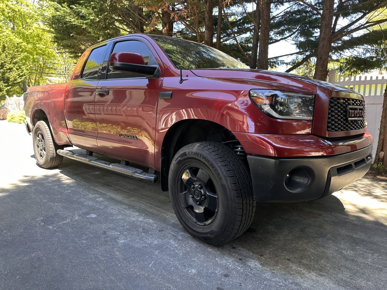

    Finished installing the Fox 2.0 front shocks. I still need to get an alignment but I'm shocked (pun intended) at how smooth they ride compared to my 15 YO shocks. Before every bump in the road is jarring and now I don't feel anything except the biggest pot holes. Truck looks nicer levelled, too.
    I have the most basic black rear shocks and maybe I'll upgrade them some day but for now I'm sick of dealing with rusted nuts. I had to Dremel the most inconvenient of the top nuts because it just disintegrated when I tried to turn it! PITA.
    I have the most basic black rear shocks and maybe I'll upgrade them some day but for now I'm sick of dealing with rusted nuts. I had to Dremel the most inconvenient of the top nuts because it just disintegrated when I tried to turn it! PITA.[/QUOTE]
    I don't even live in the rust belt and it was pretty rough for the rear. My best advice is have a quality racheting 17 mm wrench for the top nut, quality vice grips, and pb blaster. Honestly next time I would remove the dust cover right away and place vice grips at the top of the shock as well as one on the stud for added support. That way you have a better chance of not having stud strip. If that fails have that sawzall ready.

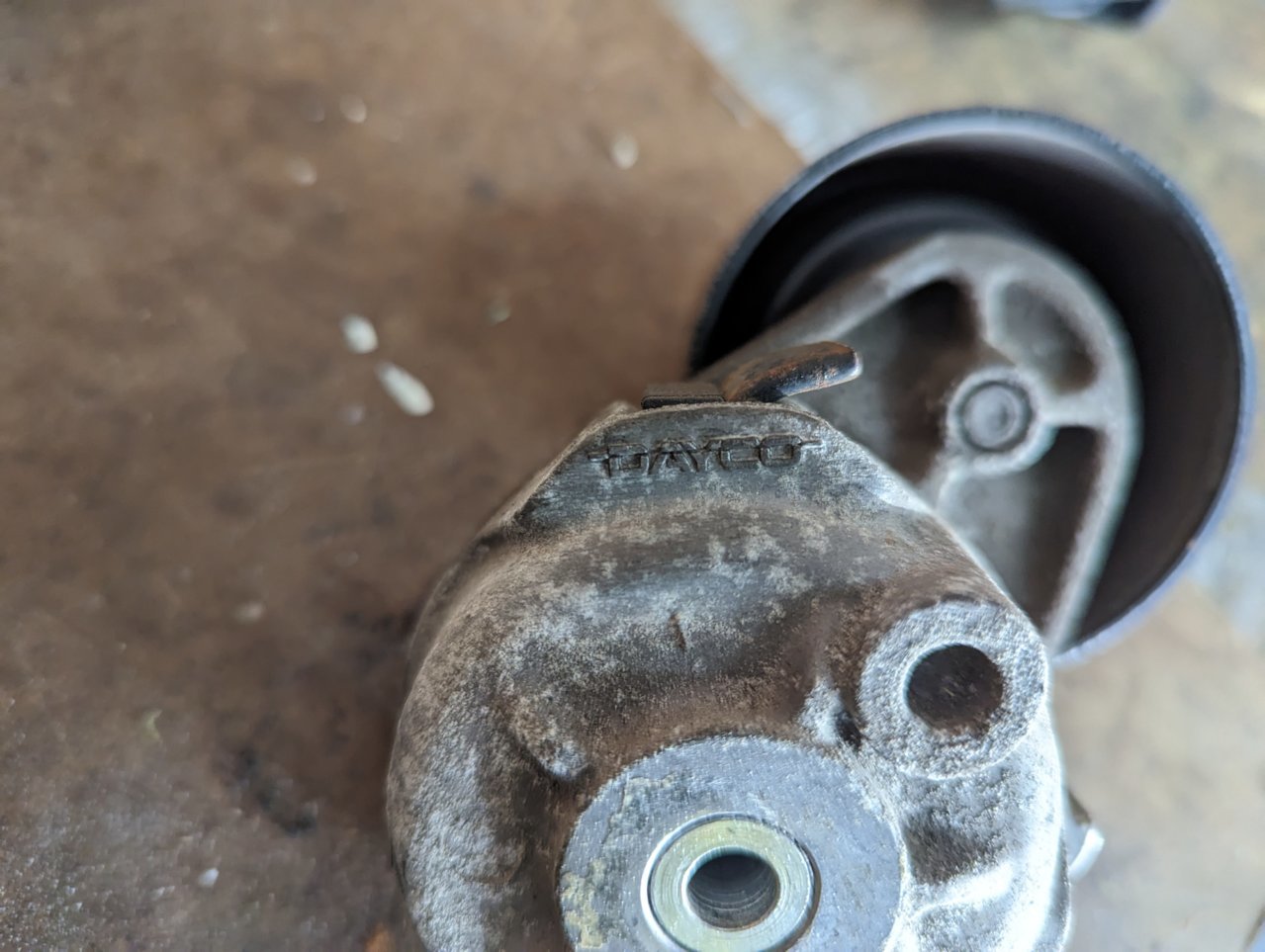

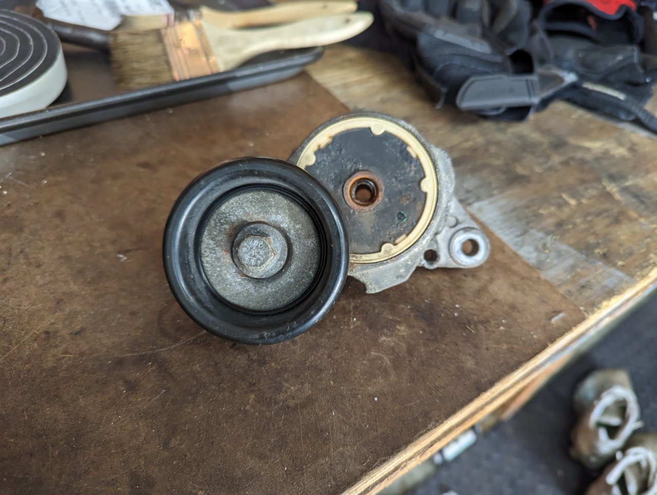

    Tensioner started squealing under throttle. 134k on her. Dayco is the oem. Used my AAP perk dollars and basically got it for half off. 30 mins and a bunch of scratches on the arm.

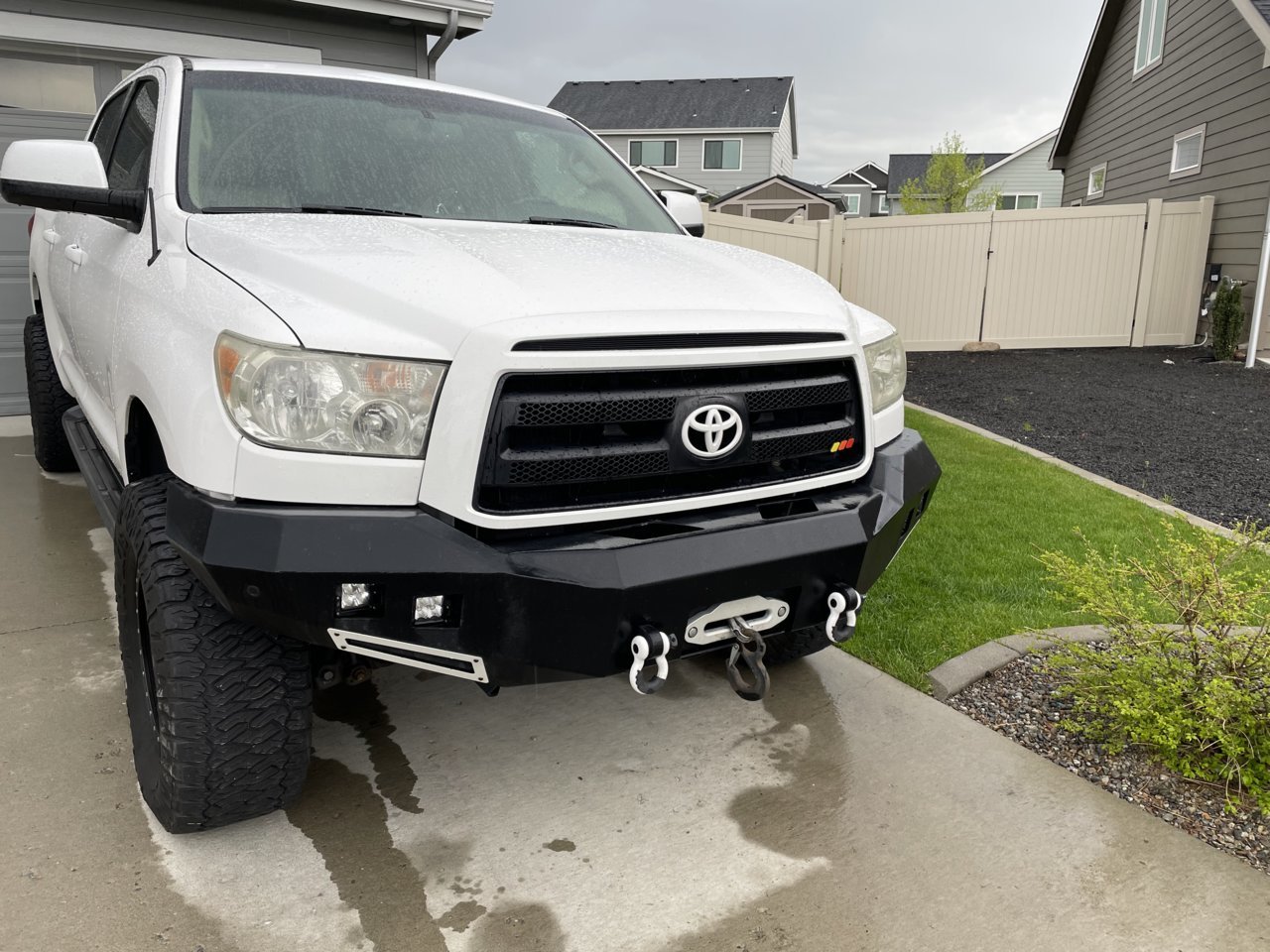

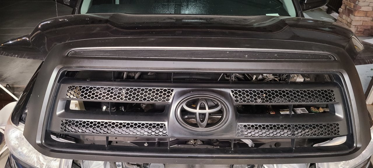

    Added a little grill badge.

    Beautiful truck and grill!

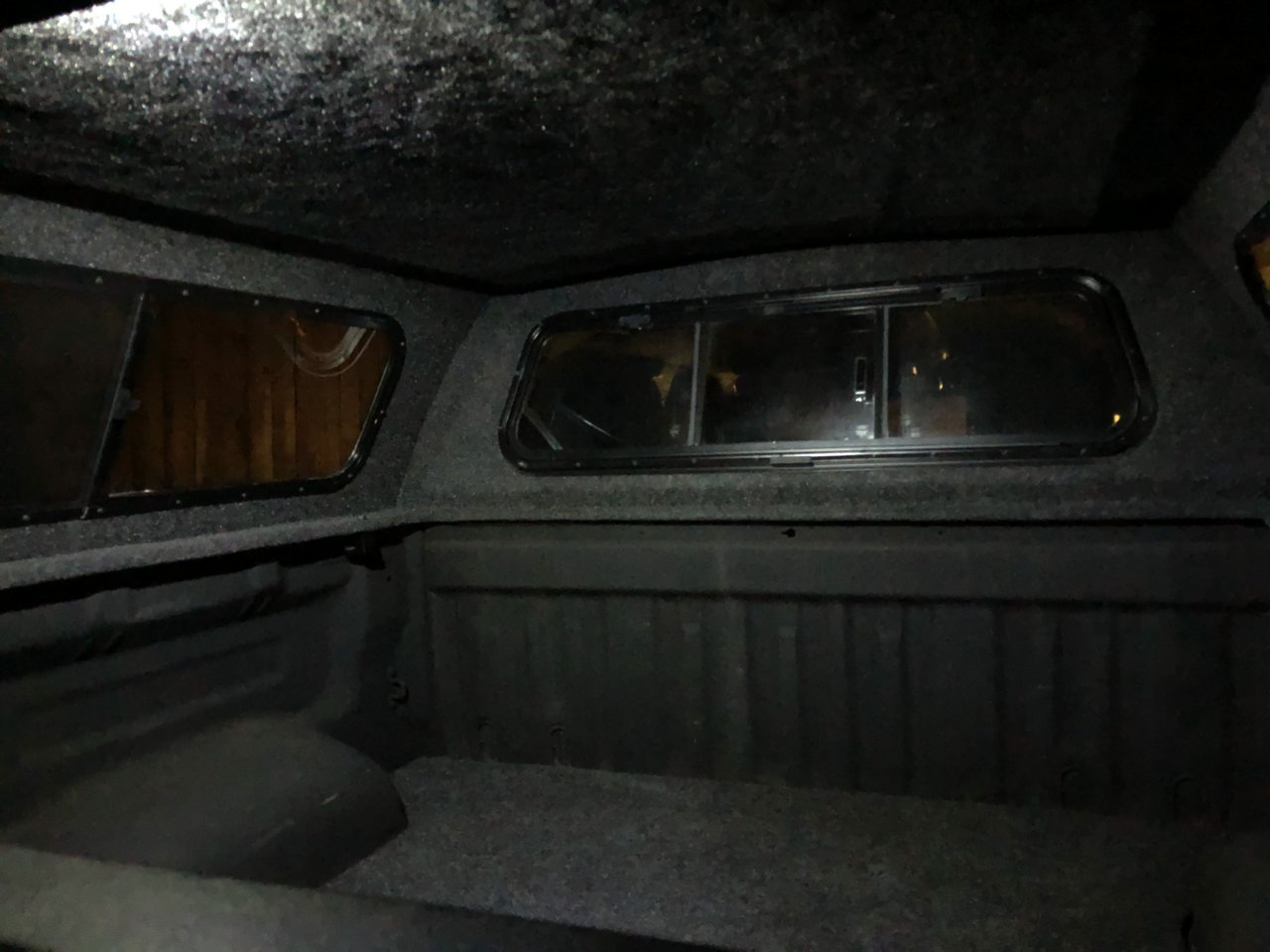

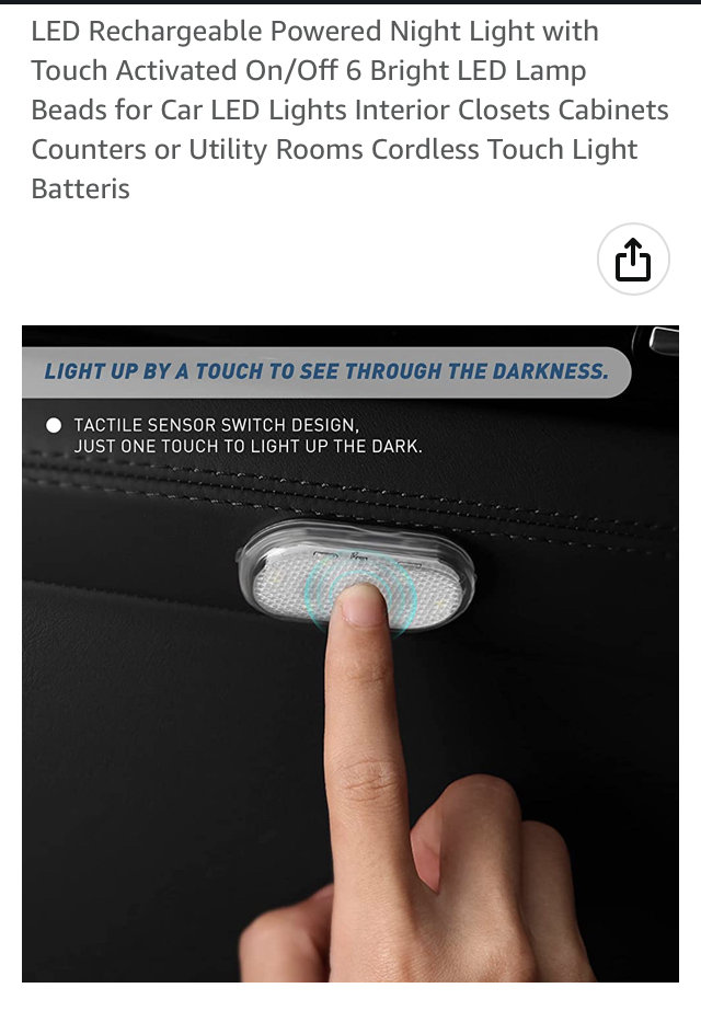

    IMG_4482.jpg IMG_4483.jpg I have a super basic truck shell. The existing battery powered light that was in the shell finally rotted away. I added one of these. Put Velcro on the back of the light and it sticks perfectly to the headliner. Best part is the light is charged via usb.

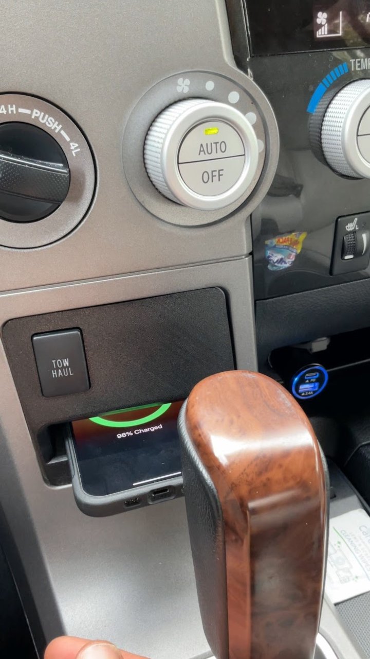

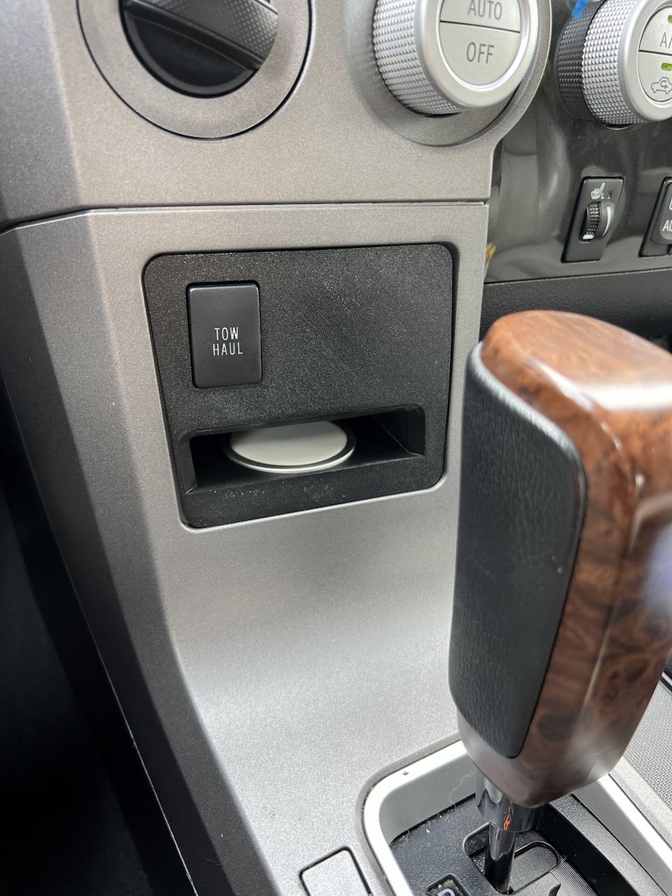

    I designed / 3d printed a Magsafe Cubby for my phone... (with my carplay head unit, no need to see the phone really) and all the vent holders block the ac (needed in houston).
    Wired up a new USB-C PD charger behind it, so it charges just fine too!

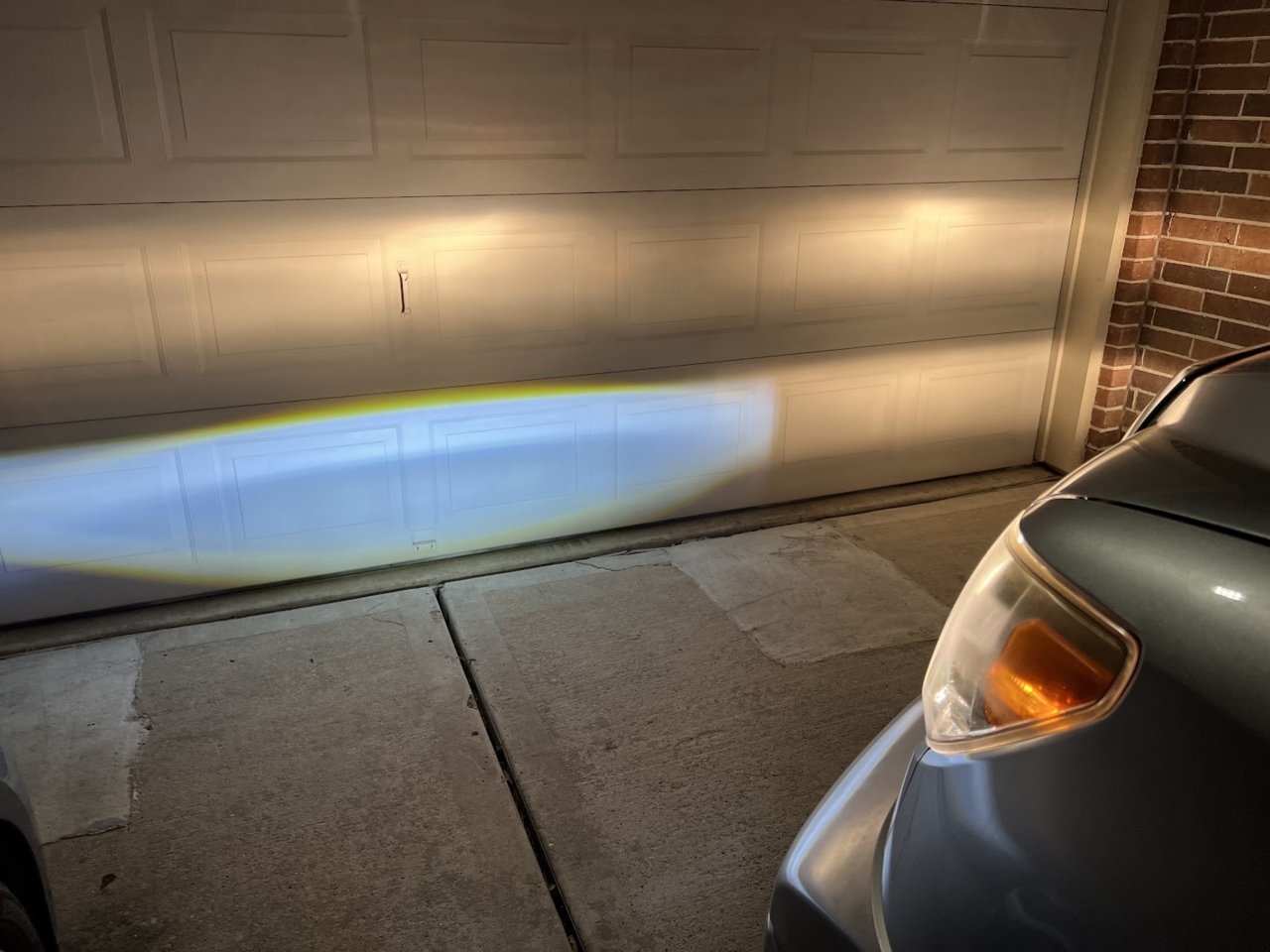

    Also installed one foglight so that I can see the difference at night...
    Then at night it was impressive...

    3d print a switch plate holder for under the ac controls between the 12v port and cigarette lighter. That’s a useless area and would fit oem style switches easily!!!!
