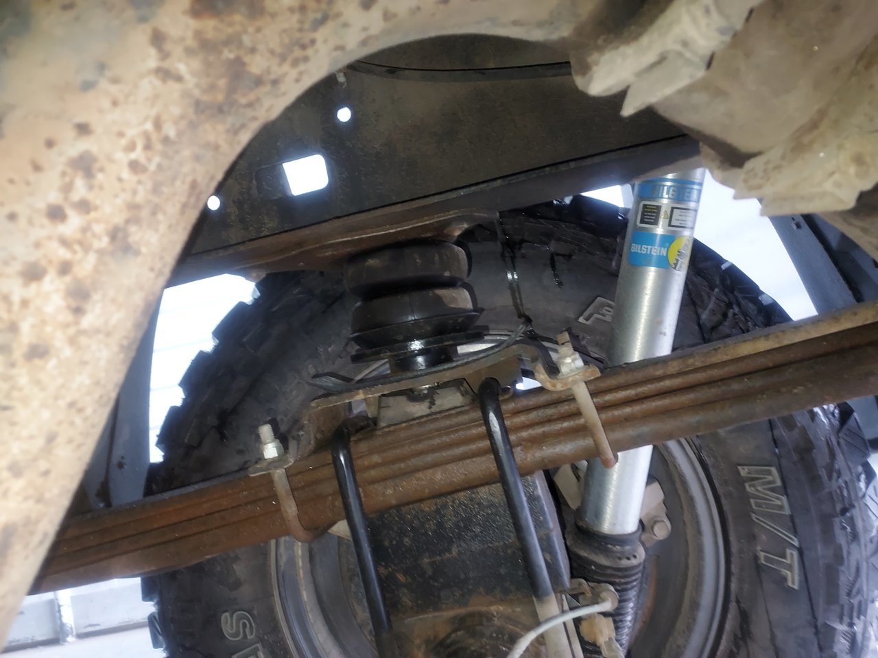

    Finally got the icon rxt springs in so much better.
    No Más block...

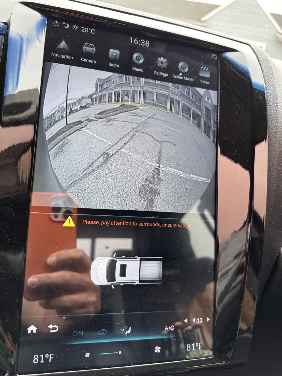

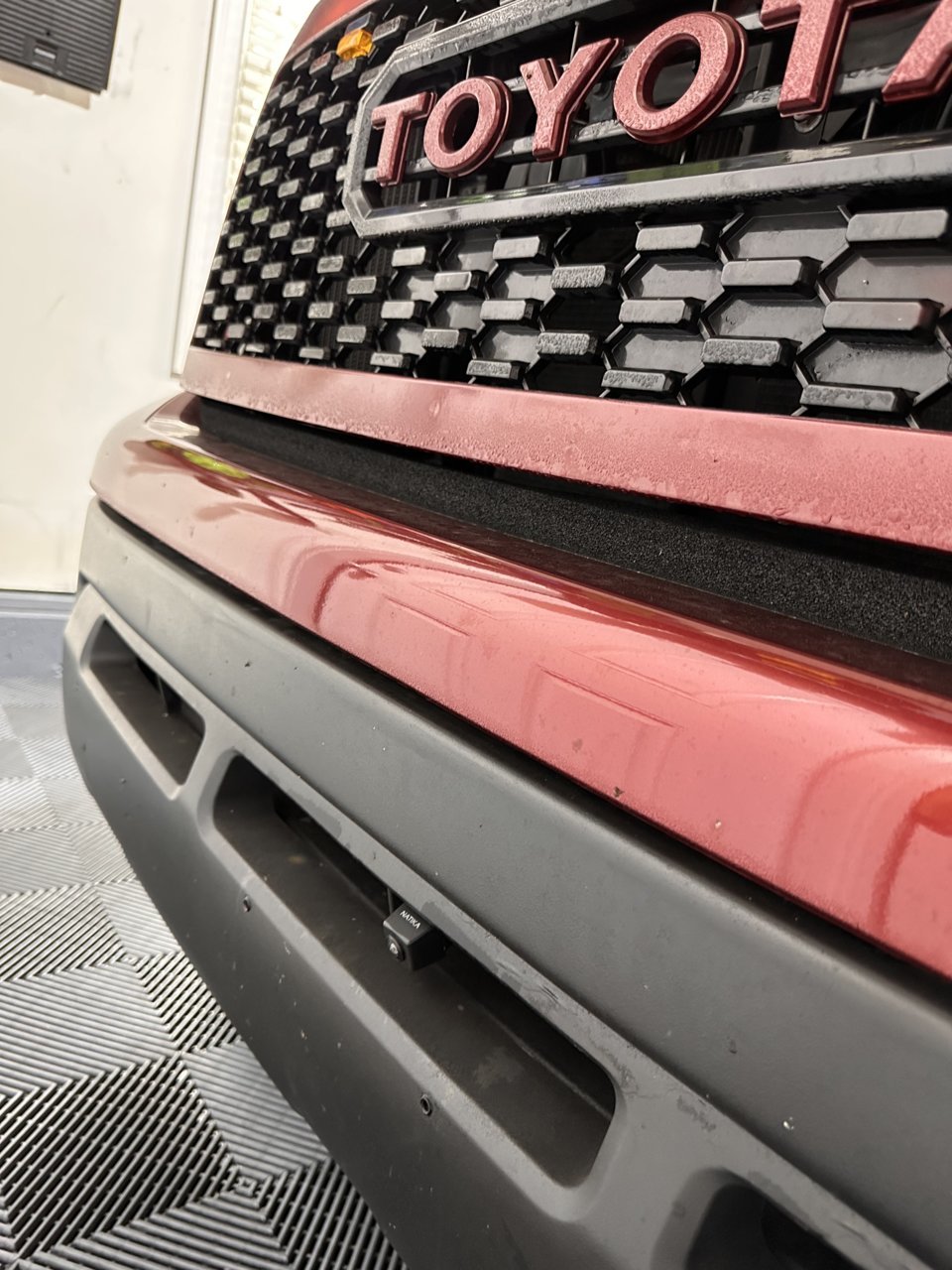

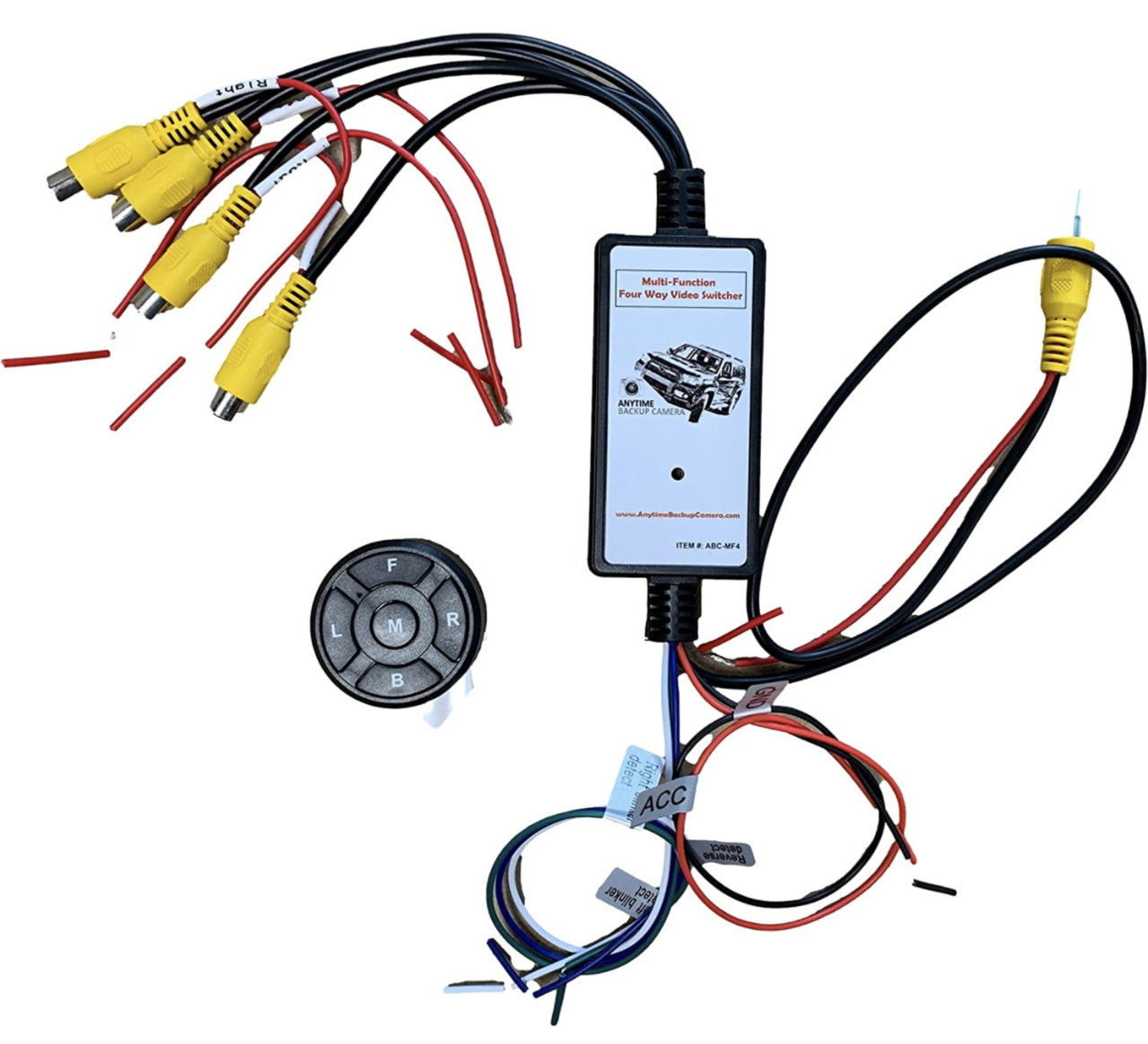

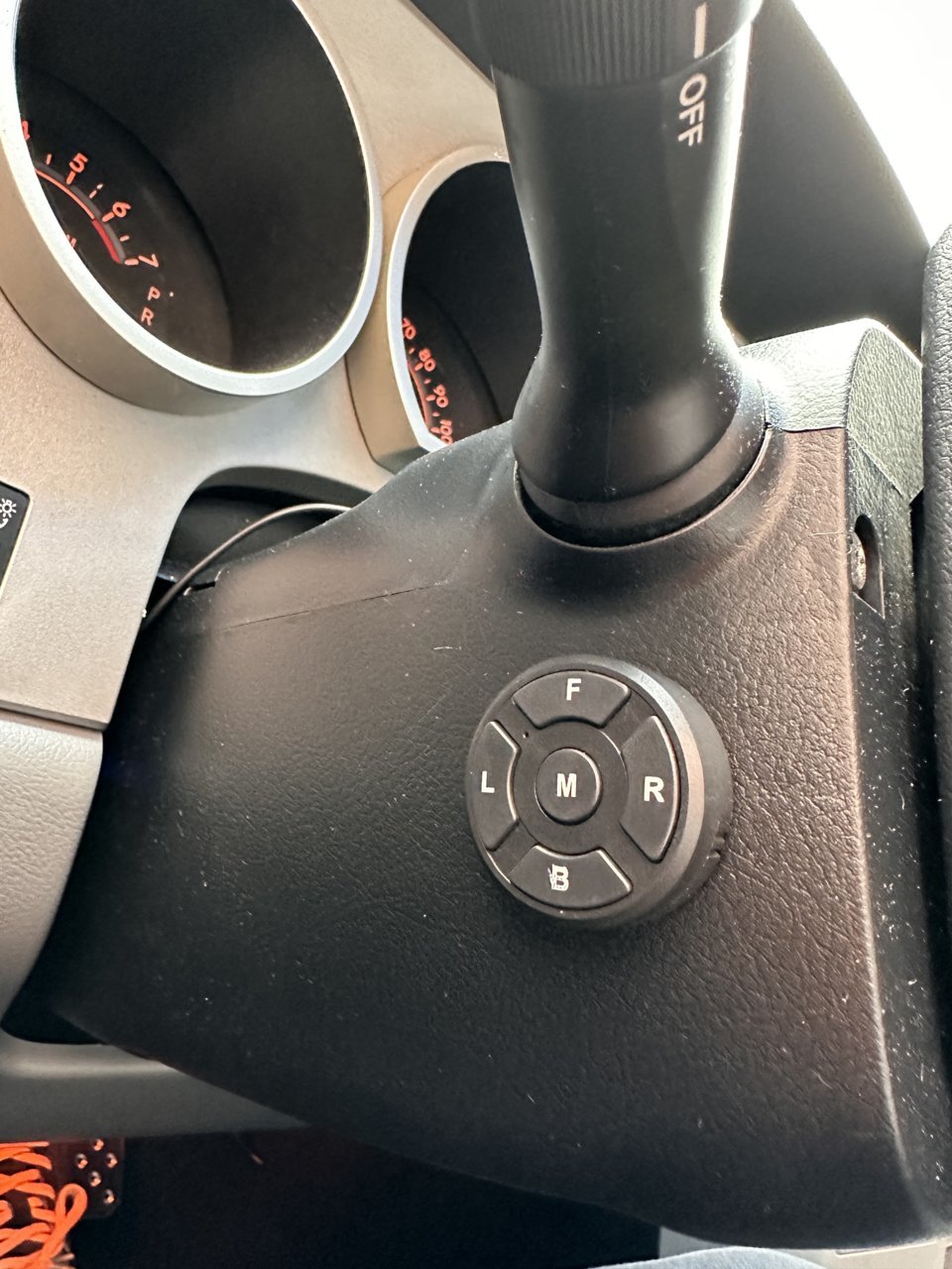

    So I'm not completely happy with my front camera placement. I want to move it higher onto the grille and point it downward so it can see the entire front bumper. But here's a closeup and wider shot and the head unit showing the camera:
    Pressing F shows the front camera until you press the middle button (M for some reason).

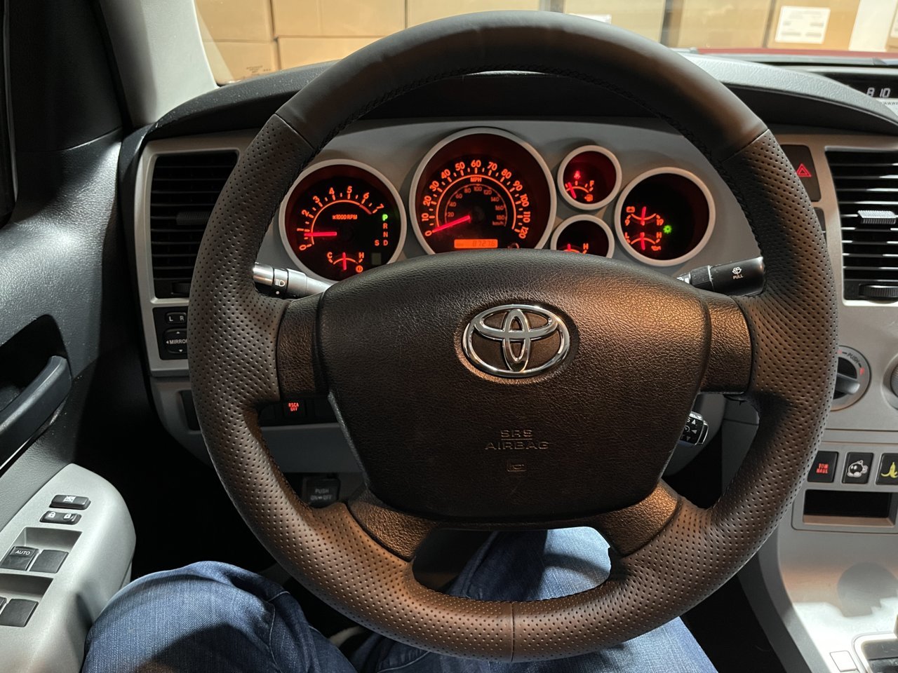

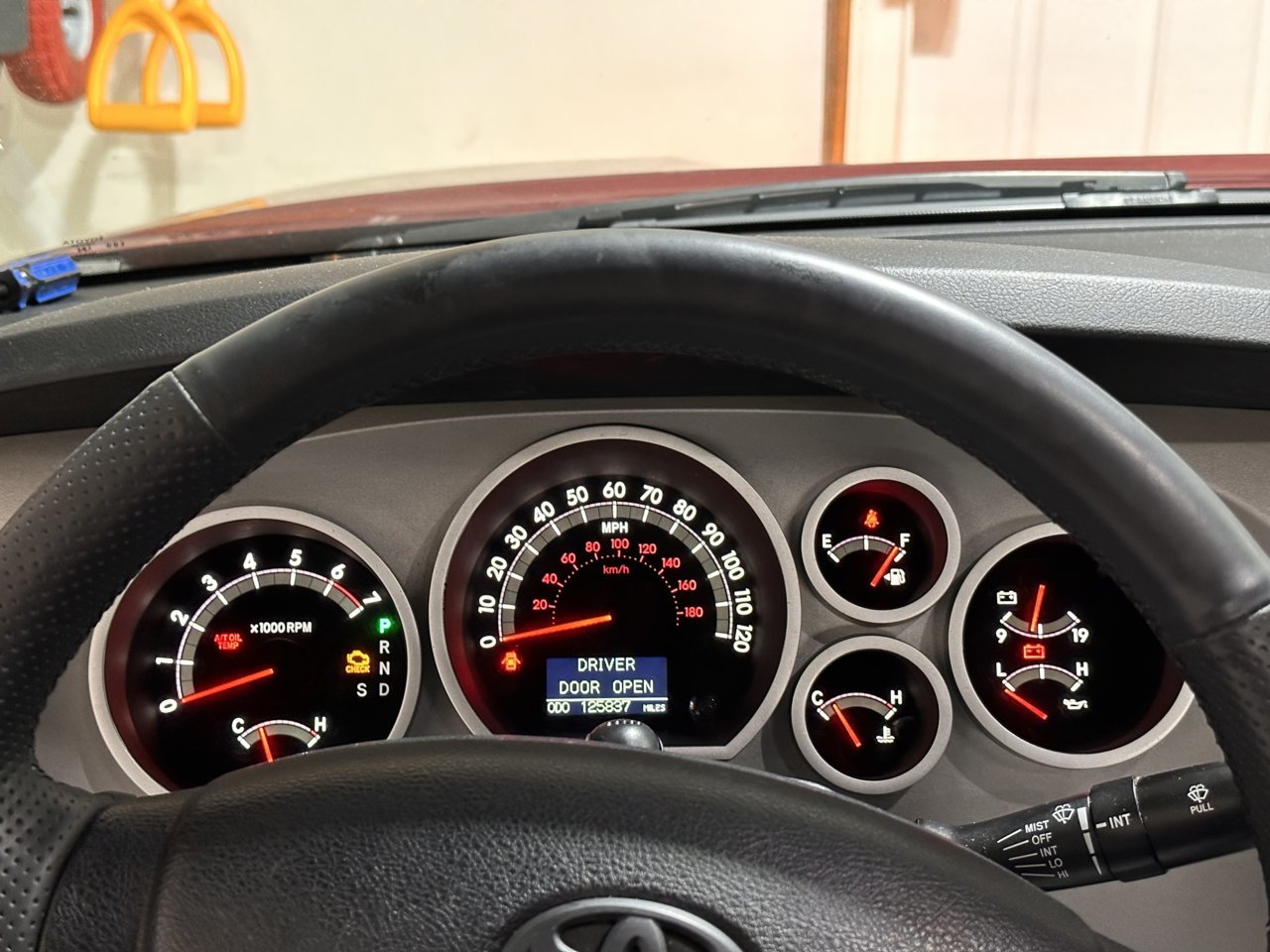

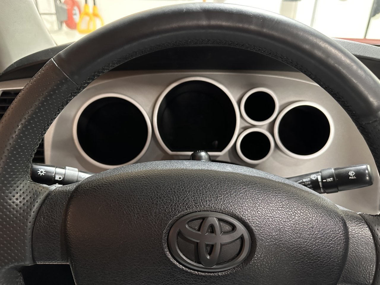

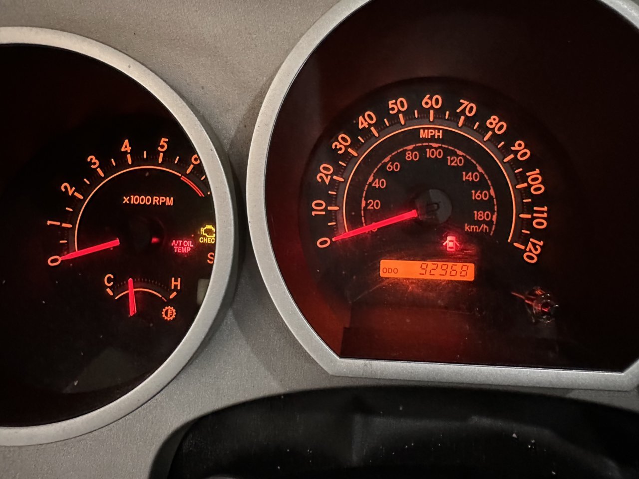

    Before:
    After:
    I bought an instrument cluster from a 2010 Limited on eBay for $61 and I wasn't sure it would work because of the difference in years, so I did a temporary install just to test it before sending it off to have the mileage corrected.
    Everything works perfect... But now I'm too lazy to take it back out so my mileage is going to be 30,000 miles over. Doesn't matter if I never sell it and I plan to keep this truck until I die in 43 years.
    Anyway it's a HUGE visual upgrade-it looks way nicer. It also means the information display next to the clock always shows the temperature, but I can see different information in the digital display, such as MPG or miles to empty. It has the tinted cover so it's just black when off:

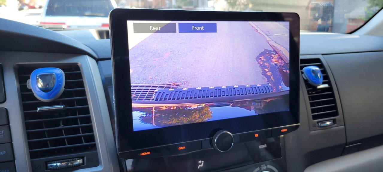

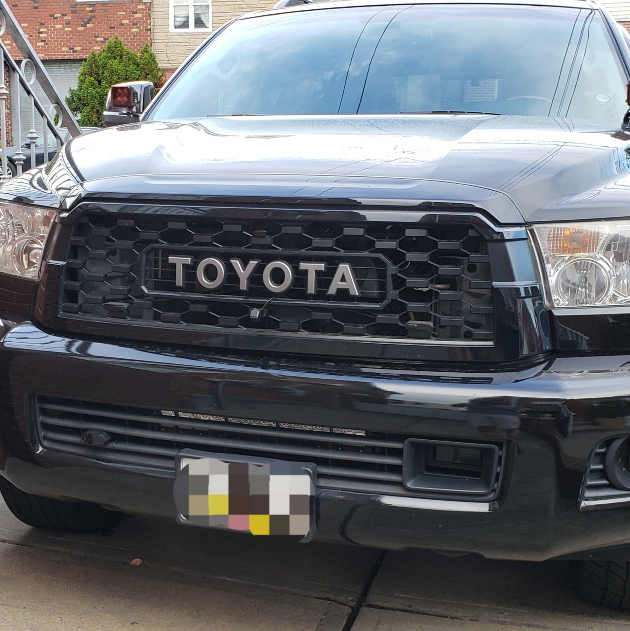

    Here is my front camera placement and view:

    This is one of my favorite mods. The only downside for me is that it won't adjust dim enough for my preference. There are even more settings that this cluster allows you to access that would normally require Techstream, like headlight timer and others that escape me at the moment. I think that the replacement lenses are ~$20 if yours is a little scratched.

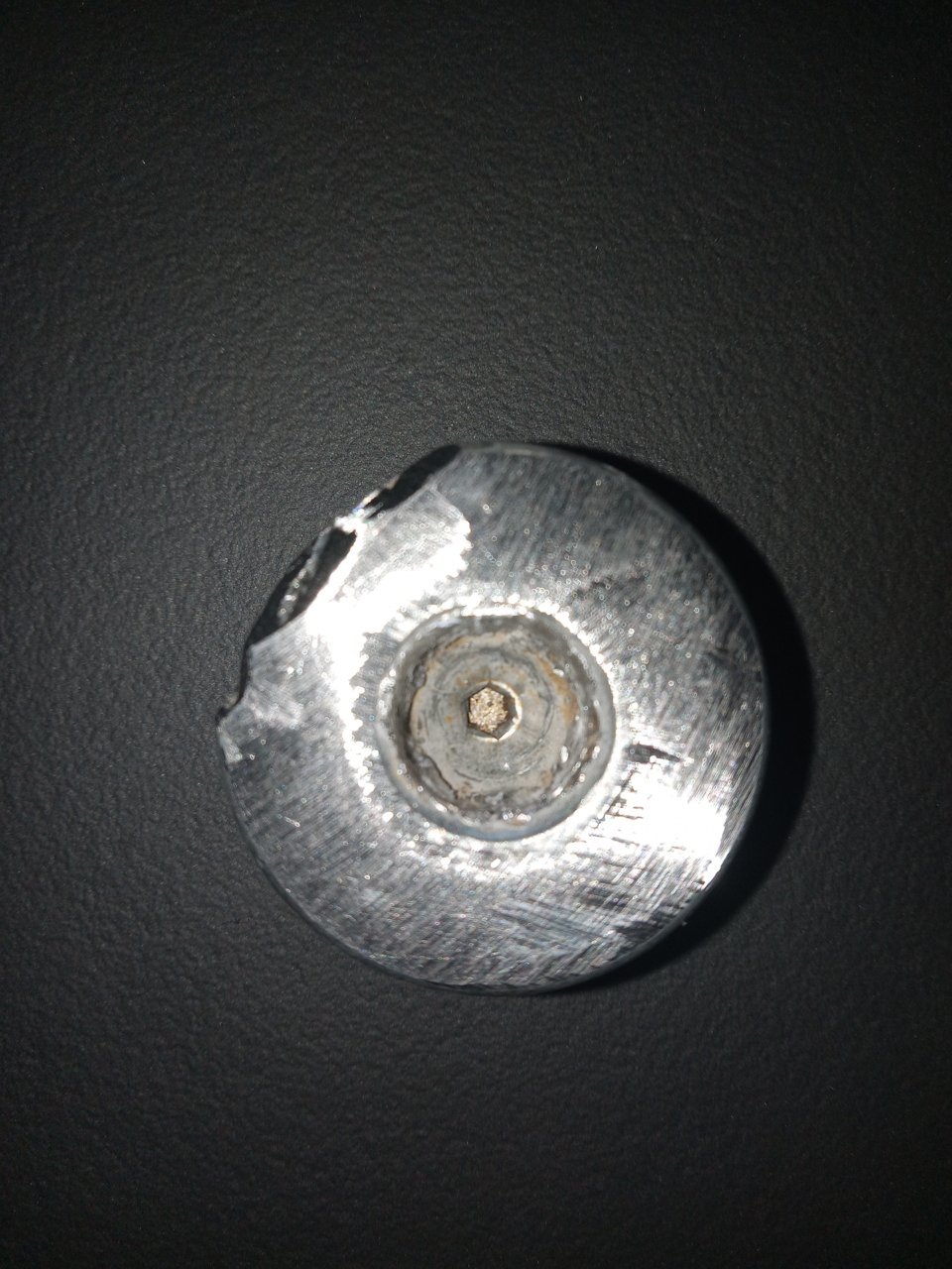

    Got the front diff drain plug out. Ended up tack welding a welded nut/bolt onto it.
    Chunk missing is from trying to use a hammer and chisel, didn't work.......
    Edit: Lexus plugs ordered. Should be available to pick up tomorrow.

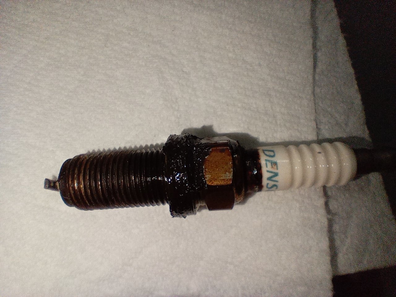

    One thing my father never replaced on the truck before I go it was spark plugs. I just removed #1 plug, by hand. It was so loose I thought I had the wrong socket and it was sitting on top of the plug, until I noticed the socket coming out. Mind you, this was a socket on an extension with NO ratchet, just my fingers.
    160k on original plugs with the first one I pulled not being tight.

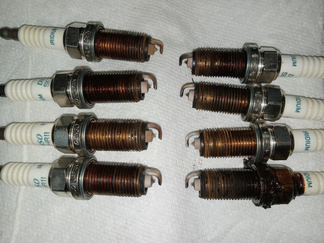

    One of these things is not like the others.....

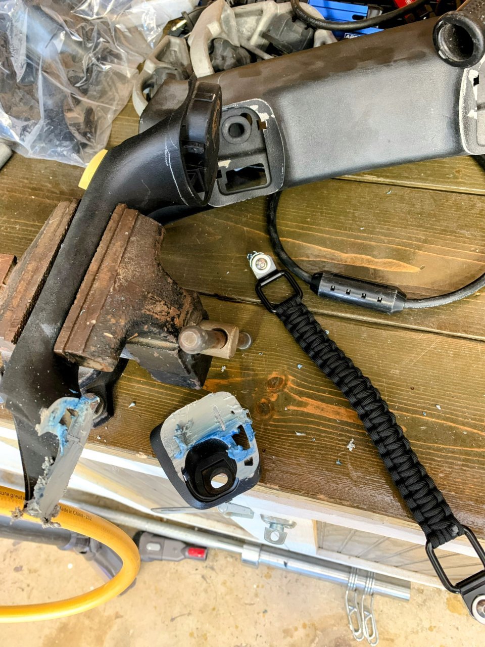

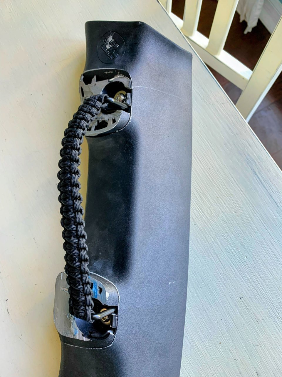

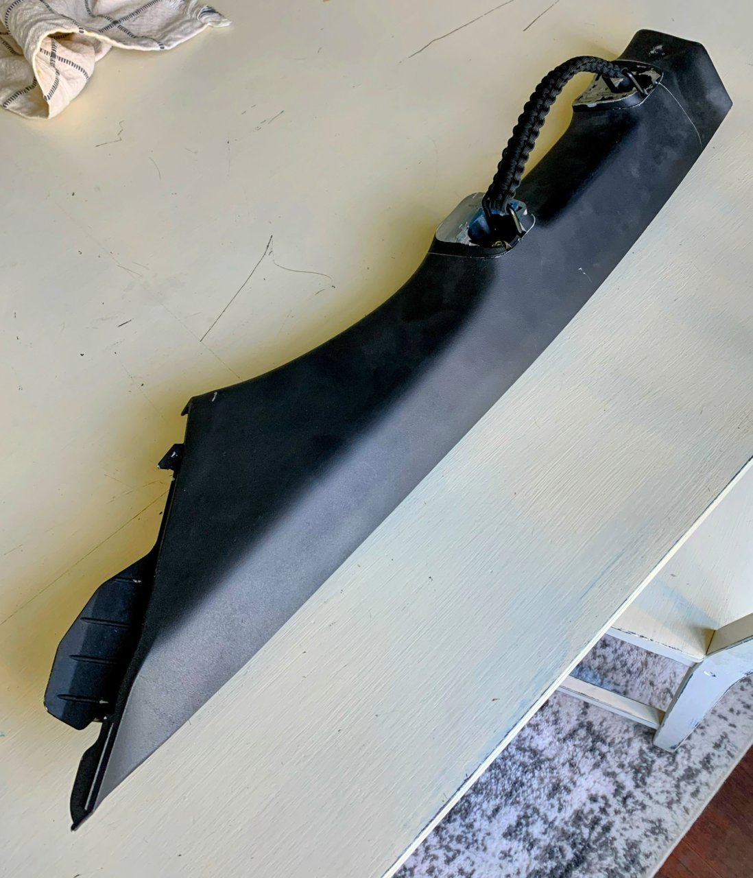

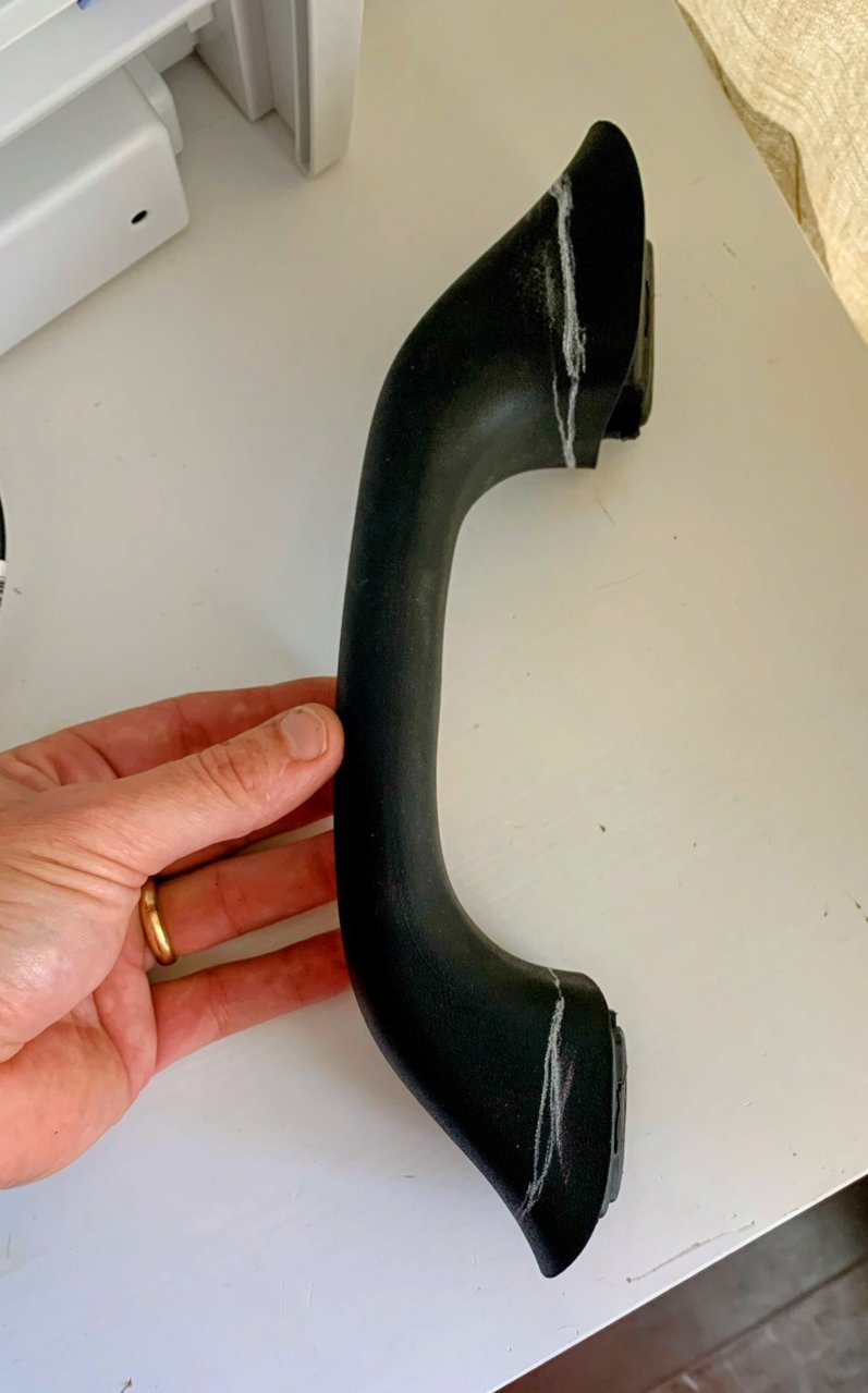

    PSA - a friend got T-boned pretty bad, truck totaled and the only lasting issue he has is bc his head hit the “oh crap” grab handle. His head looks pretty bad from where it hit and there are some cognitive concerns now.
    so today I decided to remove the A pillars and figure out a way to attach some paracord grab handles. Only issue is that the OEM handles sit against the pillars in a very weird and curvy way.
    I hacked off the ends with a saws all and gonna try to fab something up lol. Gotta love impulsive mod ideas.
    EDIT - added progress pics. it’s secure, just ugly at this point.

    Was he in a tundra? Wearing a seatbelt?
    My grab handle is a long way from my head.

    I was hoping someone would inquire, thx Retro.
    it was actually in a new TRX Ram “BUT” their handle is in the exact location as our 2nd gens - See pic below.
    idk about seatbelt, I gotta ask him next time I see him.
    I also sat in my truck and thought there’s about a 1% chance I could come into contact with this handle but it’s the same geometry as the TRX so IDK.
    It’s probably unnecessary but what else am I gonna do with all this free time I have lol

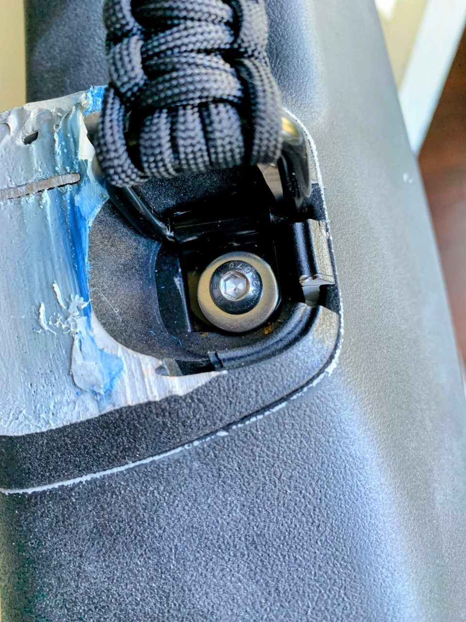

    Today I am rough cutting in the passenger side handle. Gonna chop these surgical like lines and atleast get it to a secure working state.
    I will wrap A pillars in suede to match the headliner.
    I’ll do B pillars next but think they will be easier.

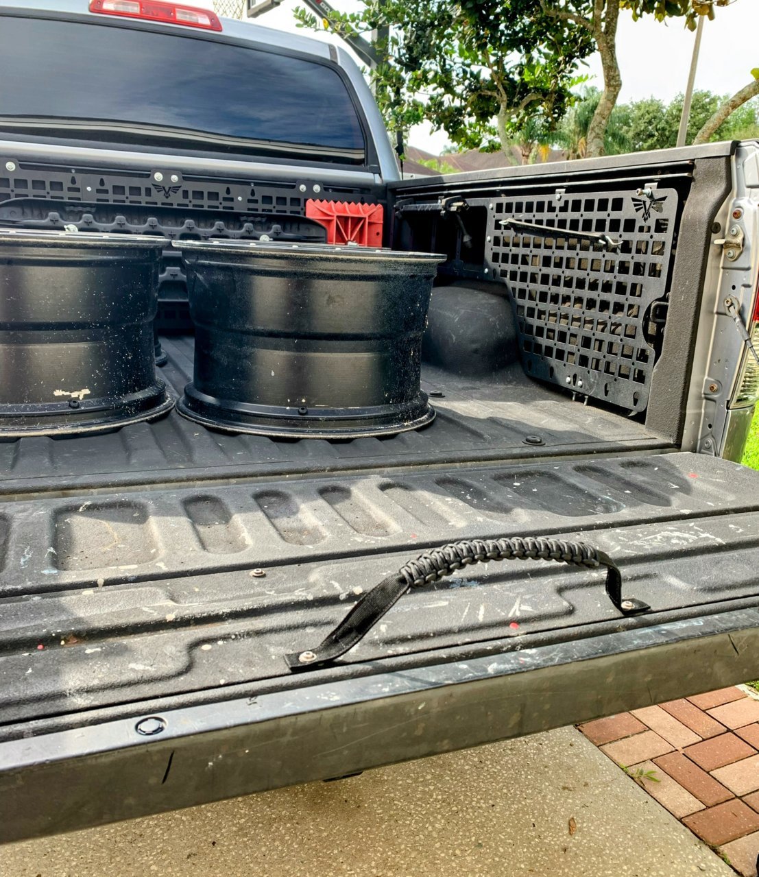

    I bought 2 different sets of paracord grab handles so I can experiment.
    I don’t care for the Seven Sparta handles from Amazon but do prefer the Yota Twins grab handles.
    here is a seven Sparta I have and tried to use it as an interior tailgate handle but I’m gonna return them I think and buy more YotaTwins handles.
