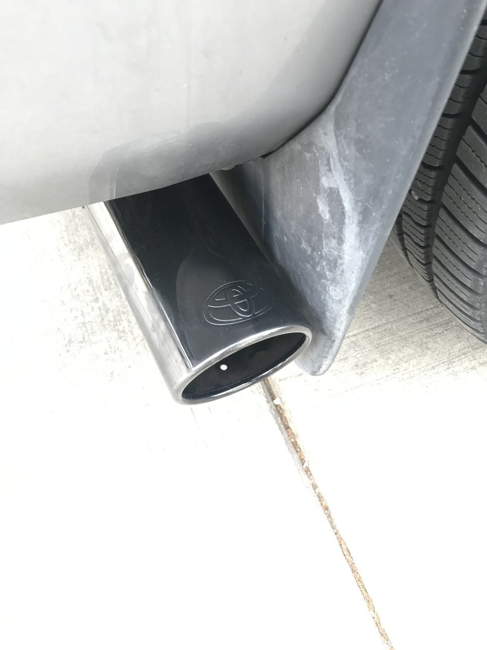

    @17TundraDCEd sent a nice black exhaust tip and I finally had the time and weather, and a relatively pain free day (along with a exhaust pipe expander) to install it.

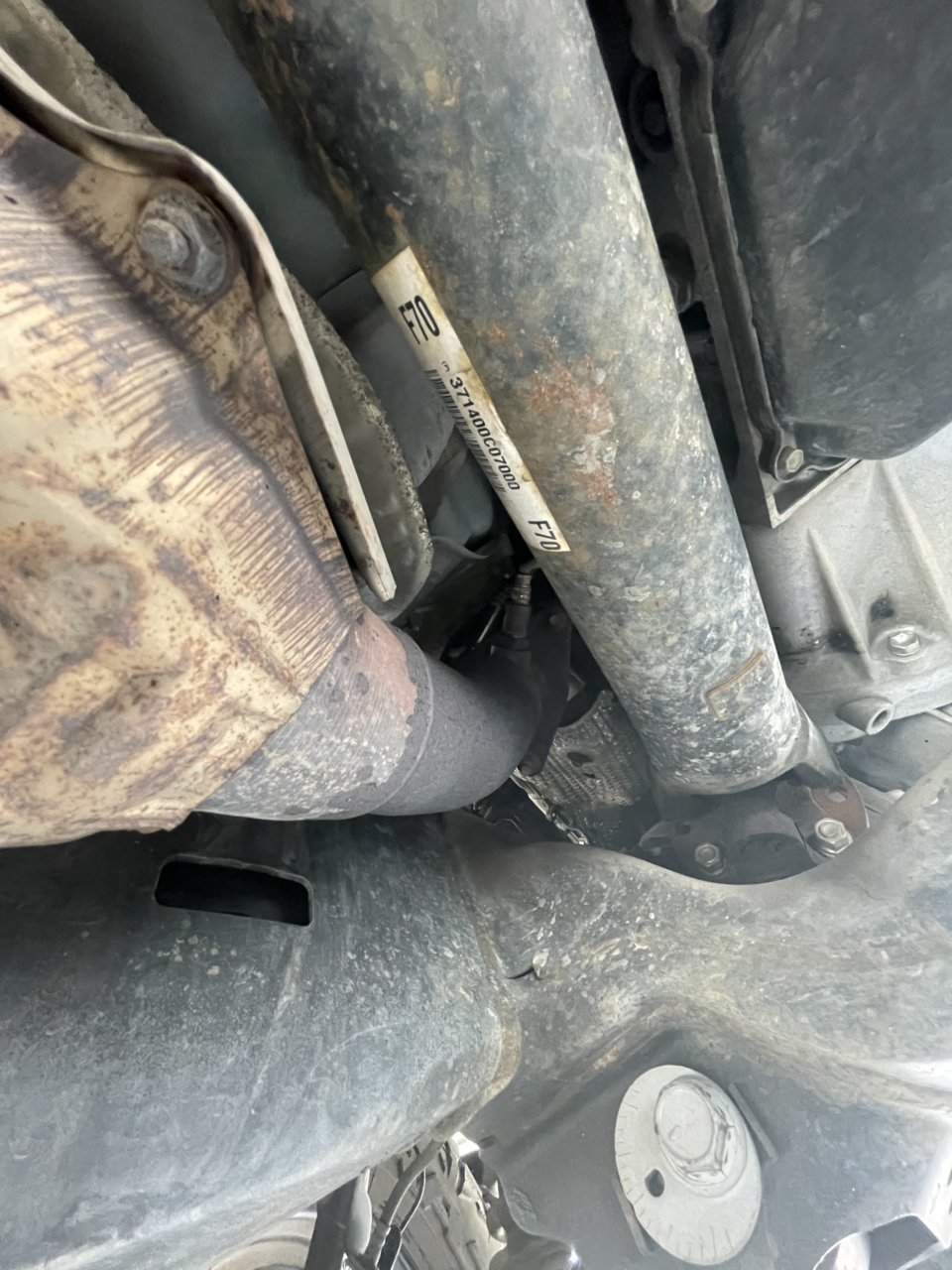

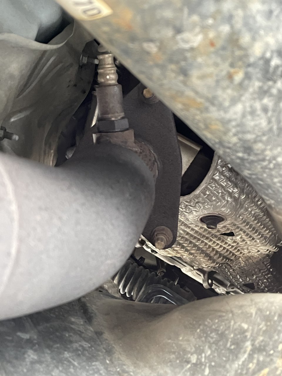

    Thanks guys! I could see what you mean on some vehicles. The Tundra doesn’t look horrible for access. Good to know I can rent one if I need to.

    Yeah that doesn’t look too bad, renting is also free, you just put a security deposit down and you get it back when you return the tool

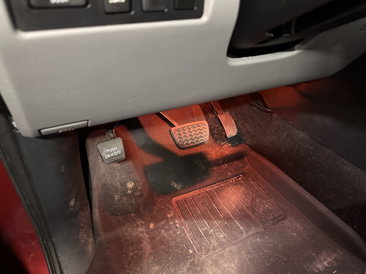

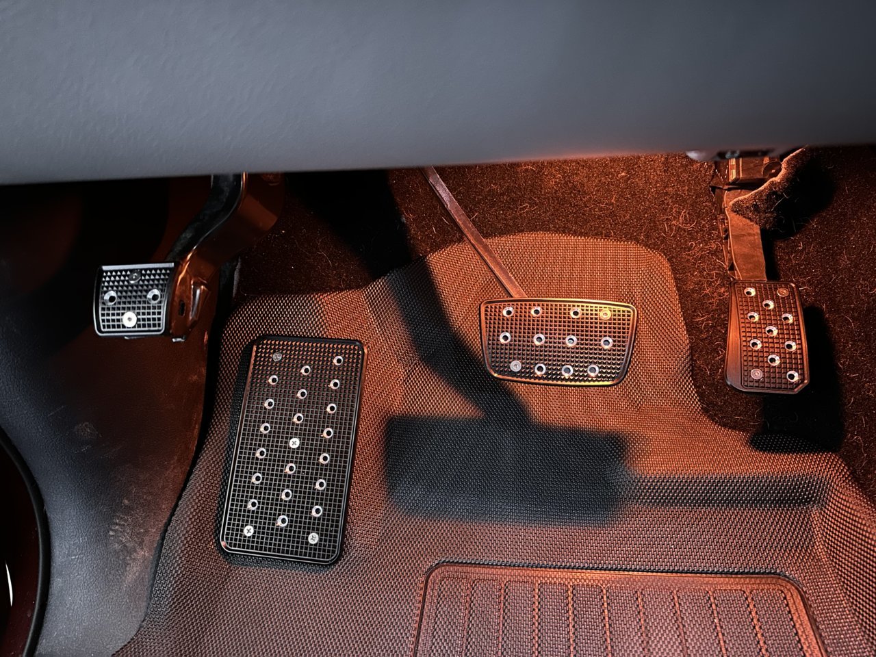

    Installed fancy pedals. Before/after:
    BD44CBA3-7A01-4C54-B629-D24C800A59B4.jpg 94CA967A-2EB7-499F-AF85-8BA85D95C55F.jpg
    They feel great! The install was easy, but not as easy as it looks.
    You need to drill through your existing pedals 3/16" to add machine screws and nuts. The parking and regular brakes are pretty thick steel so get a variety of specialty bits and work your way up. I had to remove the gas pedal to tighten the nuts.
    I broke my 1/16" bit and my 3/16" bit is now a 1/8"... So I'll be buying some new metal bits.

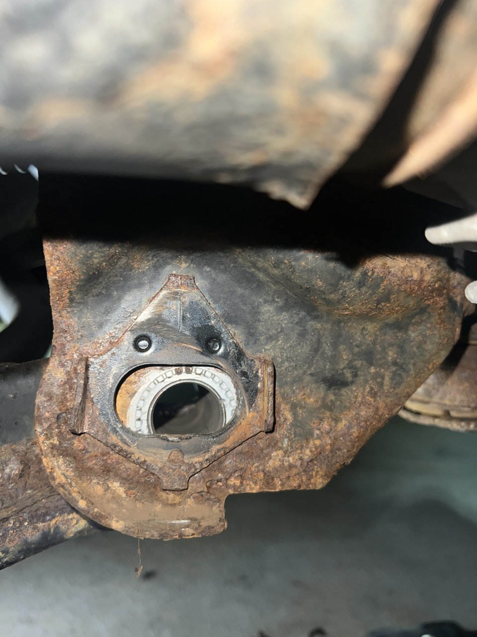

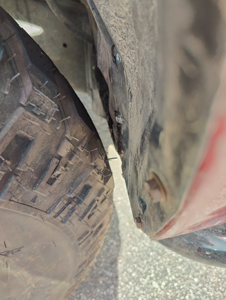

    Did an oil change, differential drop, carrier bearing drop, and clearancing for my 37's. I thought I had enough room near the cab to fit them, but I kept rubbing against the rear fender liner, so I decided to cut a few sections in my pinch welds and folded them over. I then heated up the liner to reform it against the wheel well. Now I've got plenty of clearance everywhere. Now I just need a different front bumper. My current choices are Coastal Off-road, SS Built, or Ironman 4x4.

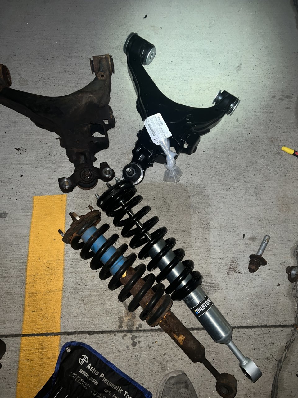

    Attempted to install 6112, new tie rods, new LCA, Bilstein UCA but the infamous LCA is getting the best of me. One came out easy and been at the other with 2 saw blades. Will try angle grinder tomorrow. Also bent a cam tab so I may have a gusset in my future.
    can’t wait to finish these installs. All ball joints have been leaking for years.

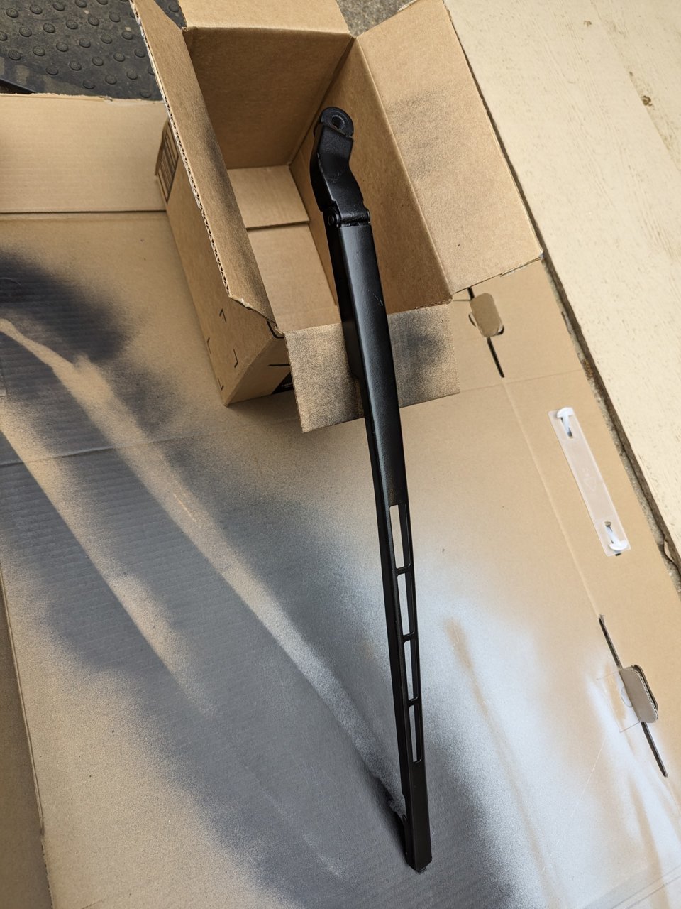

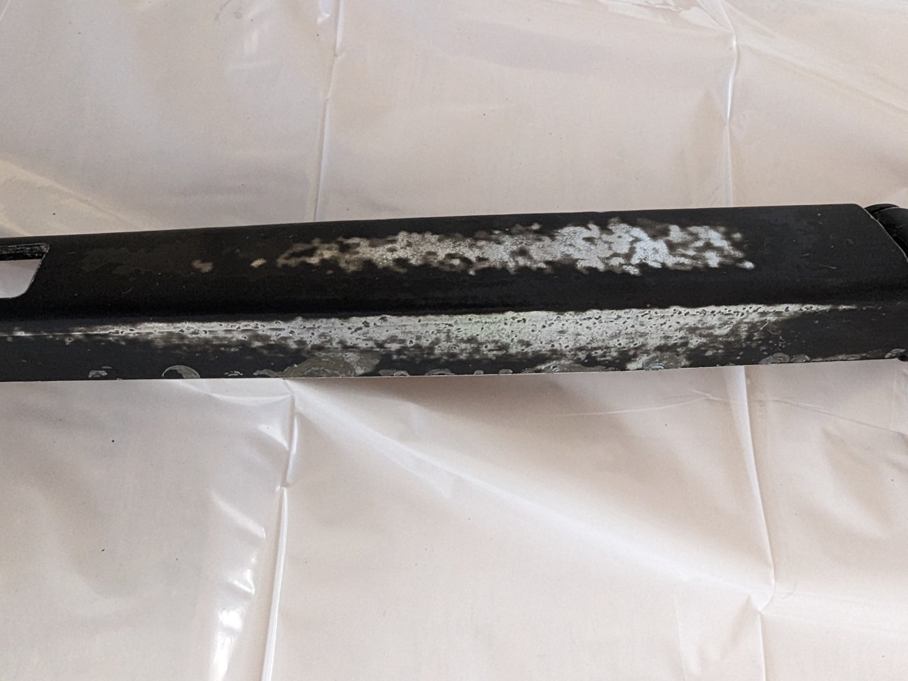

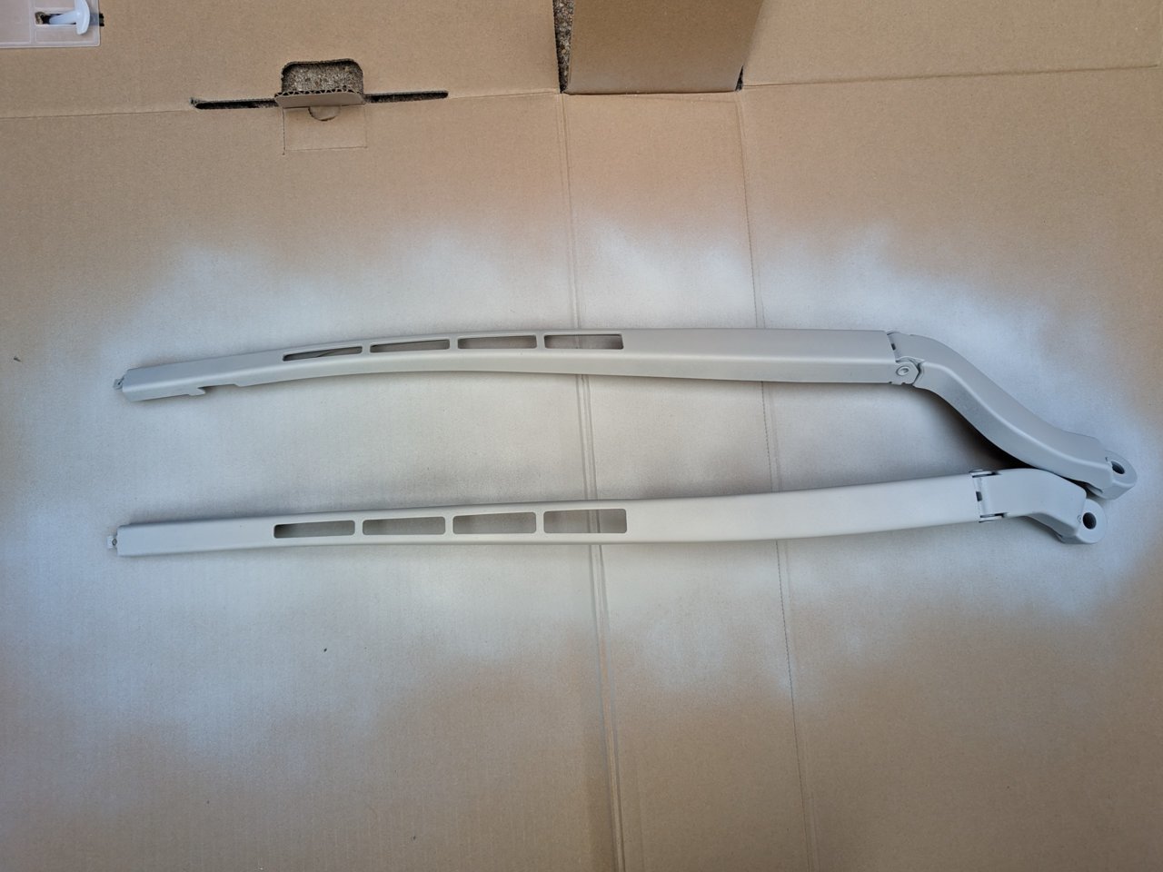

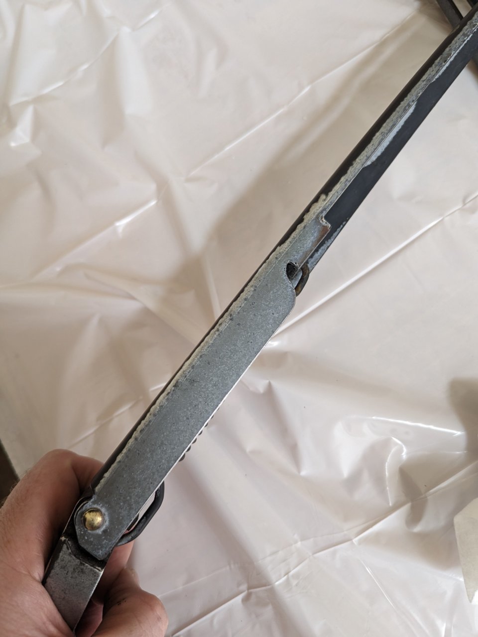

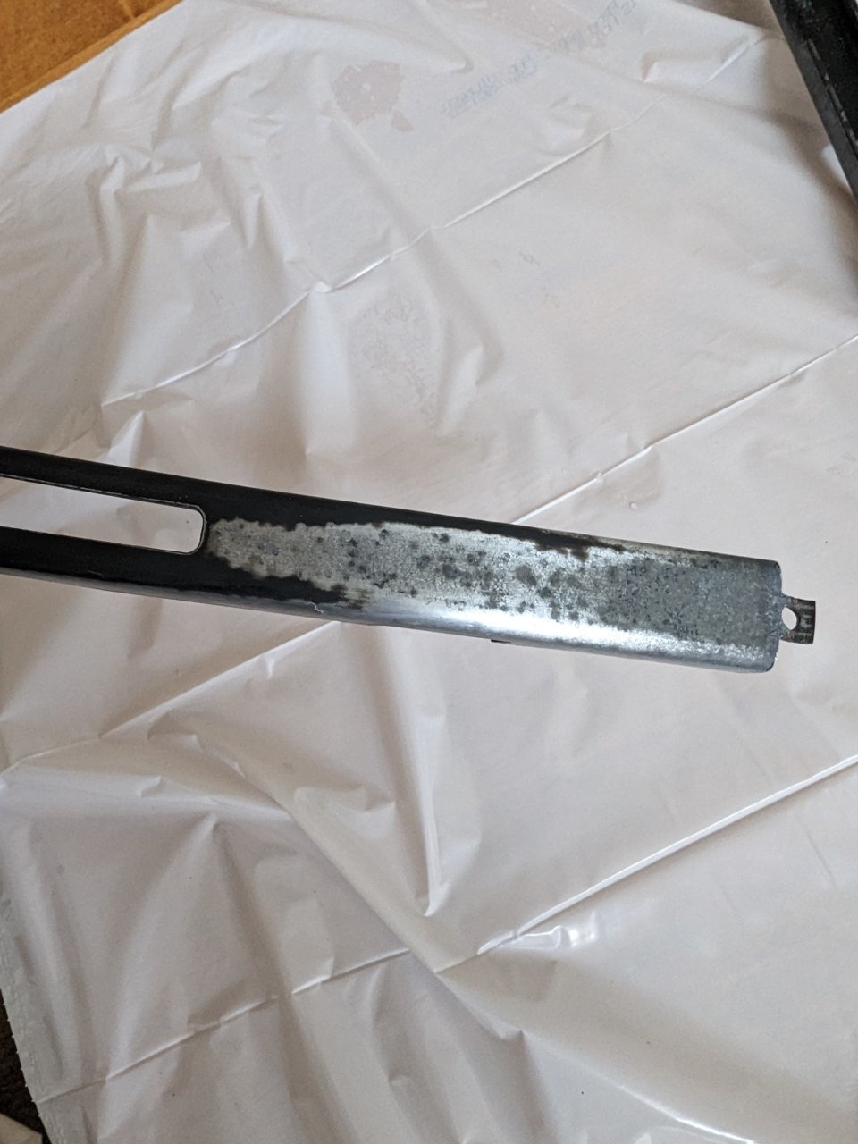

    Yesterday, not today...but here's what I did to mine (so far) this weekend.
    Wiper arms were super faded, so I took them off for a proper cleaning, sanding, re-cleaning, priming and painting with a matte black automotive paint. Unfortunately I accidentally knocked them over and they hit the ground right after spraying the base coat, so now I'll have to re-sand today before putting on the final coats.
    Also had one of my cargo lights out in the 3rd brake light assembly, so of course I did the only sensible thing and replaced both of them with the brightest LEDs I could find! And replaced the weather stripping on top of the cab.
    Projects still on my list include a grille upgrade, console safe, swapping out the factory head unit and installing a backup camera with it, getting some running boards and maybe trying to find a new trim panel for the gauge cluster area since mine has a little crack in it. It's a completely stock '08 I found with only 74k on the clock, so I've got lots of plans and figure it has more than enough life left in it to be worth all the work!

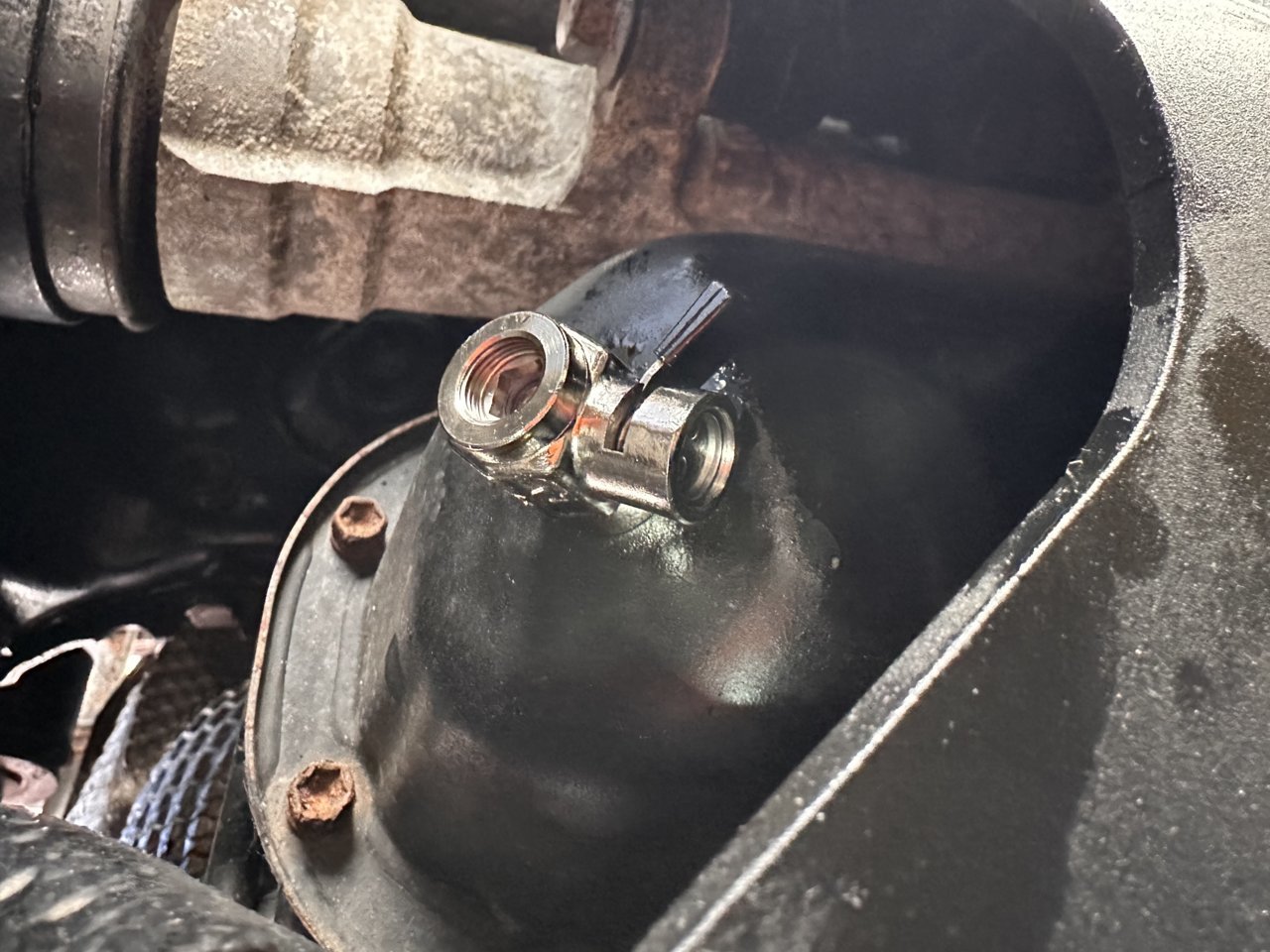

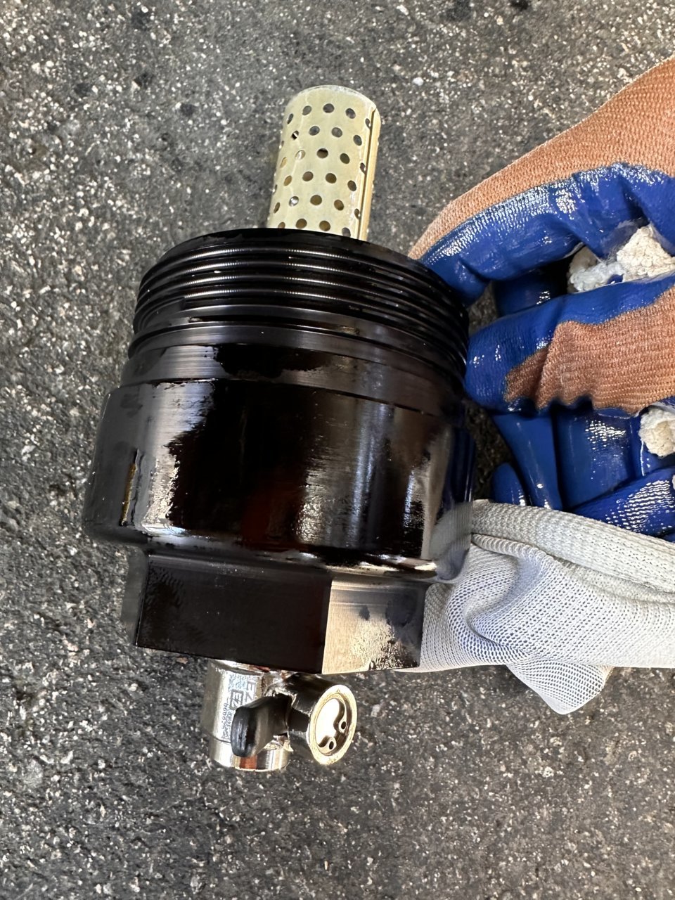

    Based on discussion in this forum, I changed my oil from 0W-20 to 5W-30 to see if it would quiet down some of the 5.7 rattle... Not much of a difference in a short drive but maybe it needs to circulate a bit?
    I installed Jowett Performance valve and metal oil filter housing which should make future oil changes easier and neater. I also have the RCI skid plate so I only need to remove a small panel to access the filter.
    785F9CB4-90A8-4024-B09C-280D2DCD1E4D.jpg 0823DB85-A716-48AF-9C60-BCFD8E16EF11.jpg

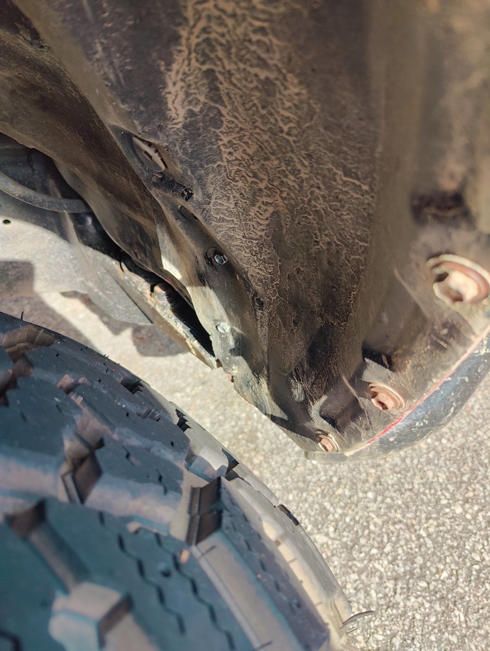

    Removed oem bumper bc friday the replacement comes in. RanchHand.
    no, it won’t match the front but it’s the best rear bumper for my needs which is to prevent serious trama in a rear end collision.

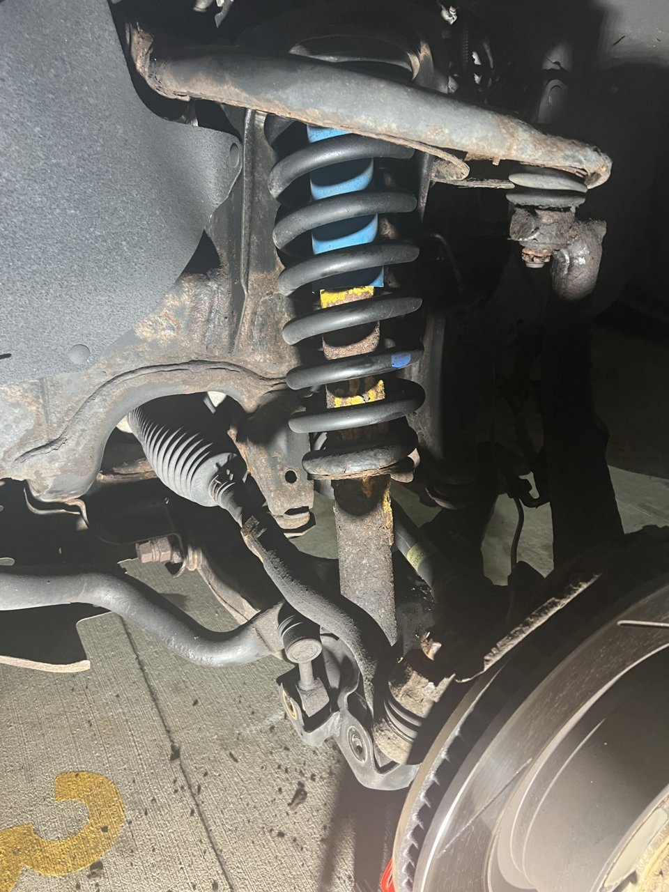

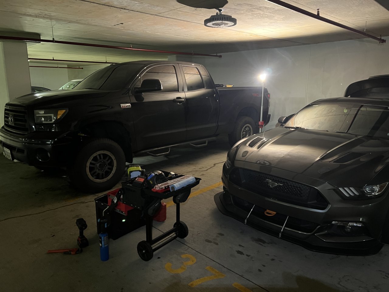

    After 5 days of messing with this, I finally. finished my front suspension.
    OEM LCA
    OEM outer tie rods
    6112 (#3 setting)
    Bilstein UCA.
    off to alignment tomorrow. A lot of anger was involved with the seized LCA and UCA bolts but other than that everything went well. One of the outer tie rod jam nut is stuck so I hope the shop can fix it. The truck looks much better now after I took care of the rear last month.
    spark plugs, engine, diff, and trans fluid next on the list.

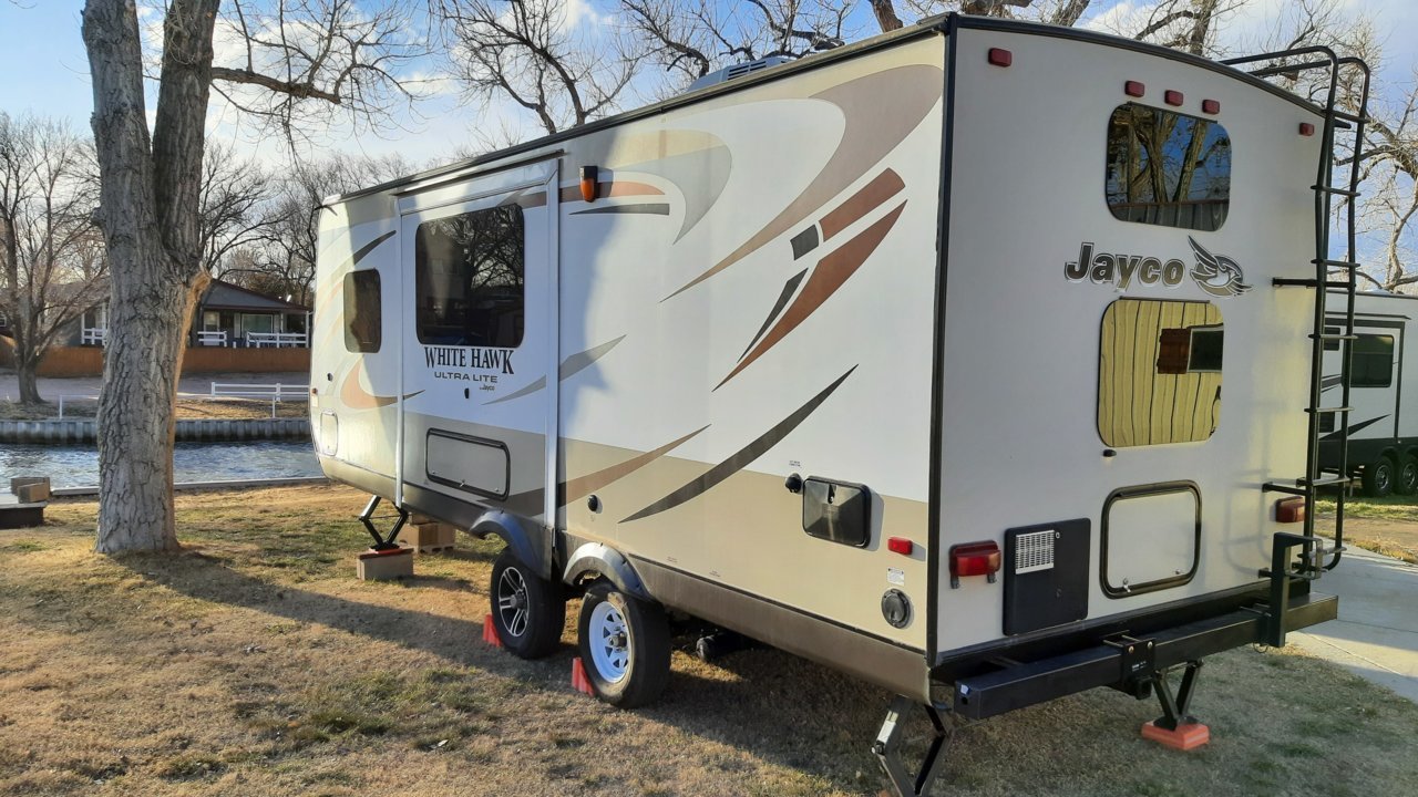

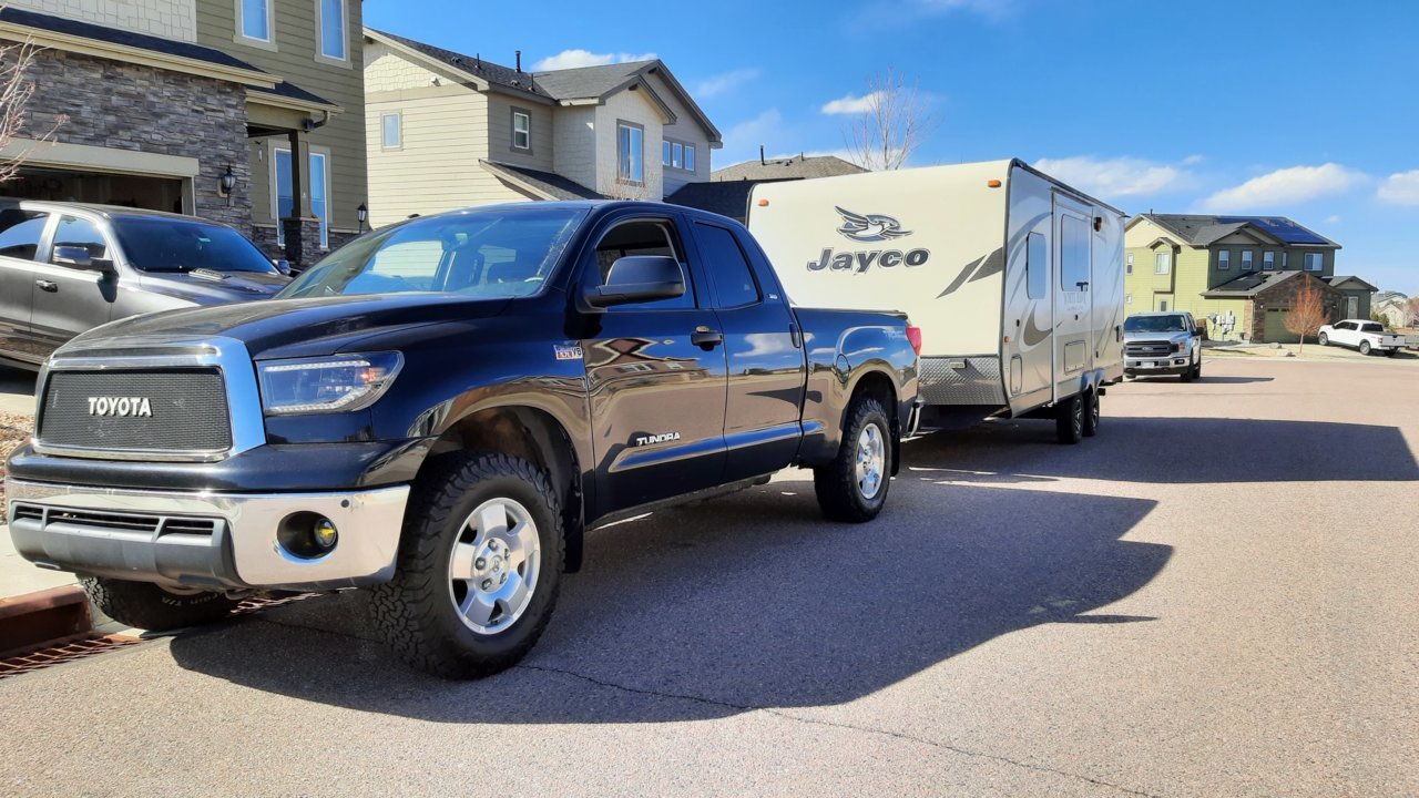

    Got a mobile domicile to tow behind it!
    Last week actually, but she pulls really nice... Even with a blowout.
    At least she's safely up at Basecamp for now.
    Let the adventures (and maintenance) begin!
