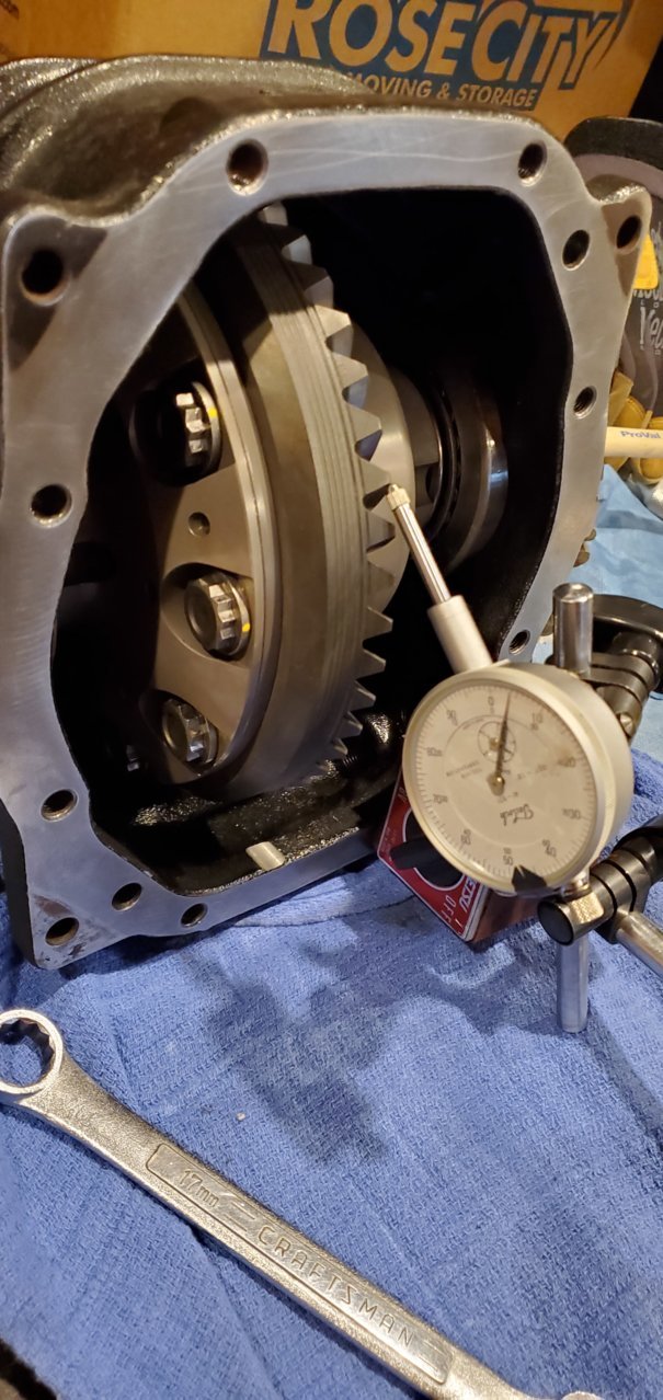

    What happened? Pinion seal leaking or did the nut come loose?
    These have a crush sleeve that must get replaced if that nut ever moves. That said, the nut is one time use too and gets replaced if ever moved.
    In short you need a beam style torque wrench rated in inch/pounds to measure the rotational torque of the bearings and seal as the nut is tightened. You'll need the spec from the manual and to your point, the diff needs to come out and obviously have the carrier pulled to install new pinion bearings and set pinion bearing preload
    It may not be a day job...
    The 2010 4.6 also has a 9.5 ring w 3.909 ratio.
    Ping me if you need help. I just installed this OS-Giken LSD in my IS-350.

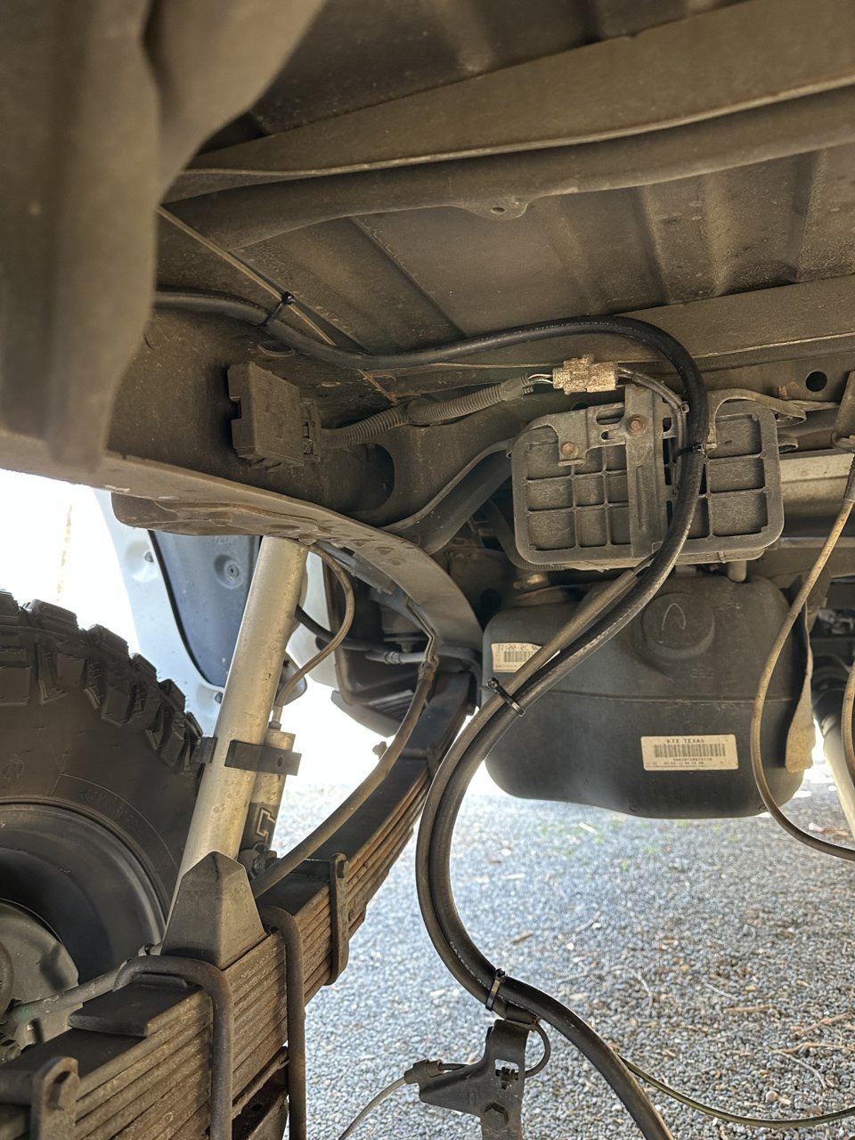

    Did the rear diff breather mod behind the tail light today. It’s these little inexpensive mods that I can’t stop doing. 27DB3666-3C50-400A-972C-6D842AE5E09B.jpg 76AD676A-A190-4046-A064-F8AB61E42826.jpg 1166E16E-F27E-4075-BEA0-00C848533C20.jpg

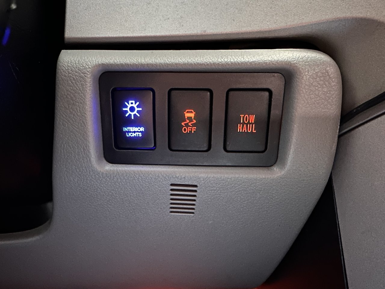

    Replaced a blue button with an orange button. This should have taken about 3 minutes but it took an hour because I did an awful job with the wiring the first time and I had to redo it.
    3B13C9BF-ED1C-4CFD-854C-FA35E3E493CD.jpg 49A66FA6-4220-4799-A2B3-0B4567EB4E4A.jpg
    Anyway orange buttons match better.

    Did you buy a whole switch or just swap the LED. The LEDs can be swapped with basic soldering know-how, but I've yet to find an exact color match for the orange in our trucks.

    I replaced the switch because it didn't occur to me to just disassemble it!

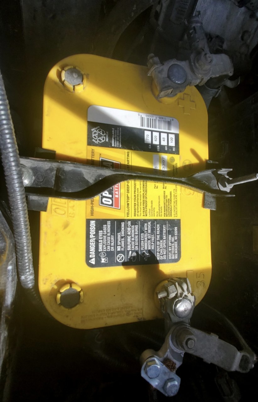

    "upgraded, or downgraded my battery tie down.. It kept slidding off to the sides, because the OEM bracket was too high, so, I took my Celica's spare tie down bracket, and ordered a short J hook from tue back side. Aint going anywhere no more.

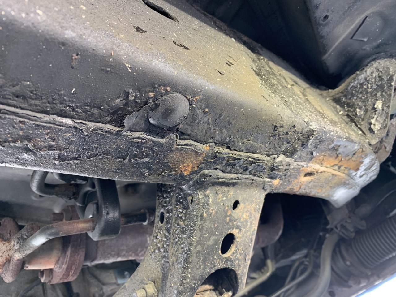

    I also went and looked at buying a 2000 Tundra at a local car lot but unfortunately the frame was super rusted.
    I’m no rust expert but this looks bad to me.
    Looking for an extra midsize pickup for kids.

    Hard to tell from the pictures but that looks like the coating from the frame is flaking off and there is a little bit of surface rust?

    That is almost brand new. If it's a 2000 model, it'll still be here in 2050.

    Looks to me like somewhat substantial rust has been spray-painted, and that paint is now flaking off with the rusted material beneath. Where the bed mounts, appears quite rotten in the pictures as well.
    Just the fact that someone attempted the "quick fix" would give me pause regarding any other maintenance
