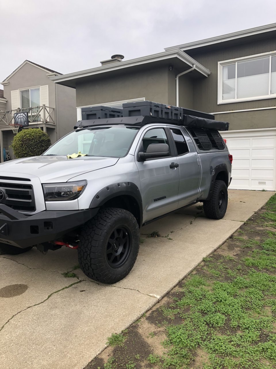

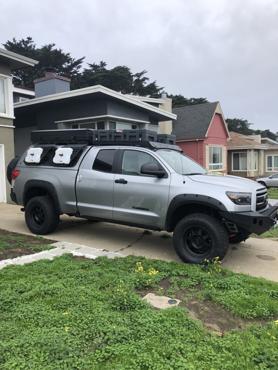

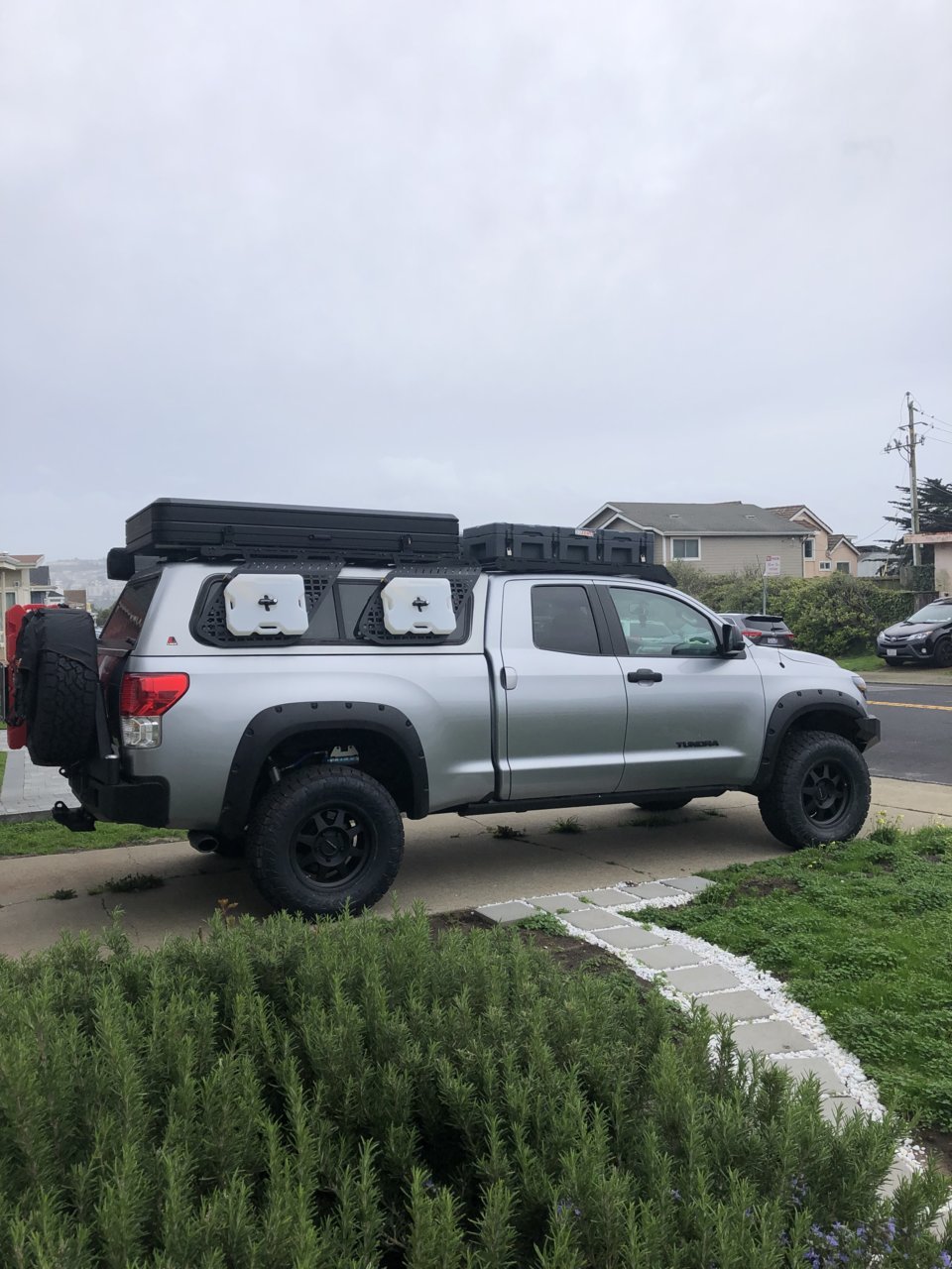

    Put on some new shoes

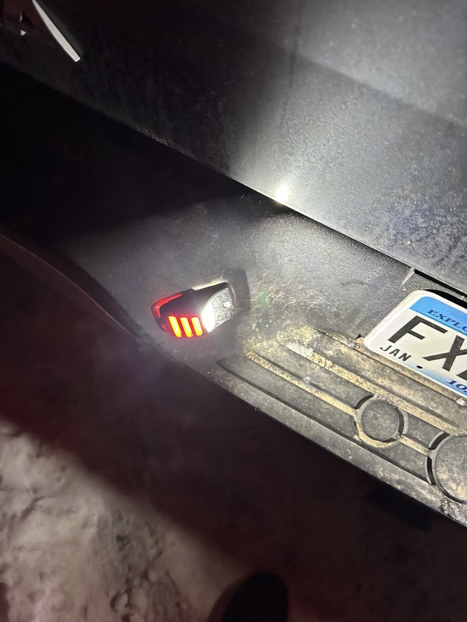

    Had to replace the bulbs so ended getting new led license plate light instead fit is off a bit 2C791A8C-FAFF-4D07-8E02-726399624DC2.jpg

    Tell me about the cap rack outriggers? Those look useful.
    Nicely done.

    Outriggers? Mean the molle panels on the side of the camper shell?

    Yeah. Who makes em? Haven't seen those before.

    they’re the rago fabrication side molle panels for a 5th gen 4Runner. Modified the suction mounts to fit the angle of camper shell

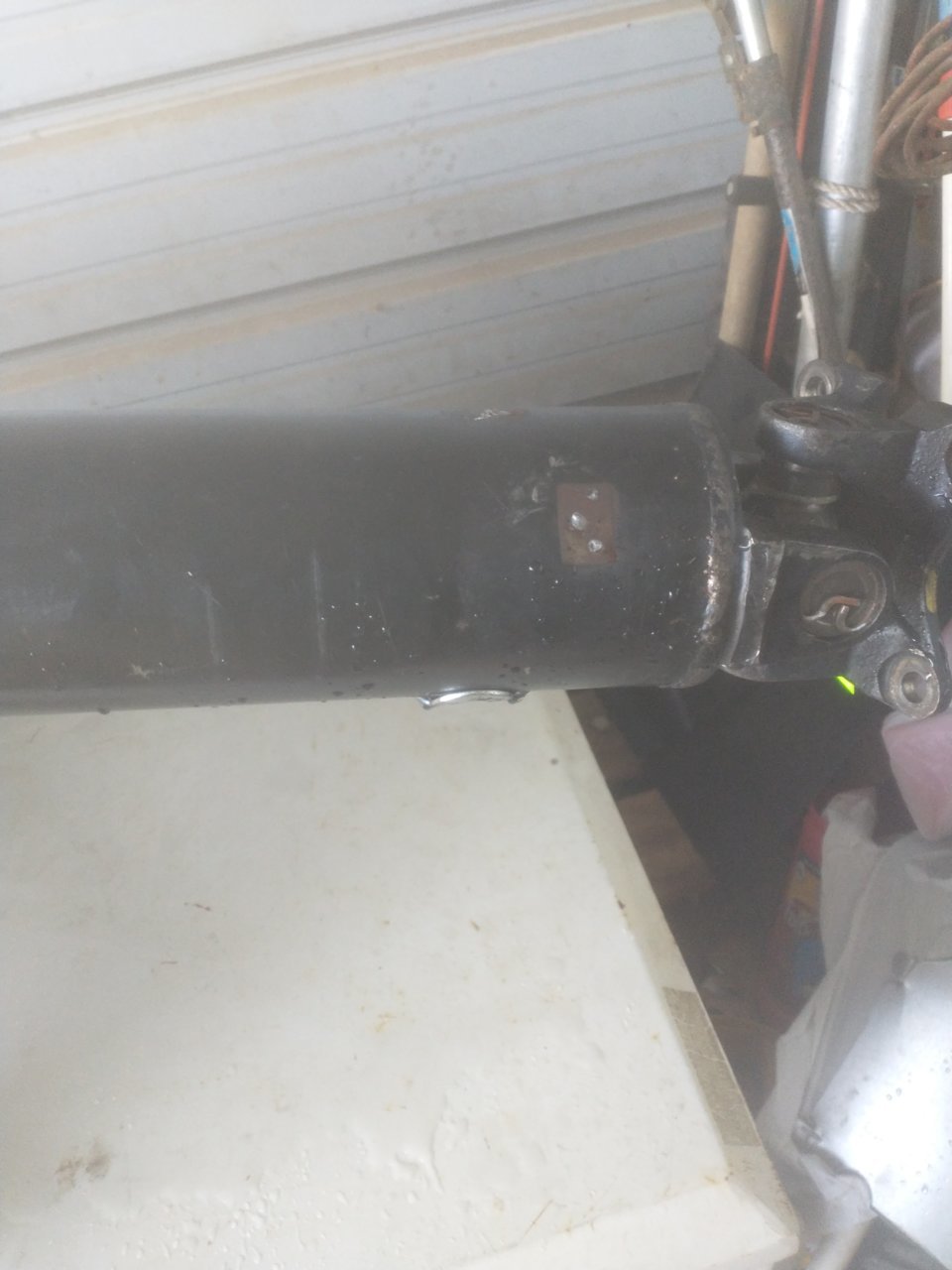

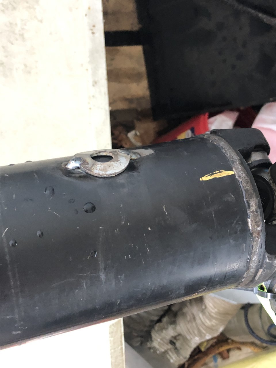

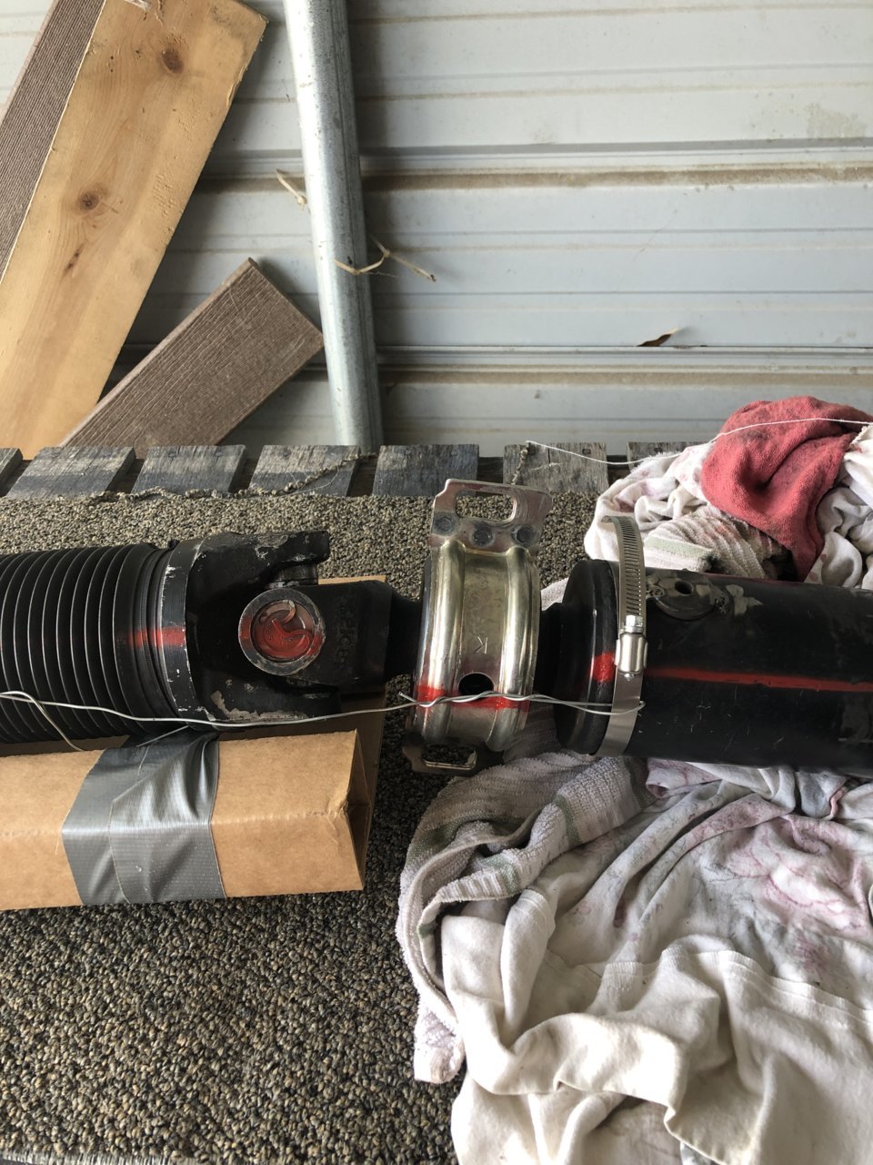

    Reinstalled the driveshaft after coming back from the shop a second time.
    I can tell they balanced it this time...

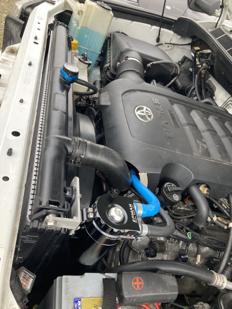

    Added a oil catch can to the 3URFE + new radiator

    I've never seen this before. I googled it so I now know what it does, but why did you want it?

    Radiator I can understand to upgrade the OEM, but a catch can is usually only necessary for forced induction applications.

    I had to add engine oil once in a while and after my engine rebuild, there are no leaks or parts left wich can cause that, so I decided to catch the oil fumes from the PCV valve before sending it into the intake and it looks good I think :D

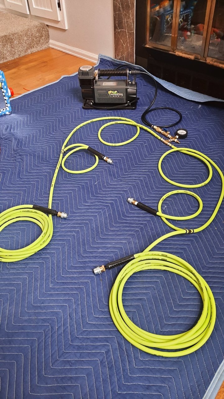

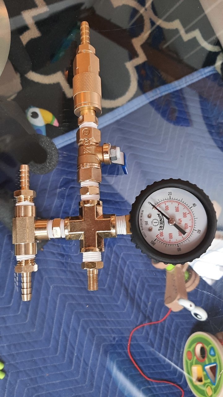

    Nothing done TO the Tundra, but mostly FOR and designed around Betty:
    Finally pieced together my manifold, hose sections and air chucks for my 4 way, tire inflation/deflation, and balancing kit.
    Goes along with the Ironman 4x4 12v air supply Santa got me while they were on sale. Allegedly they work quite well for inflating 4 large AT tires, so I hope it is more than sufficient for our ~33's
    Everything still fits nicely into the provided carrying bag. Little dude helped with the assembly process. Smooth as Eggs.

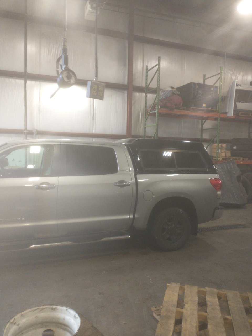

    Picked up a used shell, cap, topper....

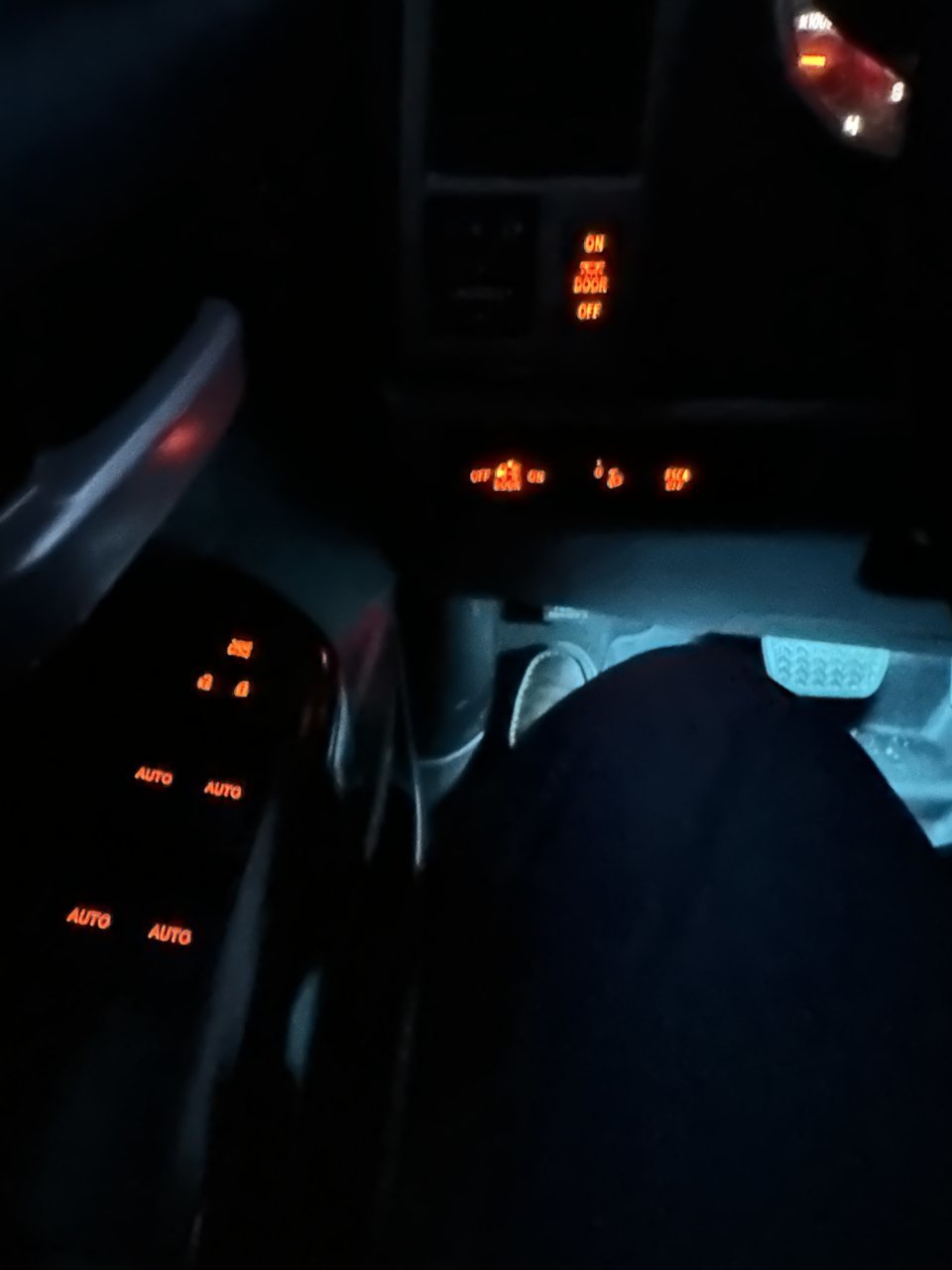

    Got my switches in today and installed the drivers side in about 5 min!
    everything seems to work great.
    @CMikeB, what question did you have?

    This switch makes all four windows power one touch up/down? If so, I'm in. How was the wiring?

    Correct. I only bought the drivers door master switch. My passengers can hold the switch up or down. Cost of riding in my truck!
    there is no wiring needed. Simply pop the switch cover off the door, remove the connector with the harness, and unscrew the factory switch from panel. Then install new switch, plug in harness, and place back on door.

    I tried all light combinations, off, parking, on, and auto and they seem to be on all the time.
    as for brightness, I feel like they aren’t as bright as the dash lights, but that could be true for the original where only my drivers window switch was auto and ligted. The image below makes them look just as bright as the dash.
    Hope this answers your questions and thanks for mentioning these switches!
