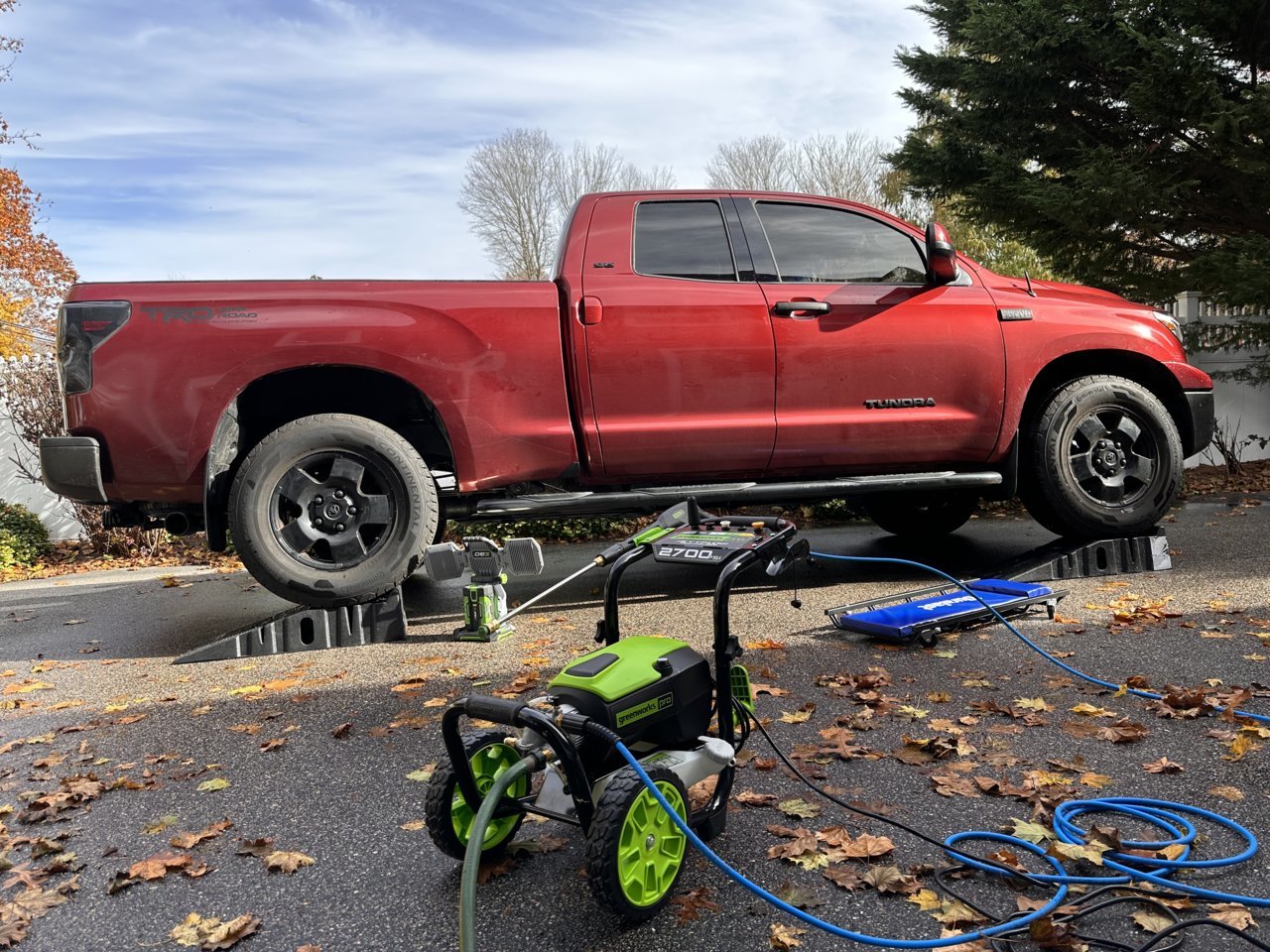

    I ramped up and power washed the underside to prep for fluid film application tomorrow after it dries. For those who've proactively fought rust before, any advice?
    I got 6 spray cans of Fluid Film and I plan to touch up rusty spots with Corroseal. I previously Corrosealed all rust two years ago but rust resurrected in a few spots.

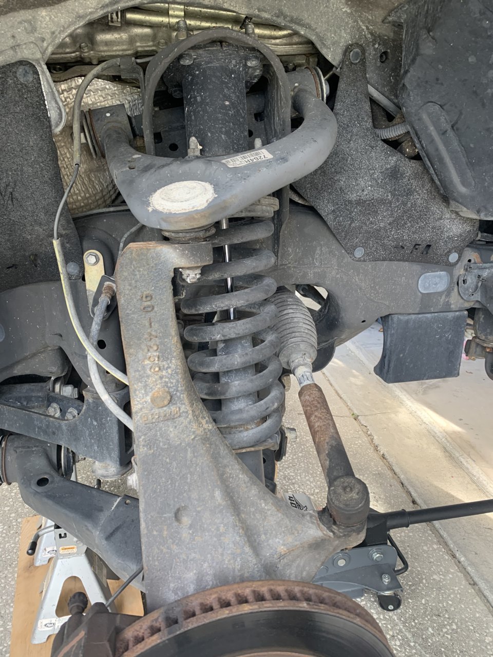

    oem

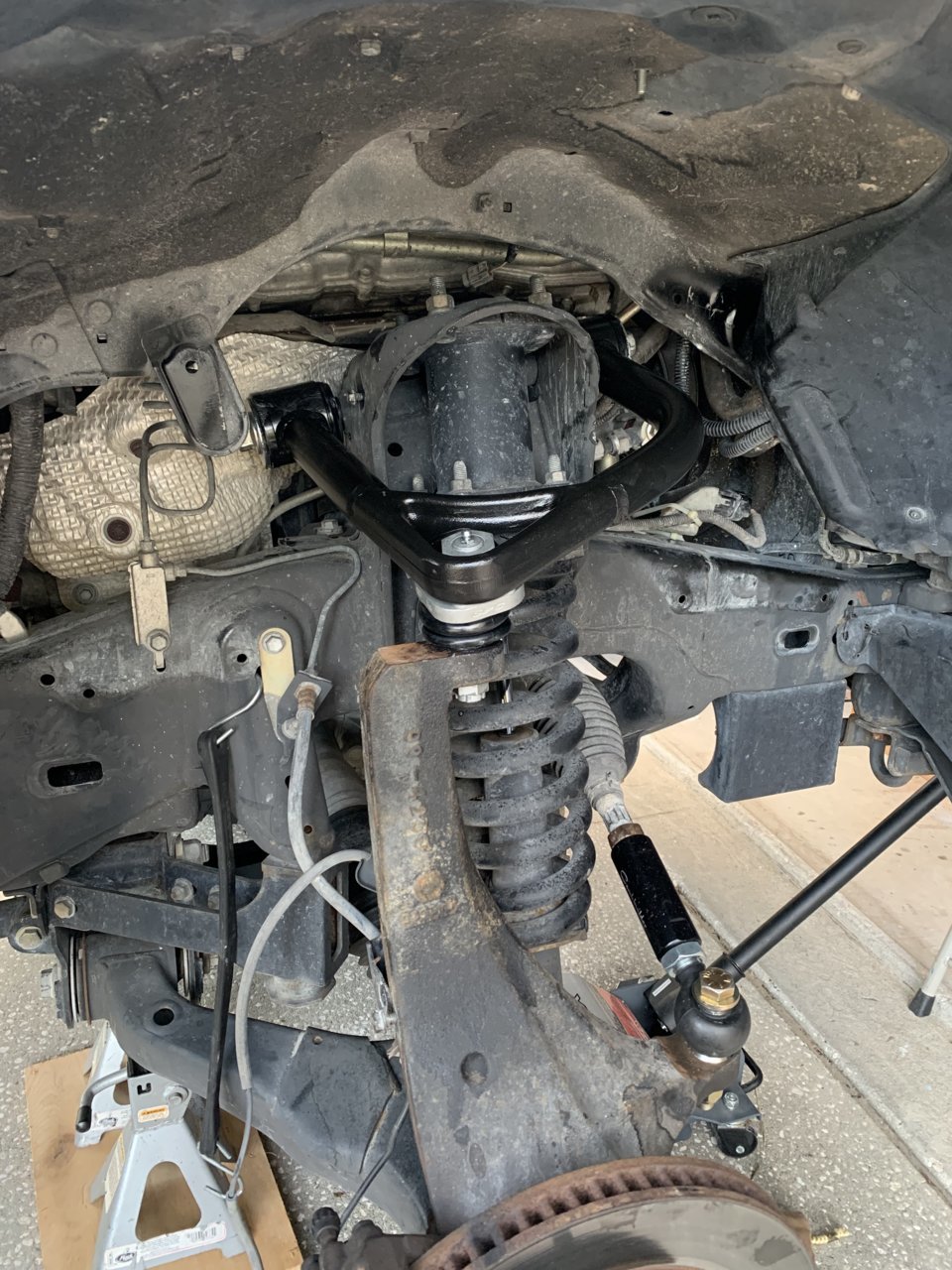

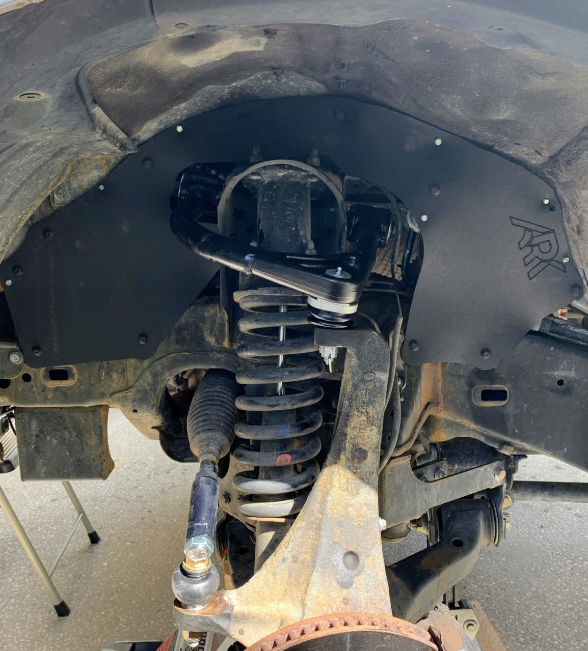

    With SPC adjustable UCA’s and Coachbuilder outter tie rods, and the oem splash shields removed

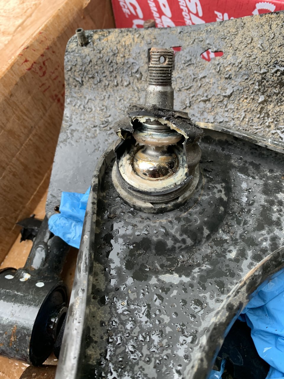

    Oem UCA exposed ball joint for those interested
    With ARK splash guards installed

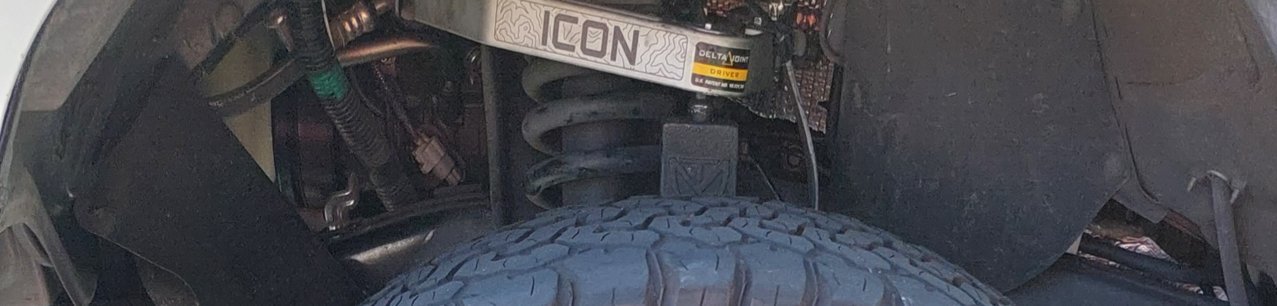

    how much clearance I have with the Coachbuilder’s and tires.
    Just waiting on the Amazon van to arrive with the 31mm or 32mm socket required to torque down the UCA top nut.
    Dropping it off at alignment shop at 0700 tomorrow assuming the socket works.
    Other than a 31mm or 32mm nut I would recommend having a 22mm wrench; long & box ended or whatever would be preferred bc I had to use giant vice grips and a breaker bar which sucked.
    I’m also waiting on a grease gun to arrive so I can fill and then maintain the tie rod heim joints as well as zerk UCA ball joints. New toys to play with!!
    :yes:
    It took me yesterday and part of today to finish bc I didn’t have all the proper tools and I go slow and am meticulous when doing things that involve holding the wheels on.
    btw, 173 ft lbs of torque really is a doozy but I got it done solo in the driveway so anything is possible

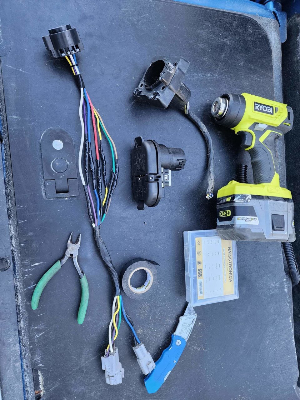

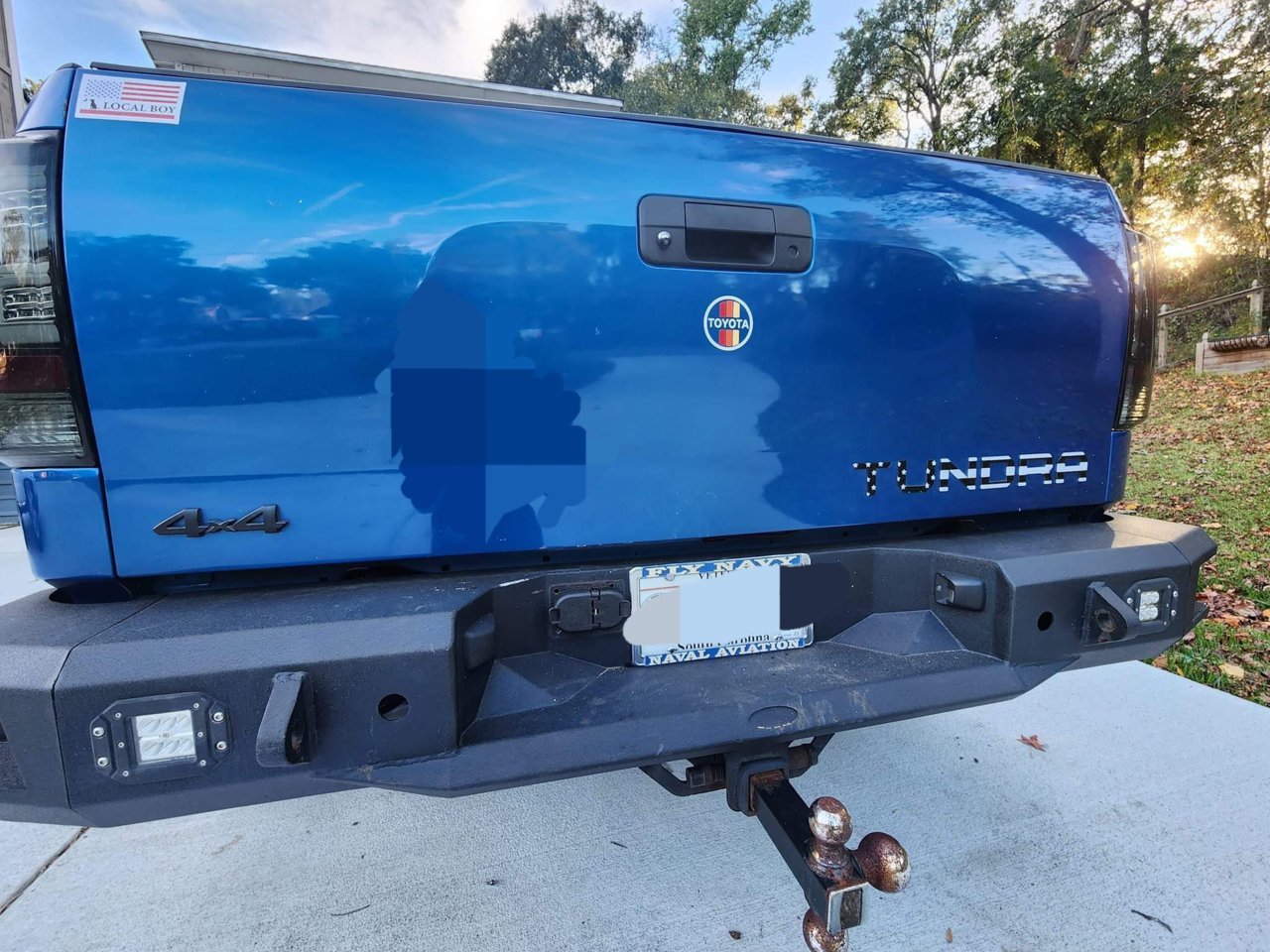

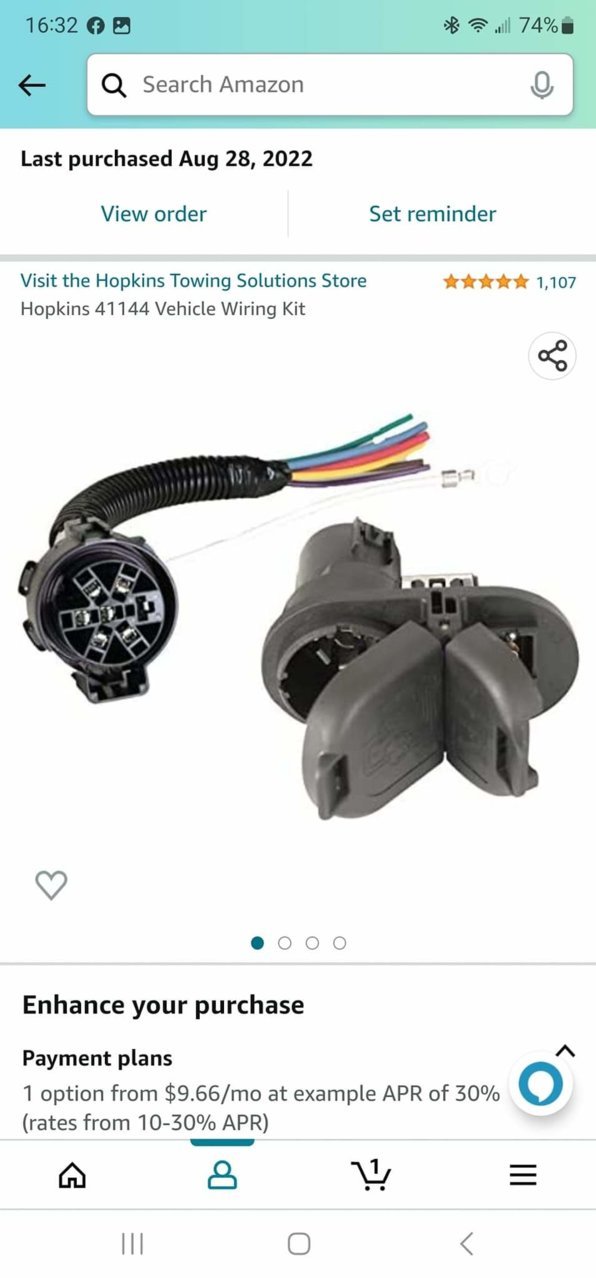

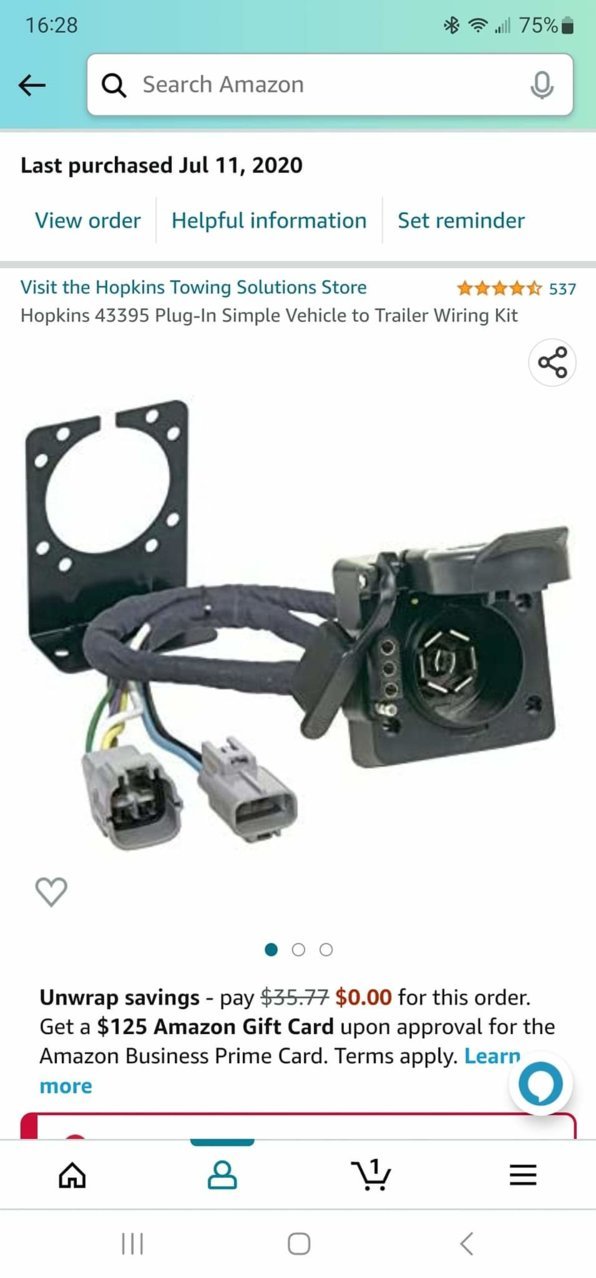

    The cap for the trailer harness I installed a couple years ago came off because the hardware had rusted away. Replaced it with the much better updated design that comes on most trucks these days. I wrapped and loomed the wire harness before I installed (not shown). I didnt know the Hooke Road bumper cut out fit the 41144 plug design or I would have just gotten that one back in 2020.

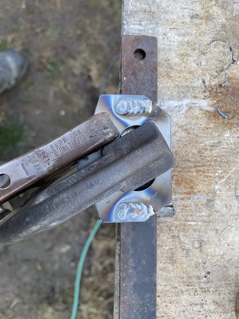

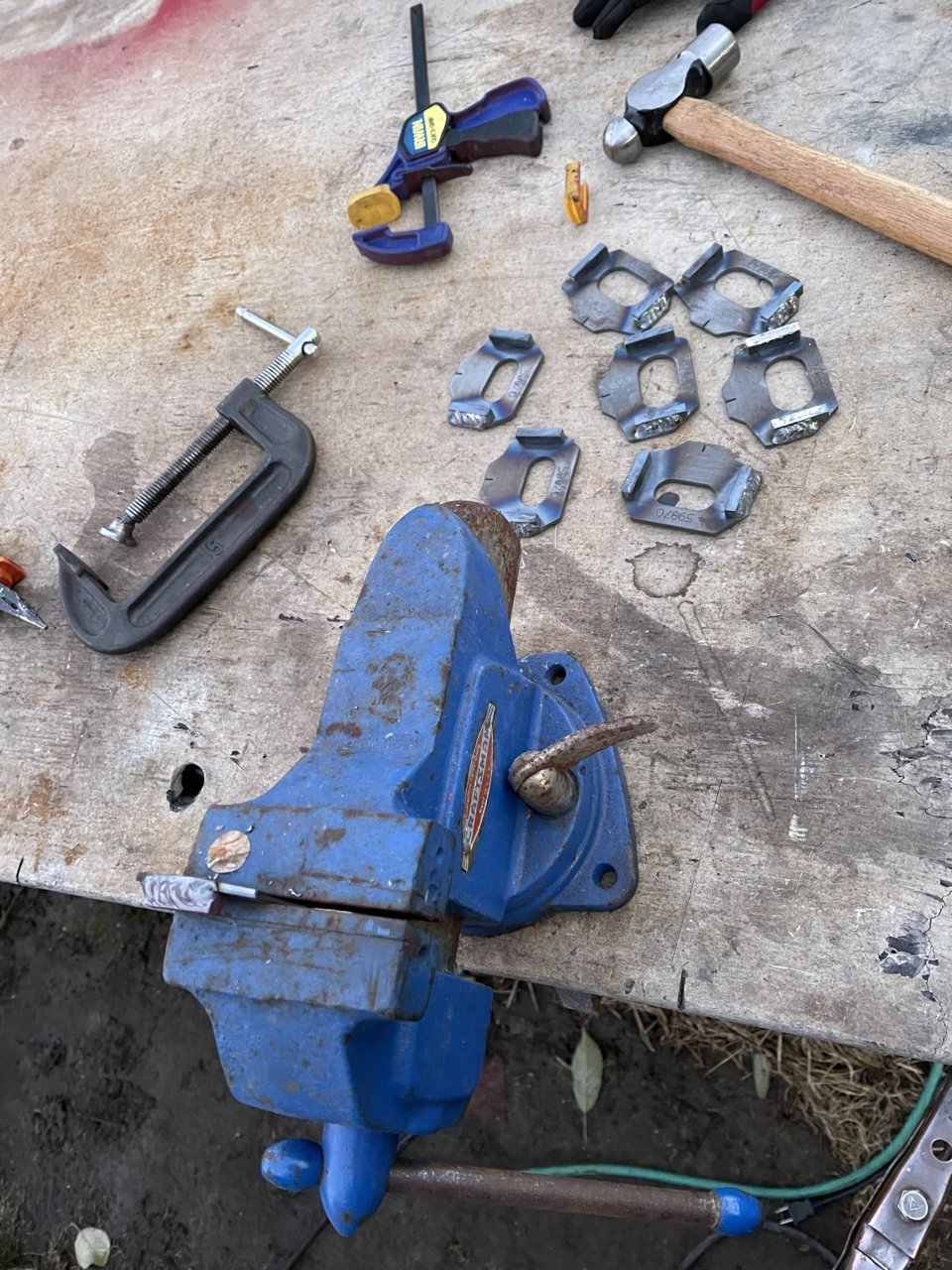

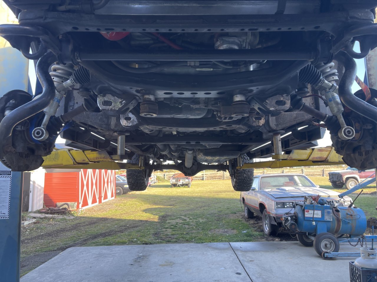

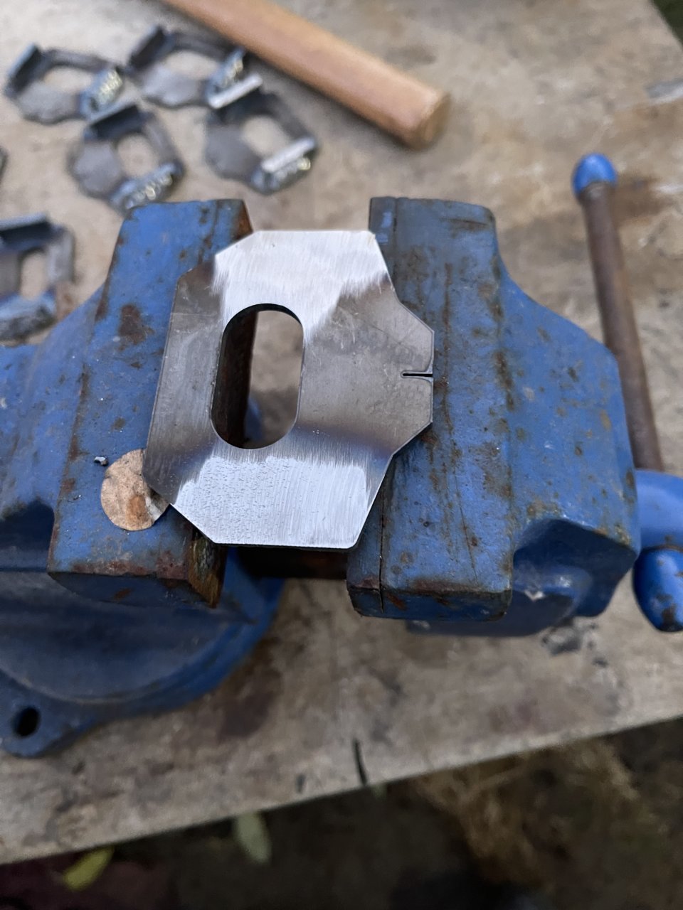

    Got the LCA's removed and old bent Cam tabs out and cleaned up. Then spent the rest of the time welding up and getting ready for install Total Chaos Cam Tab Gussets. First time in 11 years since I've picked up a welder :rofl: kinda was fun suiting up in my gear again.

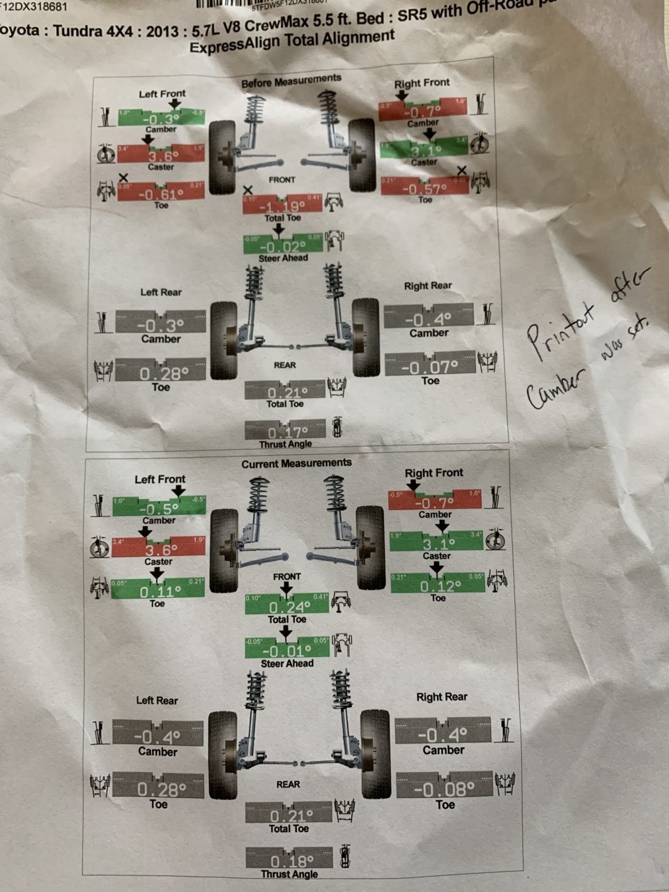

    Does your alignment tech know how to use the cam tabs?
    I ask bc I just dropped mine at Tires Plus and the guy said he has never seen adjustable UCA’s like the SPC’s I just put on, which was exactly what I was afraid he was gonna say. Then he said they only do OEM specs even though it’s lifted. :eek::eek2::confused:
    joseph_womack likes this.
  27. Nov 9, 2022 at 12:29 PM
    Ohannon7
    Ohannon7 New Member
    May 12, 2021
    #62948
    228
    Central Fl
    2013 5.7 4WD CM Bench-Seat Silver
    6” Pro Comp 37’s Custom audio and interior Off road capability is current focus
    Technically it drives better than it did before I drove it to tires plus, but the alignment specs looks like they did nothing.
    i guess I should find an off-road shop that does alignments, not really sure
