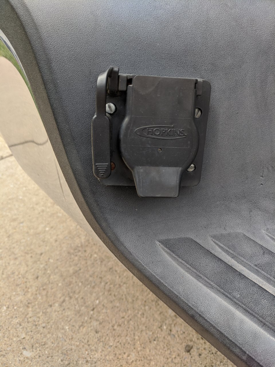

    A few... Definitely more than 2
    Not very hard at all really. I dropped the spare for some space underneath. Picked roughly where I thought it would work and traced the bracket that I pulled off. The purple is about where there is thin sheet metal behind the plastic. I started with a 2 in hole saw for the 7-pin half of the plug (which fits perfectly) and then used a combination of a Dremel and a grinder to remove the plastic and the last little corner of metal above the hole saw cut out. I got lucky and happened to place it perfectly to not have to grind any more of the metal above for the 4-pin half of the plugs. Then I just shoved it in there. I have heard from others that it is very loose only being clipped into the plastic but mine seems to be quite firmly in place with just the clip that secured it to the factory bracket and I would really have to yank on the plug to pull it out without disengaging the clip.

    Thanks! Mine rusted off a while ago. I need a new plug set up like yours.

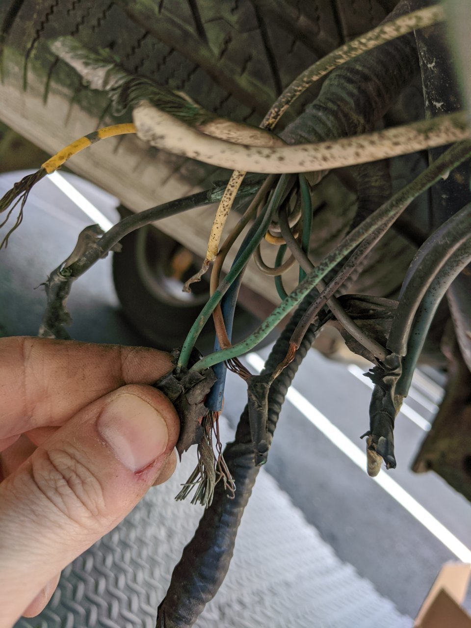

    Ayy I'm working on the trailer plugs this weekend the previous owner for some reason decided to splice the wires?! It may need a new harness there seems to be corrosion running up the wire.

    Which part number did you use for the 7 pin / 4 pin component? Or was that your original one and you had only bent the previous bracket?
    I've been meaning to do something like this for a while. Only got as far as removing my busted bracket... :(
    That is the original plug that was on my truck. I bent the bracket that it sat in under the bumper on a rock or something while playing around offroad. That was a few months ago and I just got around to moving it up into the bumper.

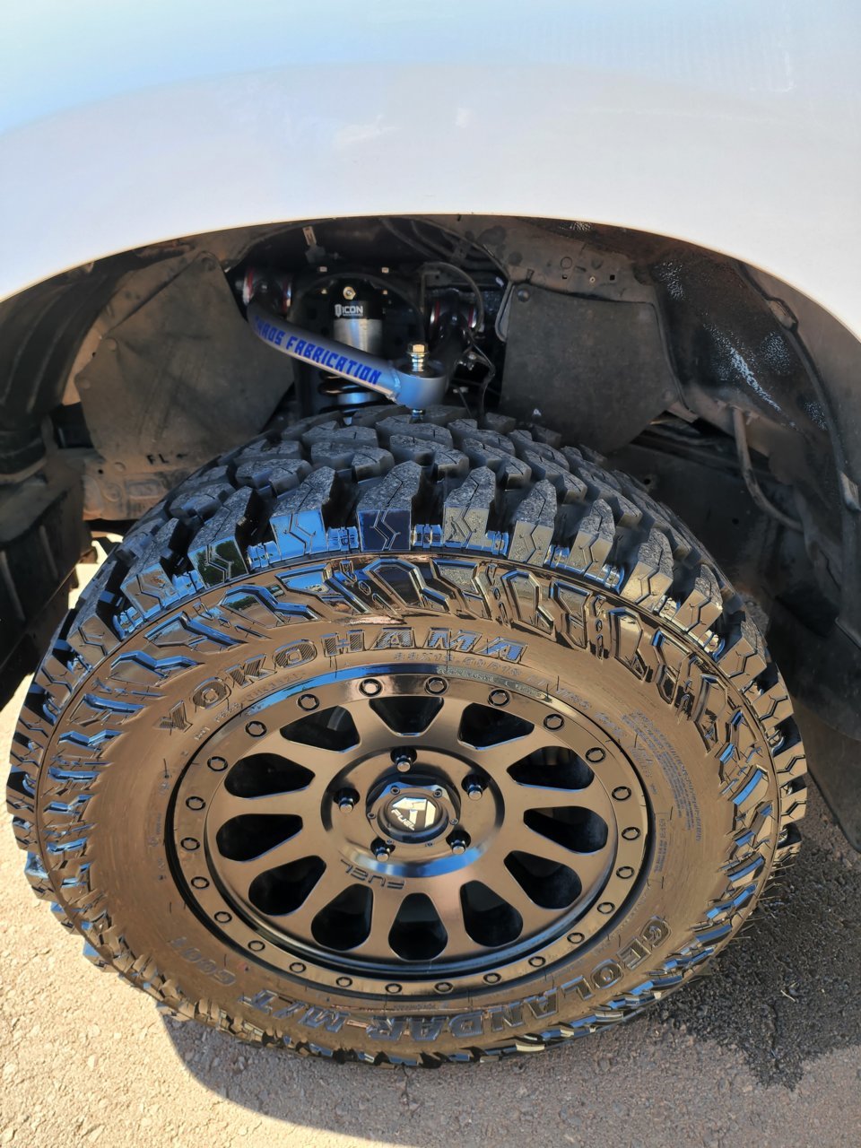

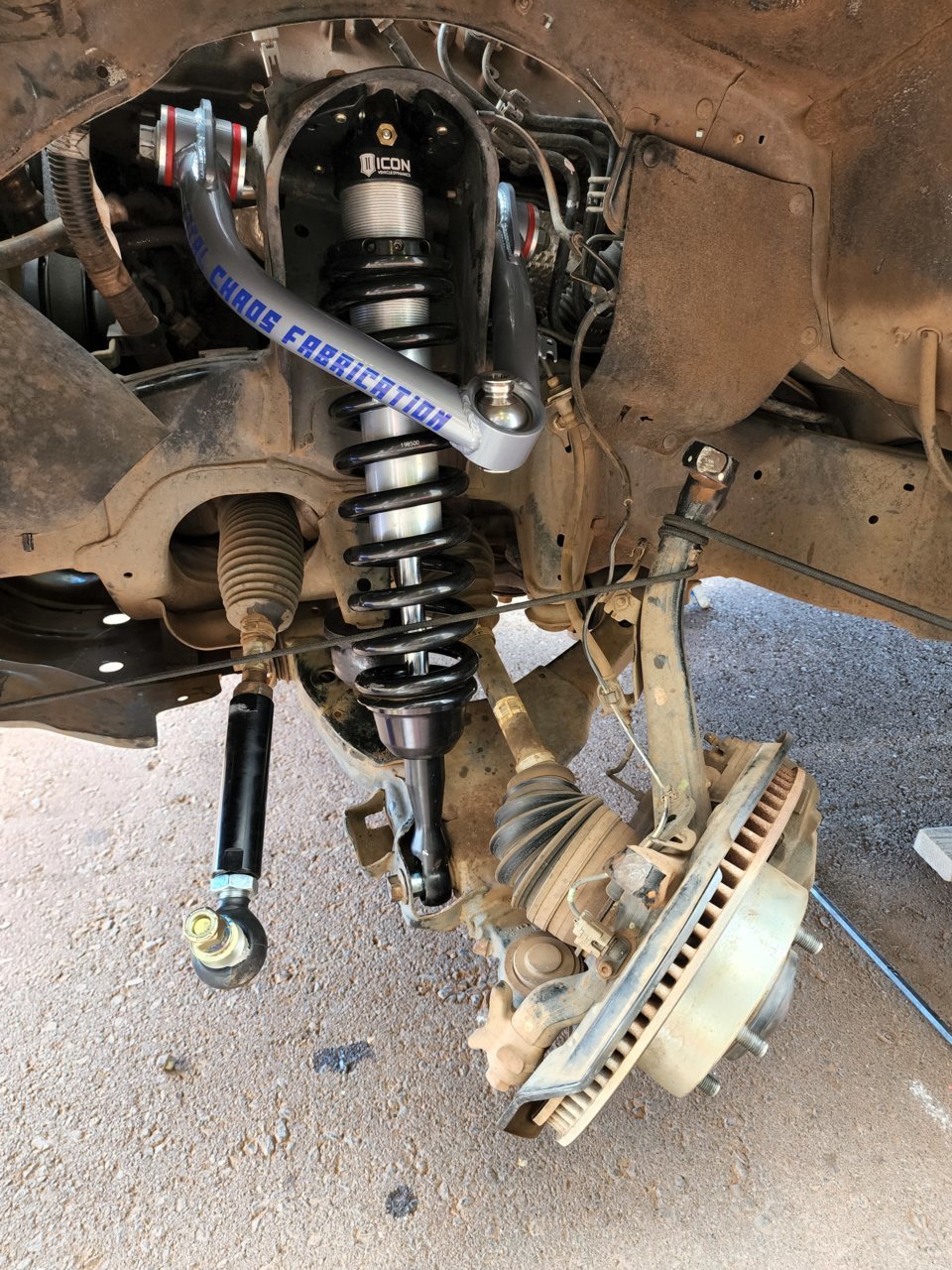

    Finally installed the icons that just got back from being serviced under warranty for a leak, along with some coachbuilder tie rod ends and total chaos uca's. Stop tempting me to upgrade other stuff now guys, just stahp.20220821_131448.jpg 20220828_144542.jpg 20220828_144530.jpg

    Yikes...that looks like a rat nest. Very good that you're tackling that!

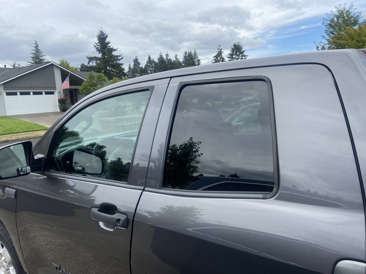

    All cosmetic so far see my posts in 2nd gen Black out chrome in progress….
    Pulled vinyl from B pillars. Much better!

    Any issues how’s the journey been?

    Steady and constant performer. Only routine maintenance and service. No real issues except failure of the clear coat. It convinced me to get the 2020. I have had my best success with Toyota - far better than any other brand (the others include GMC, Ford, Jeep).

    Excellent look!

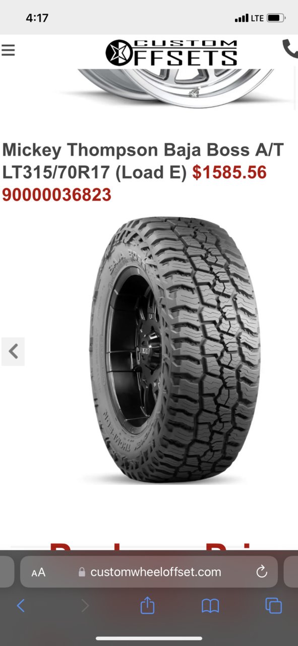

    Little update, The wheels came in today and I just can’t do it! I like the finish but the face profile is convex! WTF! Flat or Concave is a minimum expectation for a good looking wheel. Really disappointed but Discount Tire is amazing so they are sending them back. I’m going with a different wheel instead.

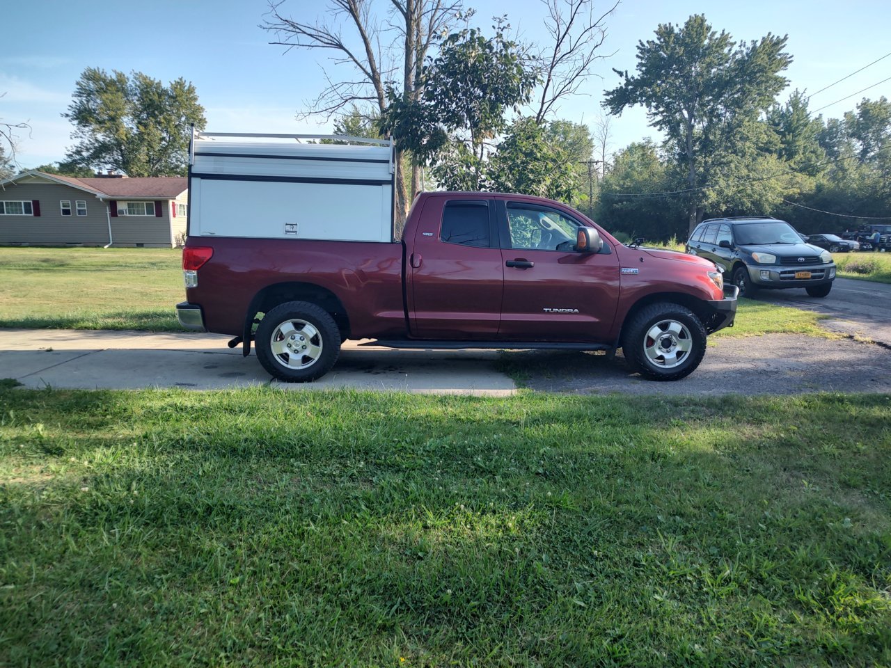

    Ha ha, At first I thought it was a shed in the yard behind your truck and that you parked perfectly in front of it and then I realized it’s not. It’s an actual cap! Your not using it to Kidnap are you?

    HAHAHA ! ! No, I want to try something other than sleeping on the ground when camping. LOL
    It's used, so cheap.
