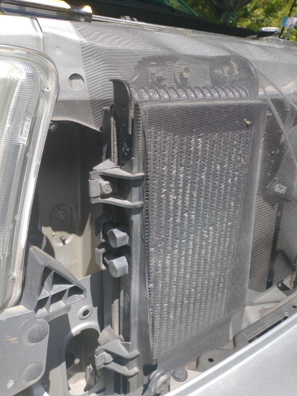

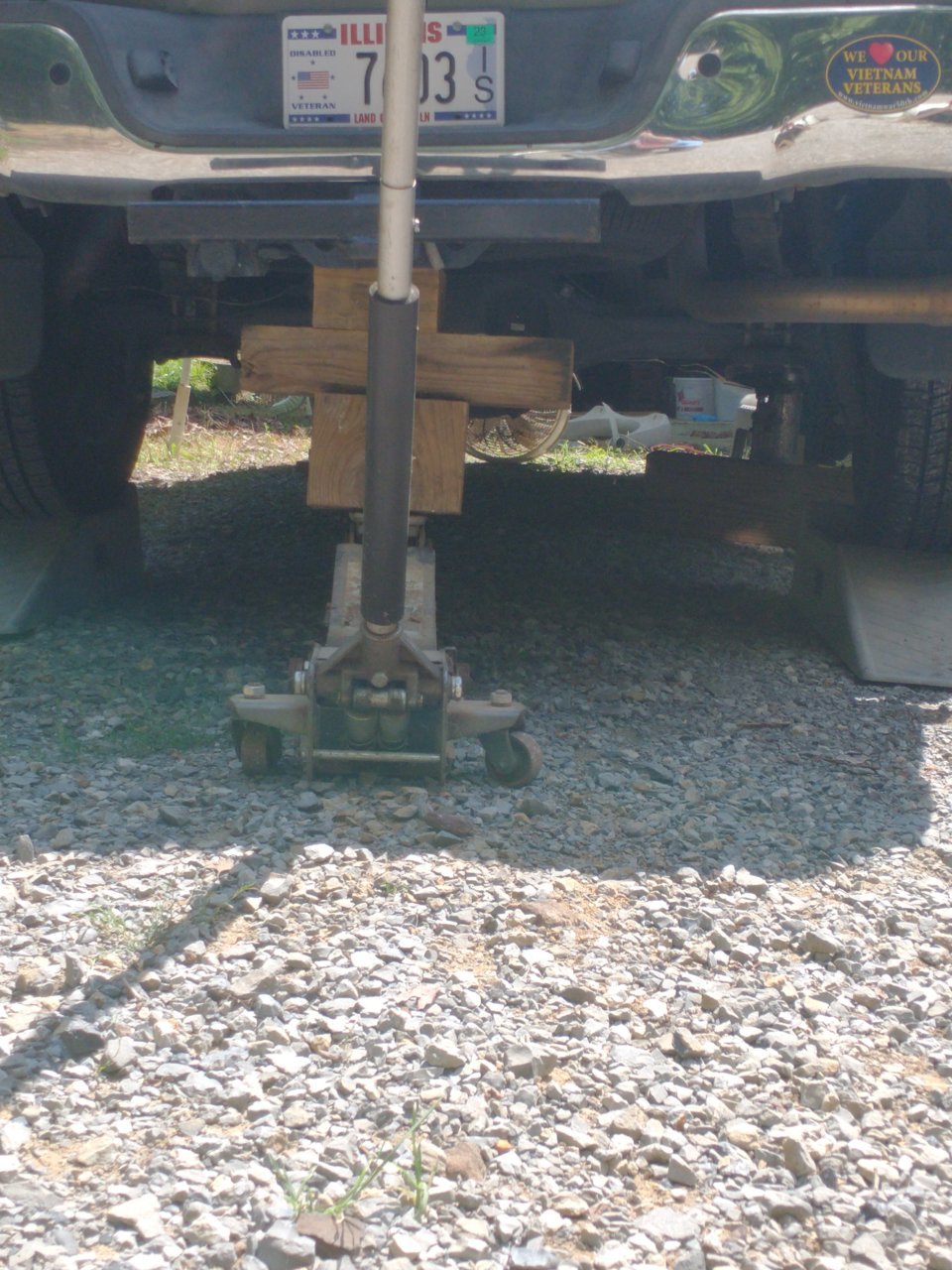

    Leveled up the truck in order to do the transmission service tomorrow:Levedout.jpg
    Here's the factory cooler on the 08:FrontofTC.jpg

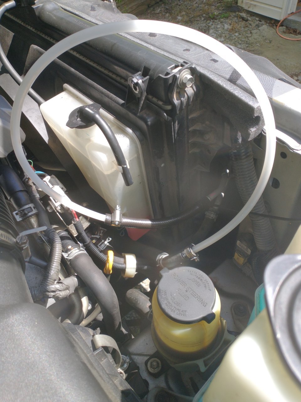

    Here are the connections in the engine compartment:Back of TC.jpg
    Here is how i intend to determine flow in the AM:TCflowTest.jpg
  3. Aug 17, 2022 at 6:46 PM
    Retroboy1989
    Retroboy1989 'Course it's 4x4!
    Mar 9, 2021
    #60209
    1,385
    Northern Utah
    2012 SR5 TRD OR (prev) 2025 SR5 TRD Rally (now)
    Wow, that is a very different design. From the later trucks.

    The fluid seems not to be plumbed thru the radiator either, which I'm not used to..I almost want to add another..some day maybe.

    Finished the trans service...
    For the final check, I let the trickle go untill was just a bit less than what he shows in this vid, which is more than I've seen in other vids...
    all collected, the amount I put back in seems to be about 2qts more than extracted....
    Tomorrow, more snooping to try and determine where the drive-line vibration is coming from.
    On Edit: If you have this trans cooler, it's the top pipe that you want to connect your discharge tube to.
    On Edit 2:....I realized early this am, that the reason I seem to have the extra fluid in the system, is because I top off the used jugs with the old fluid...which is about right!
