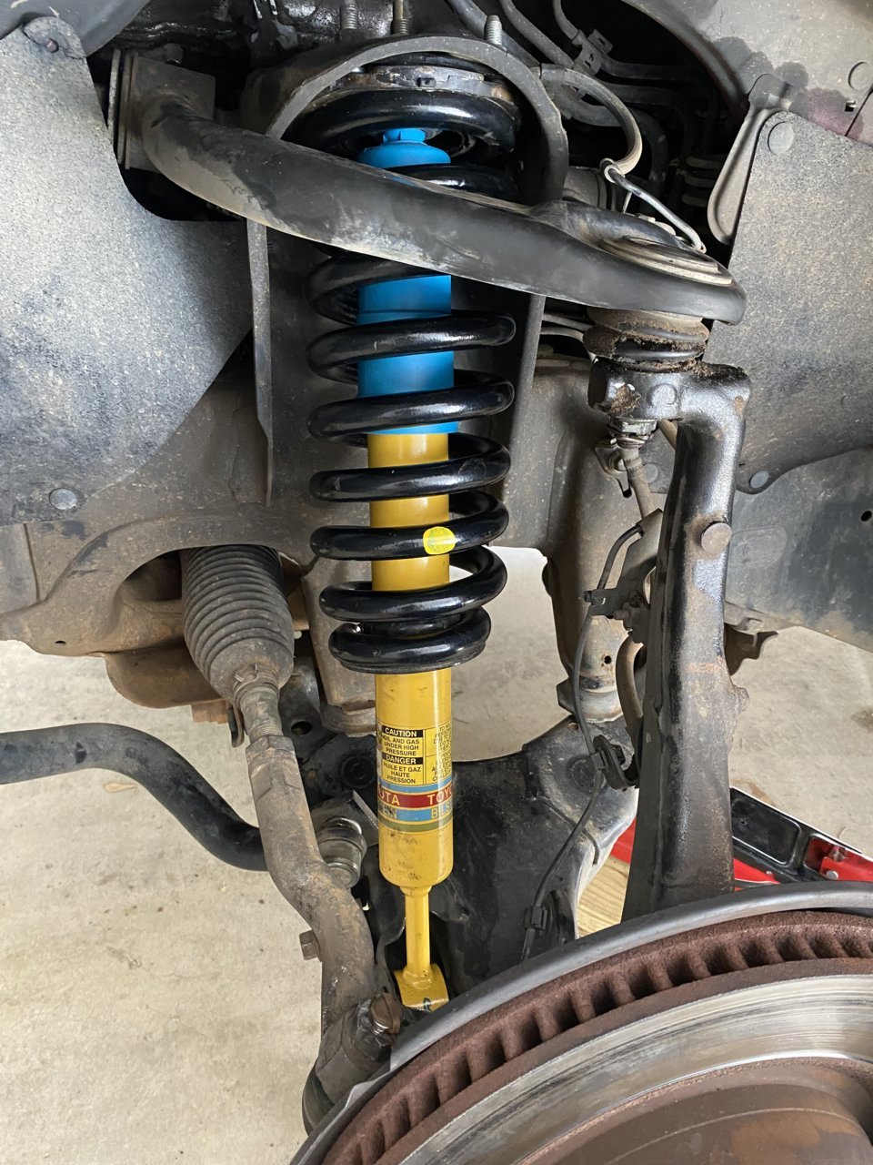

    Replaced the front shocks so she’s now sporting four slightly used Bilstein’s. The Haynes book of lies seems to think that all you need to do is remove the lower bolt and four uppers and the unit will come out. Yeah right….:mad:
    Letting go top knuckle joint didn’t help much, marginally better with the steering tie rod end removed but it wasn’t until I dropped the stabilizer link that I could actually get the old out and the new in.
    Fixed the slow puncture in one of my reasonably new front tires.
    And ordered new stabilizer links as one of them was a tad on the rattling side! Guess what’s on next weeks to do list…

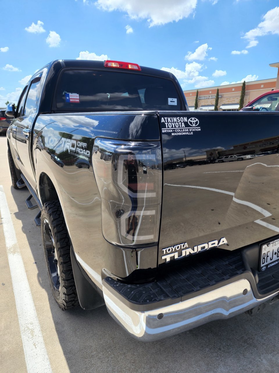

    Did my rear lights finally on my 2nd gen. Shame Morimoto never made a pair for the 2nd gens. Kinda wanna do the 3rd brake light but I heard it was a PITA. Rear Light.jpg

    Look good!

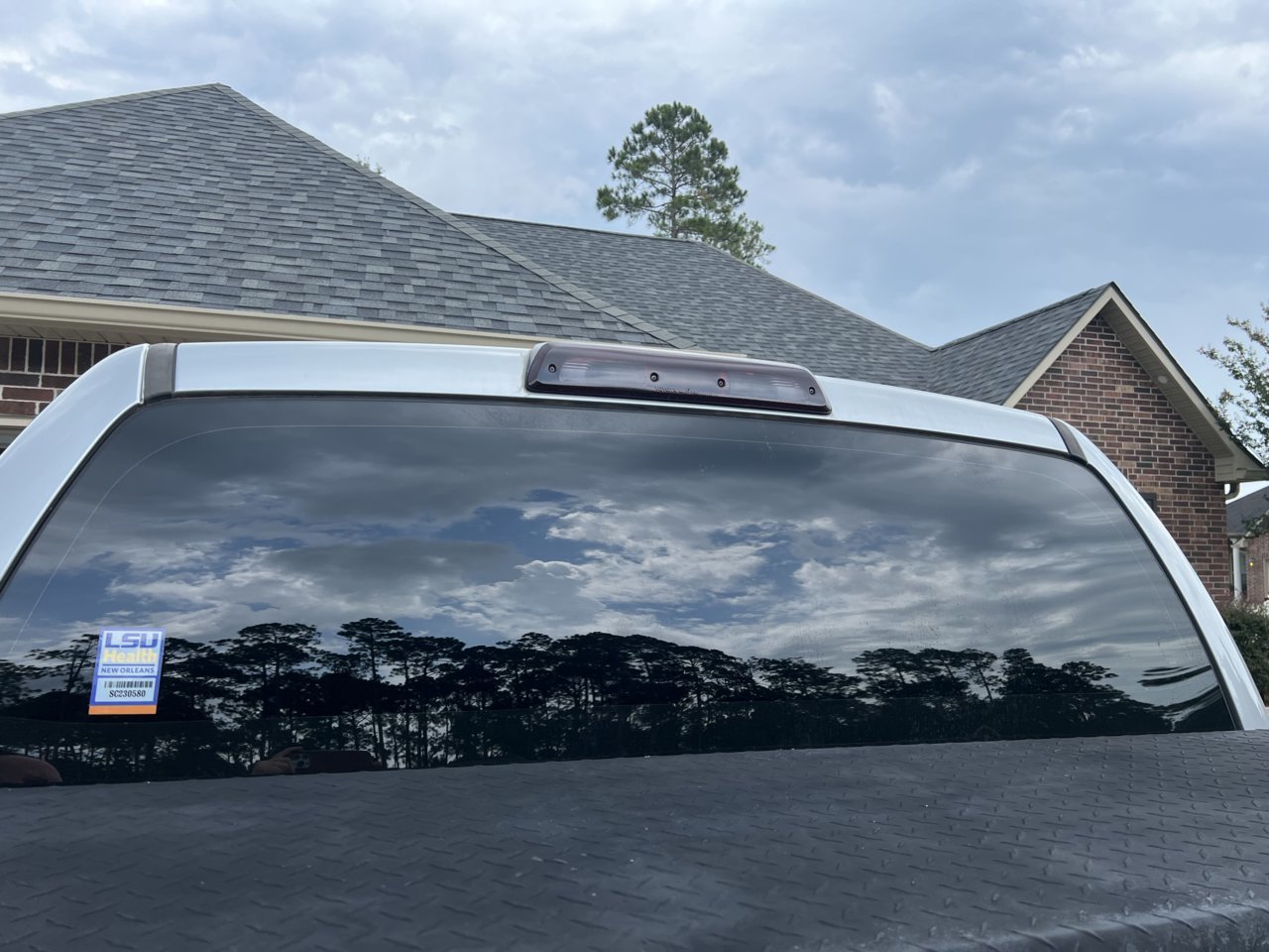

    Yea I heard it can be a pita to swap out. I ended up buying a spare cover and just tinting it myself. Turned out alright

    I heard something about nuts getting lost and headliners getting all fudged up. I was like nope... I'm good... :bananadance:

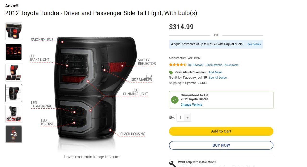

    Nice! Looks great. What are those?

    It's all LED, does not use any of our old bulbs. They look great, now I have to see how they do when it rains... They have resistors so no hyperflash even with Morimoto fronts.

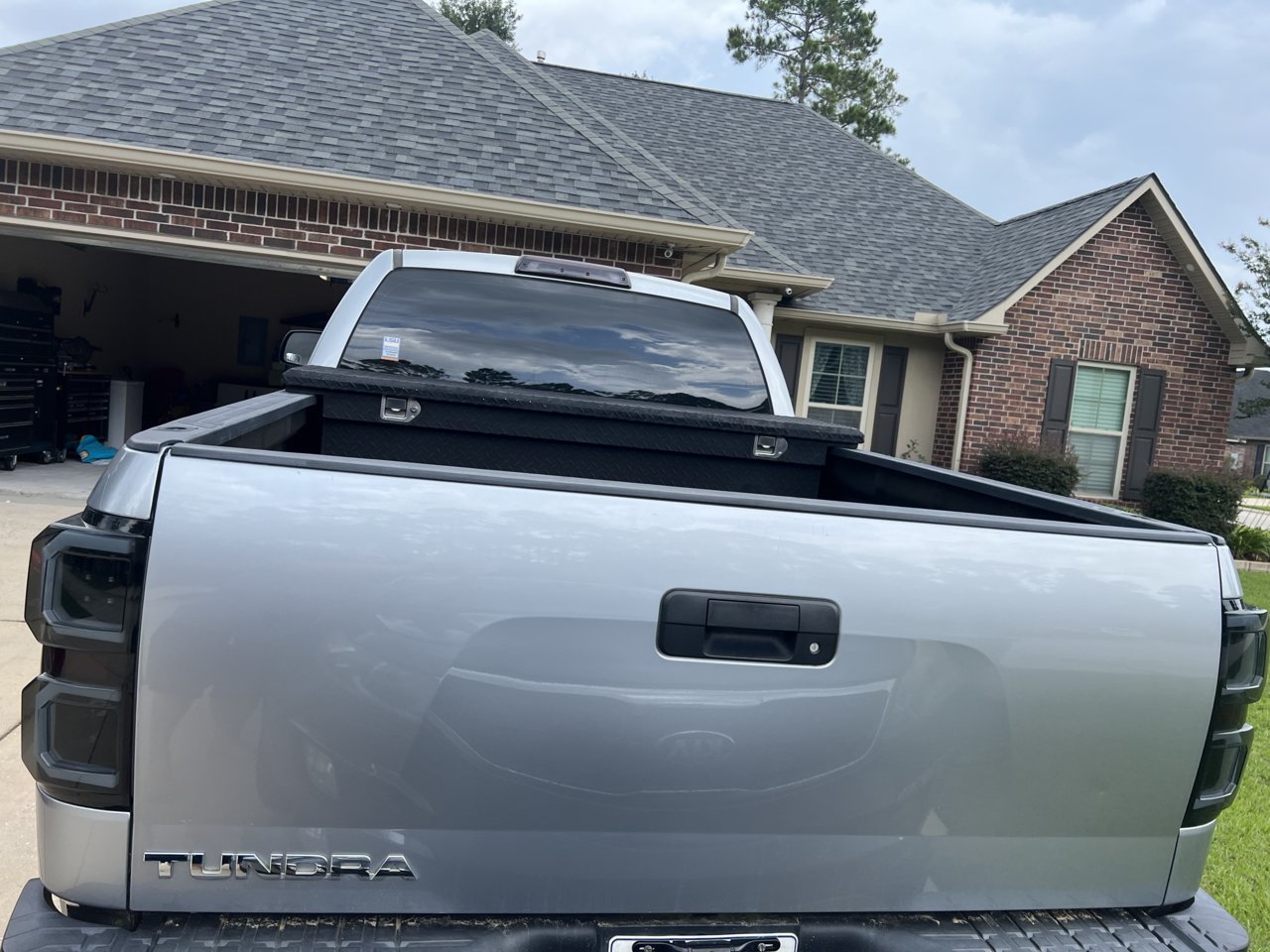

    The cover comes off with 4 screws. Then just tint it and put it back on. I installed some bright leds in there as well since i tinted it darker
    I did mine myself, not perfect, but good enough not to deal with the headache of having to swap it out!
