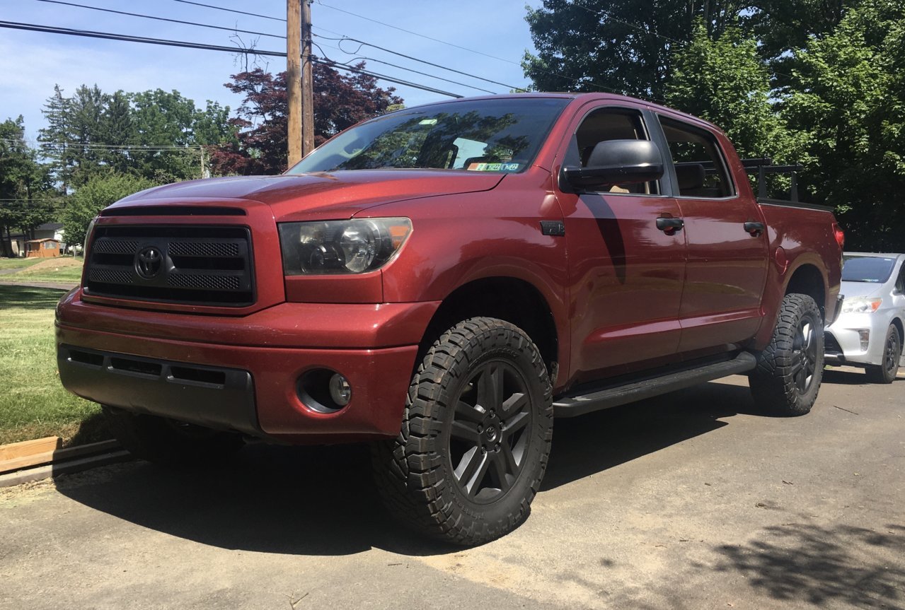

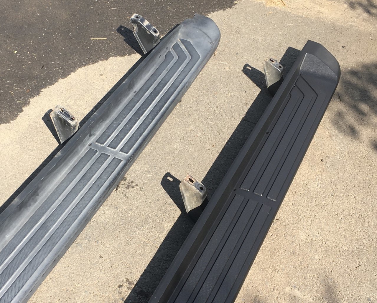

    Finally got the 35x11.50 r20 Ridge Grapplers on and refinished the oem running boards.

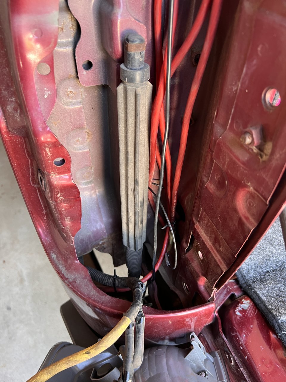

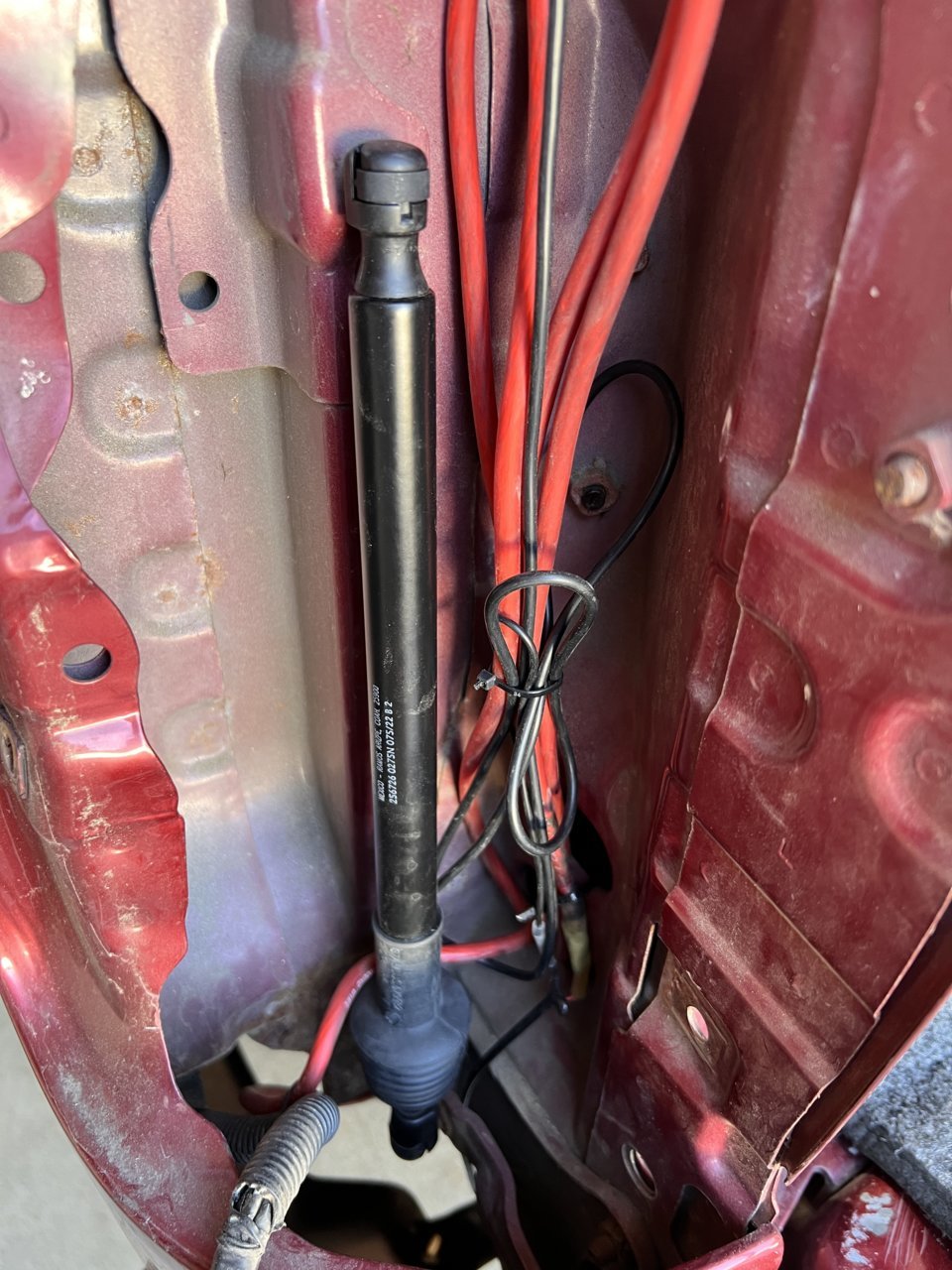

    I saw in another thread that the tailgate isn't supposed to drop at full speed until the last 1/4" and then bounce back up! Also lifting the tailgate can be a one-handed job.
    So I replaced my tailgate assist strut which apparently we all need to do after about 10 years.
    The part is 4B-256726 Stabilus and the job takes 5-10 minutes. T30 to remove your driver's side brake light (pull it out not back). Then pop off your old strut with a flathead screwdriver. Close the tailgate and pop the new strut on.
    Before & after:
    I made a video but the site won't let me upload it so just image a tailgate that slides down luxuriously.

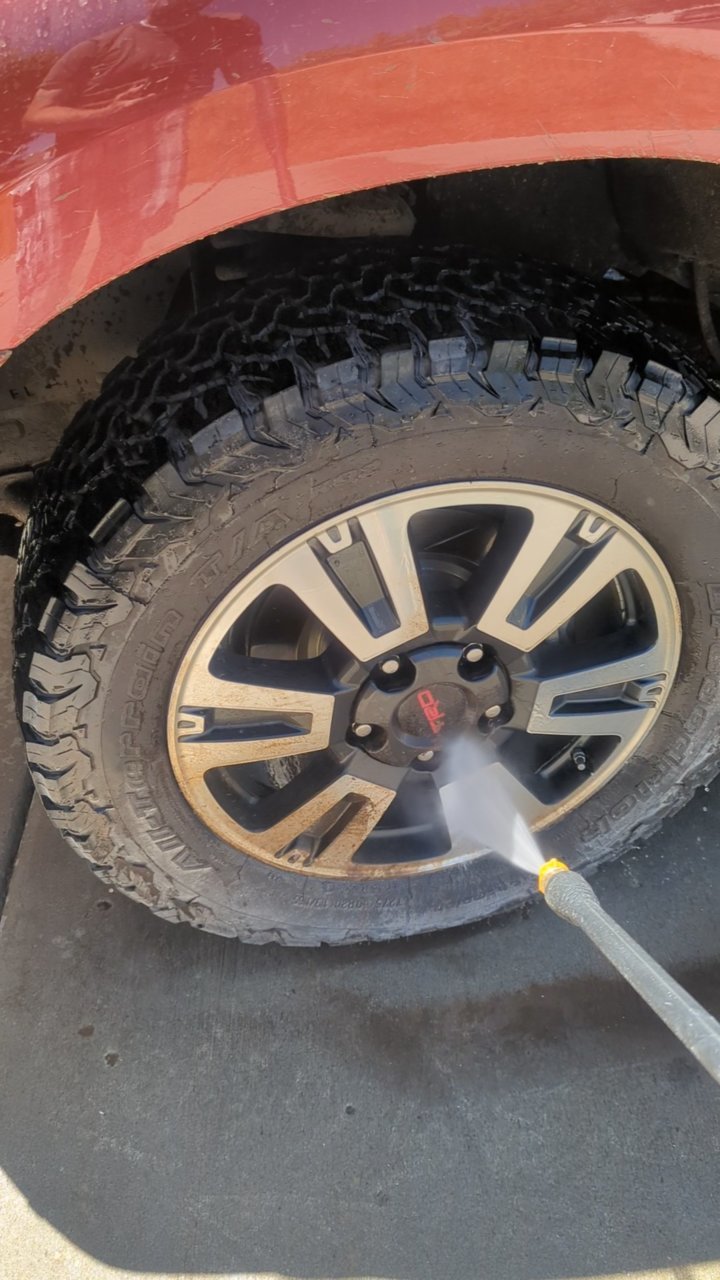

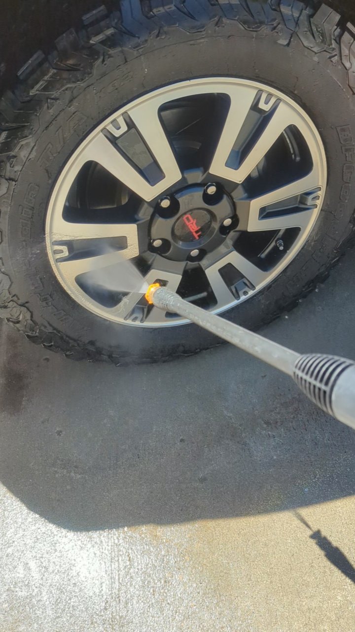

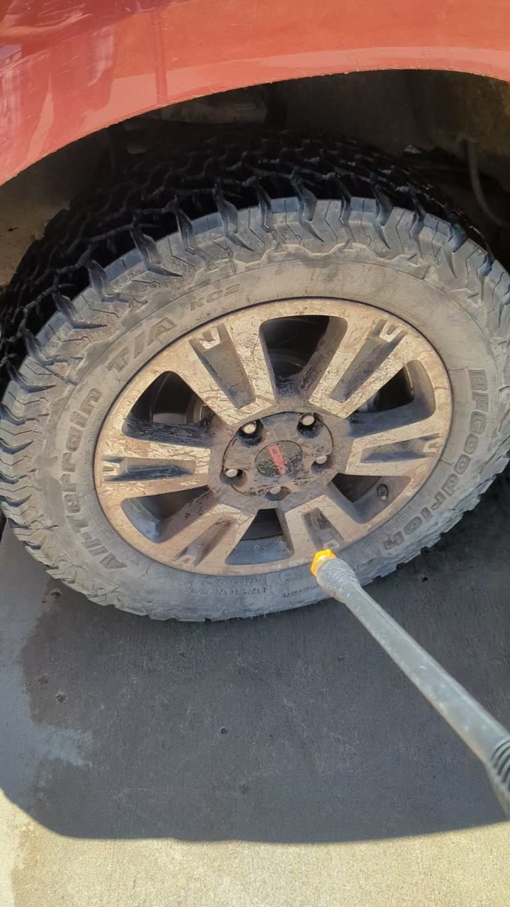

    Got back from a muddy camping trip on Sunday.
    Celebrated the 4th by washing American mud off my French tires mounted on Japanese wheels.

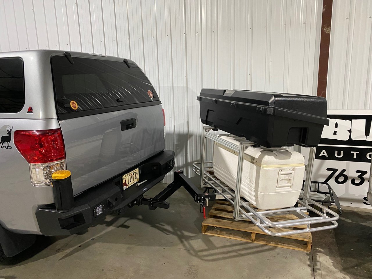

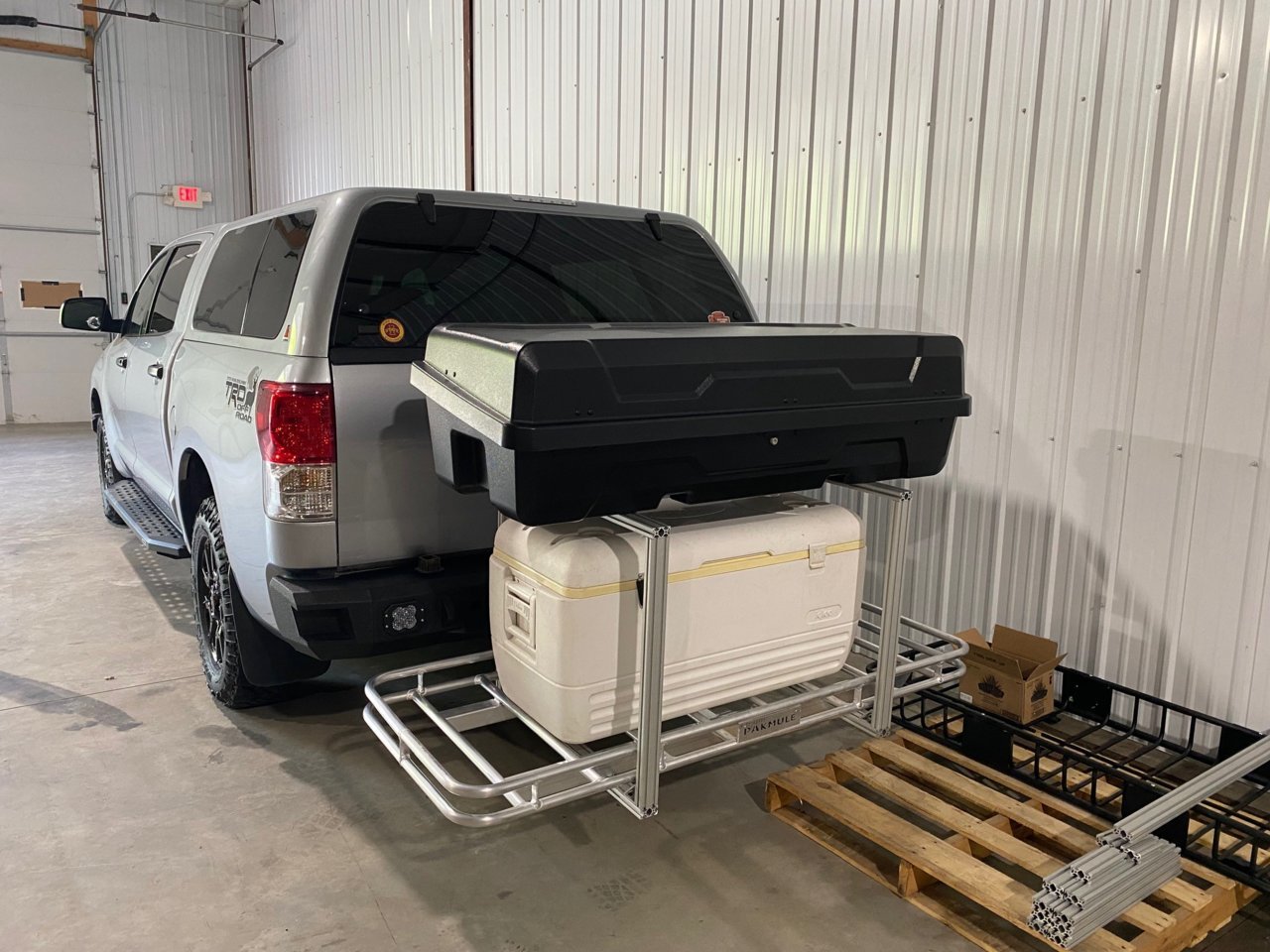

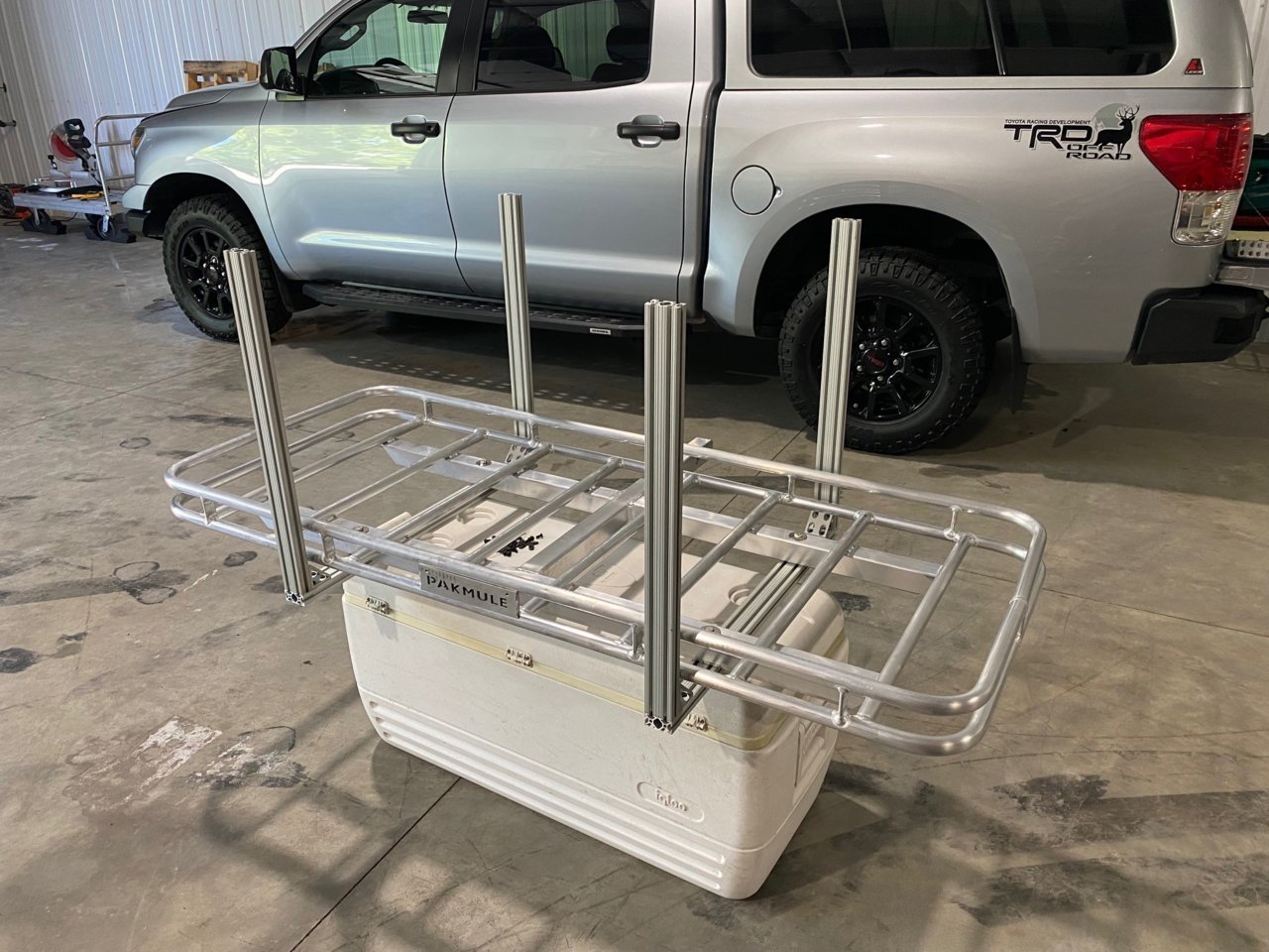

    Made my hitch rack more functional. Added an external rack so I can use my Yakima box on top and coolers underneath. I had a ton of extra 80/20 extrusion from the bed rack that I removed, so this is the replacement. I forgot to order additional hardware in time, so this isn't in its final form, but very close. This should create a lot of space for hunting season!

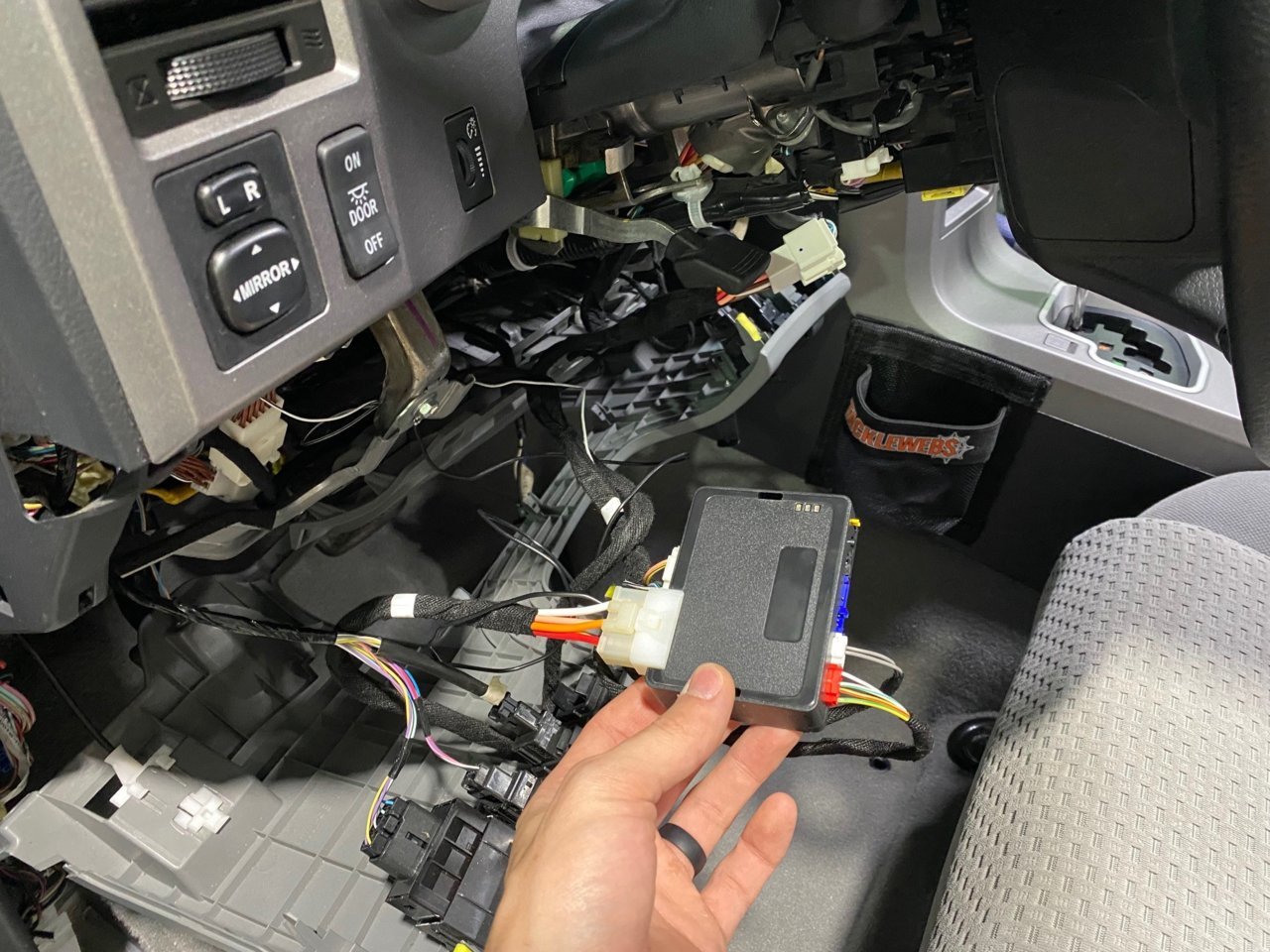

    I also added a Start-X remote starter. Easy install overall, even for someone who doesn't like wiring. All plug and play and works like a charm!
    Edit: Here it is in final form. Topped it all off with a swingout so you can easily access the bed. Very very handy!

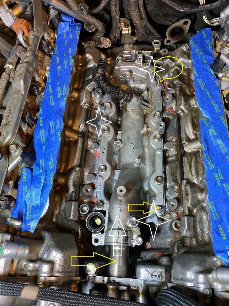

    Got it back together and during the addition of the 3rd gallon of coolant, coolant started pouring out of somewhere unseen. I closed the shop door and went to celebrate the 4th. FML

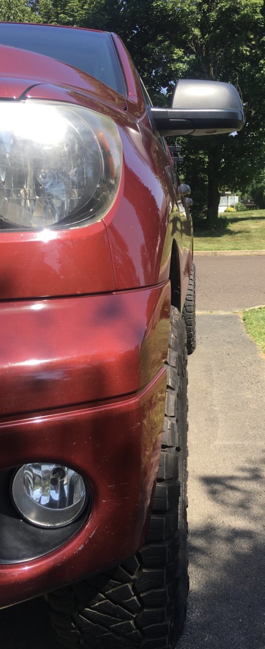

    I have Bilstein 5100’s in the front at the top setting and @Toytec Lifts shackles set at 1.5” in the rear with Eibach 1.5” shocks. Also did the carrier bearing drop. And I have 1.25” Spidertrax spacers all around. Gives me about a +28 offset with the oem 20’s. Removed front mud flaps and still have to push front of the wheel wells in a little. Plenty of uca clearance and the tires don’t touch the cab mount.
    Photo for poke reference.

    coolant started pouring out while running or while sitting off?

    It was off, hadn't fired it up yet. I'm thinking it's the cross over pipe...but we'll see upon teardown. Starting that after work later today.

    Yep, probably one of the upper pipes on the radiator were left off? Better case that the truck was off and it started coming out then if it built pressure and started leaking

    Negative. Crossover pipe goes from back of water pump housing to the valley plate/heat exchanger. The pipe has o-rings on both ends that can easily shift when fitting it. No radiator hoses disturbed doing this repair.
    Big yellow arrow points to the pipe in question

    oooo haven't actually done that job, yikes, you have to take the intake back off? Or can you weasly your hand in there to slide the hose off?

    If it is in fact, the crossover tube orings leaking then the intake will certainly have to come back off & the valley plate as well. Most likely I did the same thing as the OP did here and will have to basically do the whole repair again.
    https://forum.ih8mud.com/threads/diy-coolant-valley-leak-repair.1240395/
