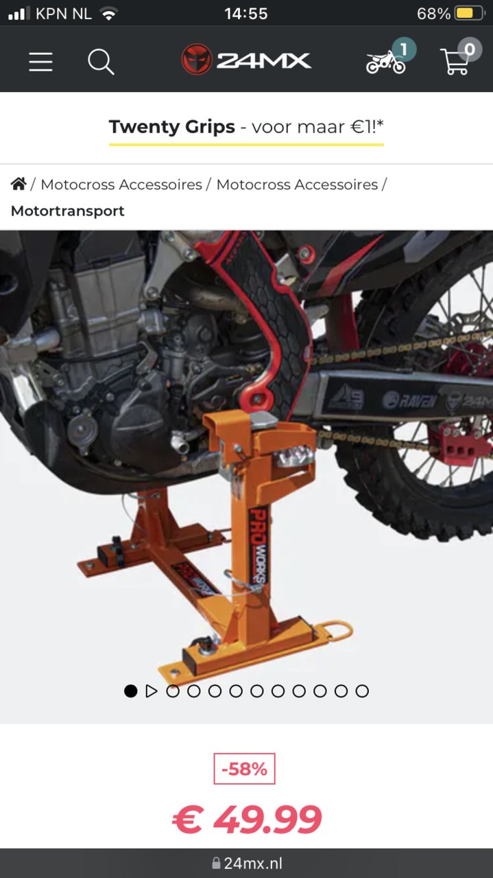

    Has someone mounted this quick load system for a dirt bike in the back of the tundra bed ? I just ordered them wondering if some one has some pictures …

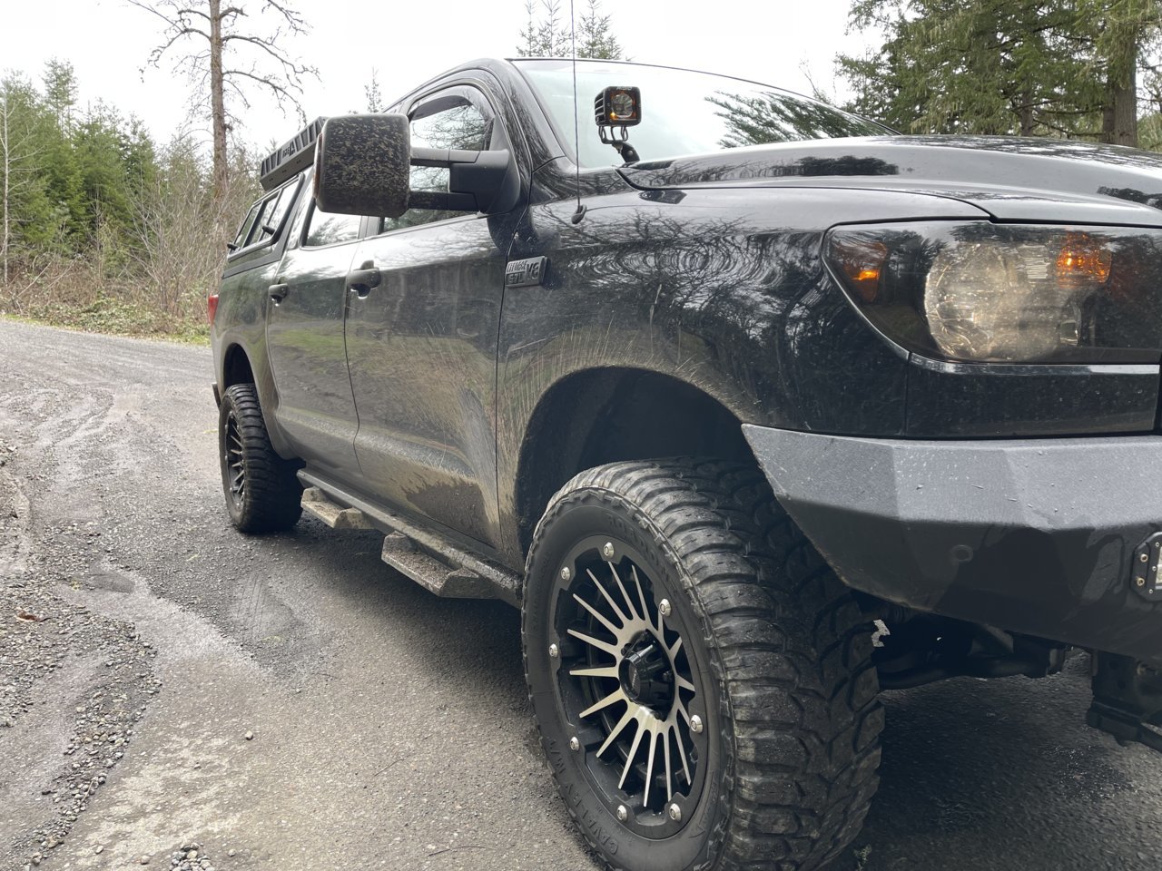

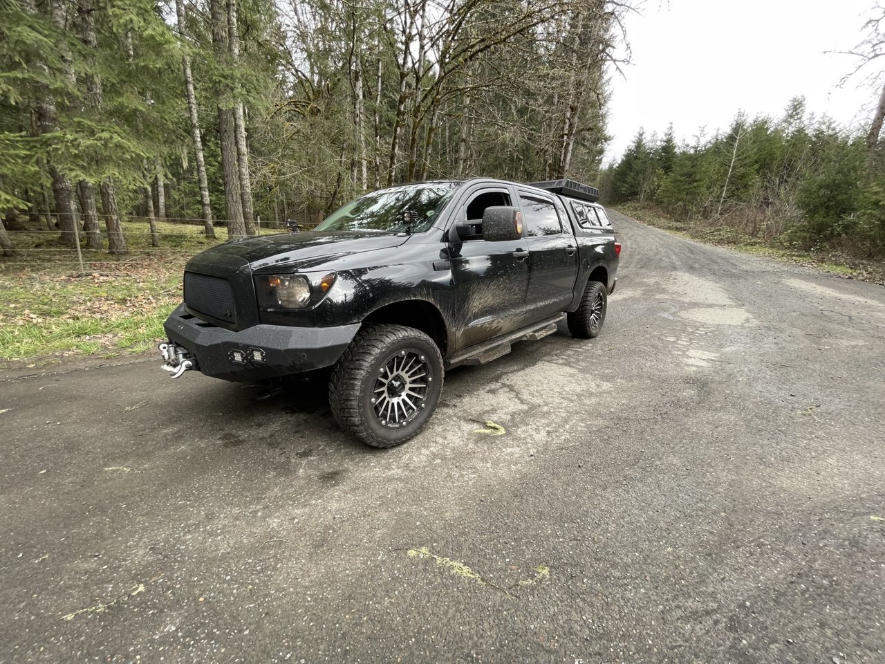

    I gave mine some exercise and a spa mud bath
    E78B80FC-0F47-436D-A7C0-0F9917B16C01.jpg 2C42A5ED-4127-488D-9C4A-EB2FB53219DE.jpg 5E582CB0-C57C-41E0-99F6-B055659762E2.jpg F5184FC4-07C4-4721-8074-ABB970692CCE.jpg
    oh yeah and upgraded my rotors to NeoChrome thanks to AutoLSD :rofl:

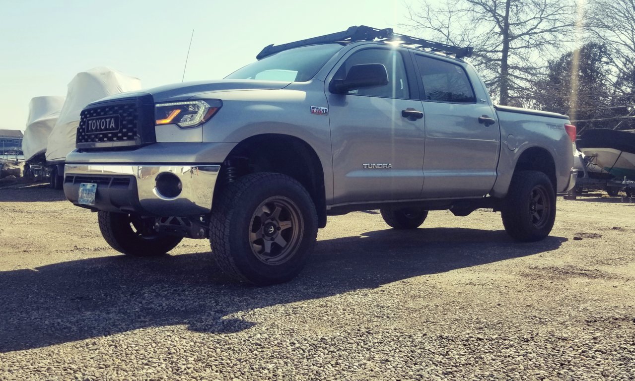

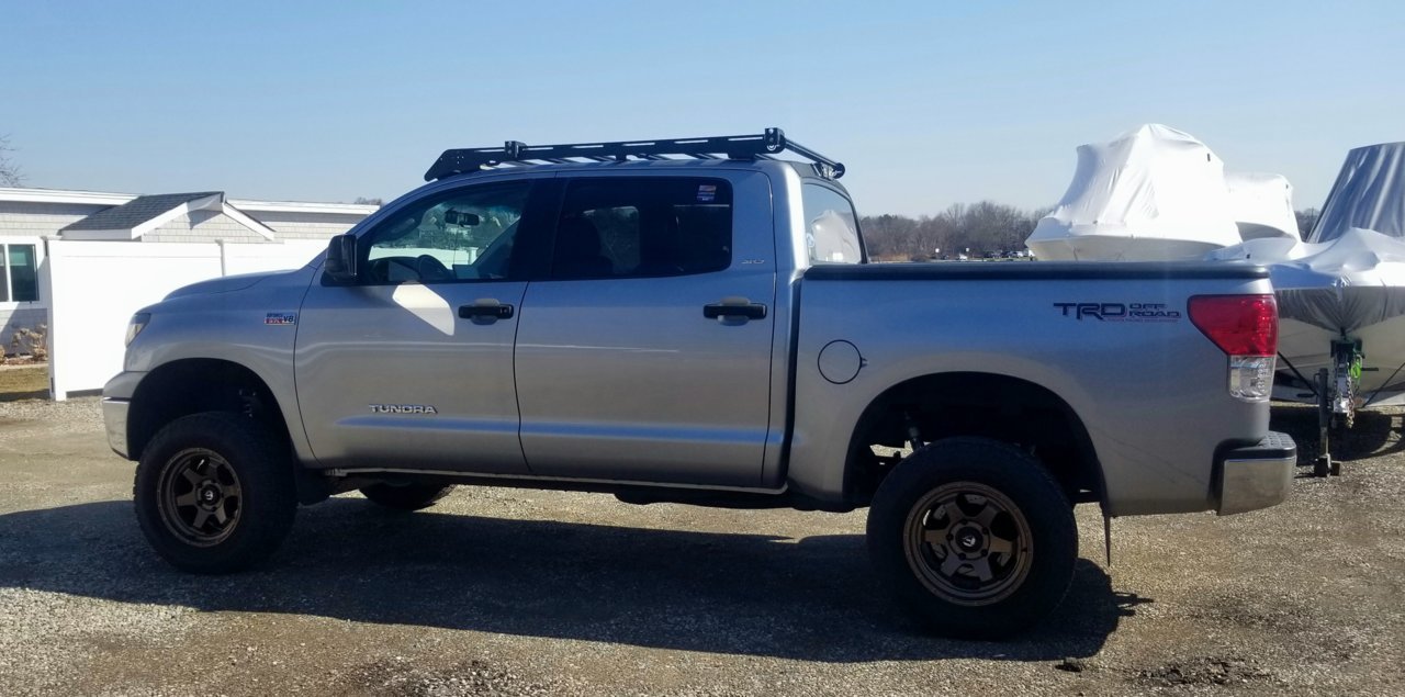

    Bed Cover, Liner, 2018 Tundra Wheels, Remote Start, Morimoto XB Headlights inbound. Just getting started...
    Right you are! Installed them on top setting and reused the existing coil. A little out of my comfort level, but it turned out in the end. Overall, pleased with the way it turned out. Haven’t driven it much, but the few miles I drove it to get an alignment done was much better than the factory shocks which make me want to :puke:.
    Picture before:
    …and after.

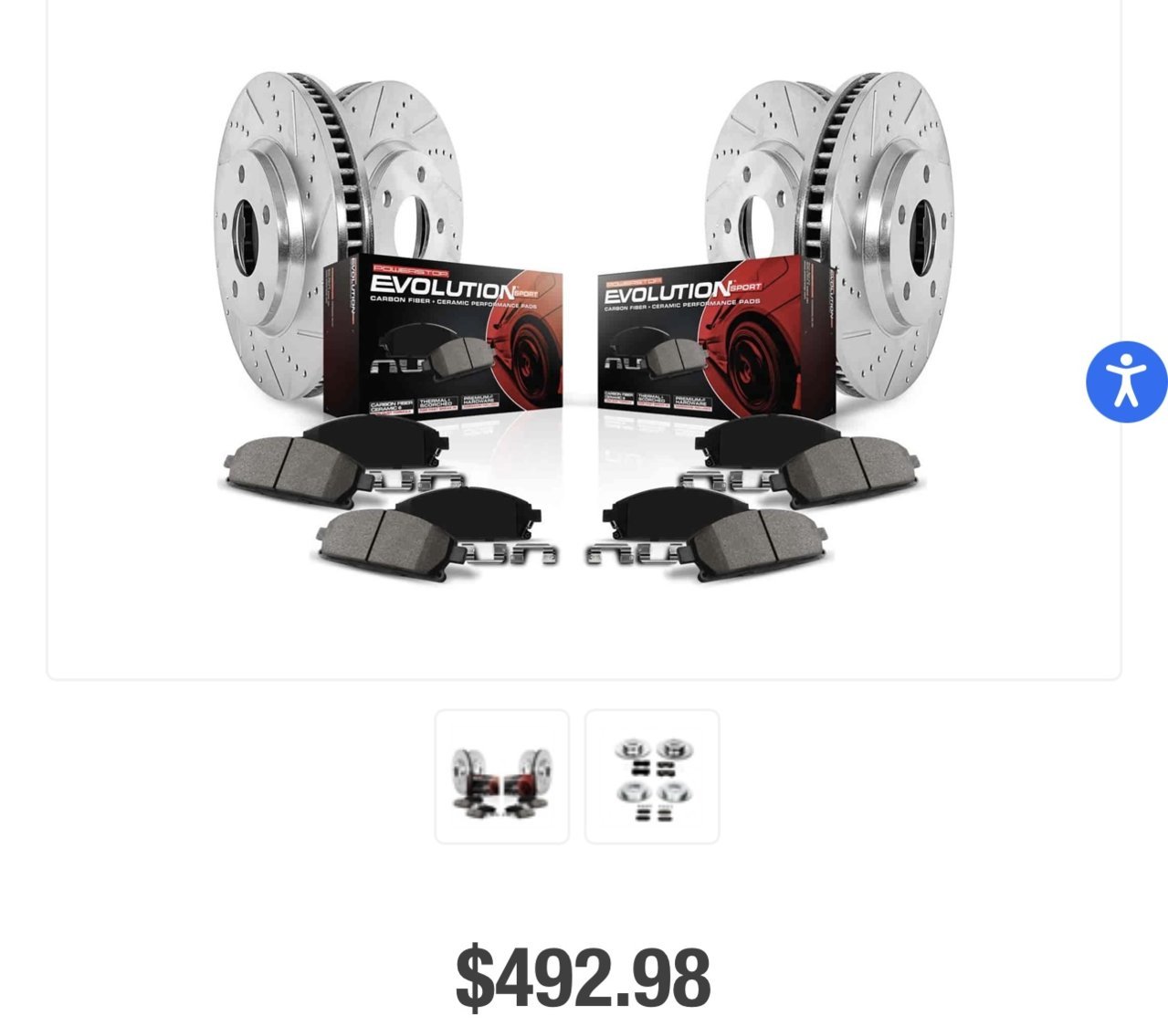

    Well following my last post ordered up "Power Stop high performance pads and rotors", kinda been needing rotors but did cheap pad slaps 7k ago and well ended up boiling the fluid and smoking a pad today. :(

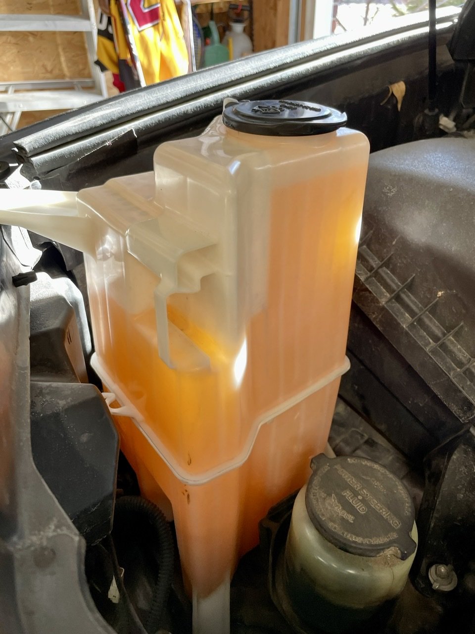

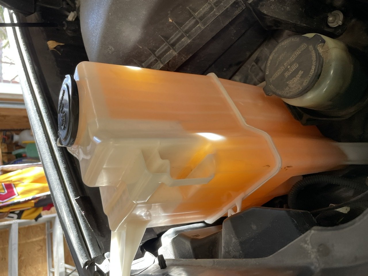

    Took out the washer fluid bottle. Drained the 11 years of mixed smeg. Cleaned it out and replaced with fresh rainex. First world problems!

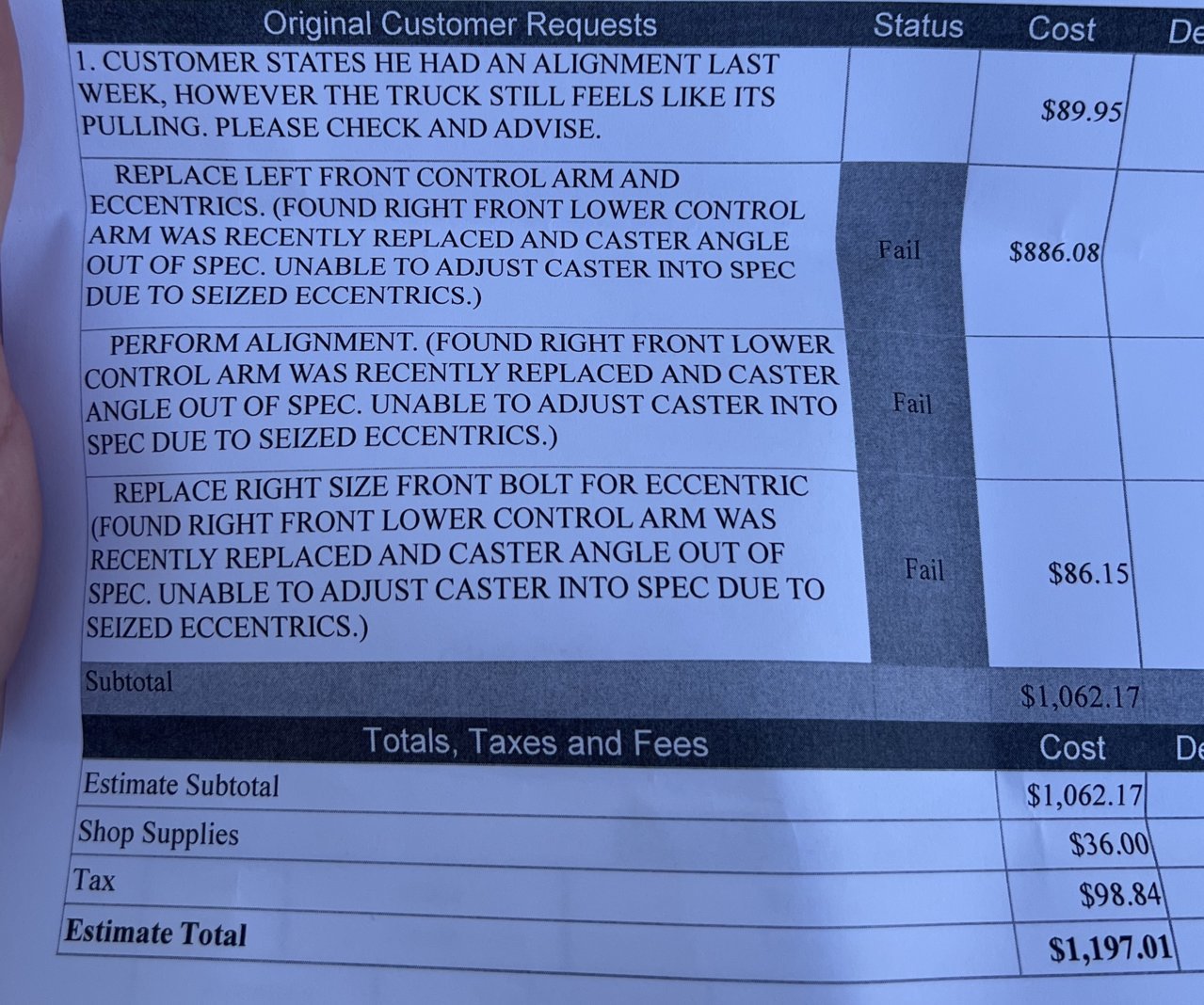

    Won't even lie, I'm a bit stunned. Need some advice.
    Just had rack and pinion replaced. Truck won't align, caster is off. This is a little stunning to me, I just had my dads mechanic align the truck a month ago when I replaced the LCA with 0 issues. Hard to believe the bolts would rust in a month (they didn't). I'm probably going to take it back to my dads mechanic and see if he can align it.
    Just wondering if anyones got any experience with something like this? With this estimate I'll be coming up on 4 grand for repairs.

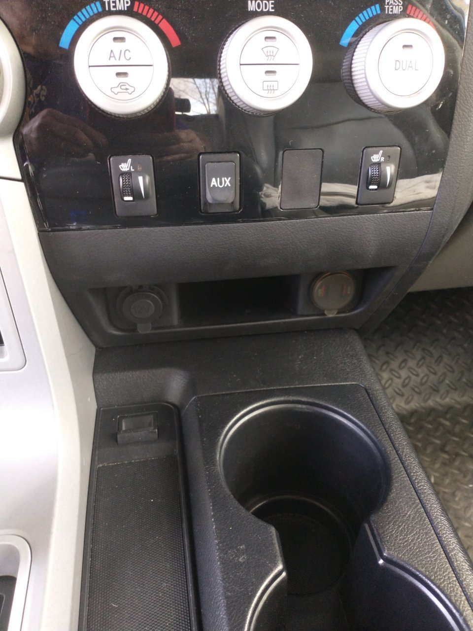

    Installed some new power recepticles.

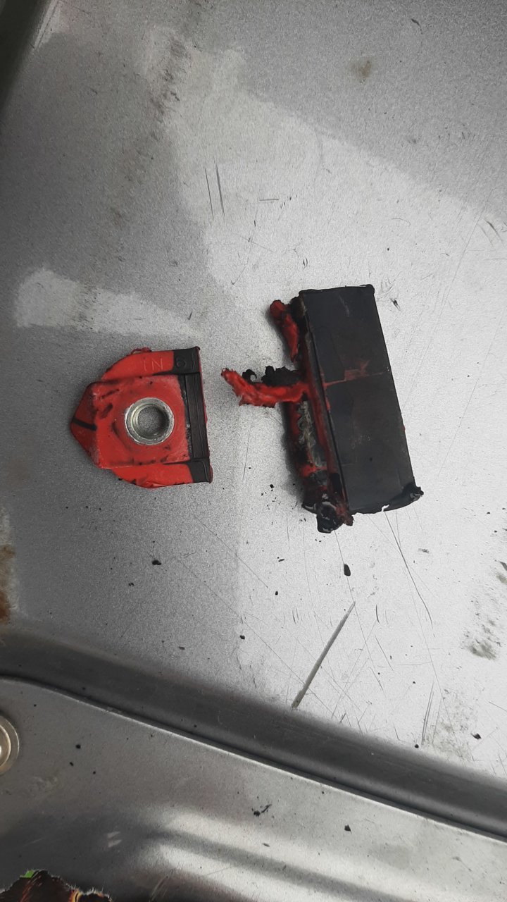

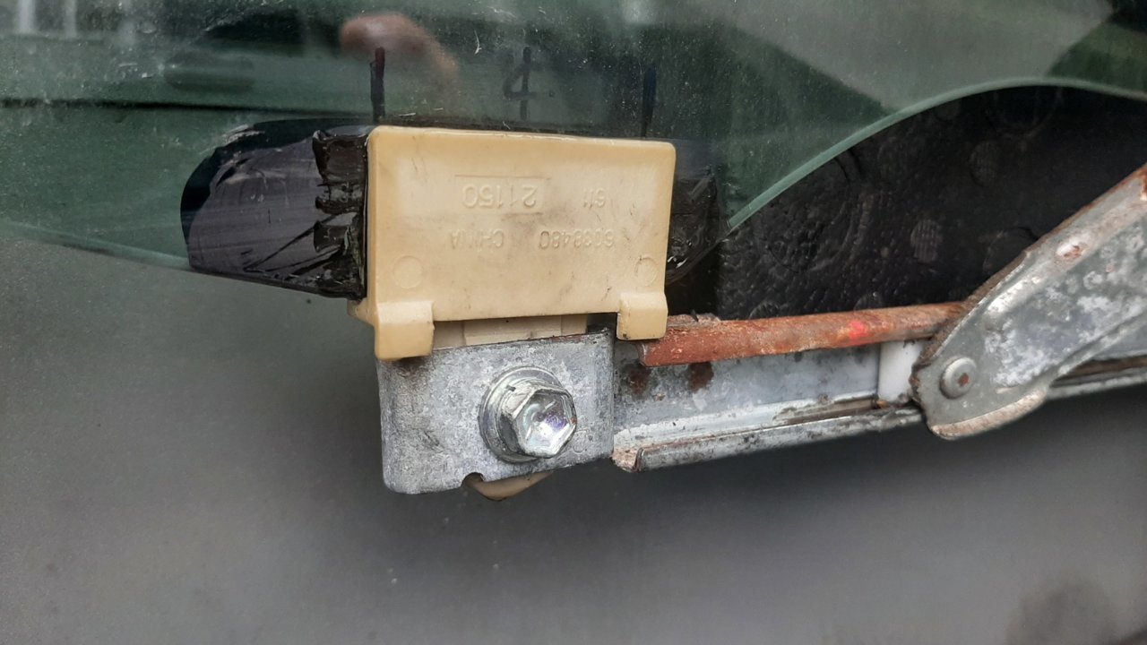

    Finally repaired my broken window mount.
    Melted the old one with a butane torch and scraped it off with the glass still in the door. Then glued a new mounting clip on.

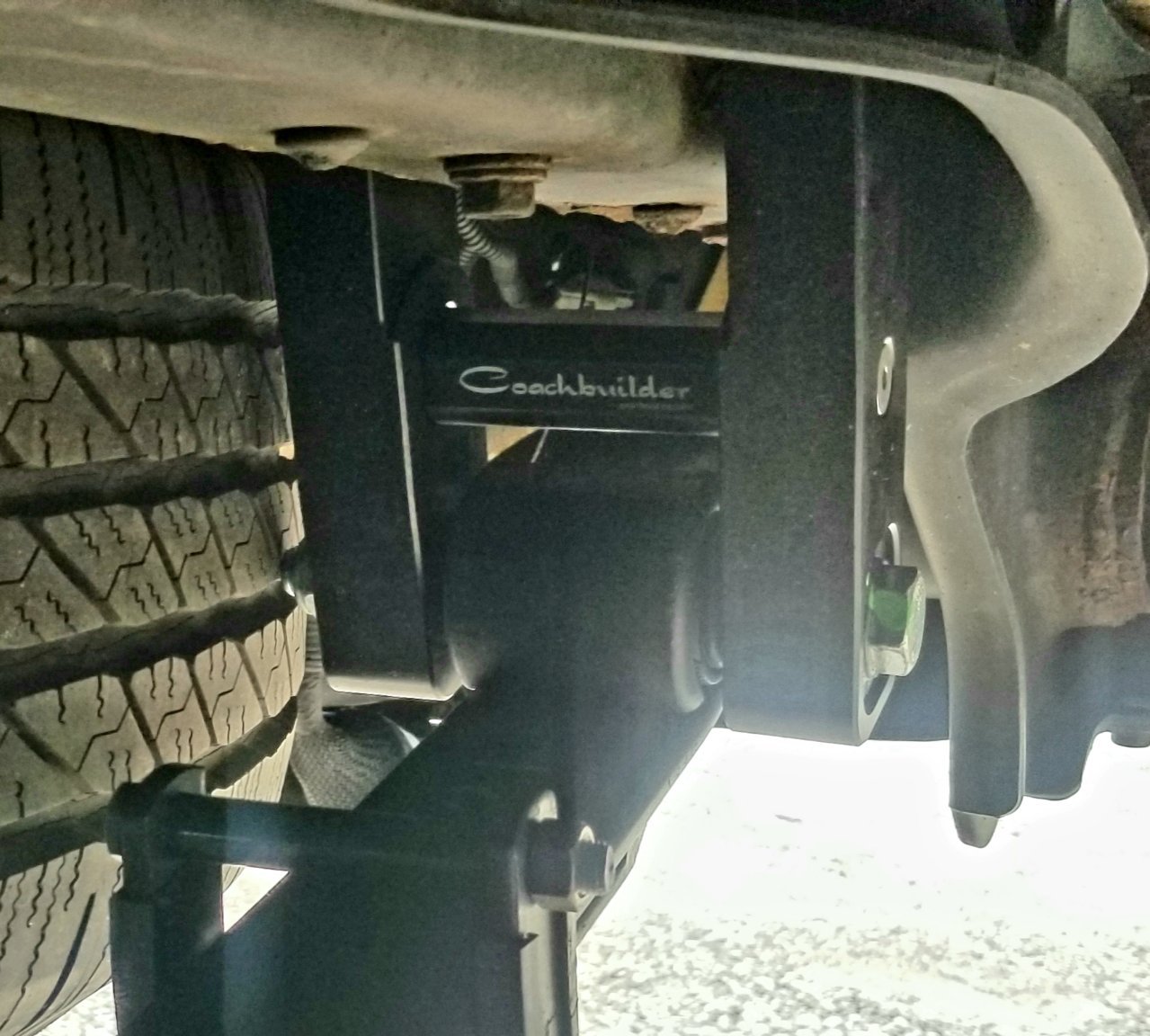

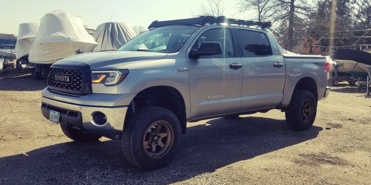

    Replaced the block from the BDS lift kit with Old Man Emu springs and coachbuilder +2" shackles. I was getting a bit of a sag in the back with the blocks and 11 year old springs, a bit hard to tell from the pictures but now I have a slight rake which is what I was trying to achieve. The customer support from Ekstrom Design was great, they couldn't have been more helpful.
    20220318_111423.jpg 20220318_111609.jpg 20220318_111503.jpg 20220318_111534.jpg

    definitely need a second opinion, what do they mean by seized eccentrics? Cam bolts?

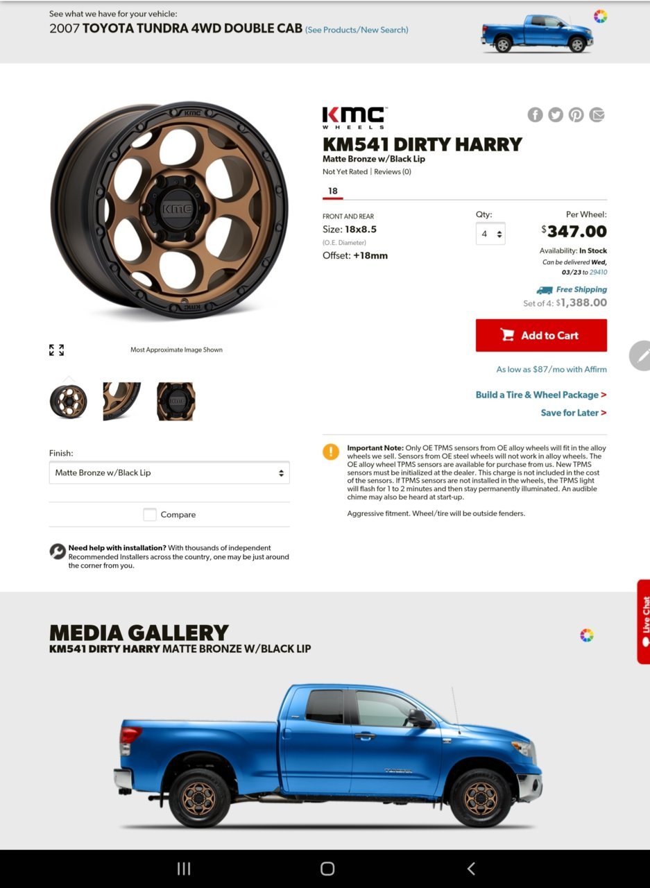

    Bought some new wheels.

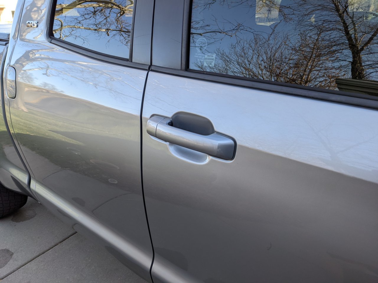

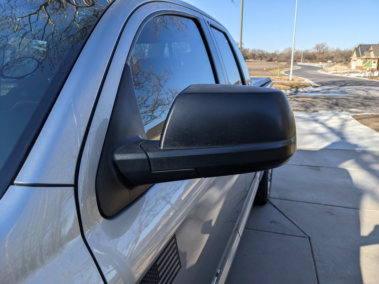

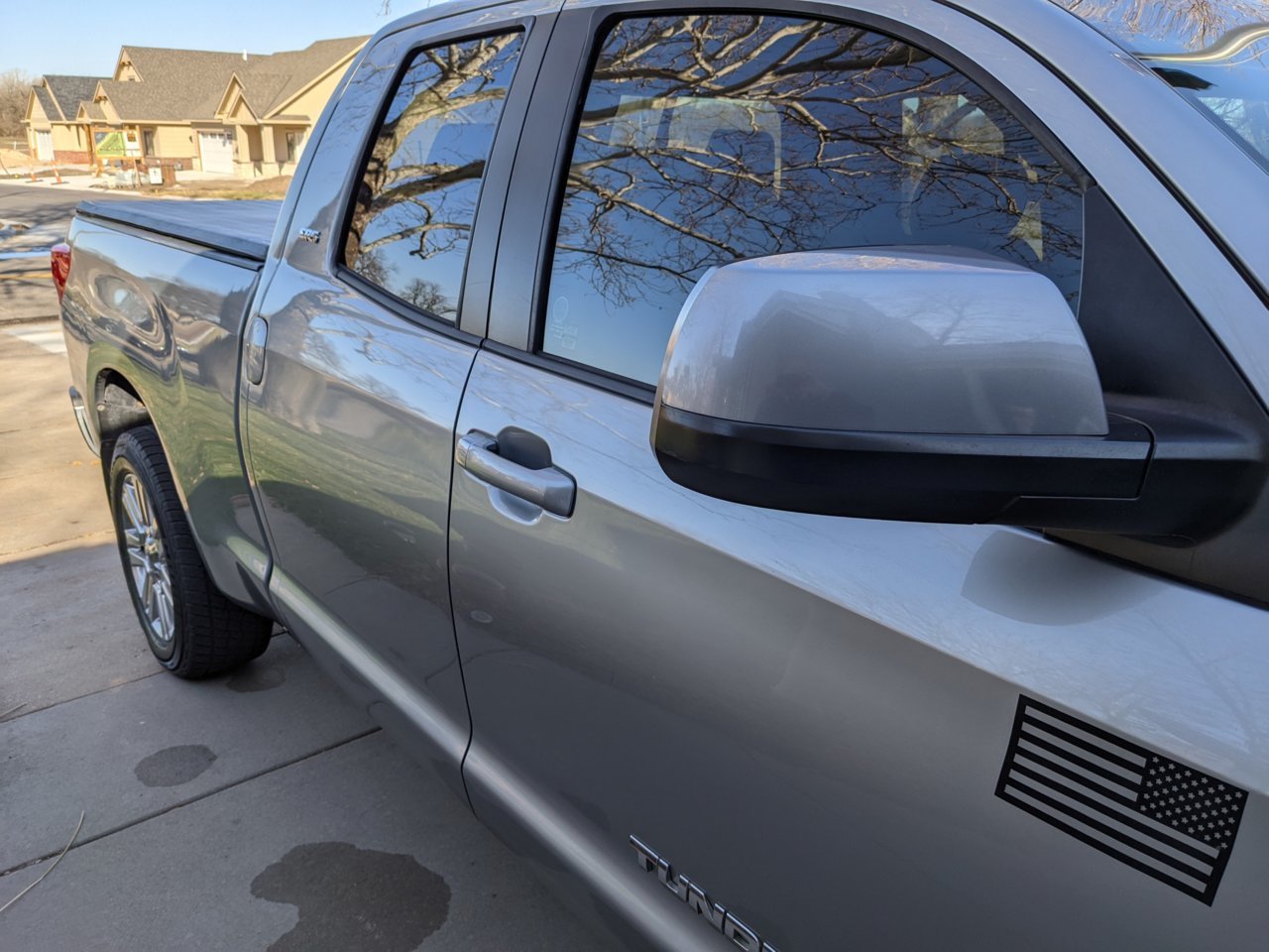

    Changed out the black mirrors covers for body match, body color matched handles instead of the black and and added a Toyota decal to the tailgate.

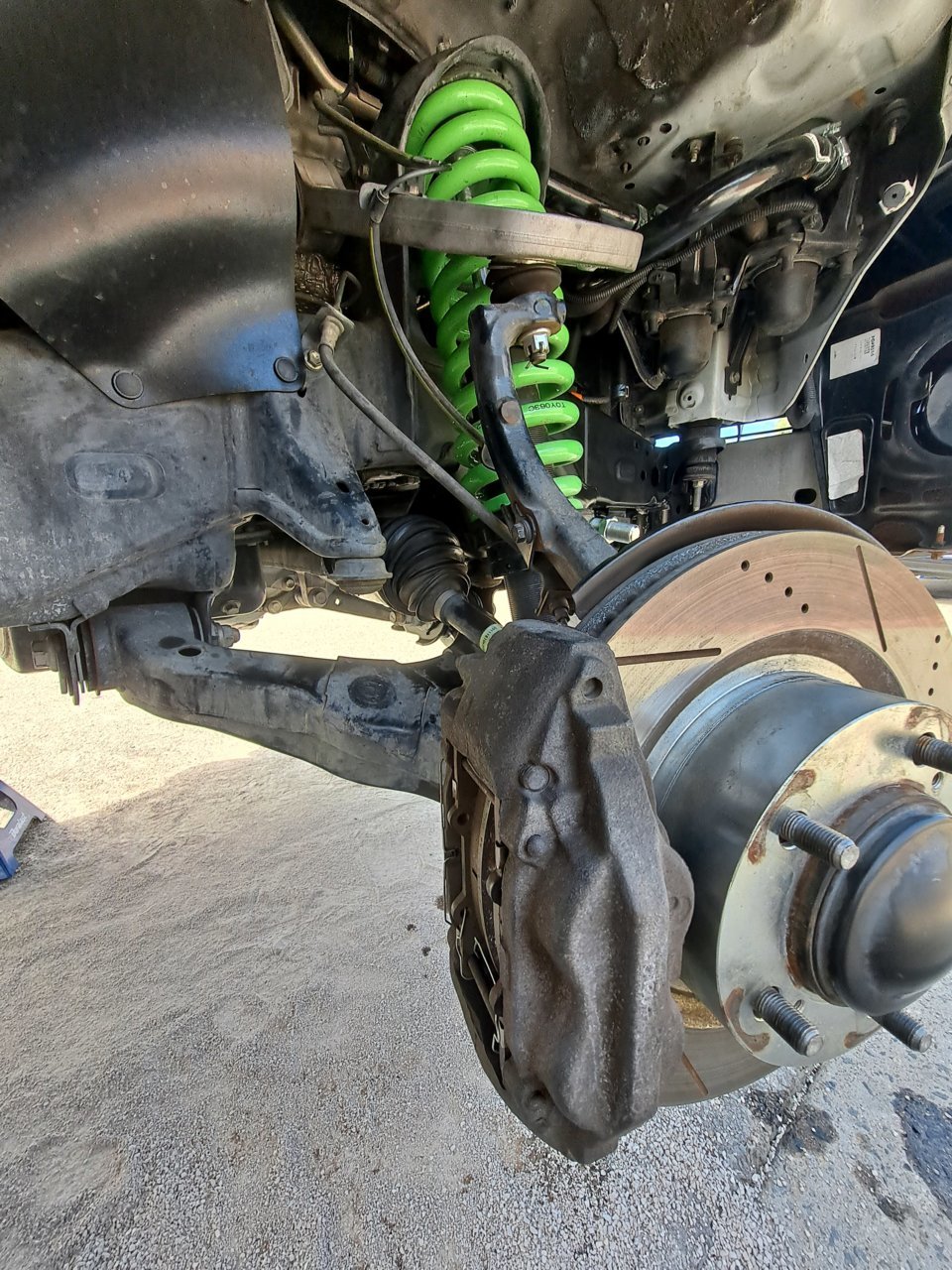

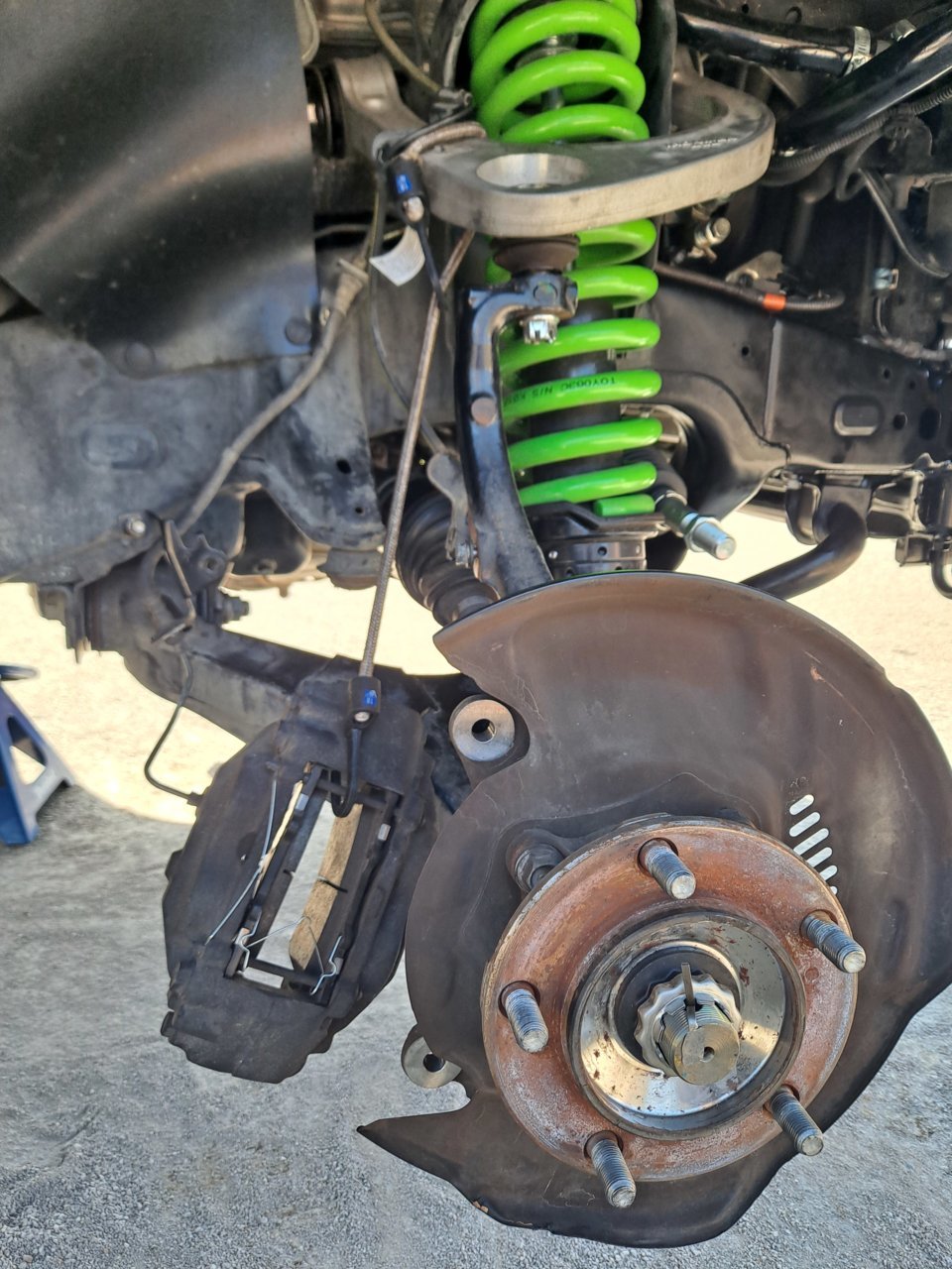

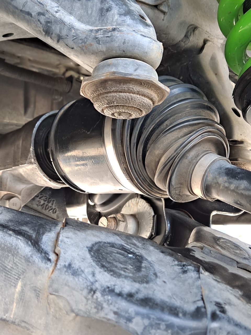

    Things I've been trying to do for the past 3 days. Replaced my steering rack and power steering pump. 10/10 pain in the ass.
    QUESTION: Can I bang the CV axle into the front transmission OR should I remove the CV axle from the knuckle and then bang it in?

    Which ever way allows the CV to be straight while its inserted into Axel axel housing. If you have the CVs at a angle while hitting it you have a chance to break the CV's.
    Most likely will need to remove it from the knuckle.

    OK so I pretty much took everything off and next is the UCA nut. There's little to no tension on the brake kine.. It should be much easier to manipulate after that.
    Feels like I'm wrestling a aligator...

    After accidentally divorcing my cv axle from the front diff, I was able to rotate the axle till the slpines engaged, depress the cir-clip, and slide the cv end into the differential an inch or so (with force, but only hands).
    Then lifted the lower control arm with a jack to achieve a more desirable alignment/angle on the joint. Confirming with rotations that the slpines still seemed engaged.
    I seated a long, mechanics prybar in the groove on the cv collar and lovingly tapped it home with a 3lb mini-sledge.
    Refilled with Mobil 1 75w90, and everything's been running great since (~5k miles)

    Yeah unfortunately when I jack my lower control arm, the truck starts the lift. So I'll have to take the root of taking the CV axle out of the knuckle...not excited about it. Now I'm trying to find the ungodly sized socked to take off that nut
