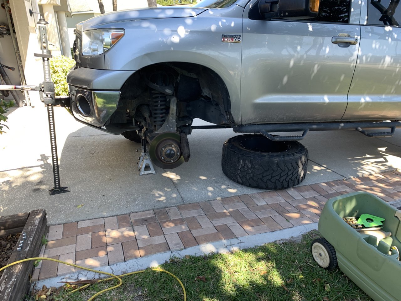

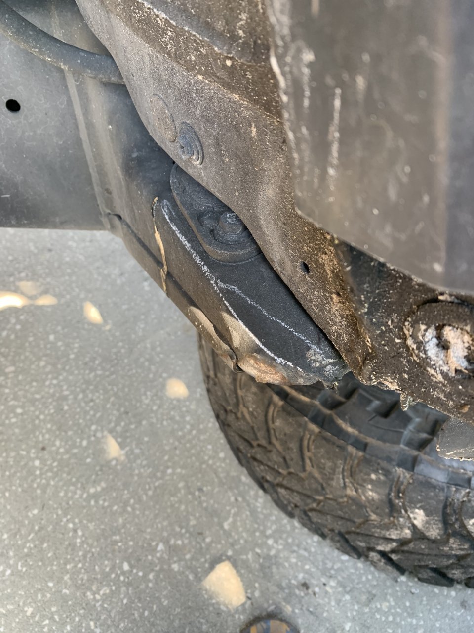

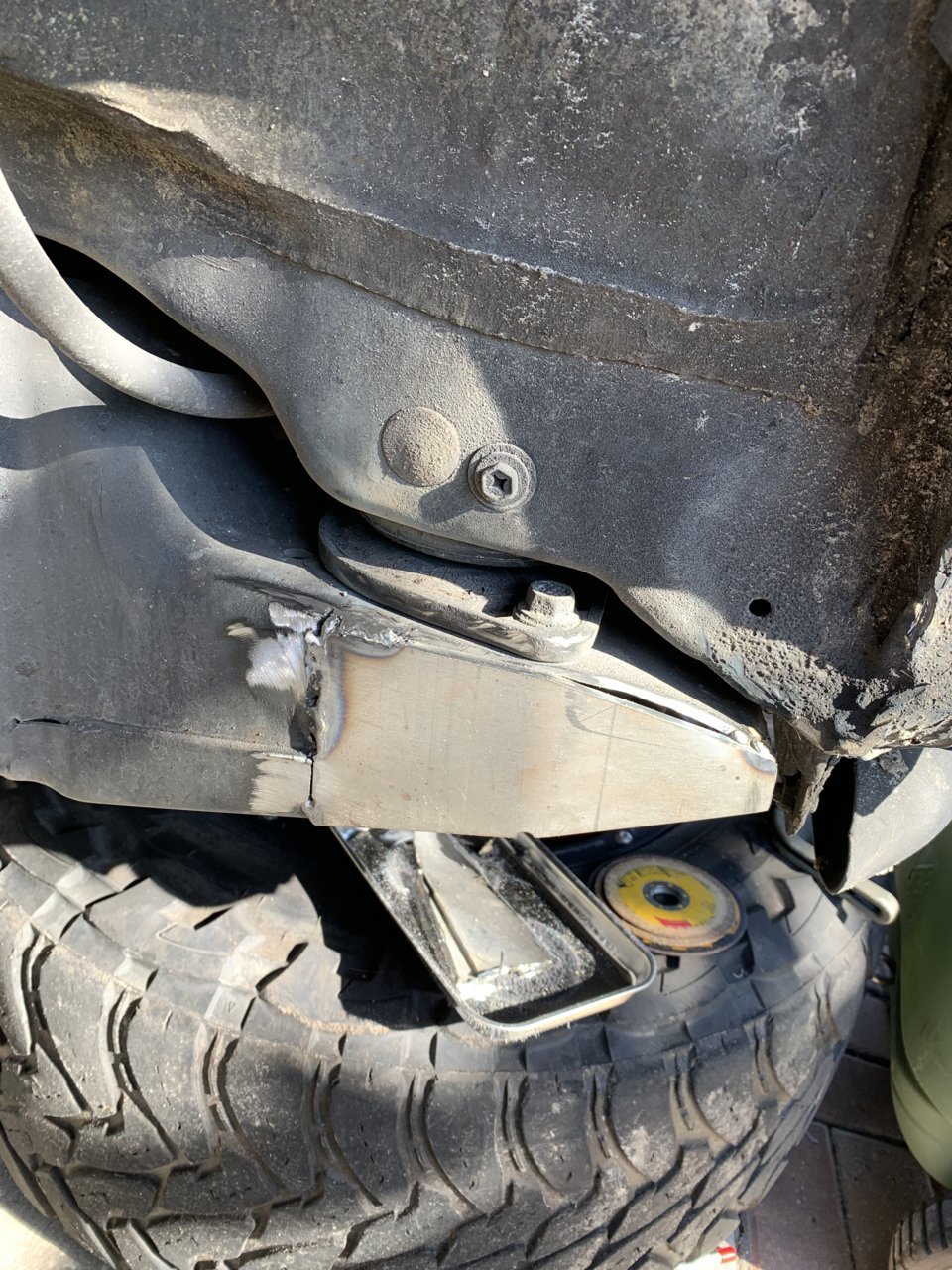

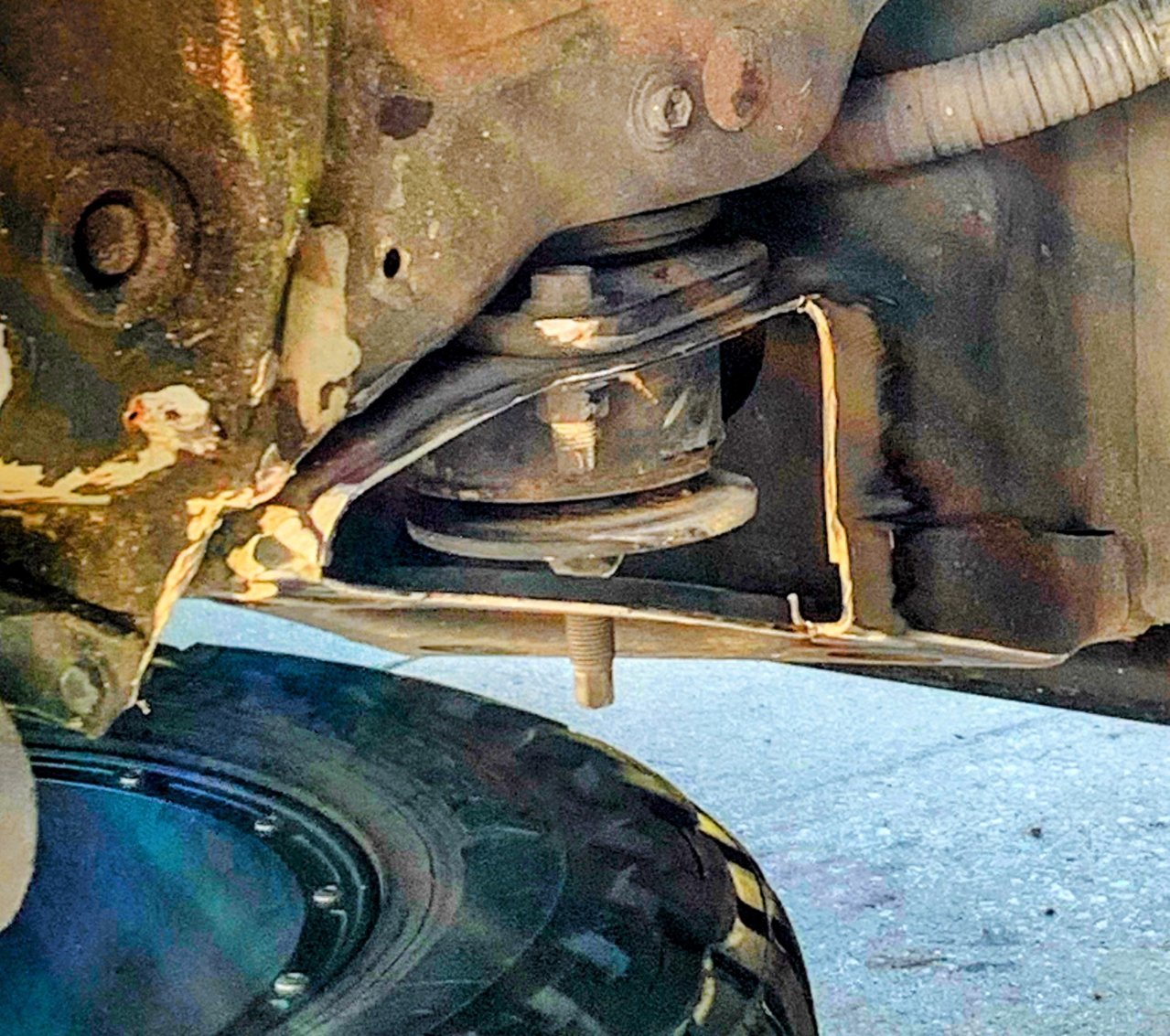

    I am about to do the BMC, with relentless fabrication plates.
    I used the front tow hook and hi-lift jack with wheel straps. It severely bent the Toyota splash shield in the process but it’s whatever at this point, I just want full turn radius and for this not to fall on me. I lowered the jack to rest on the support stands but there has to be a better than this.
    I’ll post after pics unless I do a terrible job, then I will delete this post.

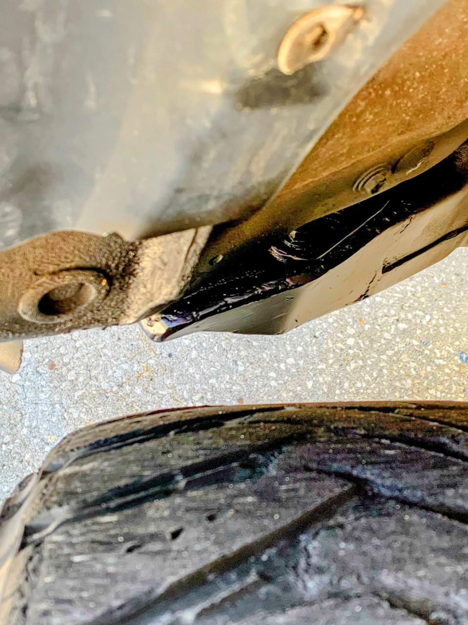

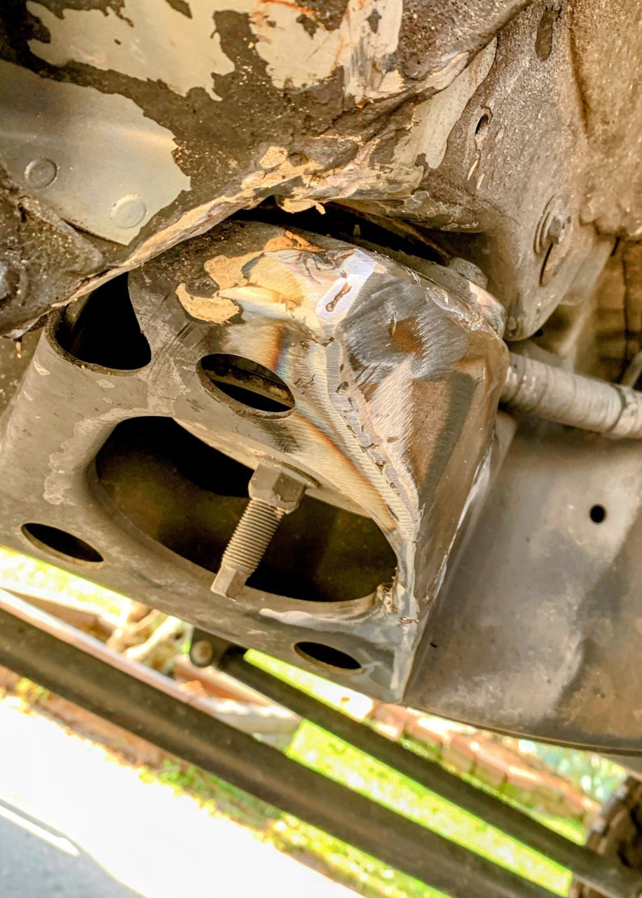

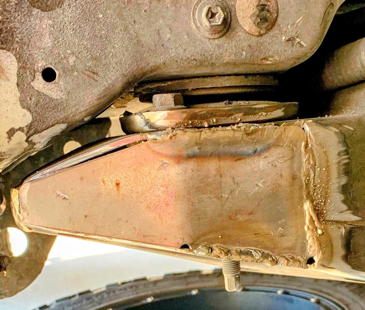

    Idk if I previously mentioned this but I’m a keyboard warrior for my day job and have been watching welding videos and bought one about 6 months ago and been practicing on my lawn mower. (the other American way lol)
    I only did one side today bc I have time and plan to do the other side tomorrow.
    I did a few tack welds and hammered the gaps into place, then I just tried to fill it all in, adjusted the heat settings a bit, let it cool, flap disc, spray paint.

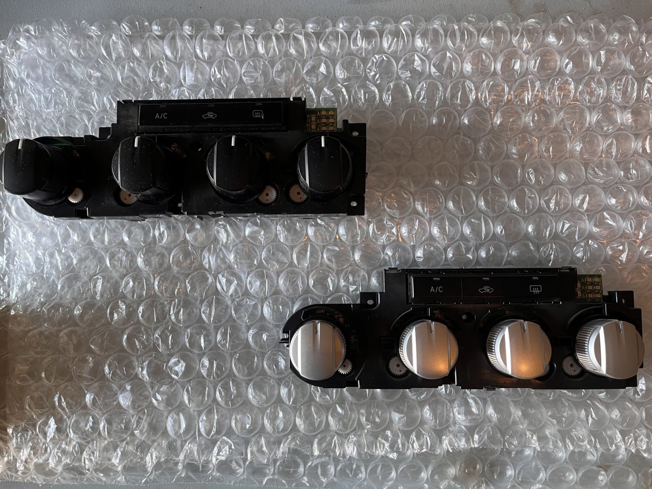

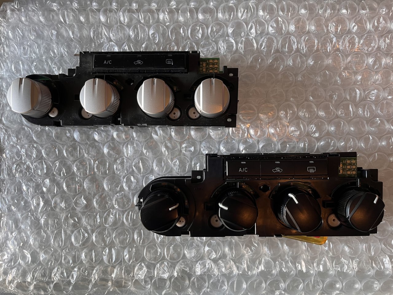

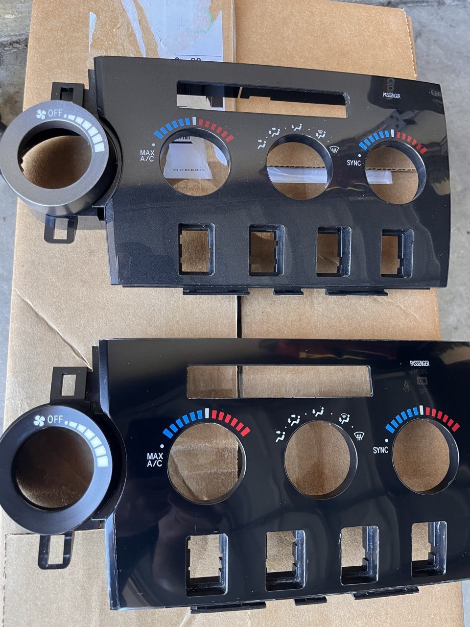

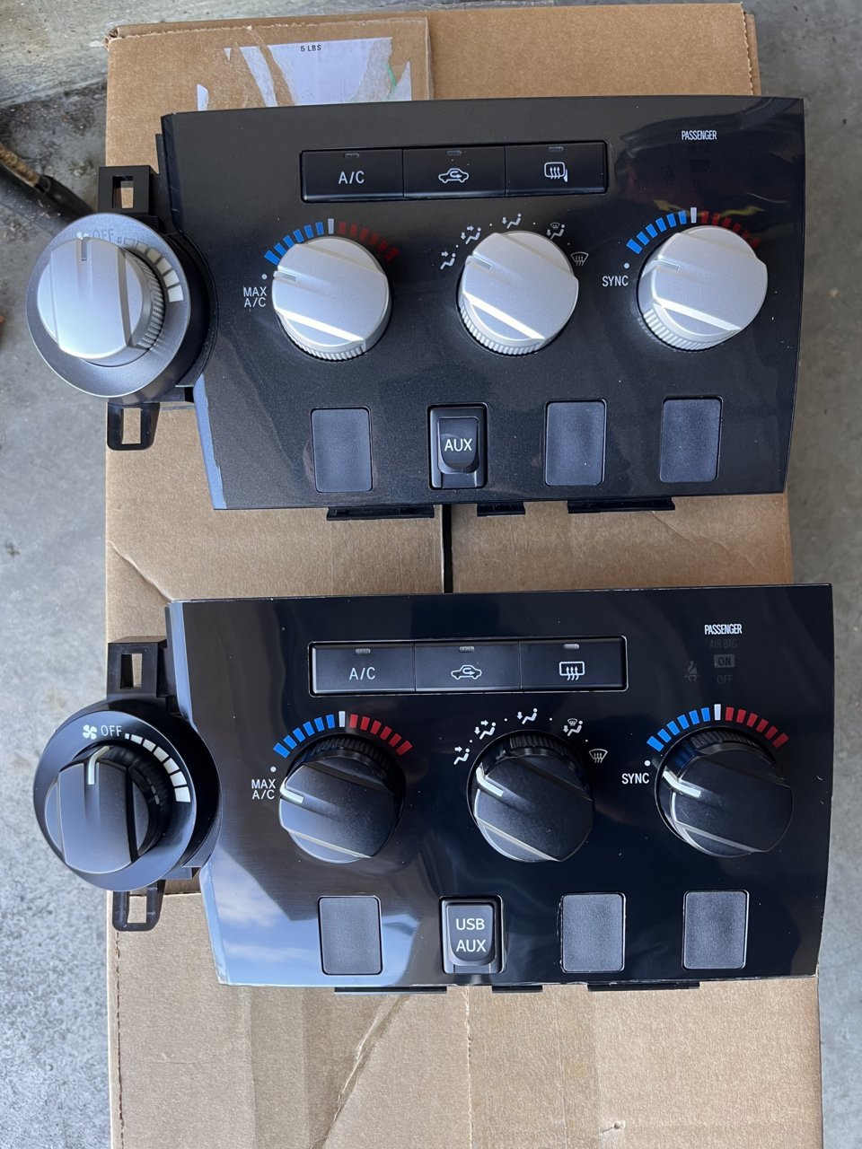

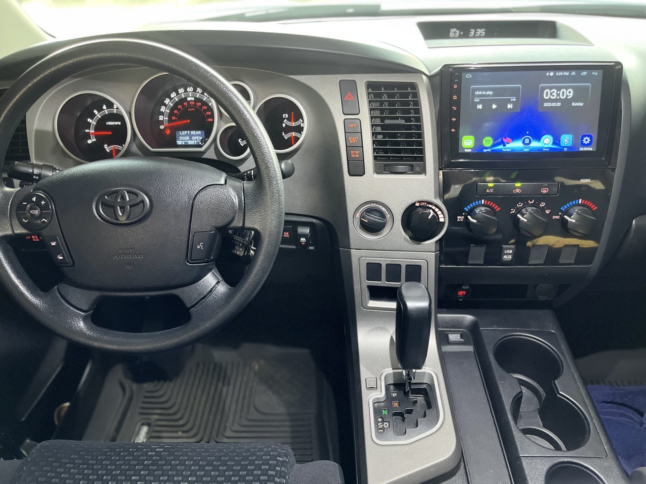

    I swapped out the climate controls today with a unit from eBay. I cleaned it up the best I could but after I got it open I noticed what looked like water inside the electronics. I ended up swapping the 4 black knobs and faceplate to my controls.
    AC73A079-D96A-47C7-A73C-324CA3C9D5C0.jpg25BED80E-A54D-473E-A51B-71DA2B0A29AC.jpg33A0588B-A30A-452F-8288-BFB3B8C20CF8.jpg10512BE9-9AAB-41F3-AA6A-5FD74D155AAA.jpg2160A37F-7545-45C5-BA4F-70B6230B24AB.jpg Happy with it and 1 step closer to the end goal.

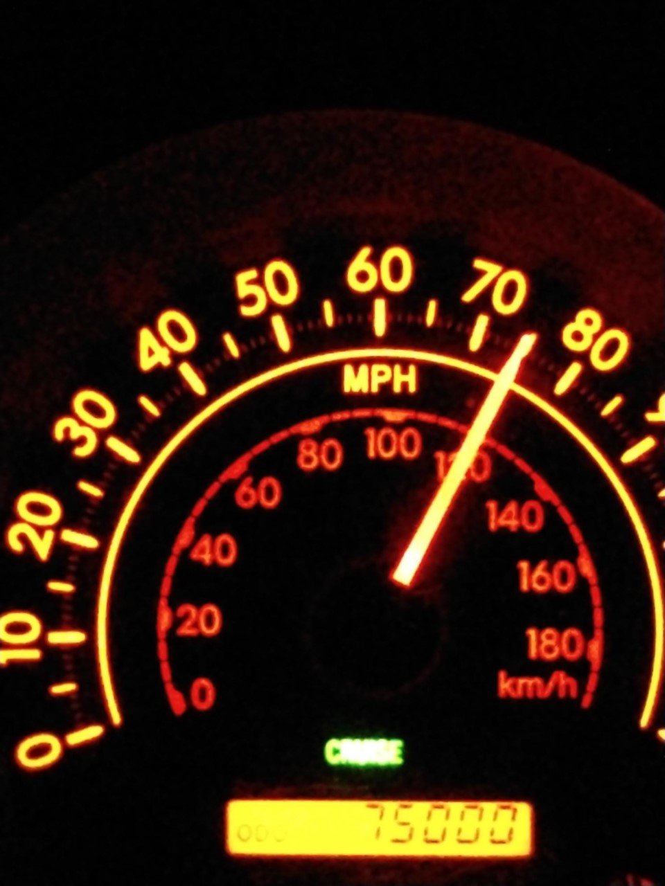

    As far as what I did.... I hit a milestone for me. Not bad for a 2012 Tundra.

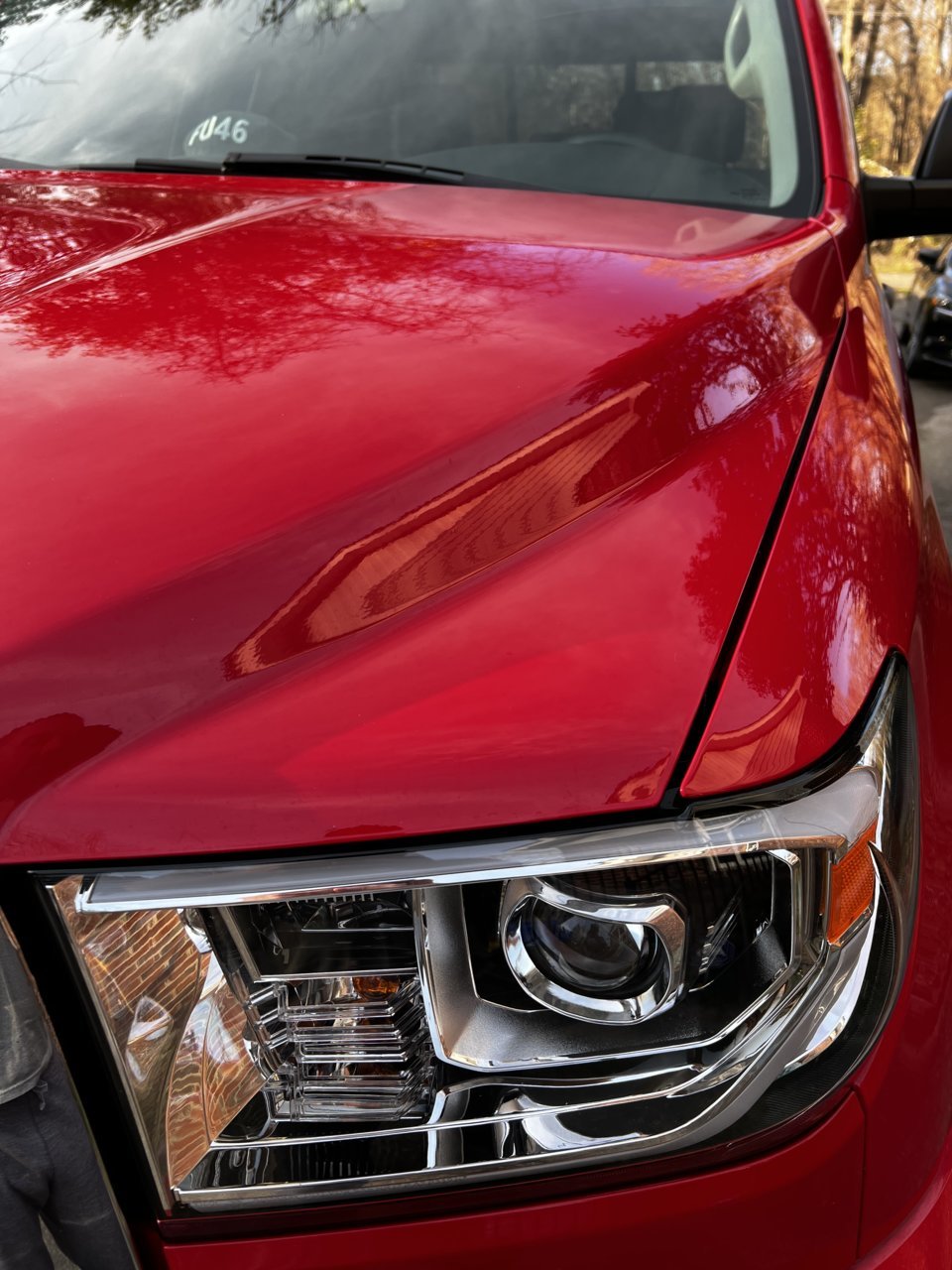

    Fresh wash using Adam's Polishes daily driver kit.

    Size looks fine, but I *think* there's only supposed to be two there :rolleyes:o_O

    Can you tell me what the part number is and where you purchased. My 07 needs this too. Thanks

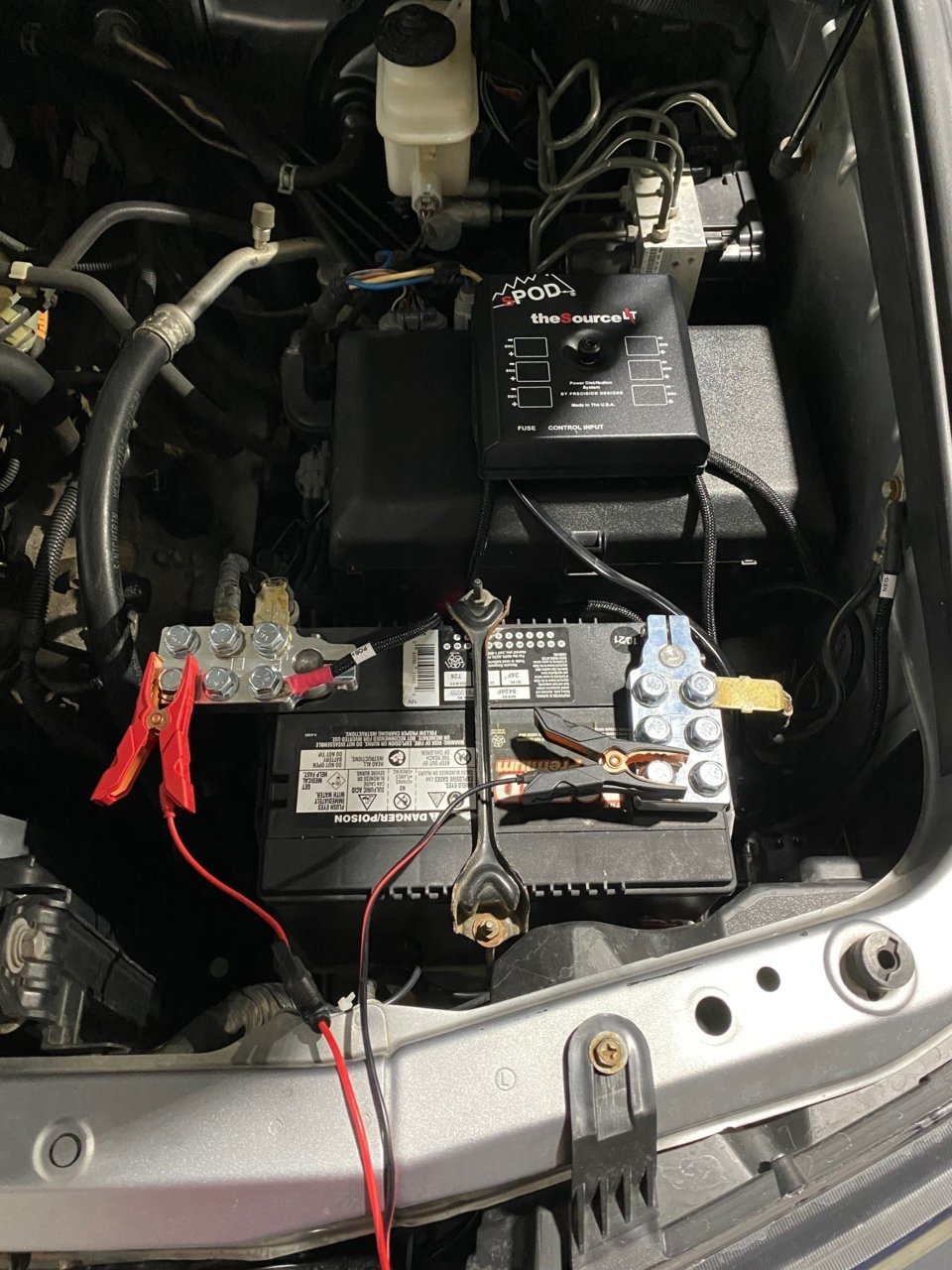

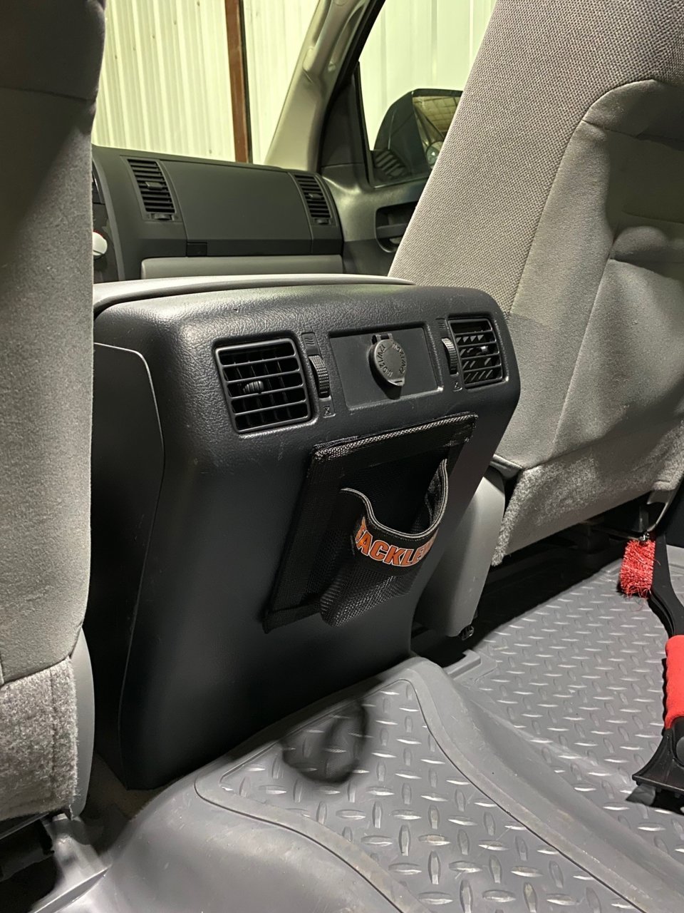

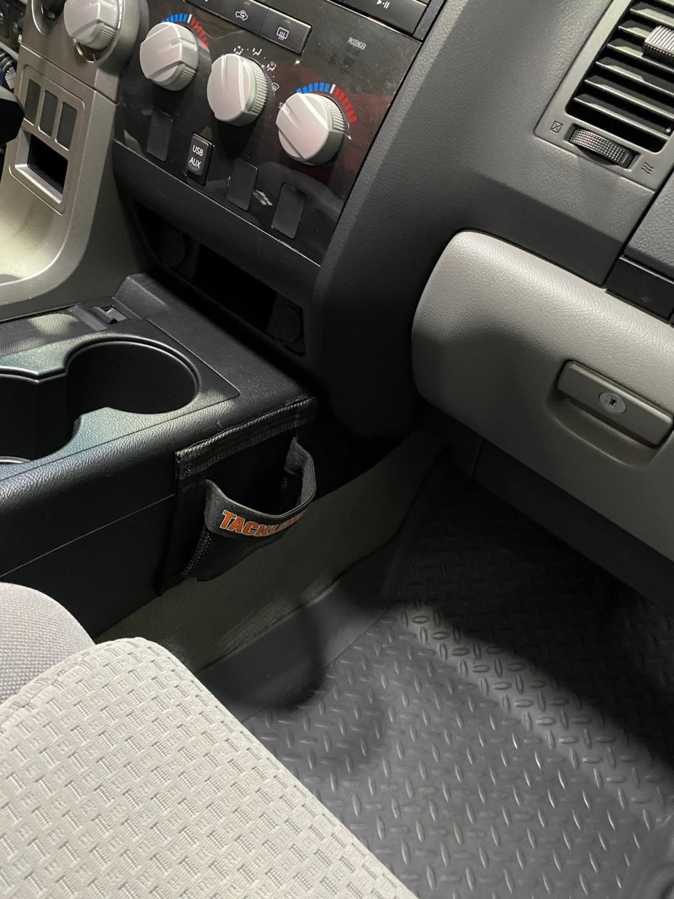

    Threw on some GP Audio battery terminals - these things are beefy! The positive is stuck out to the side because the + connections for the truck don't have any slack. Might look into that later and see if I can make some slack and tuck the terminal over the battery like it is on the - side. These will be handy when I eventually add my compressor (that has been sitting in my closet for 3 years) and possibly a winch. My only gripe is that the bolts are massive, so I had to drill out all of the terminals (on the truck and sPOD) to fit.

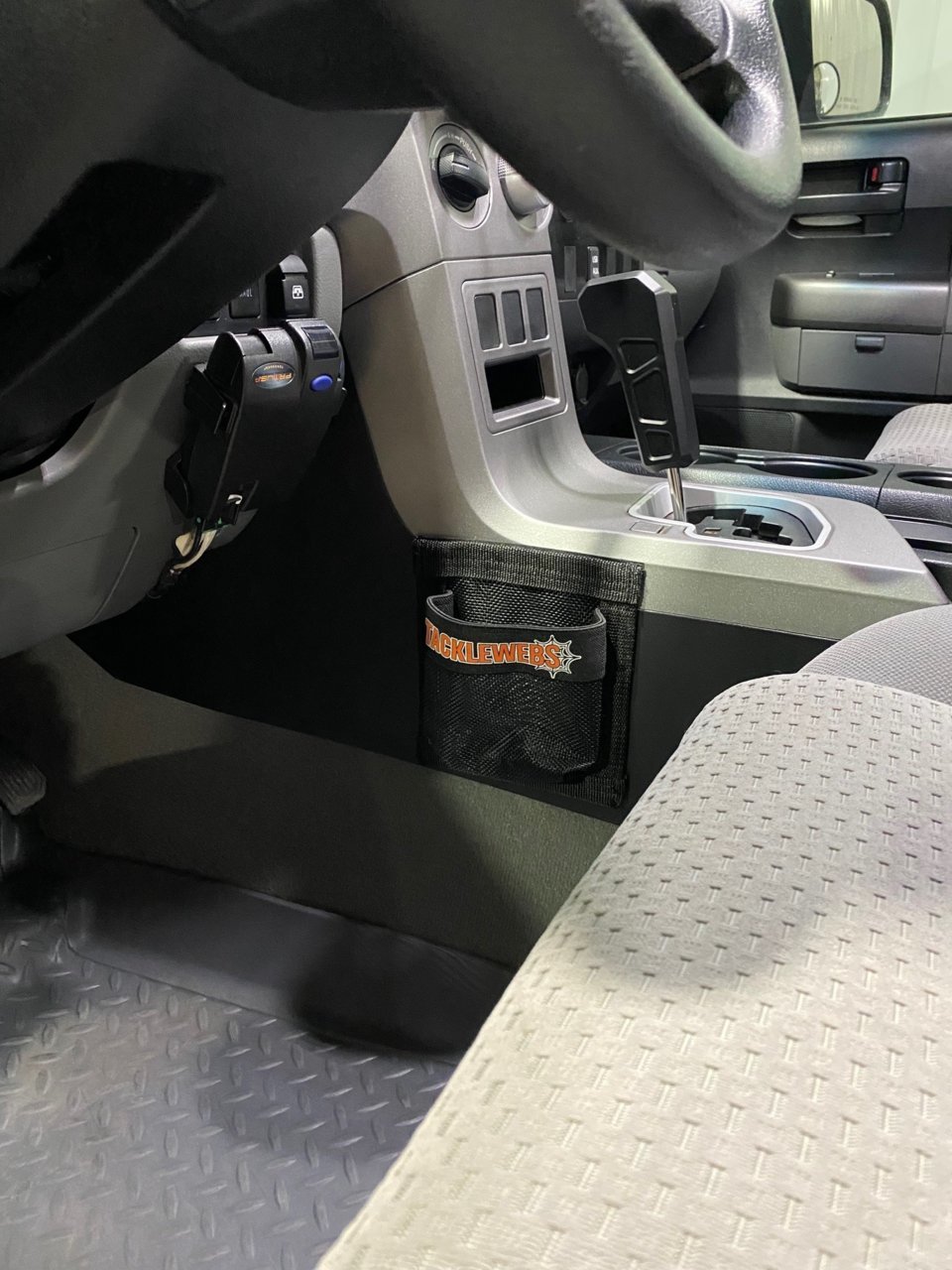

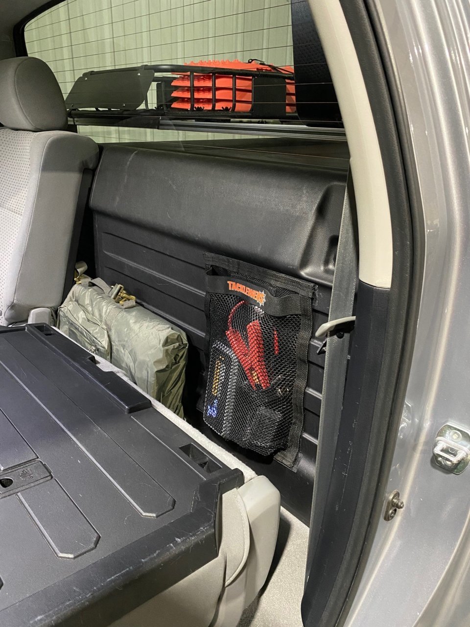

    Also threw in some Tacklewebs cup holders on the driver side, passenger side, rear passenger console and rear seat storage area. All the chalk bag cup holders on the 2.5 threads gave me this idea. I originally bought a couple of these for my fishing boat and I loved them - so I gave them a try in the Tundra. Very easy install, it is secured with Velcro. Peel off the backing and stick it wherever you have a flat surface. Perfect for cans, bottles, Yeti's, phones, wallets, ect. - always nice to have additional storage!

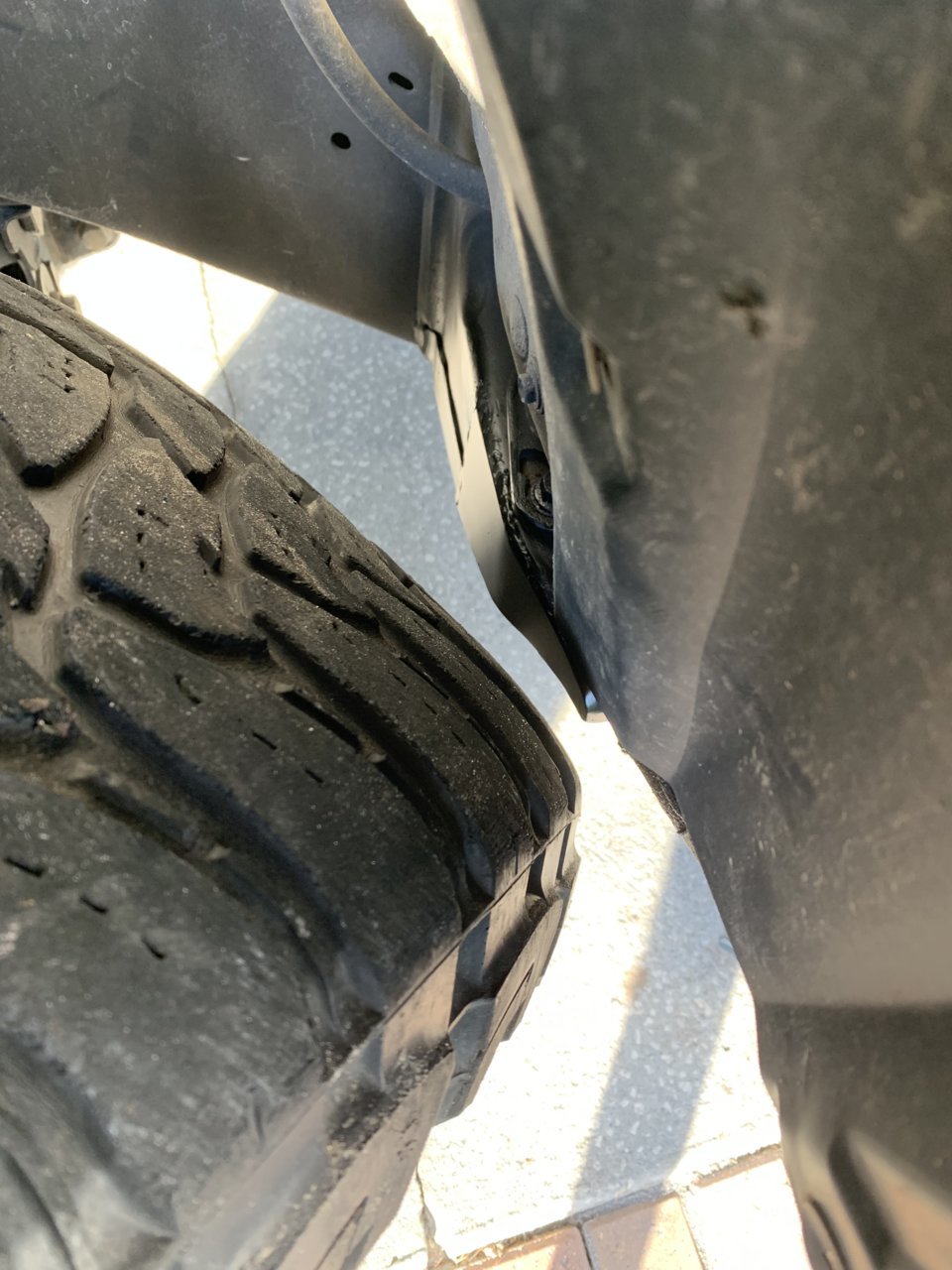

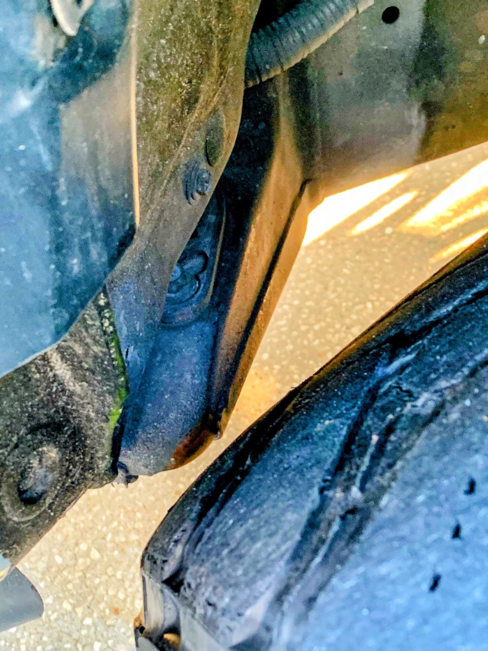

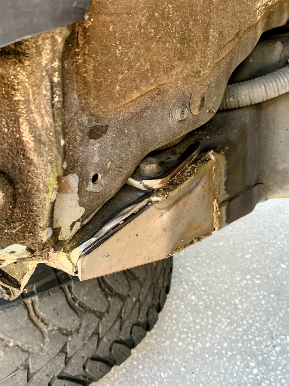

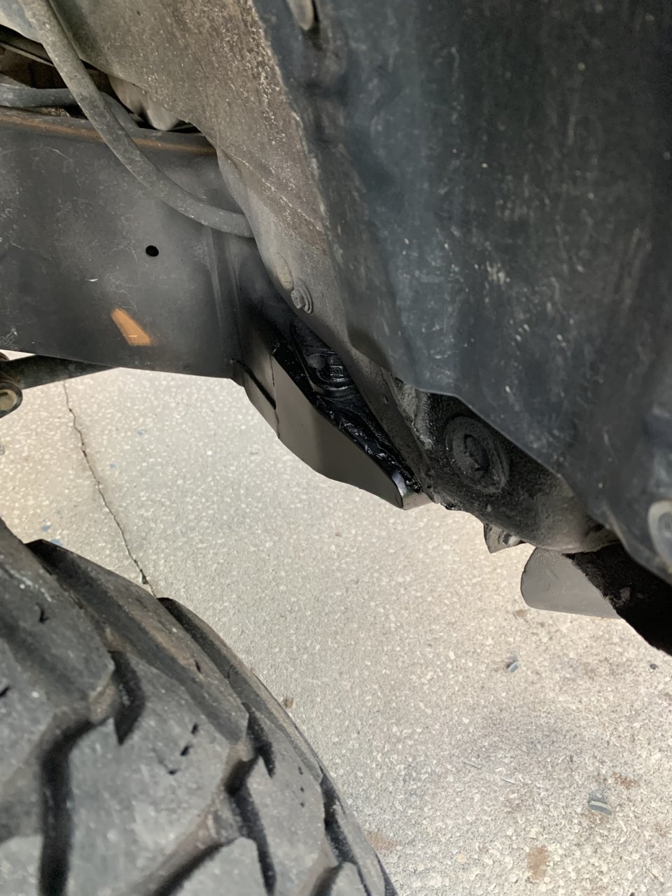

    Did the last side (passenger) BMC this morning.
    Drove it to Wendy’s, and didn’t grind one bit as I made multiple 3 point turns for fun.
    Hopefully I don’t have to round off the new tires like I did the current ones.
    I tacked it pretty well and then really pounded on the plates to try to bend them back as much as I could, finished welding, flap disc, paint

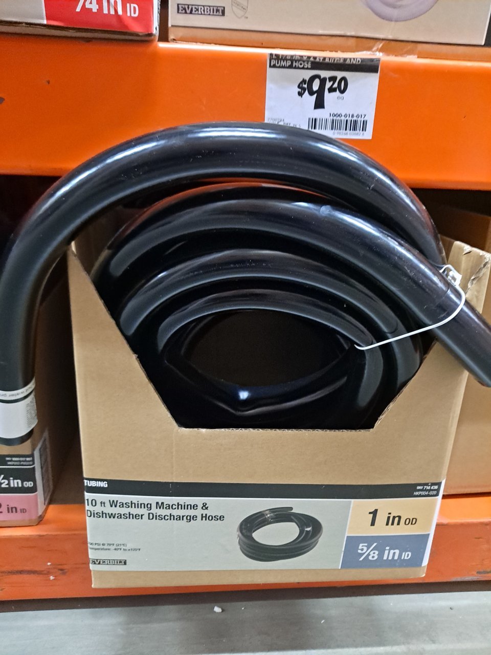

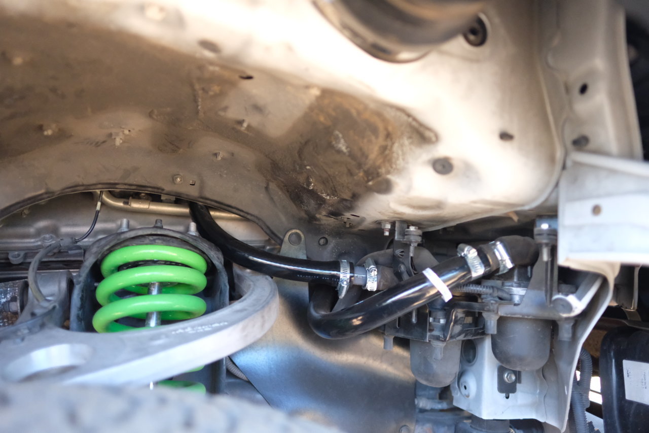

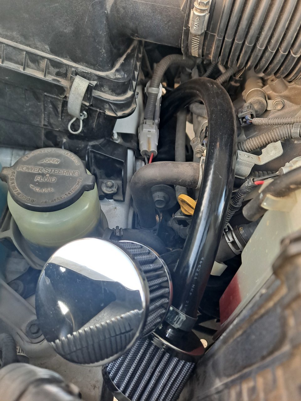

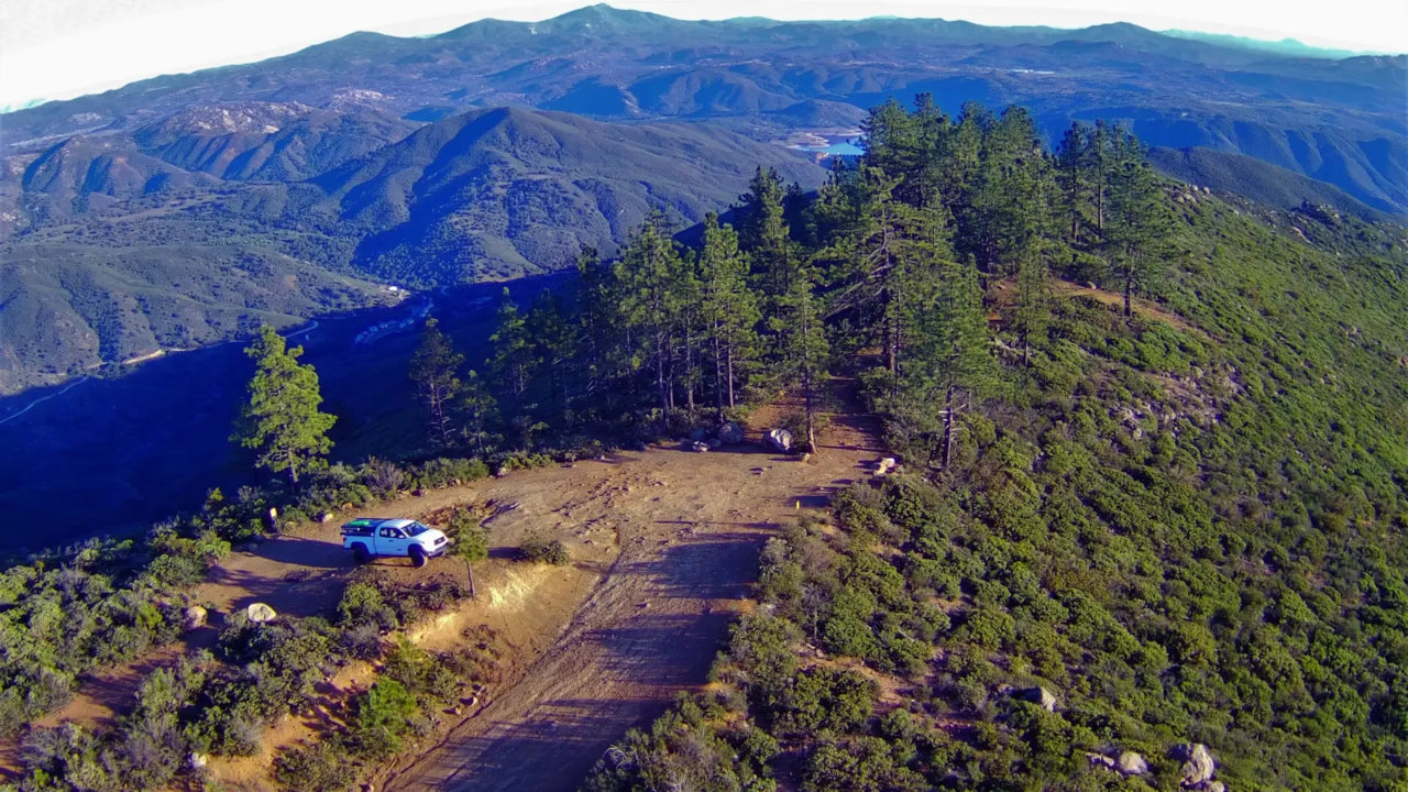

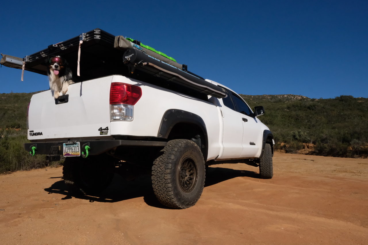

    Installed a custom secondary air injection pump relocation kit using home depot and autozone parts, saving myself around $350.
    Then I installed my bushwacher fender flares and make sure it would eat my paint by using some clear M3 tape.
    The secondary air injection pump relocate kit works and the truck handled everything like a champ. I don't see a need to regear, 4 low worked great on the spots when needed.
    Then to finally test put my ironman4x4 suspension and the 35s, I took the truck up to Black Mountain OVH trail.
    End result, the secondary air injection pump relocation works and the suspension held up like a champ.

    @AstroDude - Love the view thanks for sharing. I’m super jealous BTW!!
